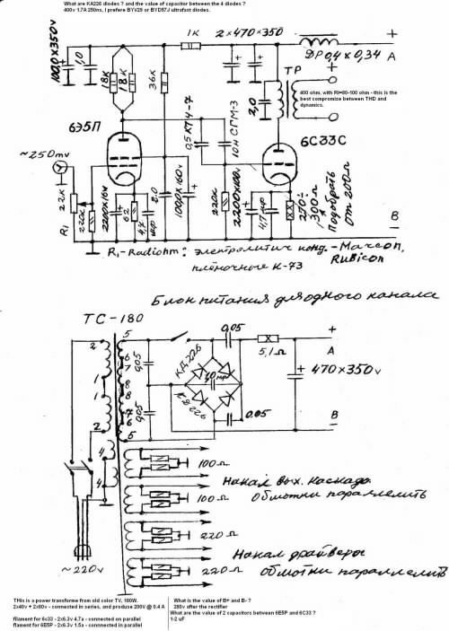

Mr.Aloia has various steps for PSU, it is one of his battle horses!
From normal CLC up to LCLC !!:hot: chocke input. And note that the PSU is " in parallel", not" in series" ( I have read so).

Hey Bob 🙂 ,
Excuse my question: are you sure to have the instruments to build yourself that monster?😀
Because It seems to me it is not the typical basic SE;
It is IMO not an easy task
But I am really newbie on tubes, so my point is just impression, of course!🙂
Hey, what type of speakers do you have to drive with it?
Big room or little?
Paolo

I have been mulling over Dmitry Nizh's inductor coupled design for a while now, and even have the ECC99's and 6C33C's at the ready! So I will have to give those OPT a look myself. I was thinking of using the UBT-1's or something similiar. Most of the SE circuits floating about for this tube insist on some exotic iron, which is what appeals to me with this design, as well as the linear driver tube, and the operating range of the output tube. Has anyone else used this design?
