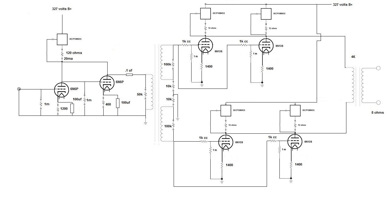

6AS7GA as push pull output?
I've taken another stab at a schematic. I can see why the 100 volt/90ma route would make sense. Less voltage swing and from what I know of load lines less distortion. But I already have the power transformer and I want to extract as much power from the amp as I may. This amp is an experiment as much as anything else.
As for the schematic. I added grid stoppers and cathode resistors instead of sinks. In one way the cathode resistors work out well because with the B+ I have the voltage dropped across the cathode resistors will mean 250 volts across each tube. At 1400 ohms it seems like the cathode resistors should be bypassed? I still have to figure those out.
The interstage design is lifted from the original Magnavox schematic.
As for the front end I thought using a CCS set to 20ma and letting the cathode resistors for 6N6P/ECC99 divide the current between them might work. I might be wrong on this. Also, it would be nice to DC couple the two voltage amps if it will work. The .1uf coupling cap acts as a parafeed for the interstage to keep the DC out of its primary.
The glaring errors will be easy for everyone to spot so constructive criticism is welcome.

Running the outputs with CCS loads brings almost nothing good to the party in this application. Since the Output transformer has a fraction of the impedance of the CCS it will dominate the distortion generating components. It will also limit your output swing - and I suspect will probably fry the CCS when the OT tries to swing higher than the B+ and reverse the drain and source voltages.
If you are going to use CCS's anywhere in this circuit it would be in the front end and in the cathodes of the 6080's. Running the 6080's with CCS in the cathodes has specific benefits which have to be understood as they come at the cost of limiting the circuit to low power class A operation (good for low distortion and DC intolerant transformers but little else). Putting CCS in the cathodes of circuits has become somewhat trendy but rarely do the people doing it understand the consequences.
I would get familiar with the joys of SPICE and model all of these ideas to see what is possible. I have taken raw ideas and refined them to workable circuits this way and learnt a huge amount along the way.

Hey anyone, I'm back to TL783 as a constant current sink at the cathode of the outputs. The reference voltage across the parallel resistor is 70 volts. The same as it would be using a 1400 ohm cathode resistor. But the actual current would be through the regulator. The drop across the regulator is 1.3 volts maximum. If I understand this correctly the actual drop through the CCS will be something less than 1.3 volts. So 251.3 across the tube and the CCS would leave about 77 volts unaccounted for. That means I could use a 1.54k plate resistor or larger if I wanted to drop 250 or more across the tube? Also without the huge cathode resistor I wouldn't have to bypass it would I?

I just can't get what the circuit you intend (( If that is a CCS - what "cathode resistor" are you talking about?? If CCS - then the drop across the TL is 70V - 1.3V. If you "load" TL with a resistor to make TL less heating (as you say the 1.3V drop across it) in this case the TL provides no (nil, null, zero) CCS performance. Aka "useless".

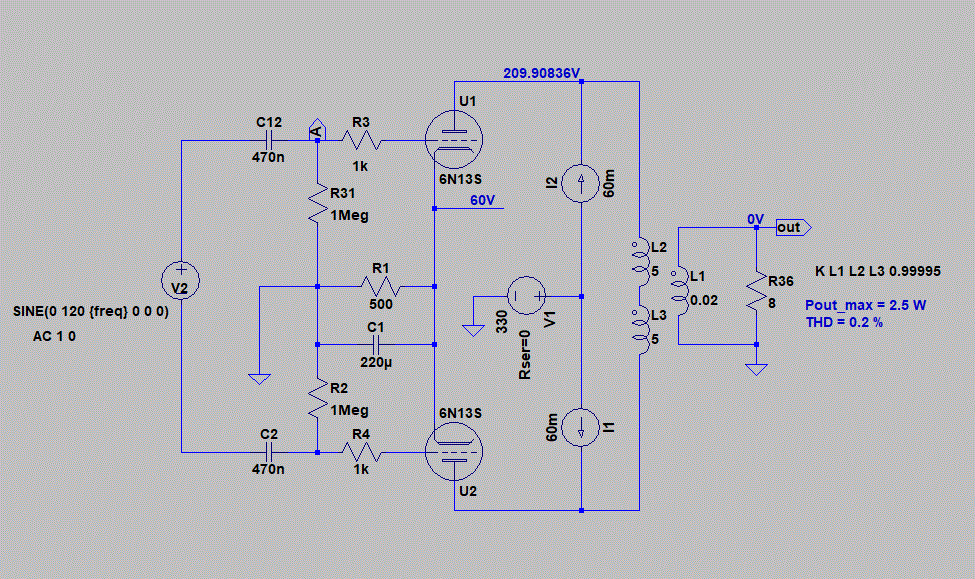

The problem with CCS at the anode is that the voltage swing is highly limited.
With normal PP circuit, the transformer at the anode, the voltage swing is almost from 2 x +Ub to Uk but with CCS only from +Ub to Uk.
In practice this means that with normal transformer coupled PP, with 375 V +Ub the max. voltage swing at the anode is some 550 V to 190 V = 360 Vpp.
With CCS at the anode the max. voltage can not be more than +Ub, less the voltage required by the CCS to operate.
In case of the below simulation the voltage swing is some 300 V - 90 V = 210 Vpp.
And as we know the power is: U² : R. Therefore the latter voltage swing produces only 1/3 of the power of the first.
Second problem is the OPT. It seems to be 4k. This is not optimum for parallel PP.
Some 2k to 2k5 would be ideal.
With your last circuit, only some 5 W of output power is expected.
One advantage is however achieved, the THD is very low.

Thanks very much Arto. I have a Japanese LCR meter on the way that can measure up to 2 kilo-henries. My current meter's limit is 40 henries so I couldn't even measure the interstage. When I recieve it I'll be able to really model the amp in Spice and that will make things much easier for me. And I won't have to lean on you guys as much.
The output transformer isn't ideal but they were free. My winder can build me custom outputs for about $90 each. So I may go that way instead.

I'm afraid your post makes aboslutely no sense to me. If used as ccs, the drop across the regulator will be whatever it takes to achieve the desired current. The 1.3V is just the minimum to get the regulator chip working. If using a ccs, you don't need to add resistors here or there to adjust. In fact, the additional resistors will do more harm than good. The ccs will automatically adjust its voltage drop as stated above.
If you want to burn less heat in the ccs, just lower your Ub+.
You will need to bypass the ccs'es if you're going to use 1 per cathode.
