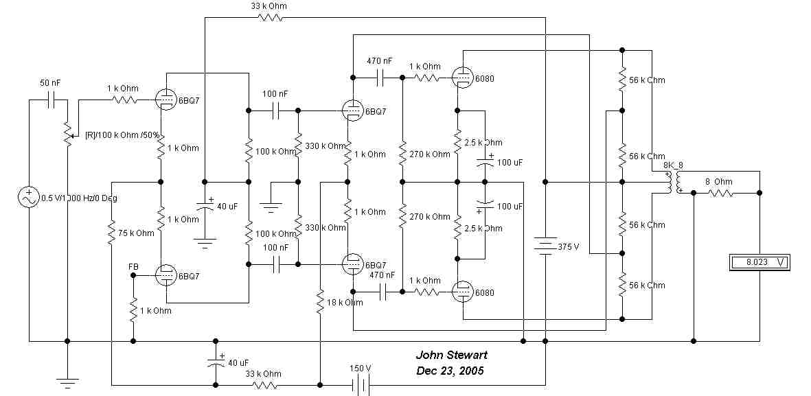

6080 PPP Amp my Vers
This has been on the forum a couple of times, so here it is again. I solved the drive problem with the simple fix of boot strapping, same as McIntosh & Electrovoice. So 25 Watts at clipping with 400V PS. Lots of heat from the four individual cathode resistors.:)
The project was simply 'proof of concept'.

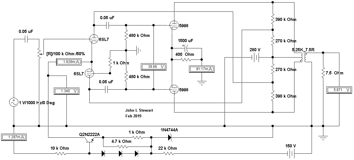

Two more Bootstrapped Examples
Neither of these need the UL tapped OPT I'd used in the original amp.
Using a voltage divider across the OPT primary of about 50% on each side, also calculated to give proper loading to the driver tube.

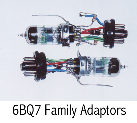

An early vers uses a pair of 6BQ7 as diff amps. This one is simulated only, I didn't do the breadboard. But I'd already made adapters to try tubes like the 6BQ7 as an alternative to the rather expensive 6SL7 & 6SN7 normally used. Tests of IMD & THD shewed the 6BQ7 to be very close in performance to what I had used on the Crowhurst Twin Coupled Amp project. In a double blind test its unlikely anyone with normal hearing would be able to hear the difference.

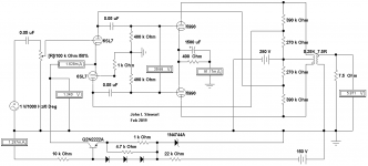

Recently I tried a bootstrapped 6SL7 driving the 5998. Worked OK, I left it at that. Depending on the supply the 5998 in PP clips at about 10 watts. The OPT was a Hammond 125E. No need for botique parts!:)
