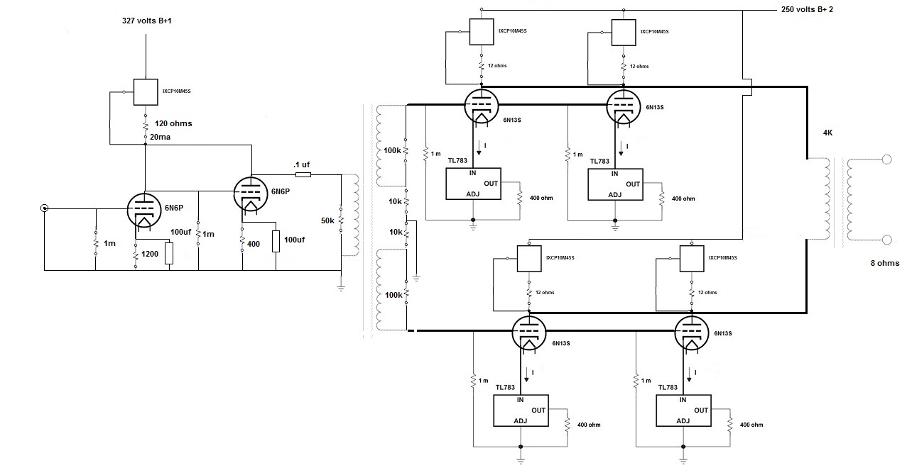

Hey All, I've been thinking that I might use a 6P15P pentode as a voltage amp. That way I can get all the voltage swing I need in one stage. And the pentode predilection for even order harmonics might help to cancel the even order harmonics of the 6N13S. I was reading about the "Scrap Box Challenge" in MJ. I was really impressed with the 6528 he used until I found only one on eBay at $79.95. Parts collection has been on the order of scrap box as well. I have two Magnavox OPT's that I hope to use. They're 4k but I have them. I can always custom order a pair later if necessary.
In normal case when output transformer is directly connected to anode,
the voltage swing at the anode can be (in theory) from zero to 2 x +Ub.
Now with CCS at the anode, the voltage can swing only from +Ub to zero.
Half of the voltage swing is lost.
The use of a CCS is sensible at voltage amplifying stages, but not in typical PP or SE output stages.
There is also CCS at the cathode. Which one is now determining the anode current, upper or lower ?
Only one can determine the current, the other is not working as a CCS.
Typical cathode resistor will do fine.

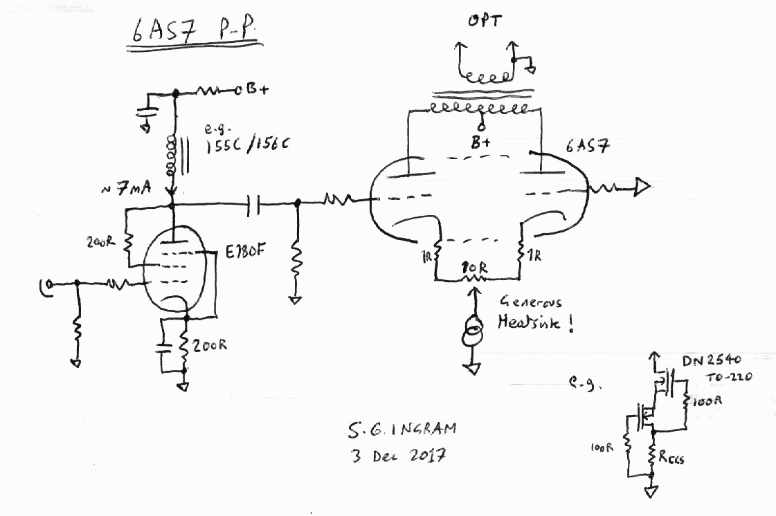

You are going to heroic efforts on this one - having built a 6AS7 single ended amp as my first and only stereo amplifier I can say from experience that it's a lot of fun to play with a big tube like this. But I'd not recommend it for an all-out effort, this tube is an awkward beast. It drinks heater current, being a tube that likes low impedance loads with lots of current. And the high grid bias means lots of heat spent in the cathode resistor. Anyhow, my suggestion is to keep it simple. The latest circuit is way too complicated in my humble opinion.
Perhaps you could look at a self-splitting push-pull design. You get to use a CCS and no need for a phase splitting inter-stage transformer.
The self-splitting concept can be see in this example: Poddwatt: Class-A Stereo Push-Pull EL84 (6BQ5) Vacuum Tube Amplifier
For the 6AS7 you want lowish B+ because this tube runs better at higher current and you don't want too much B+ to over-heat the anode. That doesn't leave so much room for the driver stage. But a choke loaded driver stage will give you the most swing at limited B+. The trick is to be very careful at the build stage, you need to keep these plate chokes away from the power transformer or you'll get plenty of hummmmmm, so build a mock up and work out how the transformers and chokes need to be placed with respect to each other.
Joined 2009
Self-Splitting 6AS7 PP
This is a rough sketch of what I had in mind. Un-proven and probably missing something somewhere! - at least I didn't check that the gain is enough from triode-wired pentode (likely requires 3V rms input), you may need to operate it as a pentode to get more gain, or place two resistors in series from plate to ground and tap the mid-point to the pentode screen - you get partial feedback and you can set the gain of the input stage where you like it and according to your 'ears'. OR you can try a higher gain triode, there are plenty of options with mu around 70.
The more complex option, if you don't want to deal with a plate choke on the driver is to us a voltage doubled power supply. Set up the output stage with a B+ around 180V (high current) and voltage double that for the front end at around 300V after filtering (low current).
fyi: Hammond 156C - good Plate choke load??
A self spliter circuit relies on the MU to do the heavy lifting of the circuit and that means a high MU works best. The 6AS7 has a MU of 2 which makes it just about the worst candidate for a self spliter.
My recommendation is something like my DC7 Mk1 design which a few people built and listened to and said it sounded good. The recipe is a 5687 driving the interstage in parafeed arrangement. This does the splitting. Load the 5687 with a CCS to get maximum gain. The outputs work well at 100V anode to Cathode with 100mA of current. Put a CCS in each cathode and then cross couple the 6AS7 cathodes to each other with back to back 1000uF caps for quasi-differential output. Replace the 5687 for an ECC99 for a better result.

There are a few other proven PP designs out there for this tube.
Shoog

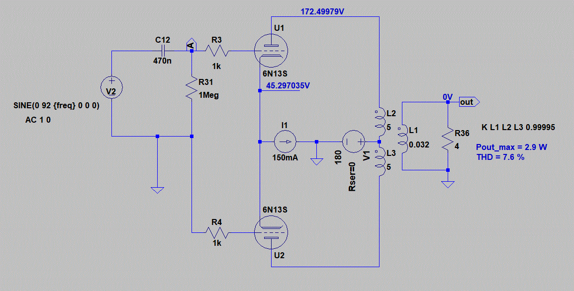

Self-splitting means that some half of the output power ( of normal PP) is lost.
Output impedance and THD are higher too, so where are the pros ?
This would be a very bad design. Self split with 180 V +Ub will produce less than 3 W with high distortion.
Normal PP with optimum +Ub (375 V) will give more than 12 W with half the THD. See post #7 and #19 (schematic and test results).
