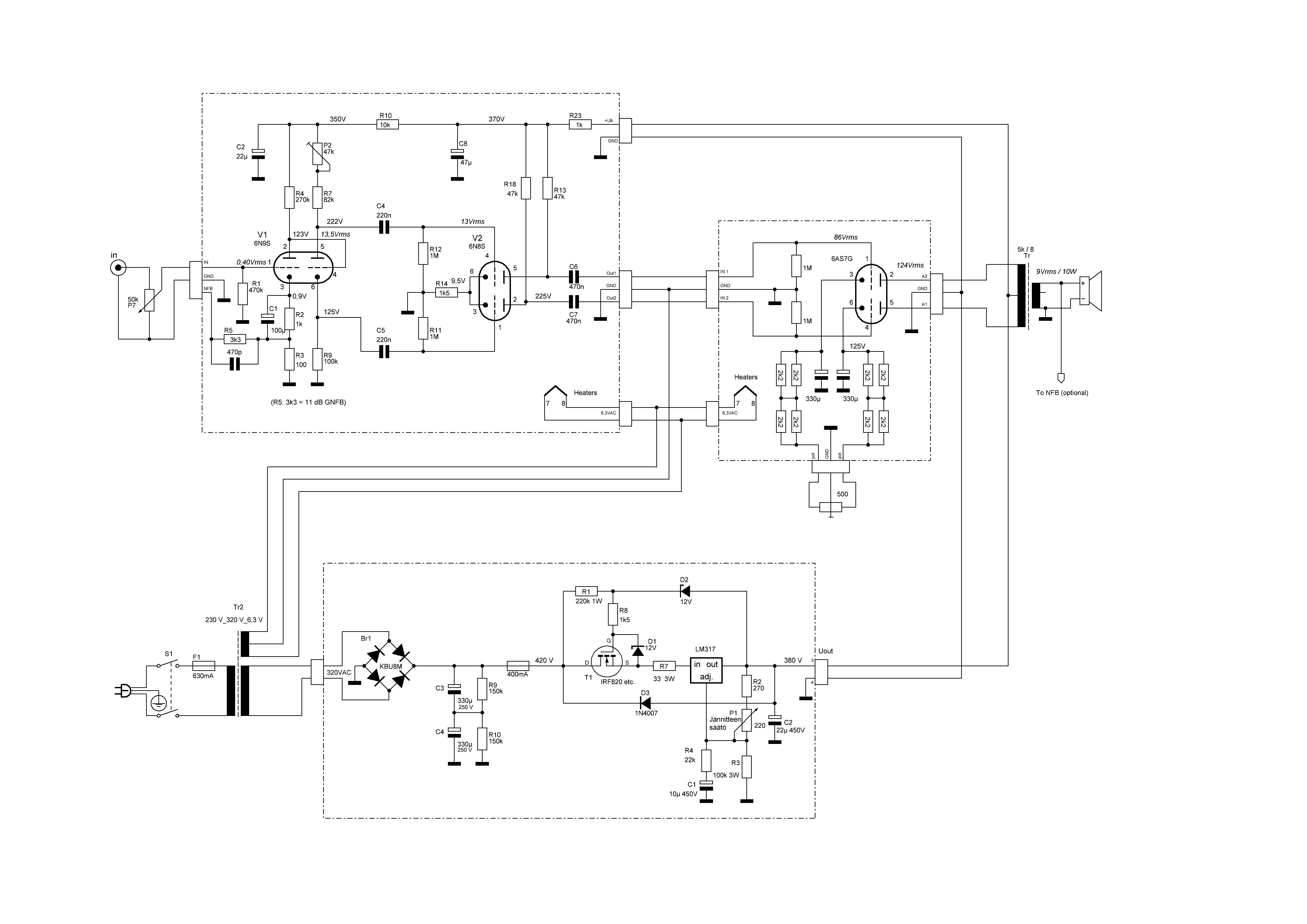

Look at my schematic at the post #7.
With 322 V supply voltage you should use smaller cathode resistor. Then 250V/50mA can not be reached, but quite close.

Artsalo, the aforementioned biasing of the driver stage is that present in the schematic of post#7?
Yes it is. You can see that the plate voltage of the driver stage is relatively high (225V) compared to supply voltage (370V). Also cathode voltage of the driver stage is high.
So the driver tube is biased to non-linear operating point where it generates "suitable" harmonic content that together with the harmonic content of the output stage finally produce low overall THD.

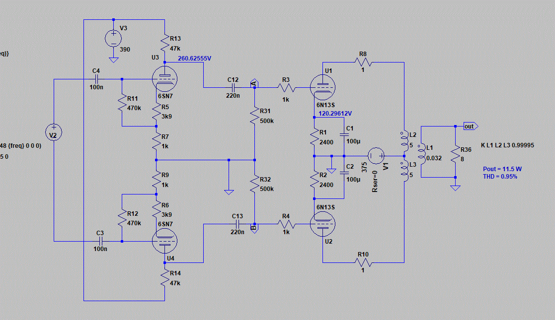

Below is the link to the latest version of the schematic. The only difference is that now the driver stage has common cathode resistor. In the earlier version both tubes had separate resistors.
http://kuva.termiitti.com/image/43742.GIF
Thanks, its a little clearer now. You are using the first half of 6SL7 as a voltage amplifier and the second half as a phase splitter. P2 is to even the output of the phase splitter? You seem to be underdriving the first tube and overdriving 6SN7 is that right? And if that is the case you must have reached this configuration by experimentation?
Can I assume that you are increasing all the harmonic distortion in the first stages. Allowing the push pull to cancel the even harmonics. And out of phase odd harmonics, in this case third, to cancel when they meet the inverted third order at the outputs?
Is the distortion created in the second 6SN7 stage?
Yes, with P2 any imbalance in driver stage, output stage or OPT can be zeroed.
The signal level is obviously lower at the 6SL7, because at 6SN7 the signal is amplified by previous stage.
I would not say that 6SN7 is overdriven, but it is biased to non-linear operating point.
My design procedure begin with several simulations with different topologies and after I have reached the target results, I continue by making a prototype. With the prototype I fine tune the circuit and make the required component modifications.
The first stages, voltage amplifier and phase splitter, I design to most linear condition.
But as I have told, the driver stage (6SN7) is the key element to make the overall THD as low as possible. There some correct amount of harmonics are generated on purpose.

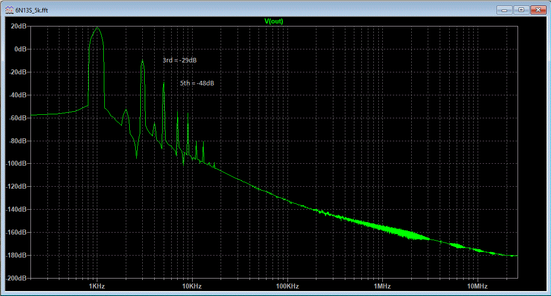

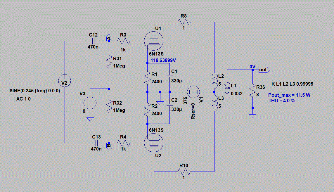

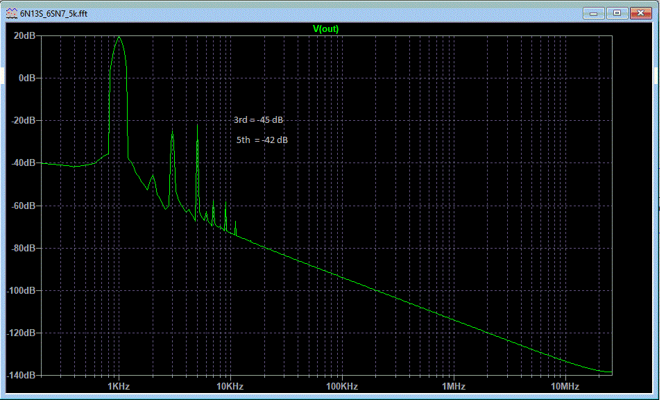

Below are some pictures to illustrate what happens when only the output stage is used and what happens when the driver stage is added too.
With output stage alone the THD = 4%, 3rd harmonic at level -29dB and 5th at -45db.
With output stage + driver the THD = 0.95%,, 3rd harmonic at level -45dB and 5th at -42 dB.

To get good linearity below 100 Hz require much higher primary inductance than, say 2H. Even with some lower priced real output transformers the THD will increase rapidly below 100 Hz. The increase of THD does not happen due to saturation of the core (as usually is assumed), but because of too low primary inductance and therefore too low impedance for output tubes.
I have got these results with a 6080, PL86 and even a E55L.What has been the source impedance in these measurements ?
Buy a dual primary 0-115v,0-115v transformer and you have access to both ends of each winding. That makes it easy to switch winding direction. As such 115-0-115V transformers make poor candidates.How can you connect the primaries (of pp amp) the "other" way ?
The article which got me experimenting with power transformers was one of the early experimenters with all things DIY audio (the rediscoverer of the MATRIX topology) and he measured one brand of power toroidal as having over a 100henries of inductance. Also anything more than a few milliamps of current imbalance will cause significant saturation and kill response below 100hz stone dead. If you aren't prepared to run CCS to address it then forgety using toroidals.To get good linearity below 100 Hz require much higher primary inductance than, say 2H. Even with some lower priced real output transformers the THD will increase rapidly below 100 Hz.
It is my personal opinion that a power toroidal appropriately utilized will out perform most cheap OT's. What will kill its potential is not paying attention to the undoubtedly high parasitics that are present. They have their constraints but nothing that isn't easily addressed.
Shoog
Morgan Jones measured a standard Farnell part as having an inductance of 152 H. If you don't null the DC, as Shoog says, then this inductance will collapse.
It is hard to see how a mains x-former would work well with only a few Henries since it would be like putting a short circuit across the mains.
Do you have link to this ?
These big differences must be caused by the test method. The old one uses 5 Vrms at 50 or 60 Hz, but when the voltage is increased to some hundreds of volts the results will change a lot too.
I tested some PP-toroidal transformers of Polish manufacturer Toroidy a few years ago when they begun the manufacturing of audio transformers and I can say that the start was not easy. It took some test/modification turns before the performance was good.
Therefore to me it is difficult to believe that a random power transformer would simply be a good output transformer. As I said before, I have not been lucky to find one yet.
The inductances I mean are achieved with inductance meter with low voltages.
