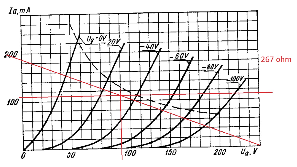

Hey All, thanks again for all the help! It's made the early planning stage much easier. The biggest change is a lateral shift in output tube. This morning I bought four Winged 'C' 6N13S tubes. They were also billed as 6AS7's but they aren't really the same. They seem to be an improvement. The grid voltage is only -30 volts so they should be easier to drive. And the cathode resistor is only listed as 250 ohms. I don't have an audio data sheet for this tube so if anyone has one it would be much appreciated.
I did find a schematic that listed a 2500 ohm output transformer primary with a rated power output of 10.5 watts. With four tubes I intend to run the outputs in push pull parallel. If I'm correct that would drop the plate to plate to 1250 or so and give a power output of around twenty watts.
The purpose of this amp is to build an all triode 20 watt amplifier with little or no feedback. Since triodes produce mostly even order distortion and push pull tends to cancel even order distortion that might work out well. Another target is to make the amplifier as simple as possible. Cathode bias and AC filaments, old school.

6N13S is functionally identical to a 6080 apart from its dissipation.
I would go with something like a ECC99 as a driver. With the horribly low gain of a practical 6080 valve you can expect to need to go into positive grid territory to get your target 10Watts and that will need a strong driver with a reasonably high gain, not a combination easily found in triodes. Better yet a pentode driver would suit better. A more realistics expectation is 7watts from a pair.

With these numbers you can get some 2 W (as PP) from one 6AS7G and then the output transformer should some 500 to 1k.
With planned 2.5 OPT hardly 1.5 W is possible.
So, to get the required 10 W, just 5 tubes should be put parallel😀.

> 6N13S .... grid voltage is only -30 volts
At 90V. With nearly no swing around that point.
You really want the supply to be 200V-250V. Mu is near 2 (same-as 6080), so bias and grid swing will be ~~100V (same-as 6080).

With autobias the cathode voltage is (with Up = 250 V) some 125 V.
Then a couple of volts difference between halves is insignificant.
That is my experience. I tested some 20 tubes and noticed that there is no need for bias balance adjustment (as shown on my schematic).
