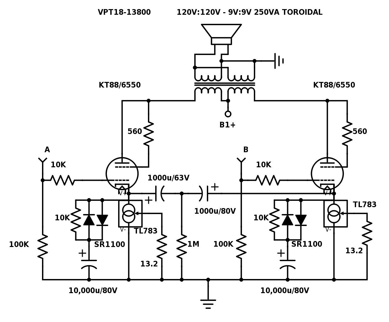

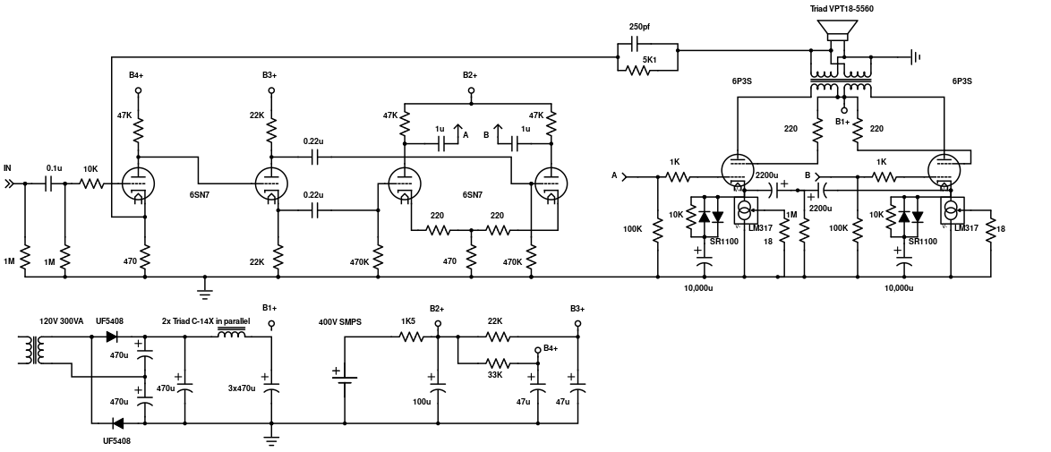

I use a Cathode CCS scheme from Broskie with a few modifications.
Here's a triode connected KT88/6550 (I'm using KT120 now) but the same applies for tetrode.
The 10,000uf cap charges up through the diode until it reaches the cathode voltage at which point the diodes are no longer biased and effectively fall out of the circuit.
If however there is a loud passage the diode will conduct and the cap can supply the extra current. Think class A with bursts of class AB.

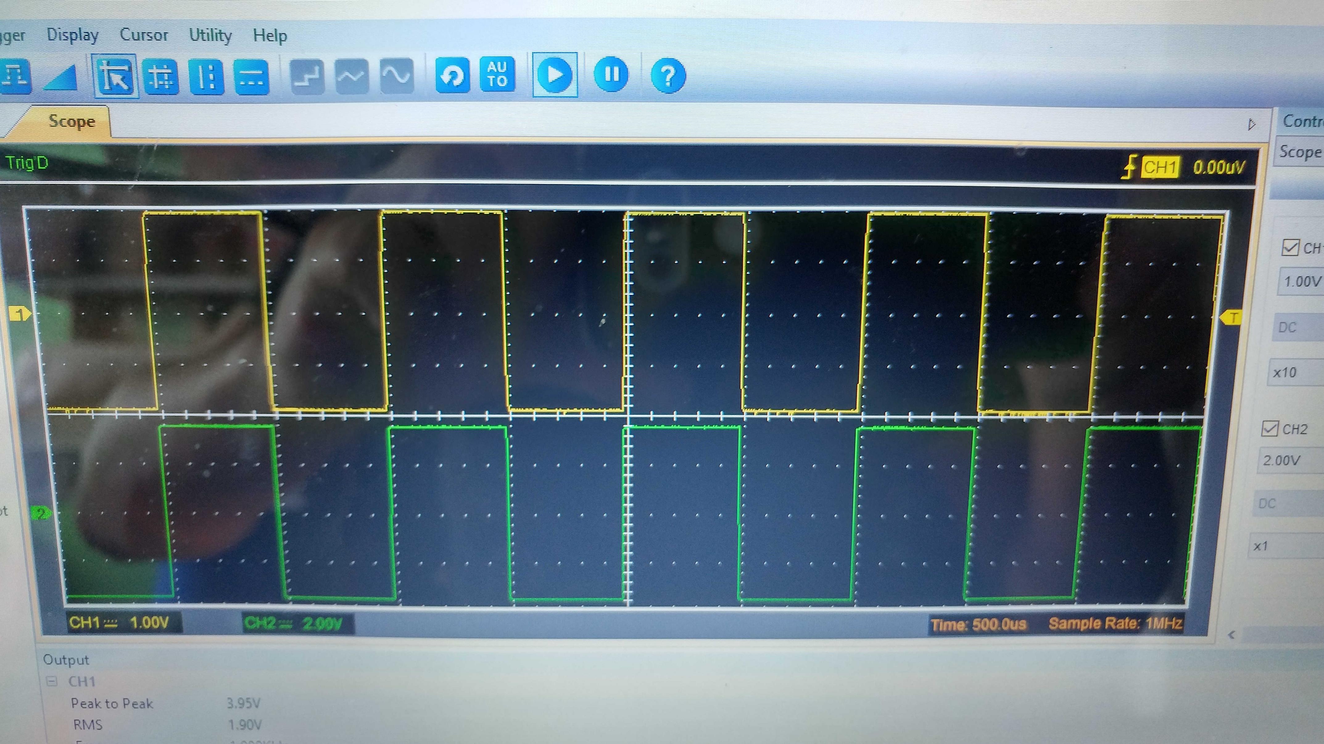

I also included a trace.
Top is DDS, bottom is amp output. 10kHz.
Yes, amazing square response indeed.

Wow! That is pretty amazing. Yes, the triode scheme is as I would expect but how do you control the screen current in tetrode connection so that it doesn't unbalance the anode current?
I didn't. The B+ is 290V G2 tied to B+ and it's biased as pure class A with LM317.

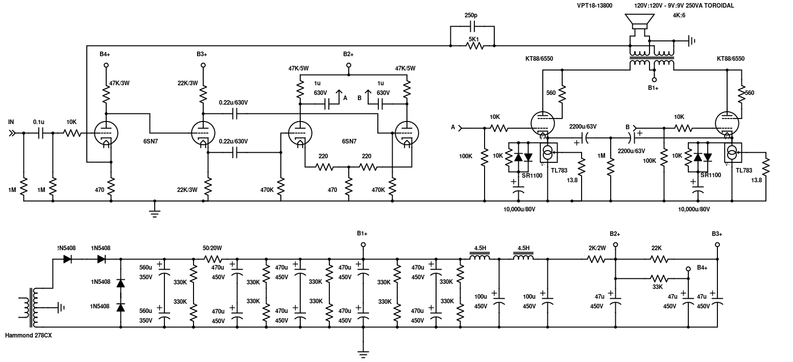

Thank you. I should mention the actual amp uses a global feedback loop.
Yes, that's the transformer. They cost me 88 CAD from digikey with free shipping. Meanwhile a suitable proper OPT is twice that. In reality the 160VA model would have been better and less money but they don't stock it.
I'll scope it at my next convenience as I'm using the bench to rebuild a power supply (SMPS overheated and failed, replacing it with a linear supply).
The heater supply in the following amp schematics is absent but I use 12V SMPS which also powers the 400V SMPS.
Cheers
I just realised I was talking about a 6P1P amp but I posted the 6P3S. Yes I know 300V@56ma exceeds the PaMax but they work fine, they cost like $1 and I like running them hot.
It's the same schematic but the current set resistor is 22R, and the transformer is a VPT12-2270 25VA. Good for about 10W.

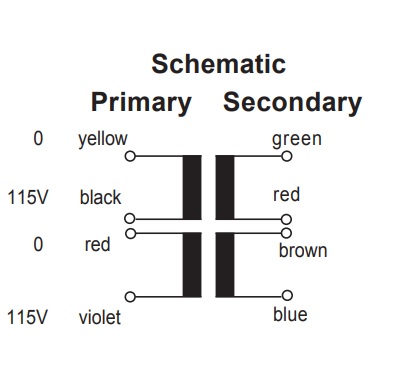

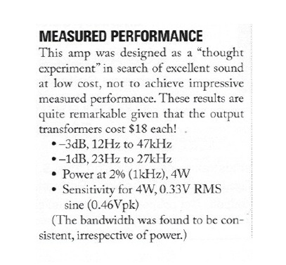

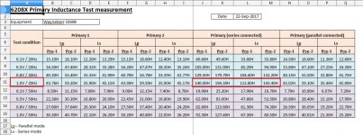

I've attached a screen capture of the Audio Express article from an earlier post in this thread. Seems pretty good to me? My intention is to use the dual primary 115/230 to 12 volts which will give me a reflected impedance of about 2.7k for an 8 ohm load.
If you look at the transformer schematics it is not wired the way I would have expected. So there is something to what Shoog mentioned about wiring them 'correctly.' Digikey wants $32.60 each for these transformers. I spoke with a guy at Talema today he said he would measure the primary inductance at 20hz
and email what the Henries are.
My friend Arlyn at Heyboer could build me a 2.5k to 8 ohm 20 watt OPT using M3 core material for about a hundred bucks each. The point is not to use an inexpensive transformer. The experiment is to see if an inexpensive transformer can be made to sound good. Besides, the toroid under the chassis will require a single hole to mount it. If they don't work out that hole will be covered by an E-I core from Heyboer above the chassis. Nothing to lose, $140 to save.

@piano3
The following data is from Triad magnetics.
"Inductance depends on the drive level and the permeability of the core (which can vary significantly). Having said that, I have reviewed some history data from various lots and here are the results.
1. VPT230-110 = 213 to 439H @ 230V, 50Hz (primaries in series). 304H average from 15 samples.
2. VPT230-220 = 192 to 444H @ 230V, 50Hz (primaries in series). 283H average from 15 samples.
3. VPT230-430 = 93 to 214 @ 230V, 50Hz (primaries in series). 128H average from 15 samples."

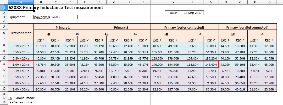

This is what Talema sent me. From my small experience designing a pair of interstage transformers, (with help) The primary inductance at 20 hz is what you have to shoot for. So I asked them to test it at 20hz. This seems a lot better than 2 Henries. If I understand this correctly I'm interested in series connected series mode?
Anyone know what they mean by series mode?
Too bad they didn't test it at a higher voltage, say 100V.
Without any DC current through the primary will that really matter?
Below 50hz these transformers will likely suffer significant core saturation with elevated voltages. Piltron audio OT are generally about 4x as big as power transformers of similar power rating - this is because the core has been enlarged to sustain the large magnetic fluxes they are subjected to in the 10-50hz range.
So I think it will make quite a significant difference whether these transformers are tested at 1v or 100v since at one volt the core will be carrying a lot less flux than at 100v.
This is the underlying logic of my 4x rule of VA rating to Wattage output - but its still probably not enough.
