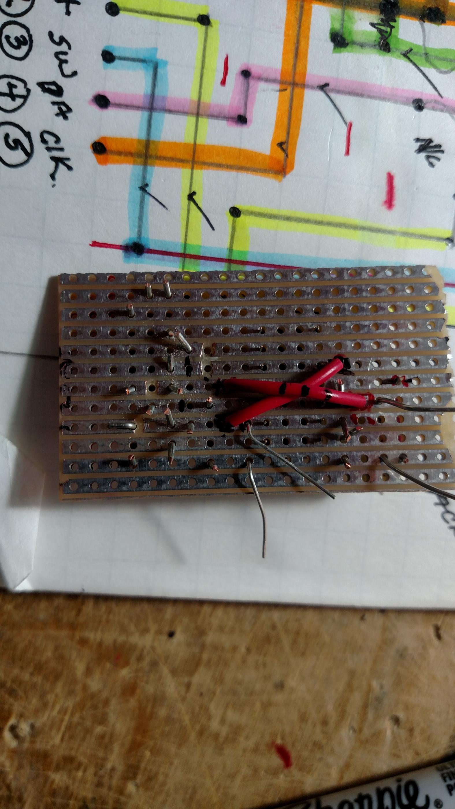

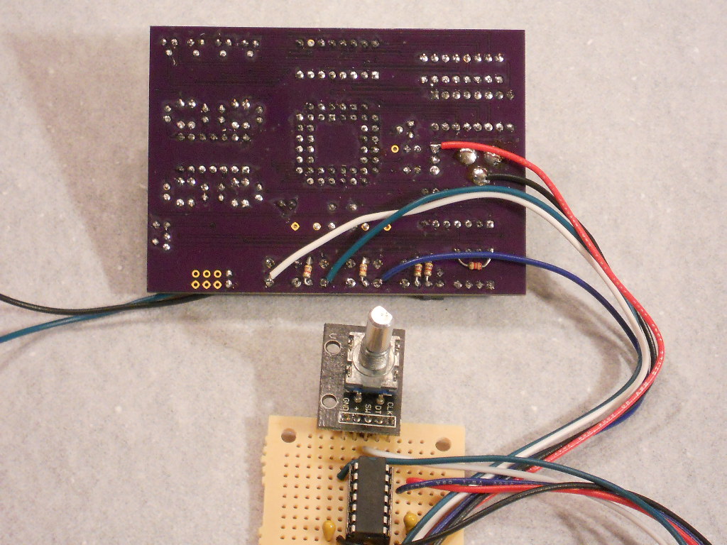

Here is some pictures which may help you out. I built 3 rotary switches 1st one worked 2+3 did not. I may have smoked the chip or there could of been shorting on some of the joints. Who knows without a scope hard to really see the whole picture. The moral of the story for me was use the schematic Pyramid has posted in the thread and use thru hole stuff.
I posted a picture of my version which might save you some set up time. I used the boards which have the rows connected in one direction. Then I used solid 20 gauge wire to bridge the rows and a demel tool with small bit cuts the connected rows. You can scrape it also. The board will be about twice as big but you can see what you are doing and what has been done. I also threw in a picture of a cheap magnifier if you do not have one. Even thru hole stuff when double checking joints is not that large.

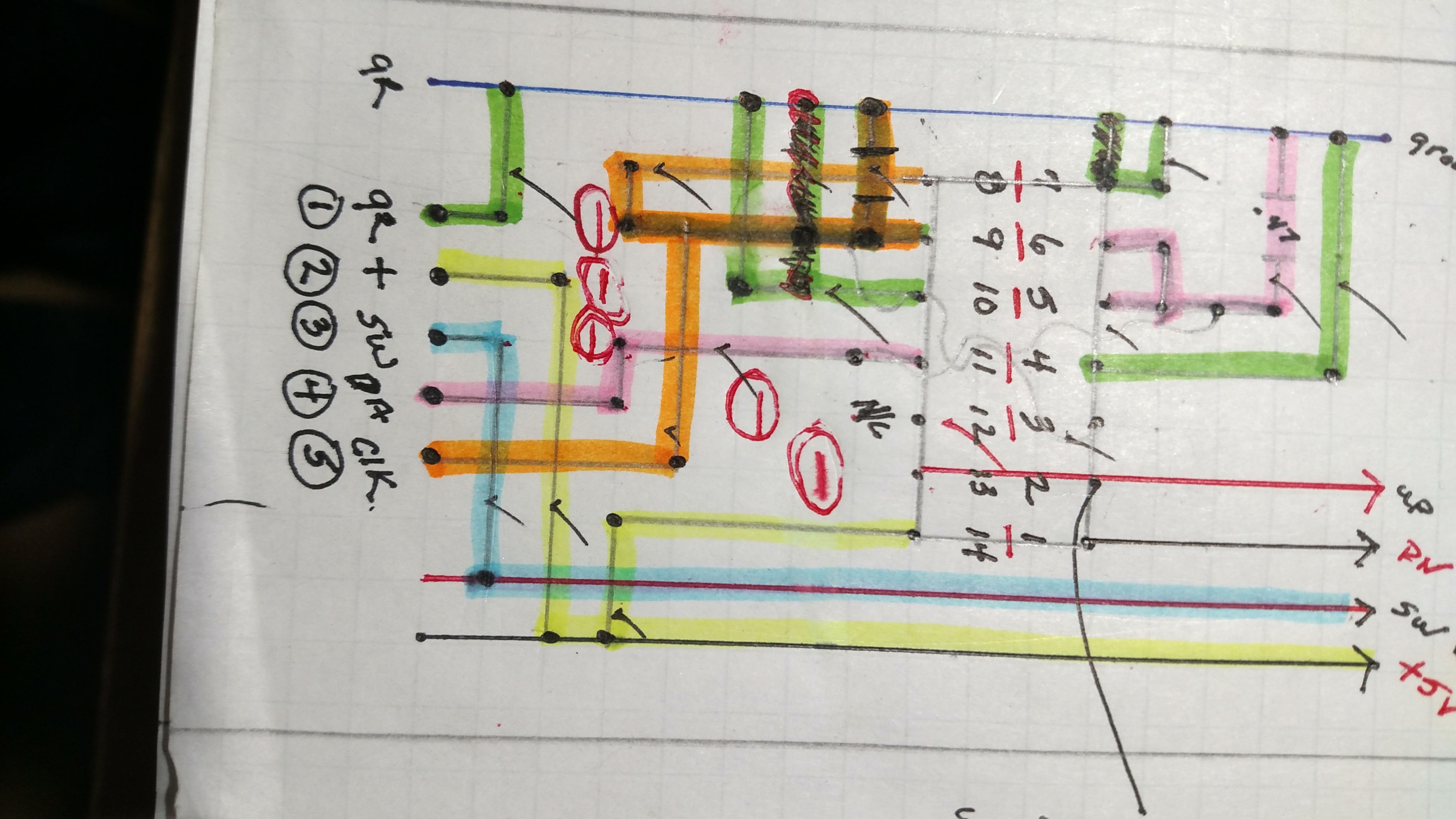

I realize the schematic I did was done for myself and not for instruction help. It may give you a idea of what is involved.

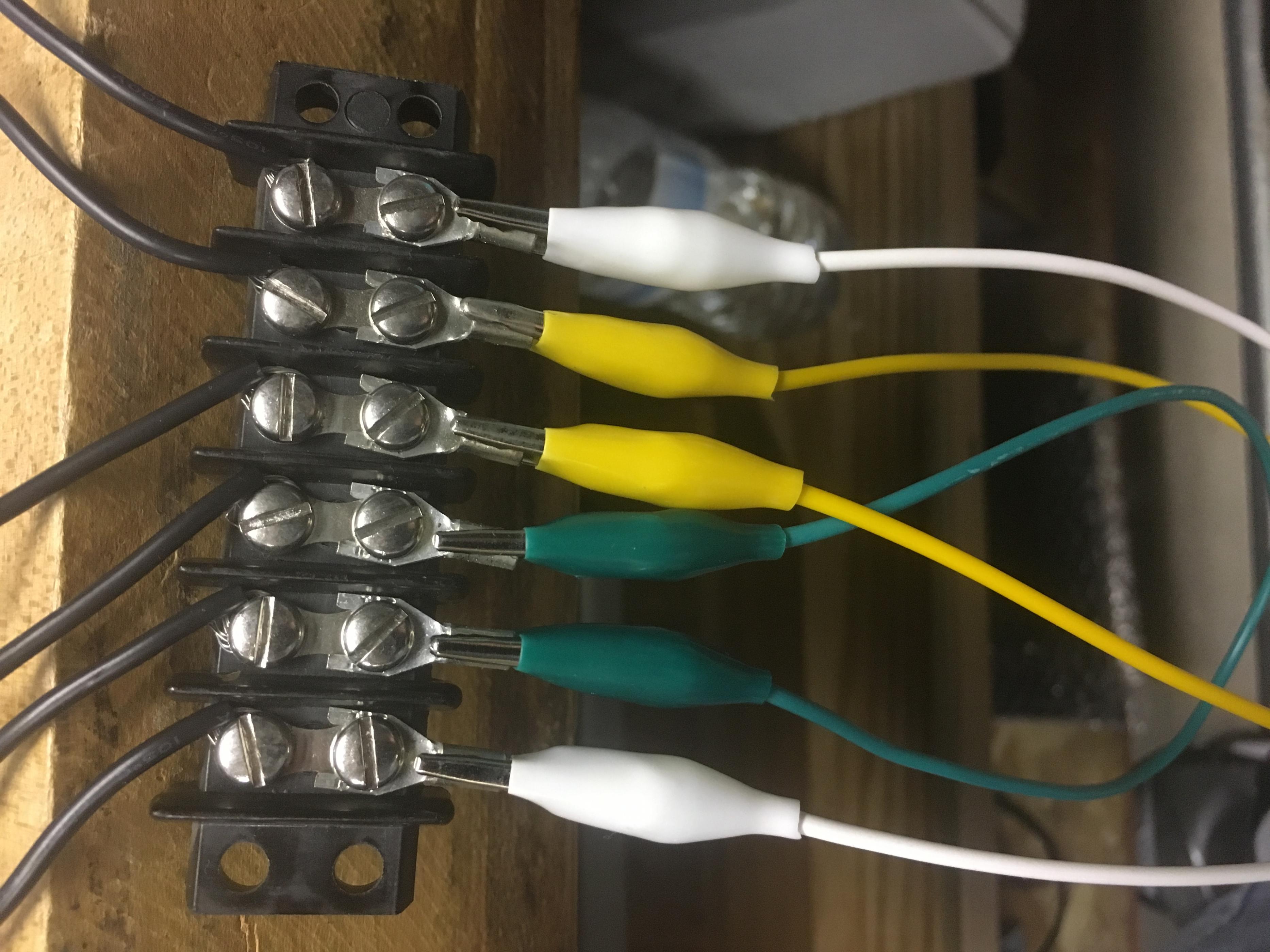

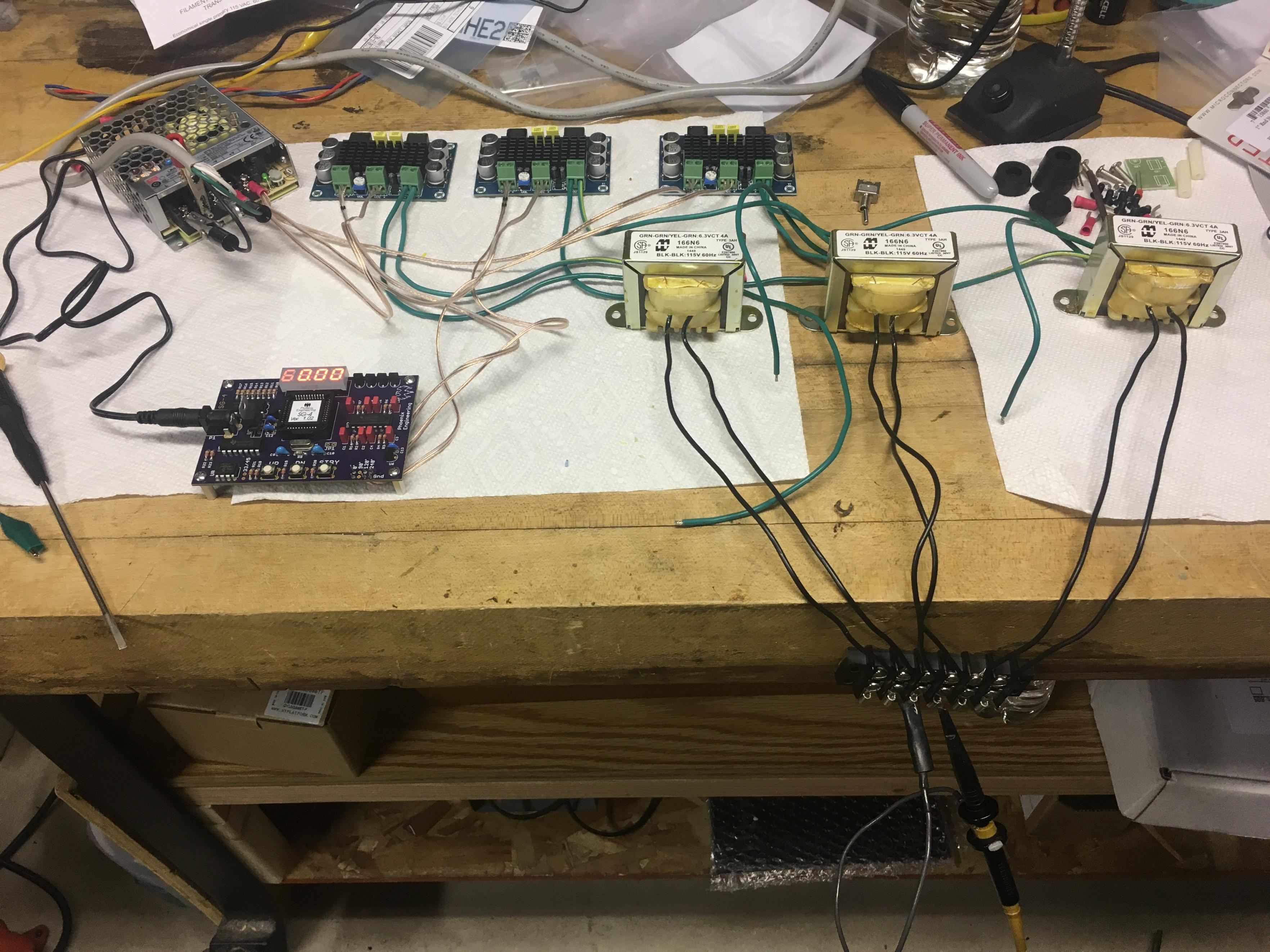

I'm also going down the three phase hookup route and so far I have one out of two configurations work for me. Delta and Star and the Delta with my testing setup is working fine so far with amps getting and staying around 120f degrees.

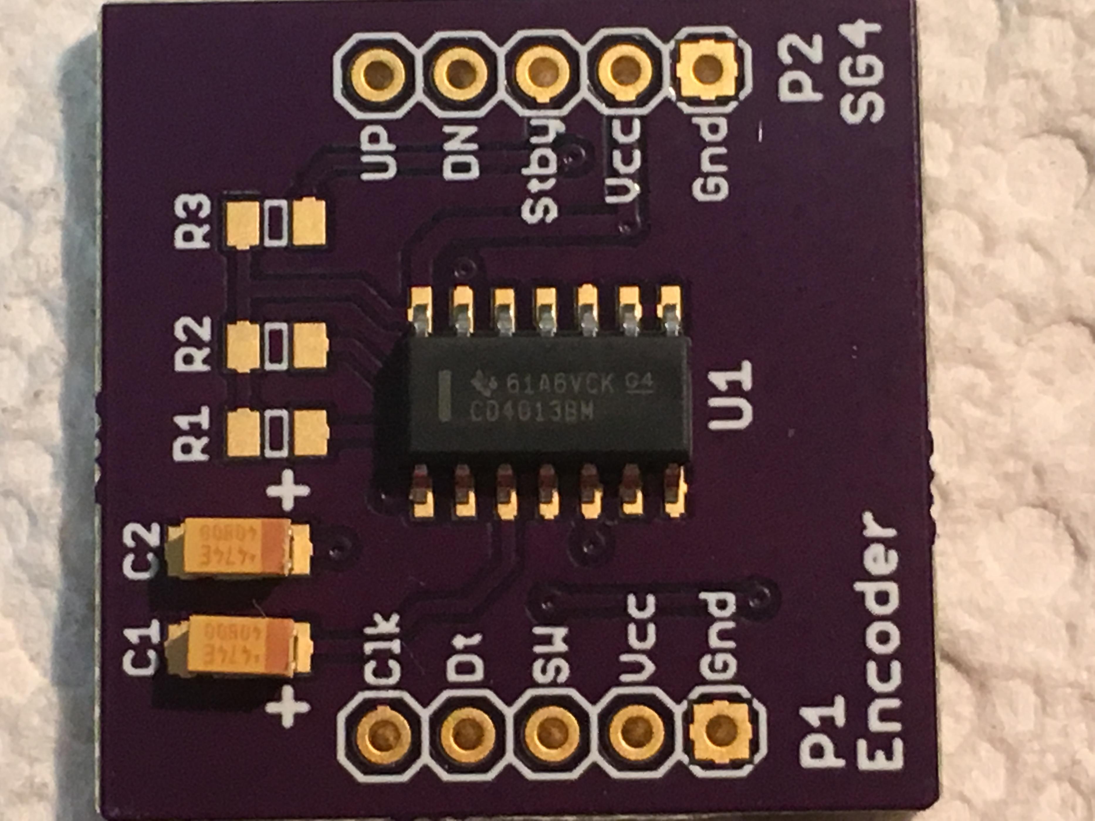

So apparently I have the Chinese version of the Texas Instruments IC.
It only has a printed bar across the body at one end for a reference for mounting.
Is this the O end?
Sorry to ask what I am sure is a stupid question, tried to find some info on the web first and everything I found, they referenced a dimple or dot.
Pin 1 of the chip is the lower left corner (pin) of you pic. On the PCB, pin 1 is denoted by the circle in the silk screen.
As Tom indicated, the line on the caps denotes the positive end.

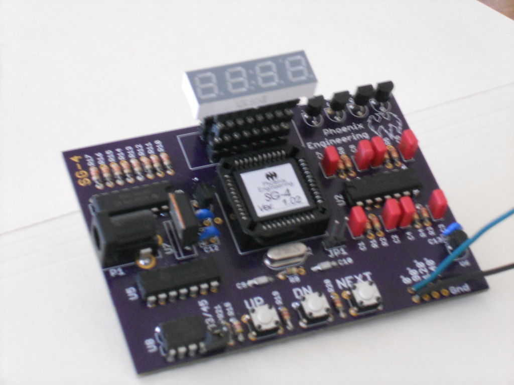

I'm going to solder my second control board up shortly and I laid the parts out.

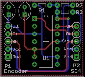

For those that do not want to mess with SMT components, I redid the PCB in thru-hole parts. The board width increased by 0.1". The tantalum caps are 2.5mm lead spacing and the resistors are 1/8W (Mouser PN 299-10KRC).
The OshPark Link is: [url]https://www.oshpark.com/shared_projects/W6QWOCOF[/URL]

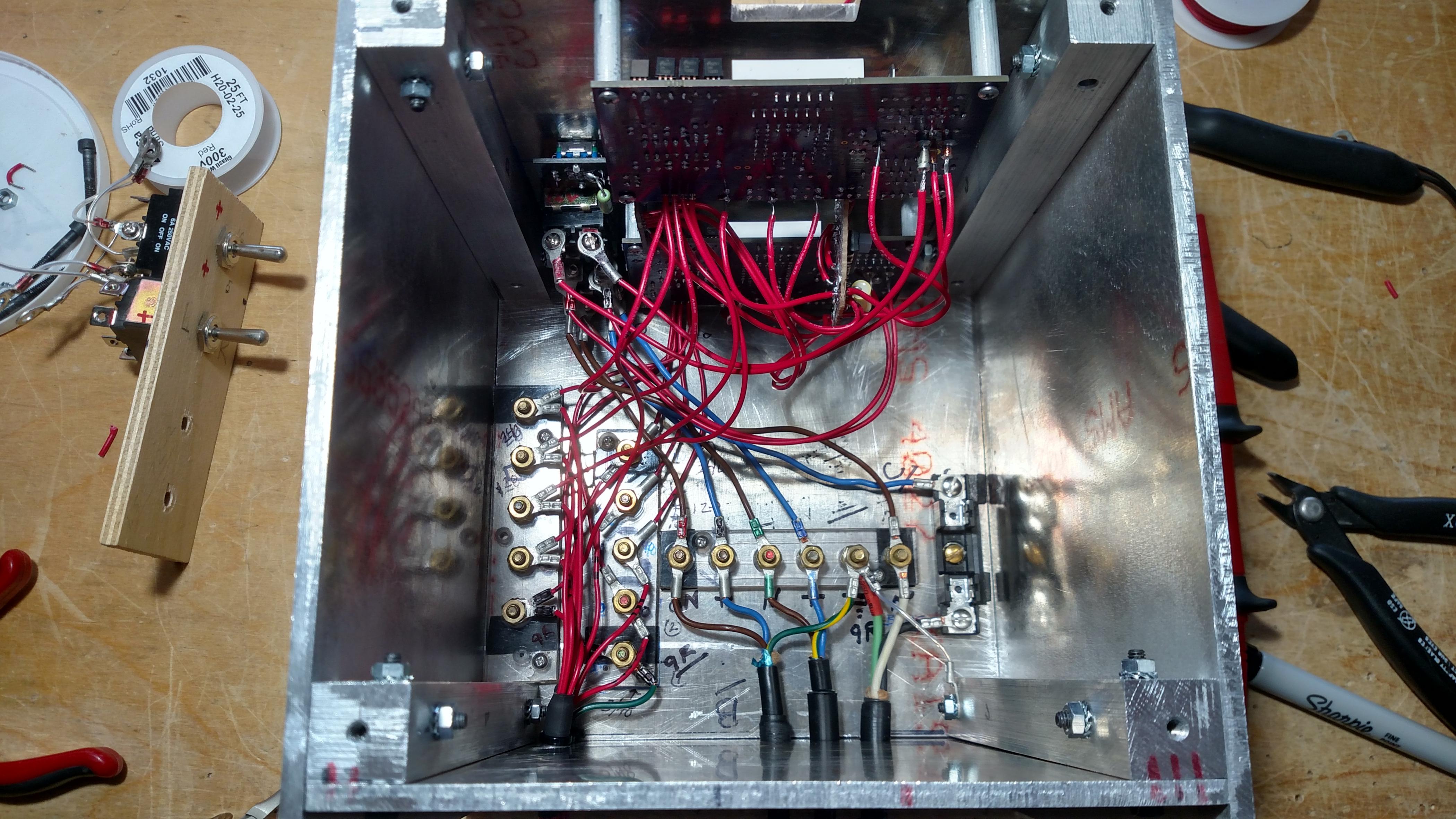

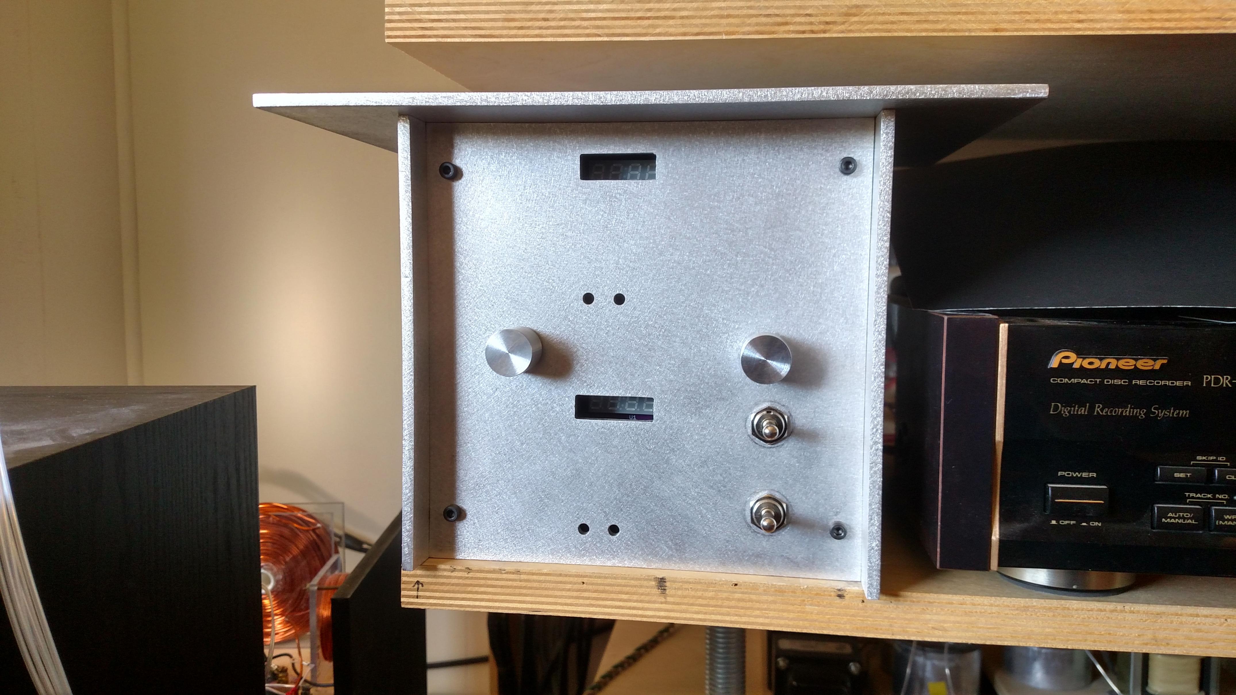

Bill you are making this way to easy!!! Everyone must suffer a little before they have a nice one button control. OK I must admit I just ordered 3 have the parts for one more complete unit. I put a picture of 2 sg4 units in a remote case. I was hurting for space in the front of the rack so I built 2 Sg4 in a high rise like NY city. Now I can put the two different amp/etc units in back to drive the two turntables. One advantage is if I change motors and need another supply just a few wire changes and I am ready to go. I also kept the boards stock just machined opening to see displays and the holes to put a rod thru to change phase and voltage. Like you said how many times are you going to change the phase or running voltage.

That pic is from my 1st prototype PCB and the resistor was added to make the E²PROM work correctly. It is R22 on your version of the PCB. Likewise, all the other resistors are R18-R21 on the final board.
You should not have any additional components on the bottom of the PCB. If you stuff the board properly, everything will work correctly.
