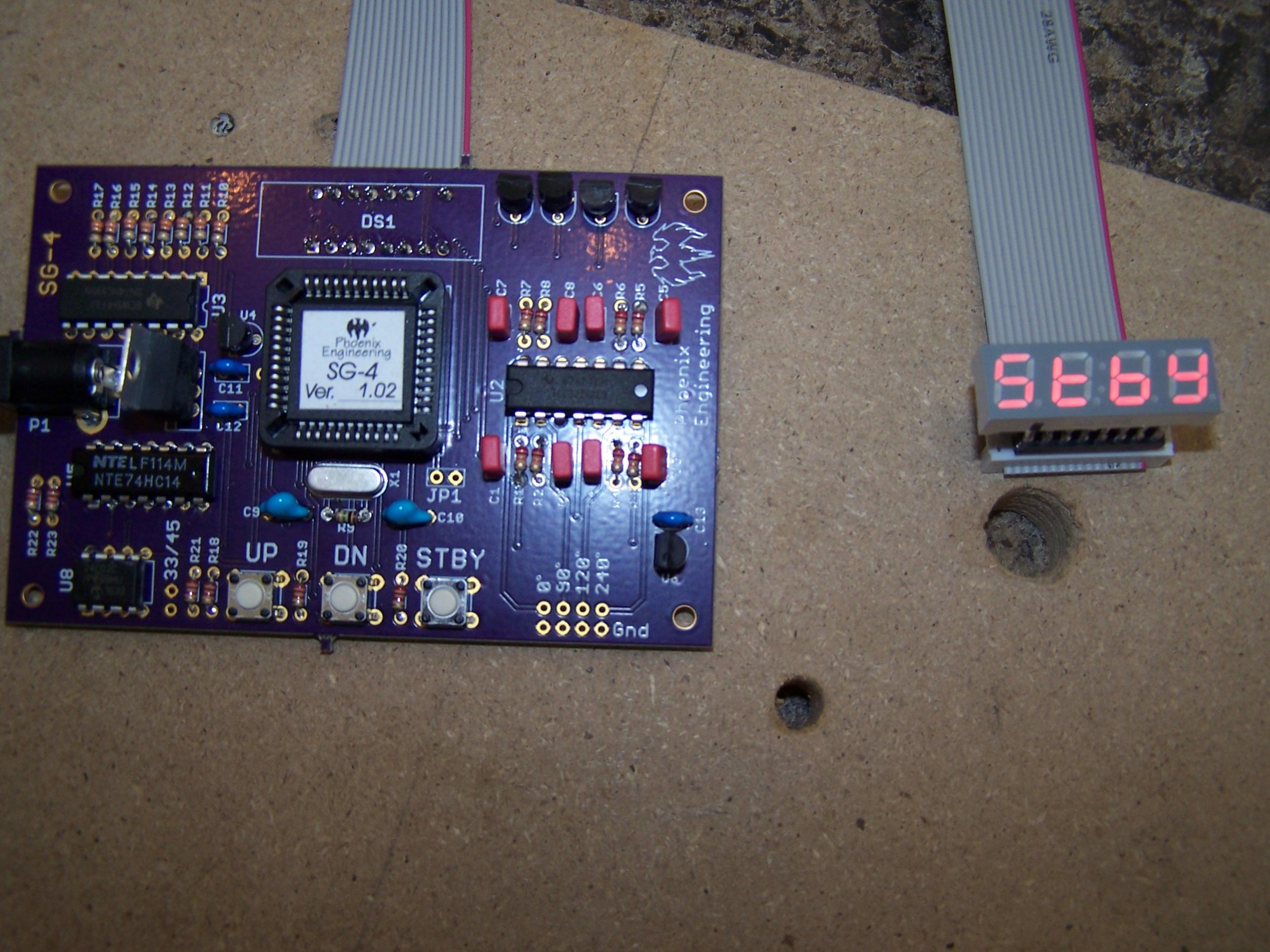

Finally got a board done and decided to light it up.
So sure that I paid every attention to part orientation and detail that I would have a working board.
I was so confident in myself, that I even decided that I could plug in the SG4 chip.
So, it did not work, surprise right?
So then I decided maybe you should follow instructions and do the voltage checks in the instructions.
Pulled out the volt meter and guess what, the battery is weak.
I live out in a rural area, so the closest store is a Quik Trip.
After a 8 mile drive to get a new battery, I can see by my measurements something is REALLY wrong.
Looking over my board with a magnifying glass, I had the U5 chip 180 out, sweet.
So my question is, do I have anything salvageable, or did I blow the whole project.

U5 is almost certainly toast, but everything else should be OK (provided nothing else is installed incorrectly). If you replace U5, everything should be OK.
Thanks, Everything else is correct.
I removed the U5 chip and have the correct voltage on pin 16 of U3.
