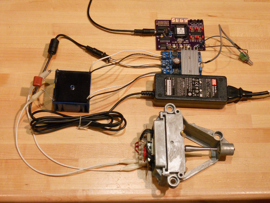

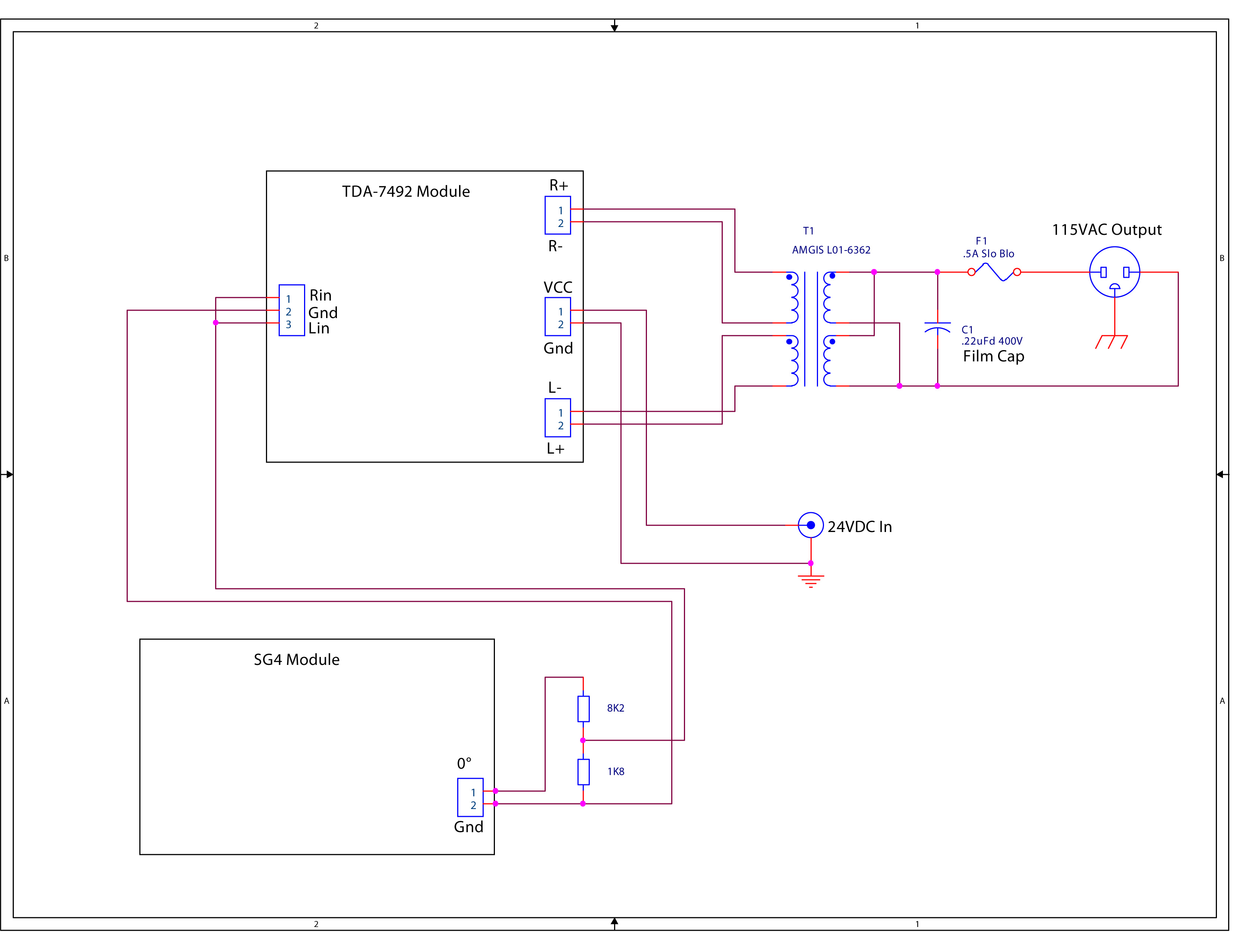

I received the TDA7492 Class D amp from e-Bay yesterday:
TDA-7492 50WPC Class D Amp
The PCB is 3" x 2.5", about the same size as the SG4. I connected the outputs to an Amgis L01-6362 12V toroid transformer and powered the amp using a GST60A24 24VDC 60W wall adapter. To drive the toroid output to 120VAC no load, you will need to reduce the output of the SG4 to 920mVPP using a pot or a fixed voltage divider of 8.2K and 1.8K resistors.
Below are the schematics for single phase 115 and 230VAC outputs as well as a picture of the supply powering a 19W Lenco motor. The TDA-7492 PCB comes with its own heat sink, and because it is Class D, requires no additional heatsinking (the temp topped out at ~100°F after 1 hour.
The amp was $10, the wall adapter to power it was $18 and the toroid is $25.
Be sure to observe the polarity markings on the transformer and the TDA-7492 outputs.
