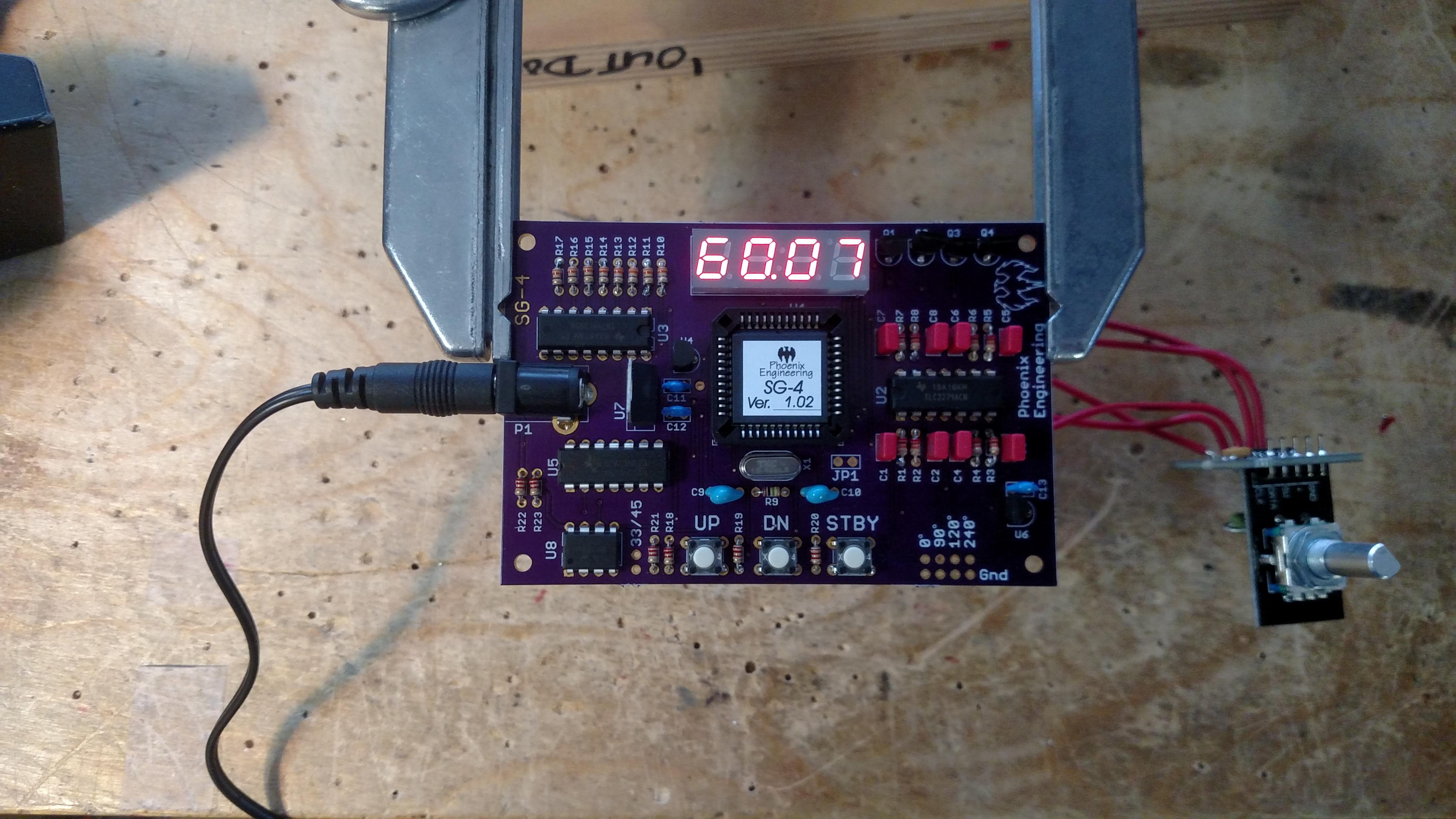

Houston we have lift off!!! Got the rotary switch on the Sg4 and it works like a champ. Push the button goes to 60 Hz turn nob goes up or down. What is really cool is when you turn it off it saves what ever frequency you had on the screen. This is not Bills 1st rodeo.
Well still have to hook up to my current power generator and build an enclosure but what cool set up this Sg4, with the rotary switch, is.

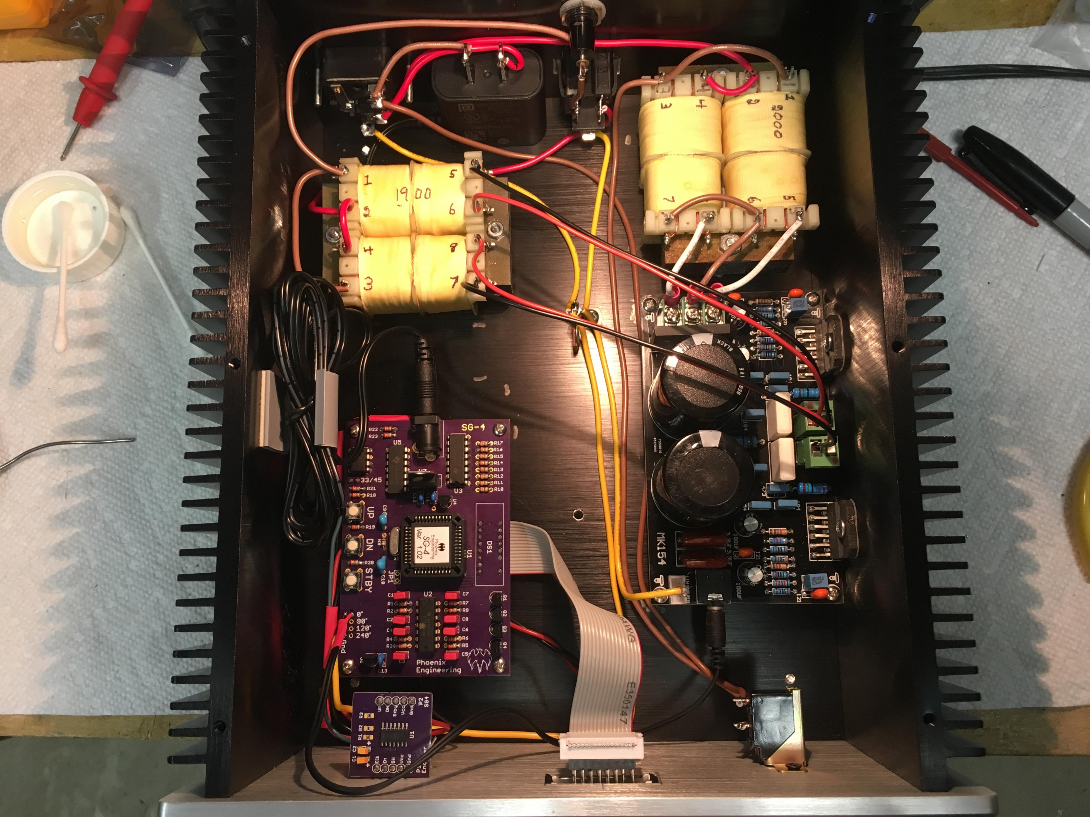

This is the finished motor controller using the SG4 sinewave generator, LM3886 based MK-154 stereo amp, 2904 enclosure and rotary encoder switch. The 2904 enclosure comes with the mounting holes for the on-off switch and the main control knob so only the display window and toggle switch for 33/45 RPM was added to the front panel. The back panel of the enclosure comes with an IEC input socket with built in fuse holder, so only the NEMA 5-15 output connected was added to the back panel.
For the display window, I milled a 0.5" wide channel on the back side of the face plate. The depth was set to within 1/16" of the front surface. I then cut a 3/8" wide hole through the front panel and squared the corners with a file. This left a 1/16" wide lip to glue a plexiglass window into the face plate from the back side. The LED display would then be glued onto the window.
In order to remotely mount the LED, I soldered a 16 pin socket onto the LED pins as shown in the picture below. I also soldered a 16 pin socket onto the BACK side of the SG4 and connected the display to the SG4 using a 16 conductor ribbon cable with IDC connectors. In order to get pin 1 of the display to connect to pin 1 on the SG4, the cable needs to have IDC connectors mounted on OPPOSING sides at each end as shown in the picture below. The cable must attach to the BACK side of the SG4 and when plugged into the socket on LED display, the cable will exit to the top as shown below.
The MK-154 amp was mounted to the bottom plate using 1/2" stand-offs and the two LM3886 amps are attached to the heatsink as shown. The tabs of the amps are isolated, so no mica spacers are needed. Mount the amp to the bottom plate and mark where the holes in the LM3886 tabs meet the heat sink. Drill and tap holes for 4-40 screws into the heat sink for mounting the LM3886 tabs.
The transformers are mounted to the bottom plate of the enclosure and are connected as shown in the OP of this thread for 115VAC input/output single phase.
The rotary encoder and PCB are mounted in the main control knob opening and are wired to the SG4 as shown in the post on the first page of this thread.
I powered the SG4 from the wall adapter that is specified in the parts kit. I soldered wires from the input transformer primary to the wall adapter plug. The controller did not work properly if powered from the 18VDC on the MK-154 amplifier PCB as the start up surge cause the voltage to drop enough to put the SG4 into reset which caused another surge and the system was stuck in an endless loop. If you power the SG4 from the amplifier board, ensure the power supply to the SG4 is decoupled and filtered to prevent this.
Two wires connect the 33/45 RPM SPST toggle switch to the SG4.
There is a video of the completed controller Here.

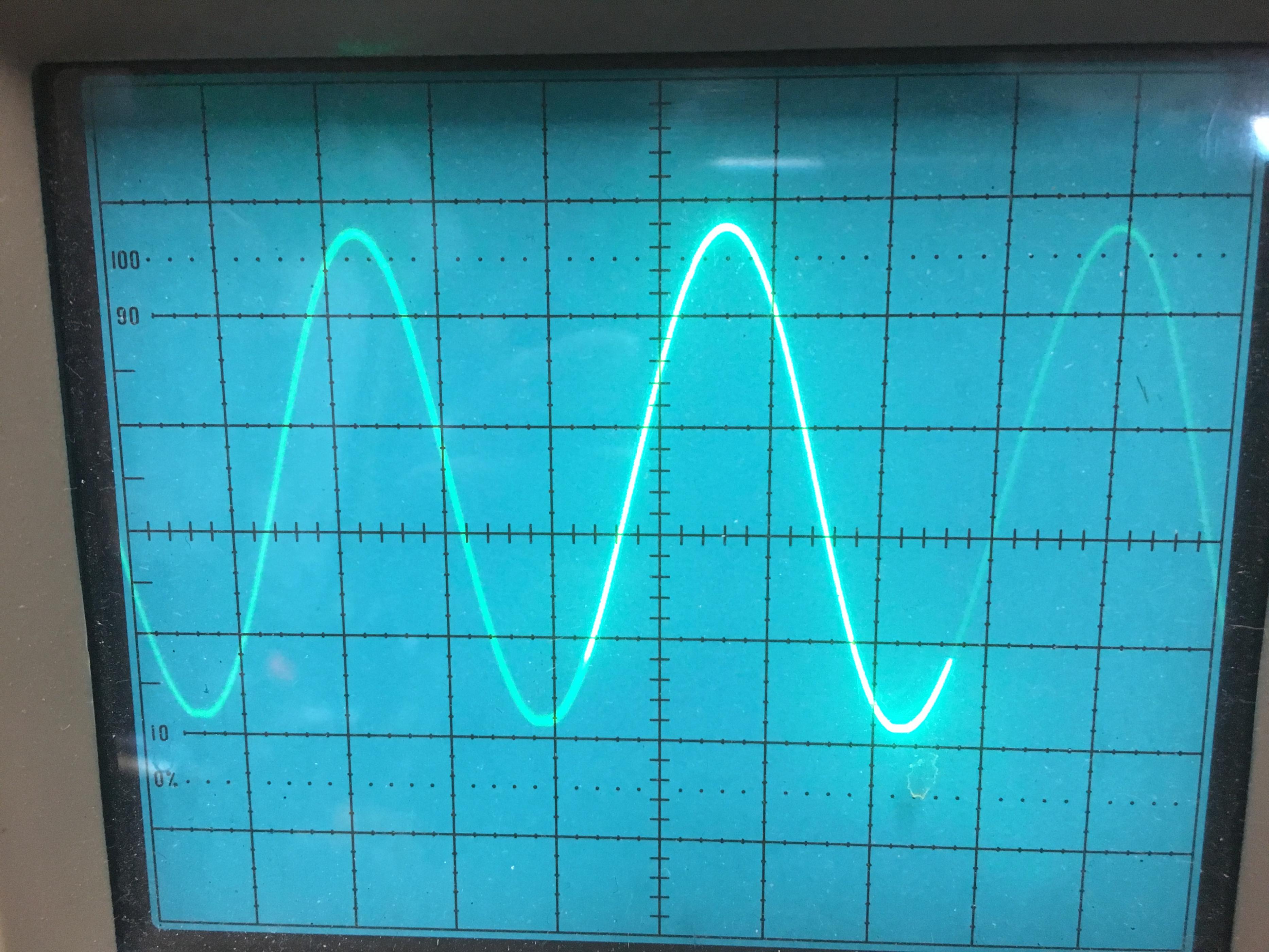

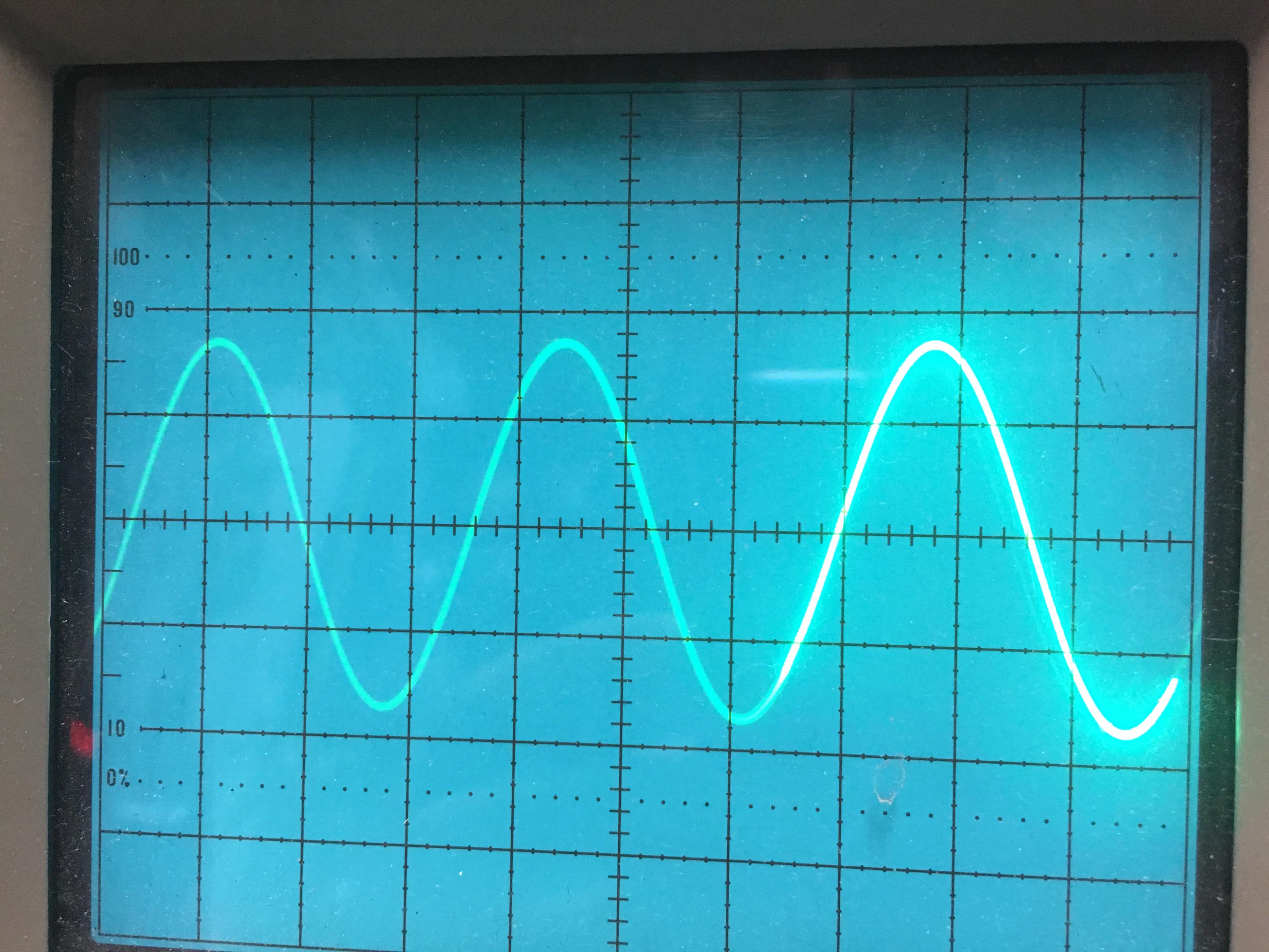

Ok just uploaded 3 pictures. The two from the scope are one from the SG4 going to the amplifier and the other is from the output of the amplifier to step up transformer.
