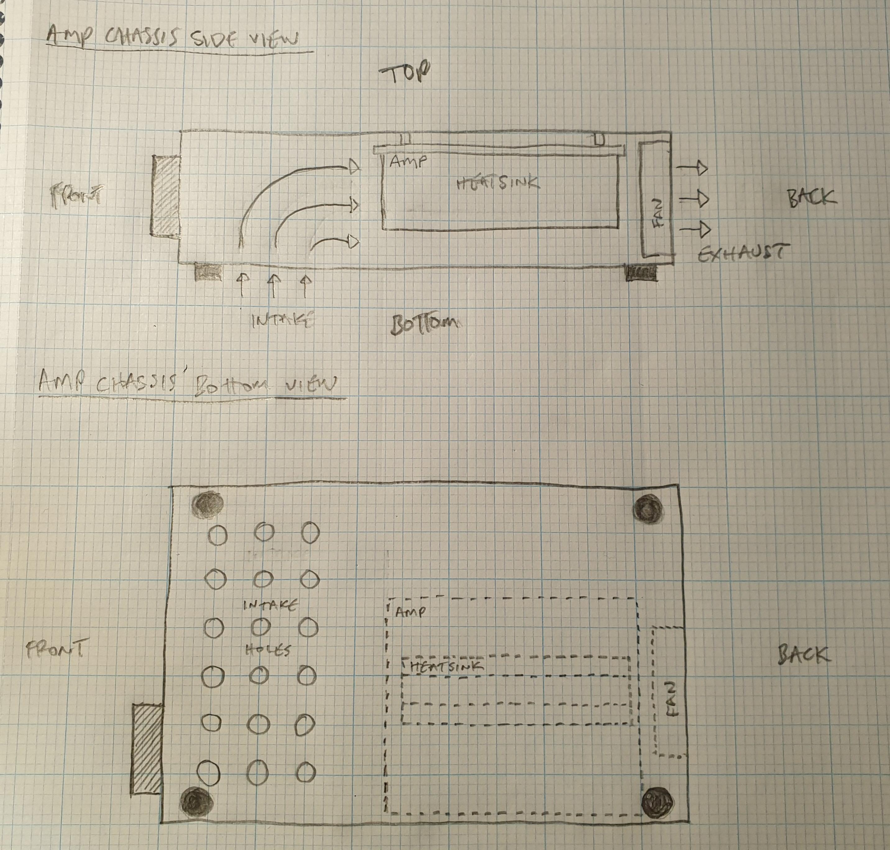

My plan for the forced convection cooling system is this:
The board in the previous post is actually the wrong way up during development and assembly. It will in fact be the roof of the enclosure/chassis and there will be intake holes on the bottom of the enclosure toward the front. This will force moving air over the warm DC-DC isolators and down the fins of the heatsink then out the back.
I hope I won't need a terrific amount of fan speed to do this and will be putting a 1w trim pot in line with the fan voltage to vary this.
It might even be a good idea to investigate channeling the air flow a la the Behringer iNuke fan hood which I tore off. Second picture attached. Maybe this is overkill, though?
This sketch was done on my lap on my sofa, I hope it is clear! Coupled with the image above I am sure you can get the idea. Any feedback welcome

I have used 3116 and 7498e for preconditioning of woofers. Even with a lot of constant cone movement, these amps did not even get warm. The SMPS were just as cool.
I think, if we try to be objective, there is no need for special cooling devices, fan´s and stuff. Seems like DIYS over engineering. Be more practical, maybe connect speakers or load resistors and let it work hard for an hour, than use your finger or an IR thermometer.
Some holes in the bottom, a little escape at the top, and all is "tres chic".
Cheers, I take your point and you may be right but here are my reasons.
24v with six 4ohm drivers
Four tpa3116 chips
Undersized heat sink
9mm mdf/ply box
I think I may be going over the top but I can always disable the fan if not needed or turn it way down.
Sounds a bit like I'm patching up a problem that should have been dealt with earlier but its all a learning curve!
Four tpa3116 chips
9mm mdf/ply box

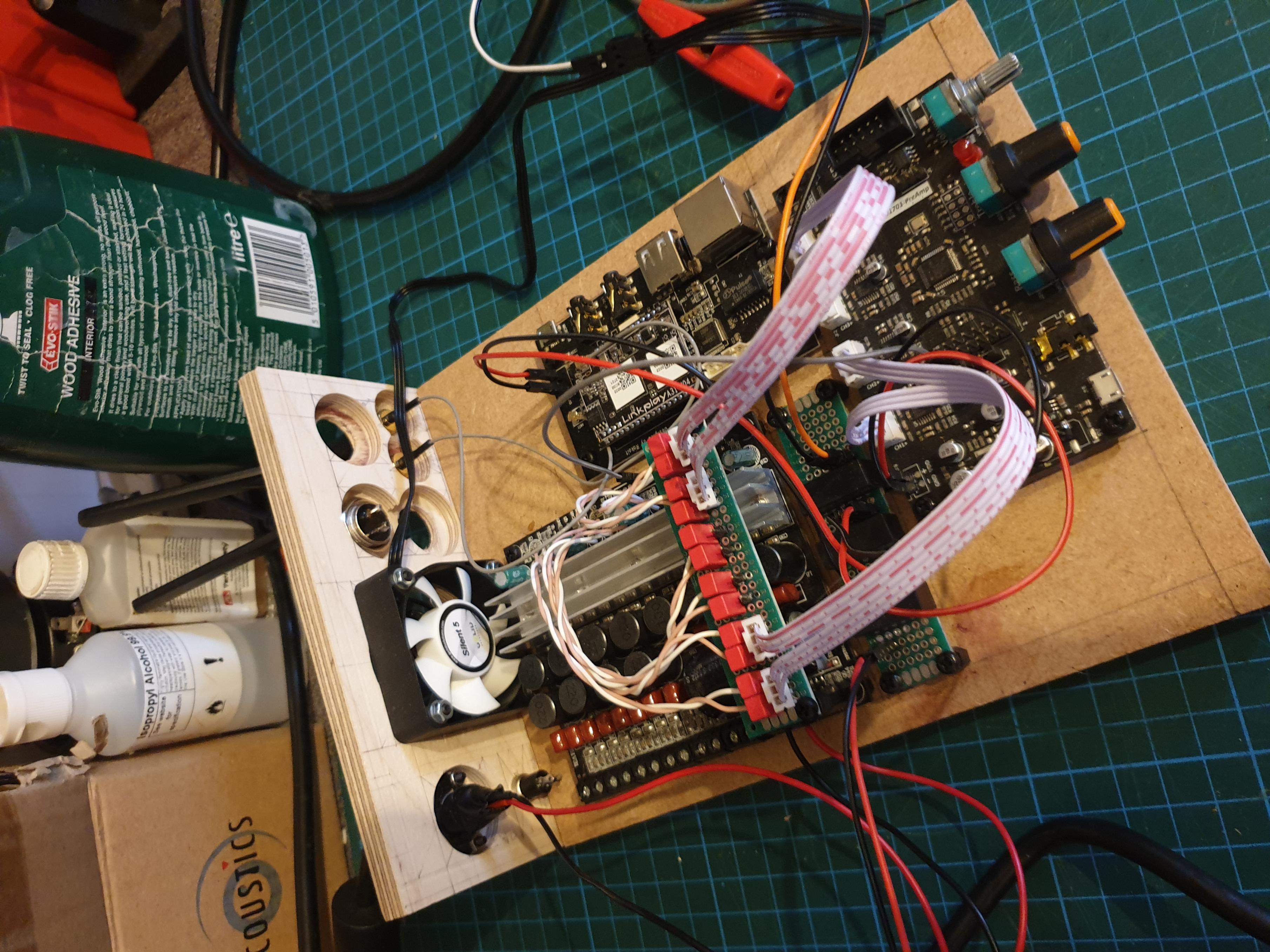

Joy / Disaster
A weird days work...
It started off going great, I installed the fuses for the DC-DC isolators with a little fuse daughter-board and soldered and set up the DAC to output a mono balanced signal and daisy chained to both inputs of the BTL chips. Everything worked a treat!
DISASTER...
Now I had it all fused up I left it on with one speaker driver connected to the main master chip and went to do some shopping with the old ball and chain for a couple of hours.
When I got back the heat sink was unusually hot considering no load and after a few minutes of admiring my handy work I connected a second driver to the master chip (so the master chip was outputting on both channels) and then all of a sudden it started outputting DC in a pulse to one speaker. The speaker that was connected whilst I was out was pulsing, the other not.
The slave chips seem to be OK and function. The master chip returns to functioning after a while of being disconnected but returns to pulsing.
Any thoughts on the cause?
DISASTER...
Options...
So, I have a few:
- Order a new board and hope it was the running of the chip with only one driver attached that fried it and not do that again.
- Attempt (again) to get a handful of my TPA3118/3116 stash boards to work together in master/slave modes.
- Try a different TPA3116 5.1 board.
- Tell my friend I don't know what she is talking about and that I never said I would make her a sound system and move to the South Pole.

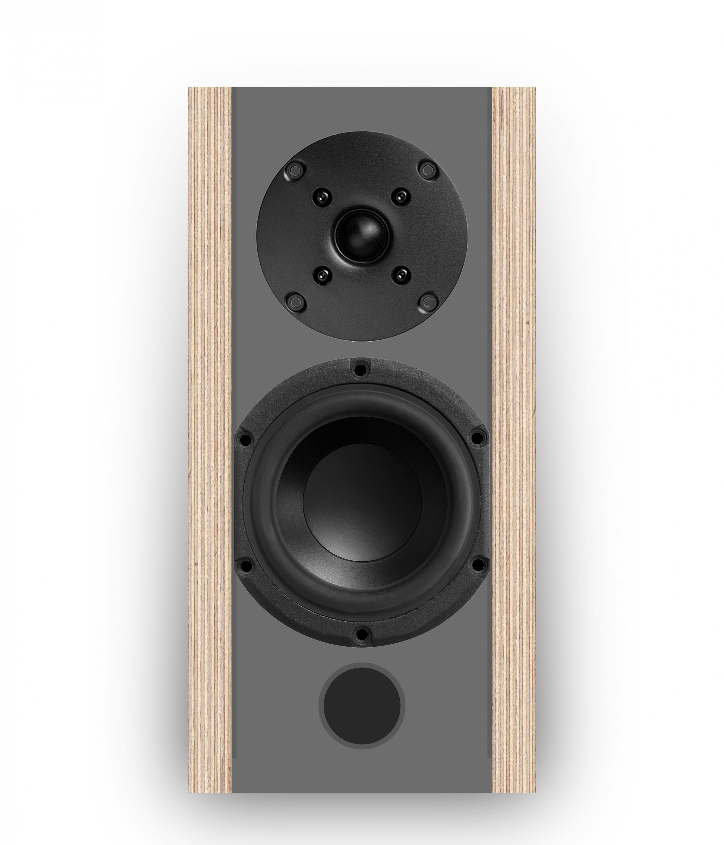

Progress is being made! Almost done with the satellite cabinets, I just need to bevel the front vertical corners, cut some tubes and mount things.
Drivers going in will be:
SB Acoustics SB19ST-C000-4 Tweeter
https://www.falconacoustics.co.uk/downloads/SBA/SB19ST-C000-4.pdf
Peerless HDS-P830870 Mid-Woofer
Peerless by Tymphany HDS-P830870 - 4" Woofer
They look to be a good match. The slim baffle (aesthetics first in this build) gives a 3k baffle diffraction so I need to cross above or below that. The SB19 has some great specs, I might try and a very high order HPF at 2k (LR48 or build a higher filter in Sigma Studio)
Not sure if I should make a dedicated thread for the crossover design of them? Anyway, onward...

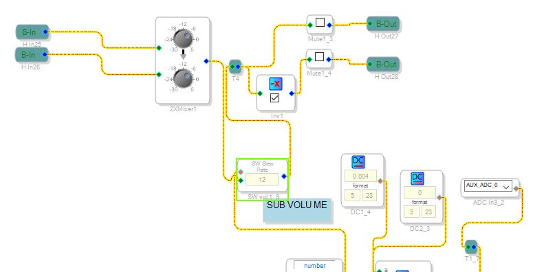

Hi Guys!
So, I am still going with this. I got hacked off for a while and then recently came back to it!
I have run in to problem tho and I wonder if anyone could advise, please?
All is up and running, crossover, volume, DAC etc. The problem is with the DAC output though. It has intermitant clicks/pops when the volume of the DSP board is turned up.
I have done all checks I can possibly think of including changing PSU to the amp, DSP and DAC. I have swapped coupling caps and I have chased it down to coming from the DAC as it is present when the DAC output goes to other amp channels not just the sub channel. I have tried a blank sigma project with low data load, no dice.
The set up is 3E DSP board with 4 outputs going to amp and then the 3E board is also outputting data to a PCM5102 DAC (as Ed very kindly outlined here). The popping starts immediately rather than in increased volume so that suggests to me that it is a data issue.
The stereo DAC is set up so it is outputting mono to both channels but one is inverted to create a balanced signal to go to the sub portion of the amp. The outputs are then parralelled to each of the 2 sub amp inputs. I have attached images and the project file.
Can anyone suggest a reason why ths might be happening? I am so close to finishing!

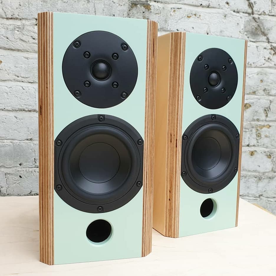

Satellites done.
I missed this when it was posted, but these look superb, well done.
What is the finish on the central MDF panel?
Are the ports just holes, or is there a length of tube behind?
Cheers man.
The whole speaker was first coated in a couple of coats of Rustoluem Crystal Clear satin then an acrylic colour over the top of the MDF sections then several more coats of crystal clear. over everything. I know the paint isn't very strong but I have used the crystal clear on my coffee table that has taken a pounding over the past two years and it is doing well.
The port is tuned to around 90hz I think so quite short but it looks shallow because i use PVC pipe into a forstner bit cut hole behind the port front, does that make sense? The port fits in snugly to the baffle from behind.
