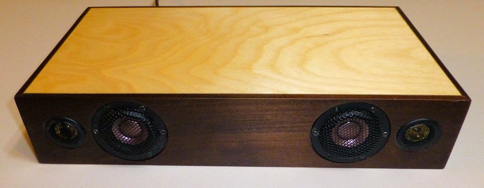

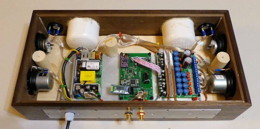

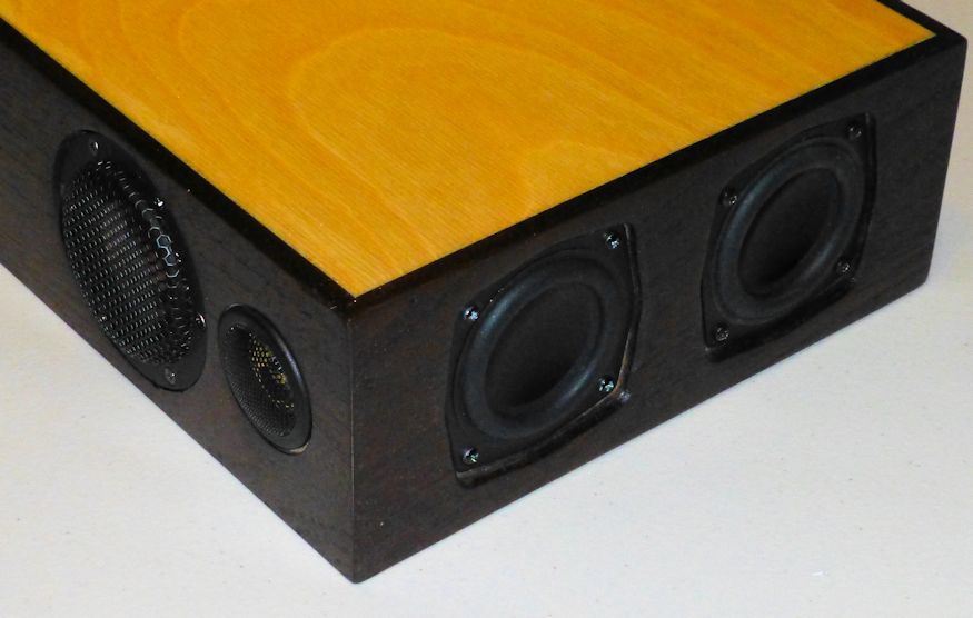

Here is a mostly completed project with that board. It's a computer monitor stand, so it's intended for very near-field listening, with small (2-1/2") subs and PR's on either side. That amp has enough power to fill up a room--it's perfect with a stereo 3-way DSP board.
Nice build! I would like to make something almost exactly like that with the birch ply I will be using for the speakers.
Do you have any issues with noise? What do you do about grounding and safety with regards to the power supply?

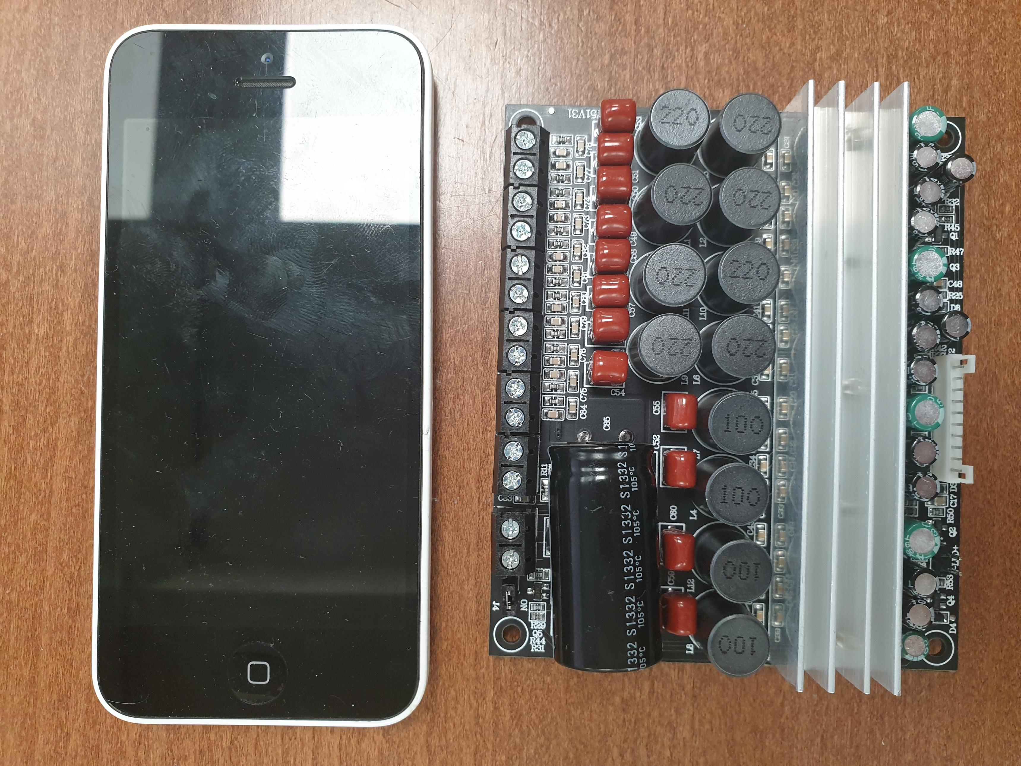

I would like to have a go at that 3 way board but I am an SMD novice.
As the parts for this build start to come in from the East et al, I am starting to think about how to go about things.
In previous builds where I have used balanced inputs to the chip via a 1uf cap. I then soldered flying leads to the cap on the board. This was a pain in the neck as they aren't easily soldered/resoldered.
So, my plan is solder cables to the +&- of the board inputs and run these to a prototype board daughter board where I can use through-hole caps and connect/disconnect with ease.
Two questions regarding this:
1. I can't see any issues with doing this, can anybody else?
2. What caps do I need to use for optimal performance? From what I have read MKP film seems the best choice?
So many here, but which?
Polypropylene Film Capacitors | RS Components
Do they all pretty much perform the same?

Regarding noise:
1) I'm still working on grounding issues. I got a surprise by using those heat pipes to bring the heat out to the back panel and found out the heatsinks are connected to the circuit ground. I had lots of buzzing until I connected the back panel to the power cord safety ground, but now there is lots of hum whenever the amp is connected to a computer. I can make that go away by transformer-isolating the input, but I don't like that solution, so I'm still thinking about how I want to finalize the grounds.
2) The amp itself is somewhat noisy ("hiss") because the gain is set too high. I haven't looked at how the gain is configured, but I think the gain-setting resistors are under the heatsink and I don't feel like taking this thing apart right now. I bought another amp to see how the gain is set, but it won't come in for another 3 weeks or so. The gain is so high that a computer can easily overdrive the input, so I want to change the gain. Reducing the gain should lower the noise.
3) I'm not sure what you mean by "+&- of the board inputs". The board input connector only has 6 "+" inputs and one "-" connector on the original version of the board (with two bulk capacitors). The newer version of the board (with one bulk capacitor) uses a longer connector, but it still doesn't have the separate "-" inputs you need for balanced input. But you should be able to remove some of those 1uF electrolytic caps that connect the "-" input to ground, and that would give you some pads to connect to. I don't know whether using balanced inputs would make it easier to avoid shared ground problems, but it might...

Neil, perhaps I should have explained a little more explicitly.
Instead of using the single ended inputs provided I will remove the heatsink and fish out the differential/balanced input traces. Then, remove the coupling capacitors on both positive and negative inputs and solder in two flying leads for each channel that I will bring to a daughter board. This is where I will have the coupling caps which can be swapped out without me risking damaging the pads on the board every time I solder.
The balanced signals from the DSP board will not require a ground.
Yeah, I expected this board to have its gain set way too high so I will bring them all down to 20db with some surface mount resistors I have.
This combined with the balanced input should keep noise issues to a minimum.

I don't think you will need to remove the heatsink. Just remove all of those 1uF electrolytic capacitors and use the capacitor holes to make the connections to the daughter board.

It has arrived, fantastic! I expected it to be small but it is a lot smaller than I thought.
Having a little poke around it I see many of SMD resistors are of the tinier variety but I see some (which I think are the gain resistors) under the heat sink which are a little larger.
Only problem is that the heat sink seems to be bonded to the chips (bolts removed).
I thought, maybe, heating the whole board up on a radiator and seeing if it softens a bit? Thoughts anyone?
