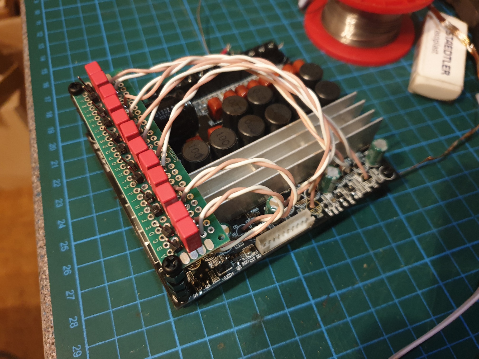

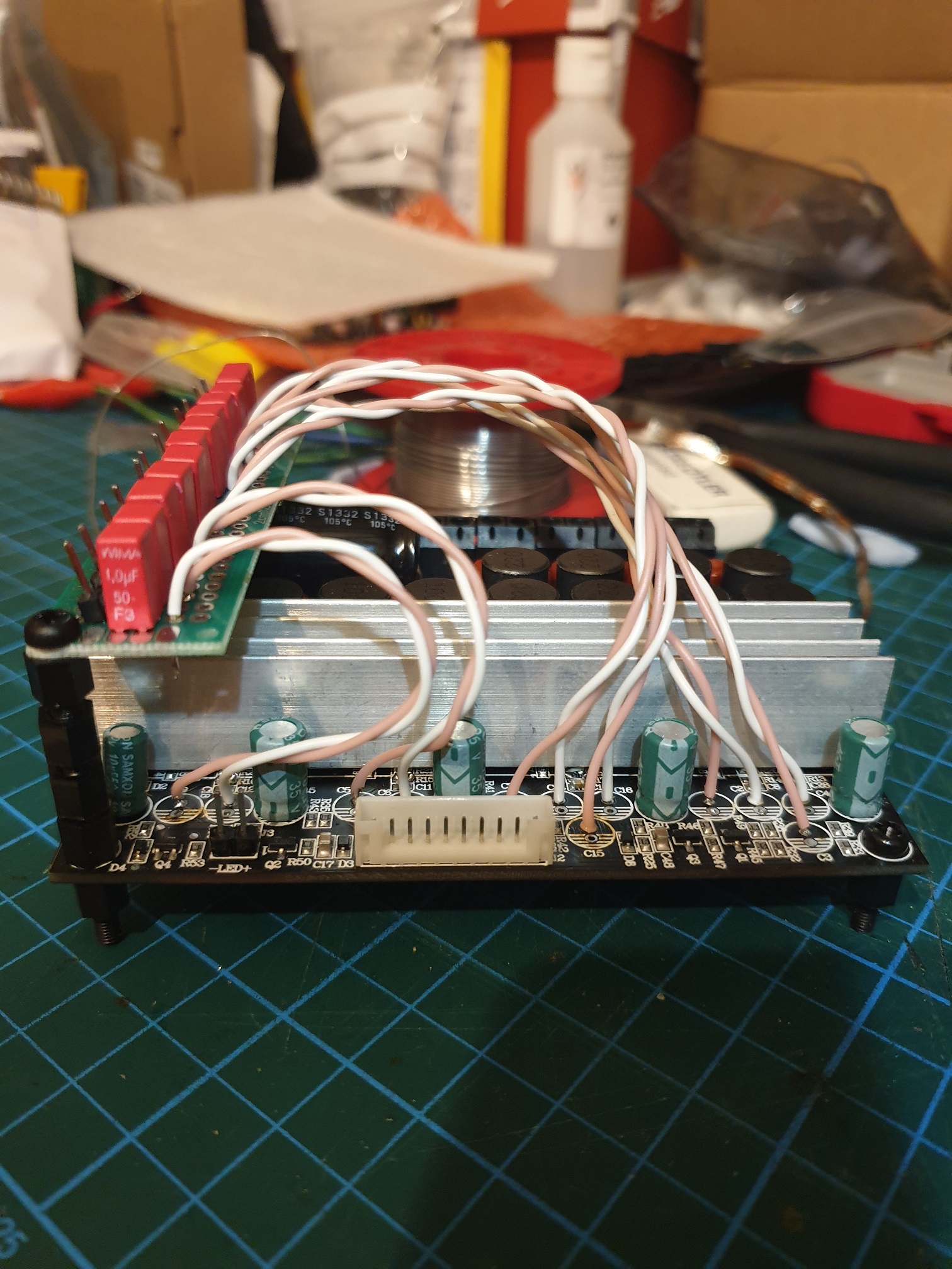

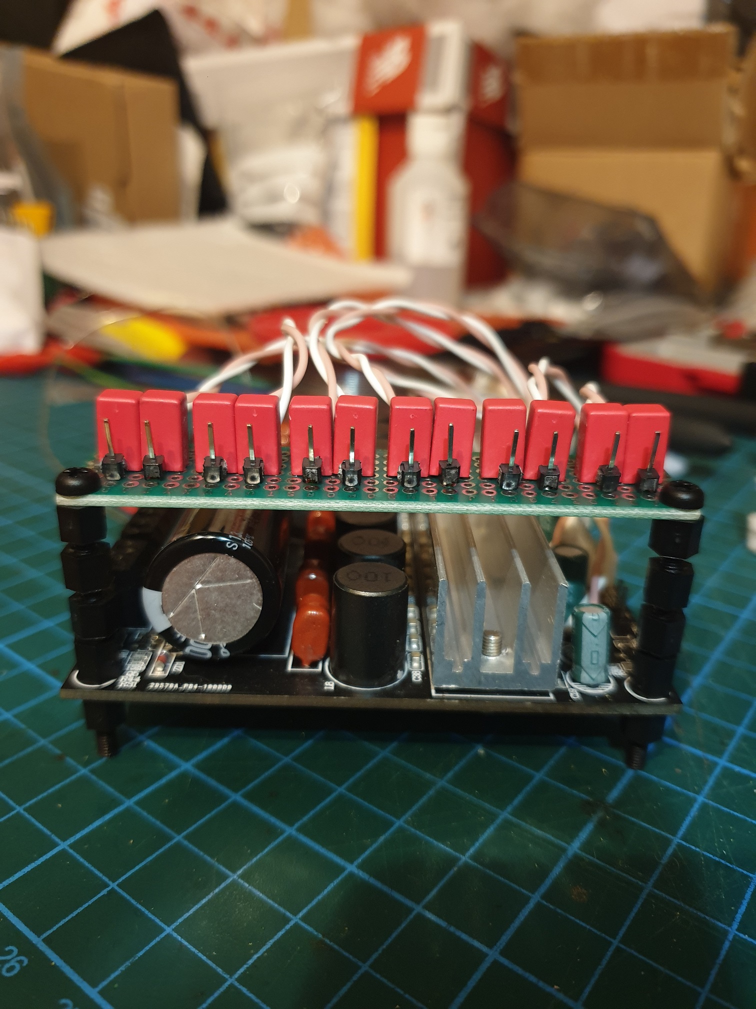

Balanced input daughter-board complete!
I ended up using Wima film caps.
I think I will design the crossovers on my MiniDSP 8x8 using the balanced outs and this amp with these inputs. I can't imagine the DSP board will alter the sound that much, the amp will be the bigger factor I imagine.

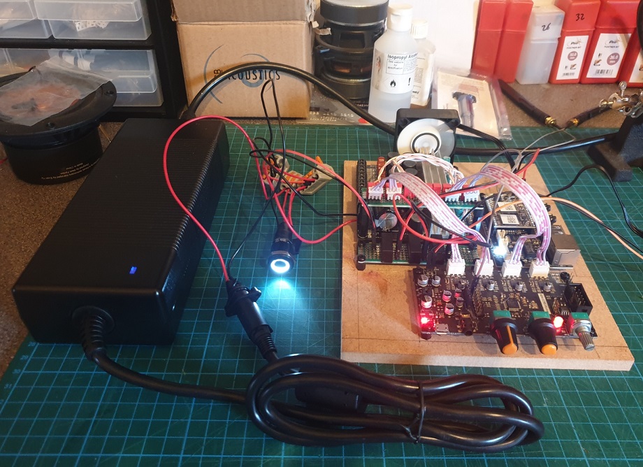

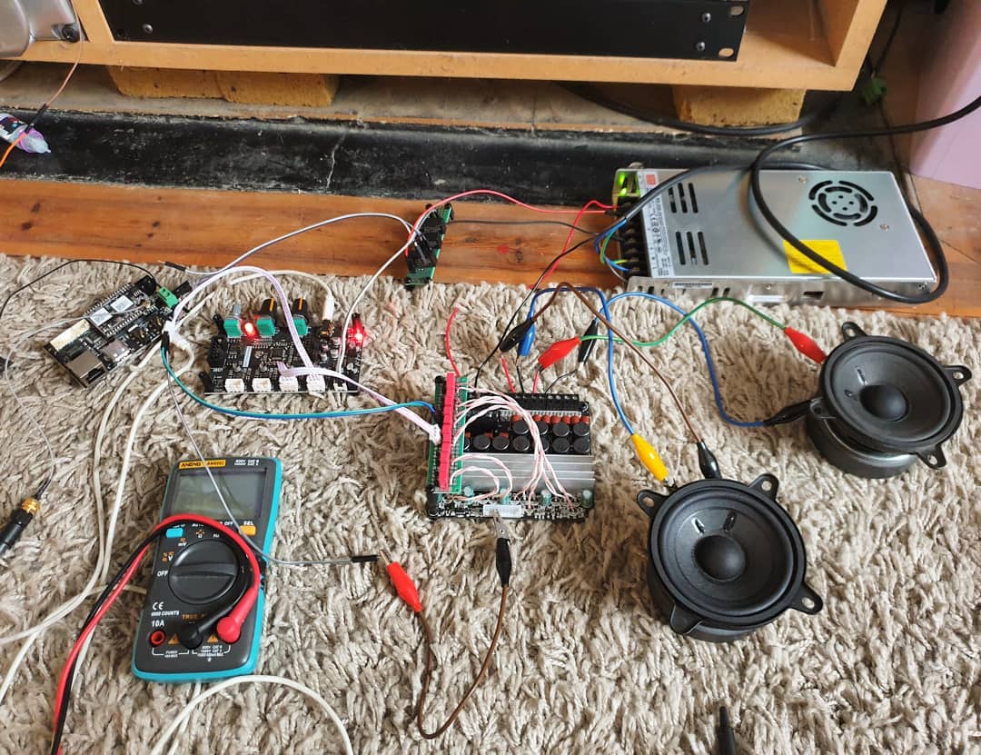

Updates:
* DSP board connects using my Sure programmer, brilliant!
* I'm investigating wooden cases and have come to the conclusion some sort of shielding is in order, perhaps in the form of copper or aluminium tape. BUT, how will the bluetooth/wifi aerial of the Arylic Up2Stream Pro get coverage? Hmmmm.
Also, the only metal protruding parts will be speaker terminals and aux in. Do these need to be earthed? I read elsewhere about using a CL60 between star ground and earth but my set up will be a bit different with lots of DC-DC isolated grounds.
I am using the enclosed Mean Well LSR-350-24 PSU.
* Cooling. I'm going to need additional cooling if I am going to using a wooden case.
These look just the ticket and will be about the internal height of the case. I plan to have one at the rear of the case pulling air across the components from peg board style holes in the front half of the bottom of the case. I plan to have a second blowing air down the fins of the amplifier.

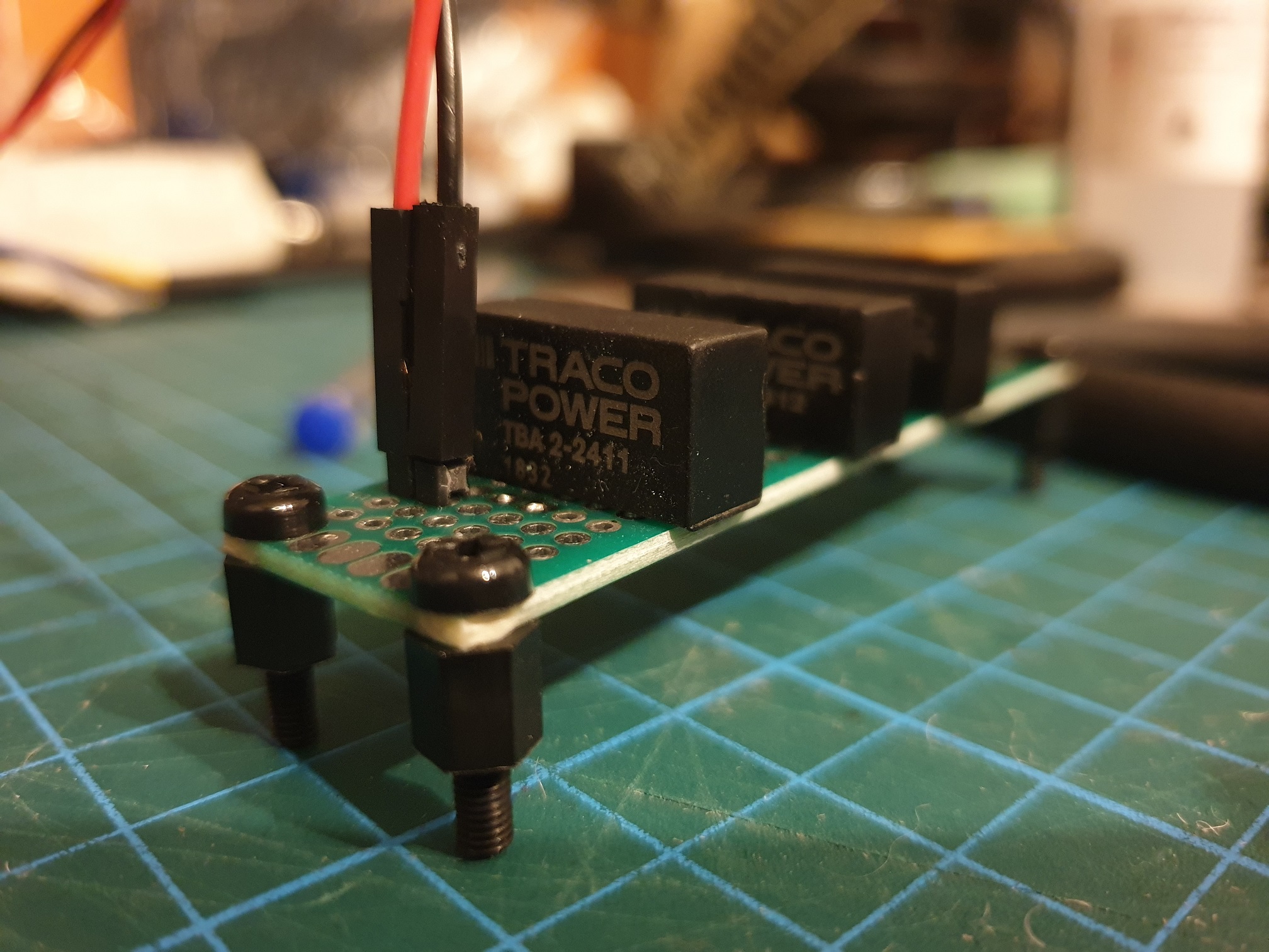

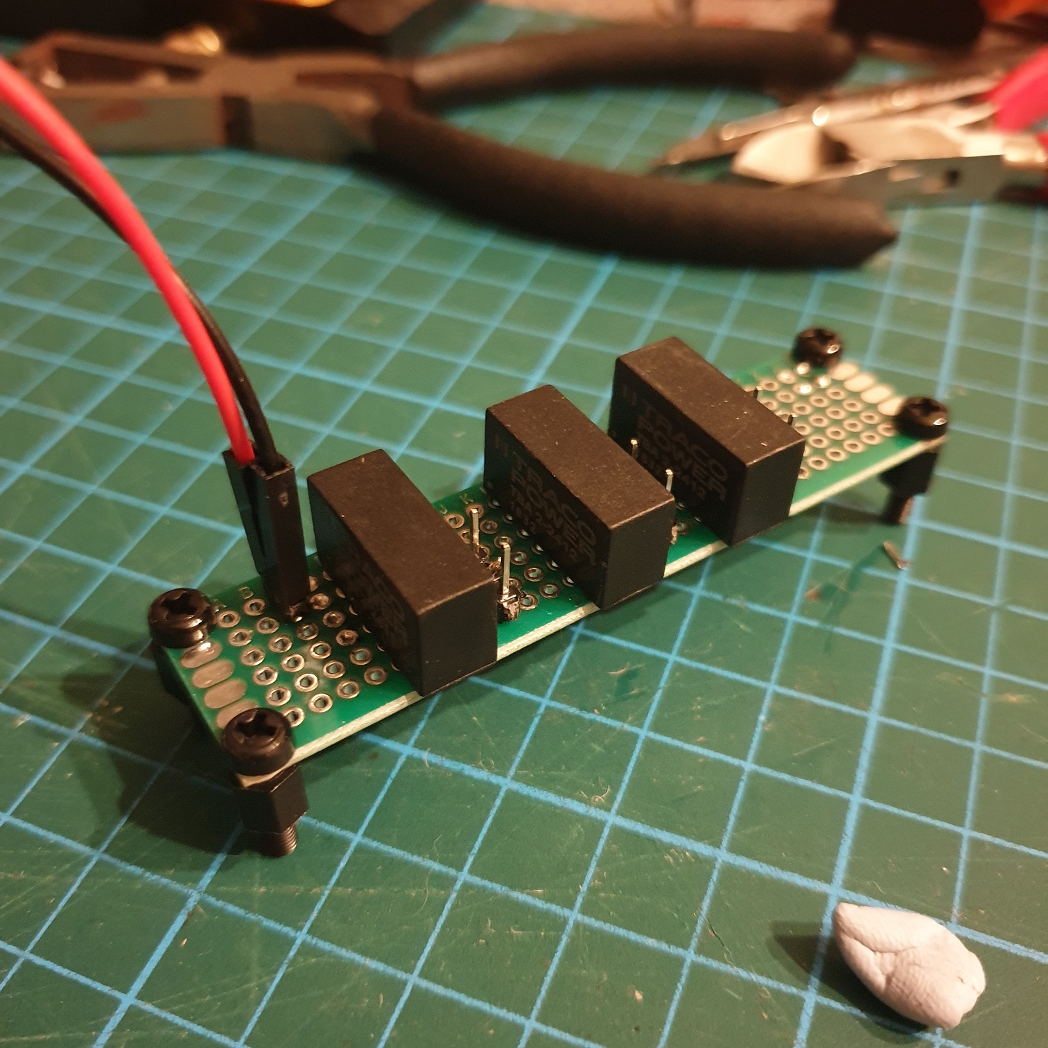

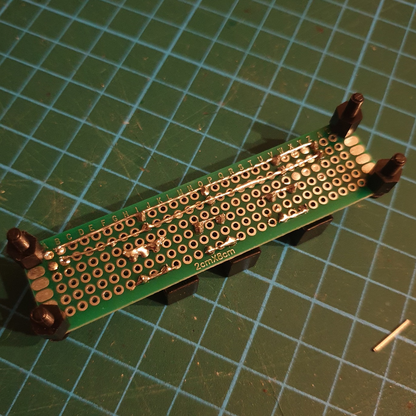

The low current power distribution board is done!
Neil, I took your advice and splashed out on some DC-DC isolators that went straight from 24v to 5v and 12v, respectively.
I ran the 24v down all + and - with bus bars (?) and jumped across to dupont headers for easy assembly/dismantling of the individual boards. The 3e DSP boards only have headers for 12v and I couldn't be bothered to desolder the USB socket to access the 5v.
Having spoken to Arylic and one of their engineers the Up2Stream Pro board only uses 300ma despite the recommended 5v/1a PSU. I tested it this evening and it works fine with a 2w/400ma supply and wifi coverage didn't seem to be effected!
I was feeling miserable when I got in from work today but making this little board put me in a good mood again!

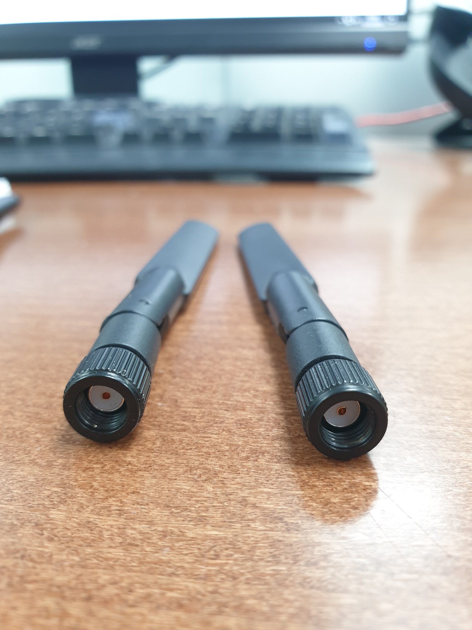

I have had these in my drawer at work and forgot about them, will they be appropriate for bluetooth as well? They are standard wifi aerials from the back of defunct machines.
I'll pair them with these:
20cm IPEX To SMA (Male) 1.13 Cable Antenna Pigtail Cable Coaxial | eBay
Those aerials should work well. The mating cable looks right.
I've had some issues ordering by description (RP-SMA vs SMA, vs female/male housing, vs female/male pins), but as long as the picture is accurate you should be OK.
Once you have the SMA connector available on the chassis, you can use a larger antenna or an antenna with an external mount if you need more gain. That's sometimes important with these WiFi modules to minimize interference and prevent dropouts.

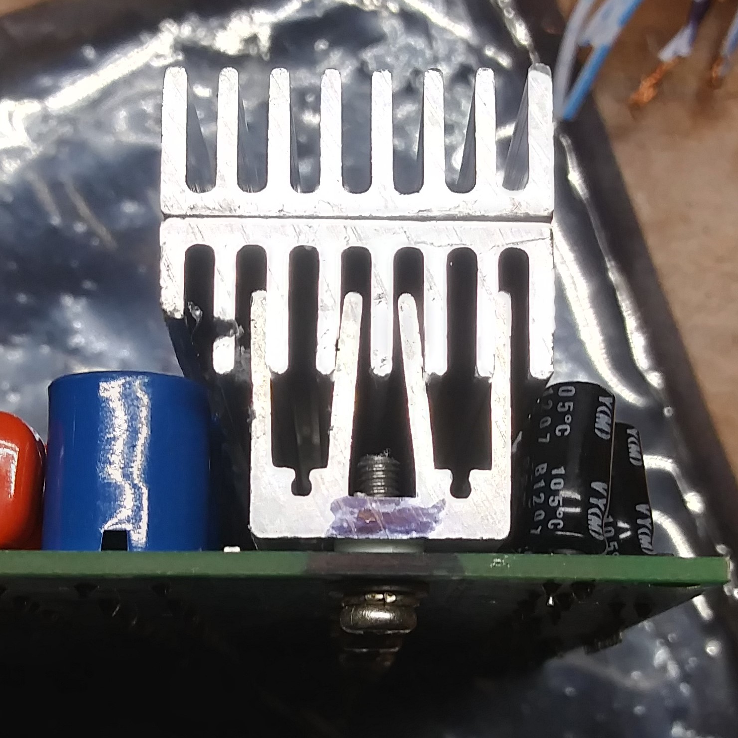

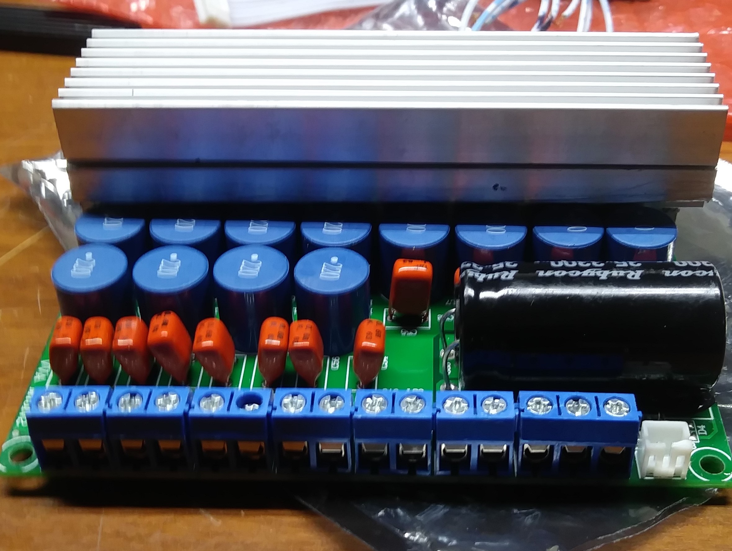

To improve the heat dissipation on my board I purchased 3 heatsinks for $1.13 from Ebay (LINK). They’re the same length as the original heatsink and have adhesive backing on their flat side. I removed the original heatsink, turned one of the new heatsinks upside down and used a vise to force them together. Then I mounted a second heatsink right side up using the two adhesive covered backs (see first picture). The only complication was the outer fin of the upside down heatsink hit the tops of the blue inductors so I used a hacksaw to shorten that fin before mounting the final heatsink.
In my haste I forgot to wipe the heatsink fins with thermal paste before using the vise to force them together. The board still runs significantly cooler than just the original heatsink so I’m satisfied how it turned out.

Thanks for all the suggestions and info. I had a break from this project but I'm back on it.
The system works as designed, which is nice! Wifi source, DSP and amp all working from the same PSU with balanced connections. I might try the I2S connection next. But it hasn't made it any further than the image below - I need to get on the woodworking stage as spring approaches!

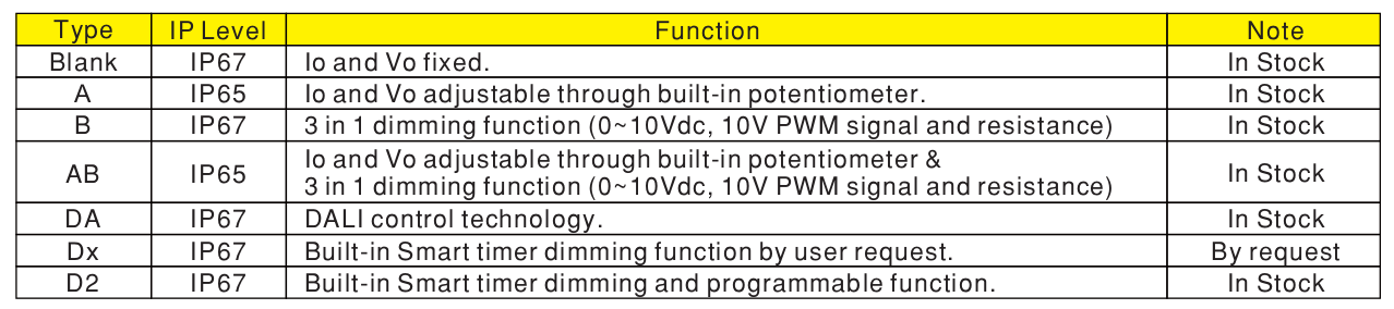

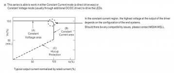

I'm starting to get a bit worried about having the power supply in a DIY box so I have been looking at self contained units so 24v is the only power source in the box.
These are fairly cheap:
https://uk.farnell.com/mean-well/el...41996954789|&CMP=KNC-GUK-GEN-SHOPPING-2943984
http://www.farnell.com/datasheets/2...MI3eT6_Jvv5wIVU4fVCh2ttQfOEAQYASABEgJU4PD_BwE
I don't understand what the dimming feature of the unit would have in terms of ramifications for use with this amplifier. Is it a bad idea?
Sticking with a well known company is preferable as I am making this for a friend - I would be quite happy to use an AliExpress special in my own home.
Any thoughts would be appreciated.

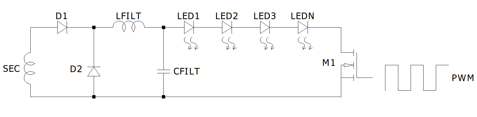

As it says the LED dimming is PWM, on off 1KHz-3KHz, likely to be a mosfet switch. I would assume that the units not specified with that option will not have the component(s) in place.
I would raise one concern over the fact that the basic supply and presumably others in the range incorporates some form of load line shaping that might not play nicely with a dynamic load such as an amplifier.
Then again... current limiting is current limiting. You will have to suck it and see.
Thanks for the input, man! Although I couldn't have put it so specifically as you they were my concerns, also. Though, isn't a switched supply PWM anyway? Maybe I've revealed my lack of knowledge there!

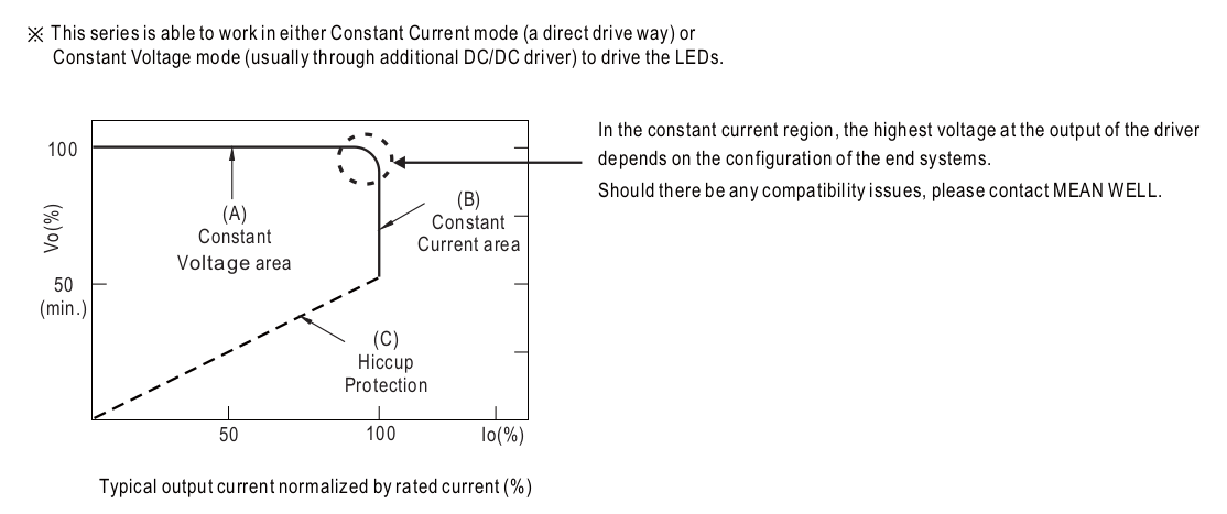

I wondered if the current control was set to max it would disengage the function.
They are £30 in the UK, delivered vs £65 for the fixed voltage version, not sure if it is worth the risk, the budget for this project is maxed out as it is and I don't want to waste my friends money 🙂
Yes it is a switch mode power supply and will use PWM to produce the regulated power for the LEDs. The PWM section mentioned in the data sheet is an additional function provided to dim the LED string. It seems you are suggesting that the supply with the PWM function is cheaper than one without it, TYPE BLANK Vo and Io fixed with no PWM function.
Anyway it should be possible to set the PWM to 100% in effect turning the output on all of the time and Vo/Io to maximum. It is also highly likely that my interpretation of the operation is completely wrong.

Small steps but it's getting there!
Instead of enlarging the heat sink (mainly due to me not thinking ahead and mounting the balanced inputs above the current sink) I am going to go for a constant slow draw of air across the board. The air will be pulled from the front end of the enclosure through the opposite parallel panel that the boards are mounted on. This will pull it down and across the DC isolators that get warm and then down the fins of the amp. Hopefully this will be enough.
I am using a Gelid Silent 5 50cm fan which, I would like to say (outside of an Amazon review - it would grate on me that I assisted Bezos any futher) that it is NOT silent. I may down the speed to quieten it once enclosed.
