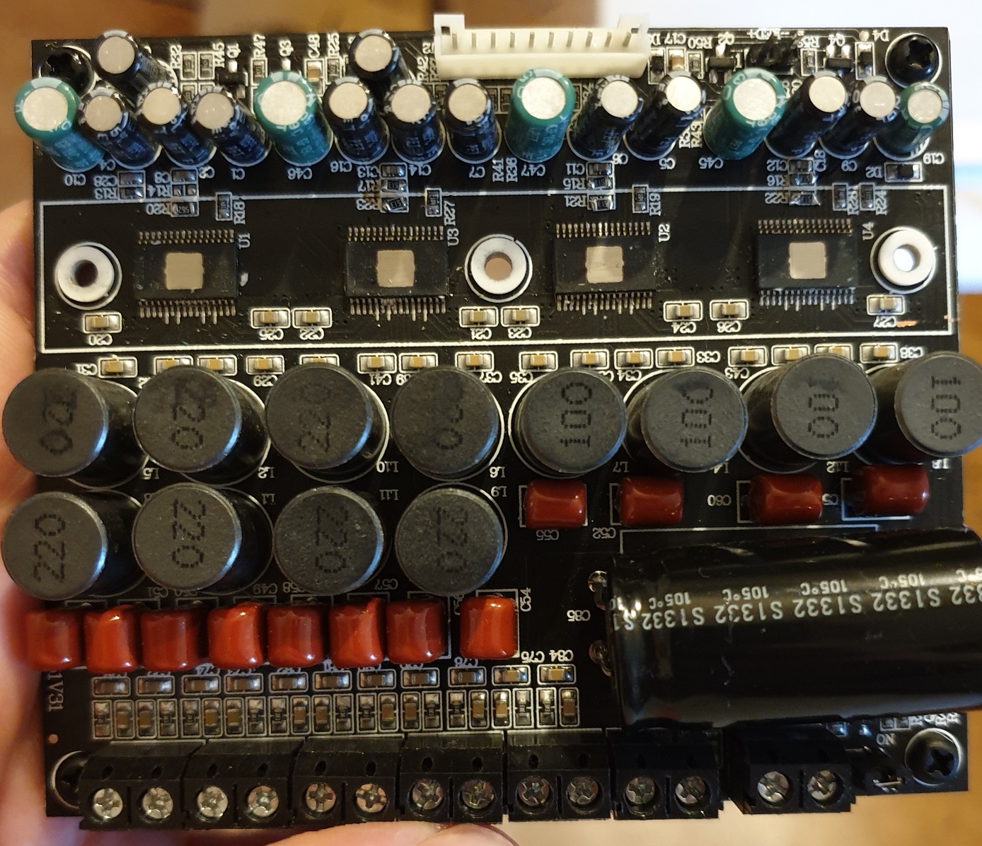

It looks like there are two versions of this board--one with two bulk capacitors and 3 screws holding the heatsink, and a newer version, with just one bulk capacitor and 5 screws in the heatsink.
I've taken the heatsink off of the "original" version with 3 screws. There is thermal paste on each chip that makes it stick to the heatsink, but it's pretty easy to break that bond by twisting the heatsink a bit. It's gooey stuff--the same as what is used on many CPU's, but it doesn't harden.
If they used thermal epoxy on the new ones, you might need heat or a solvent to break down the epoxy. The thermal epoxy that I've seen is the same type as the 5-min epoxy, which softens around 180C. Heating to that temperature would probably damage the board. However, isopropyl alcohol or ethanol would probably attack the epoxy without doing any board damage. There are some other candidate solvents listed here.
But cripes, with 5 screws, why would they also use epoxy? I'm guessing you should be able to remove the heatsink with moderate force, directed in a way that wouldn't put too much stress on individual solder joints.

Do not pull on the heat sink, twist it a little, while heating the heat sink. Maybe stick a screwdriver into the fins. Pulling while heated will destroy the chip as it is embedded in plastic.

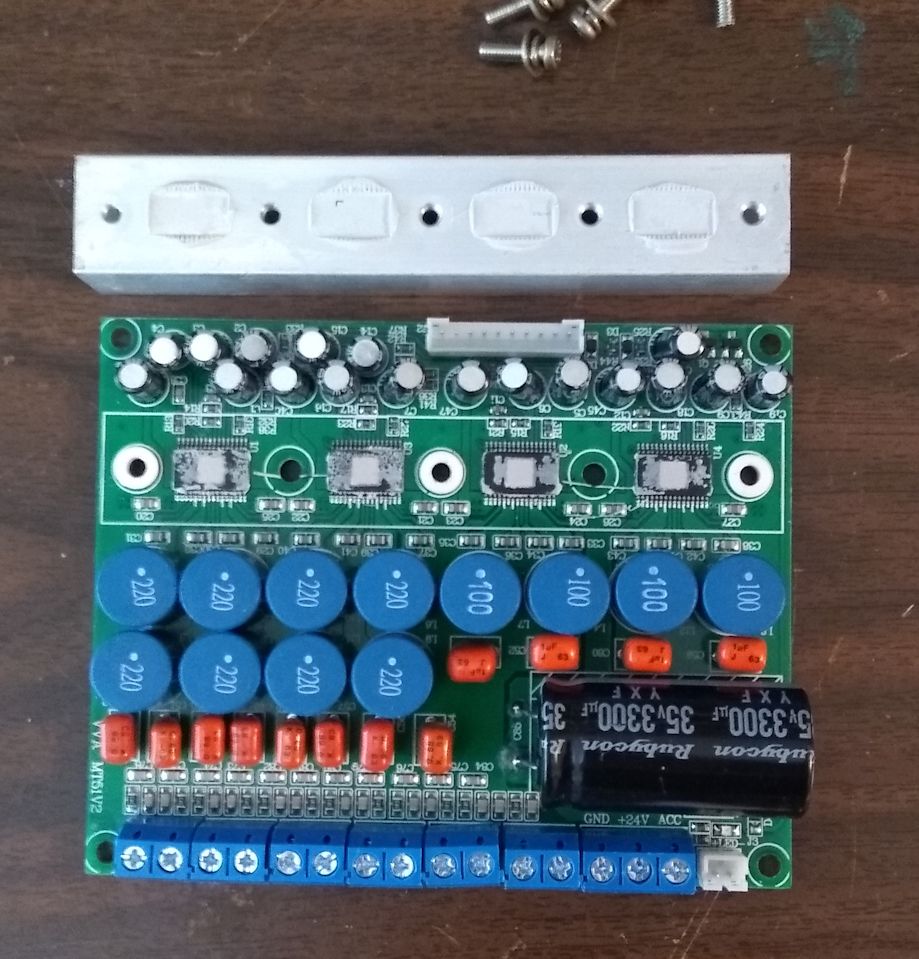

OK, mine arrived today, also. I ordered from a place that showed the picture of the old version, but I got the new version with 5 screws in the heatsink.
And yep, the heatsink is glued onto the chips with thermal epoxy. That's the bad news. The good news is that thermal epoxy isn't very strong. It's hard, but somewhat rubbery due to the embedded thermal paste. I crammed a screwdriver between the inductors and the heatsinks and also pried between the heatsink and the circuit board. It didn't take that much effort to pop off the heatsink. I'm not going to guarantee that you won't screw up the board, but for me it wasn't a big deal.

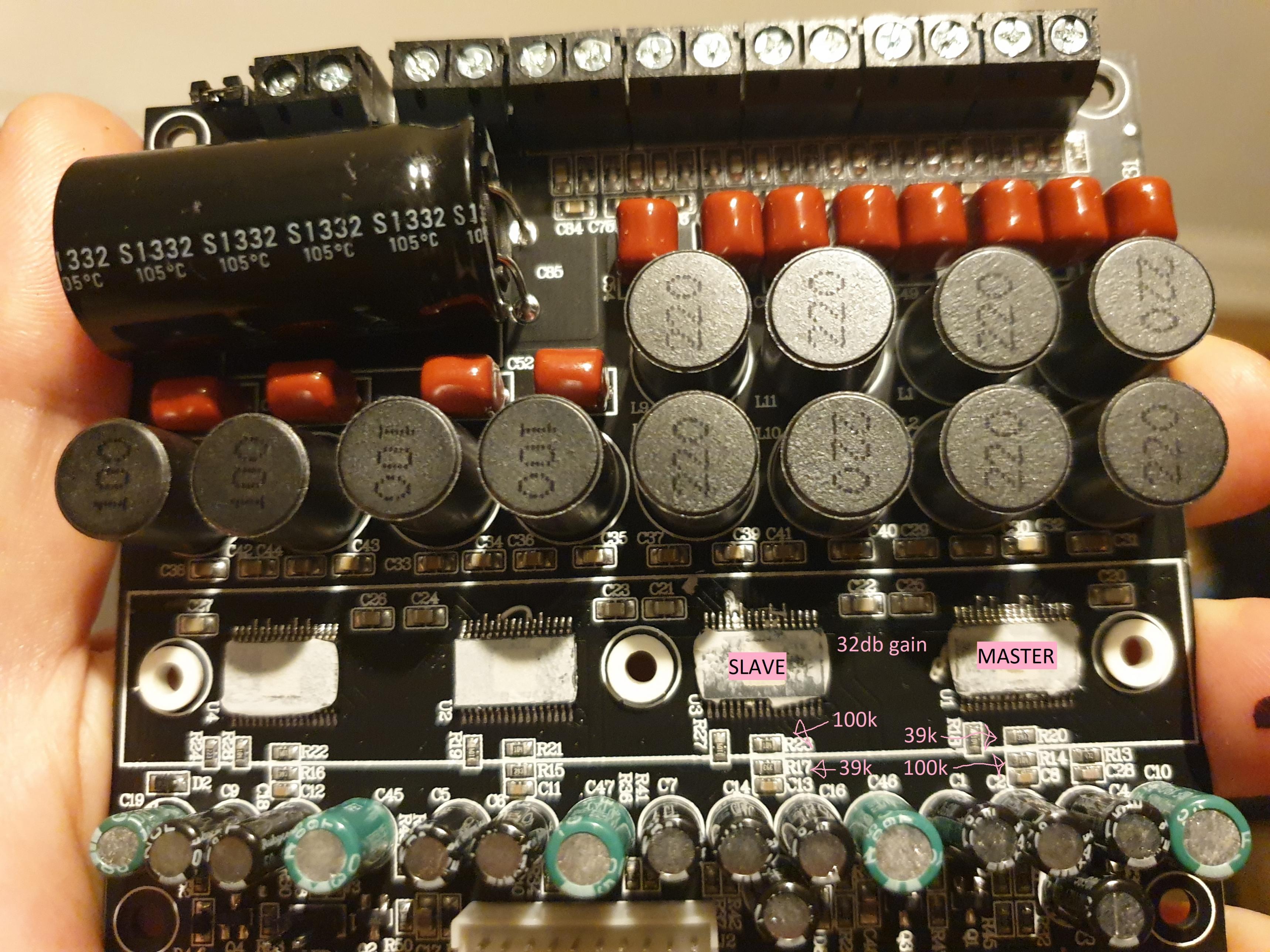

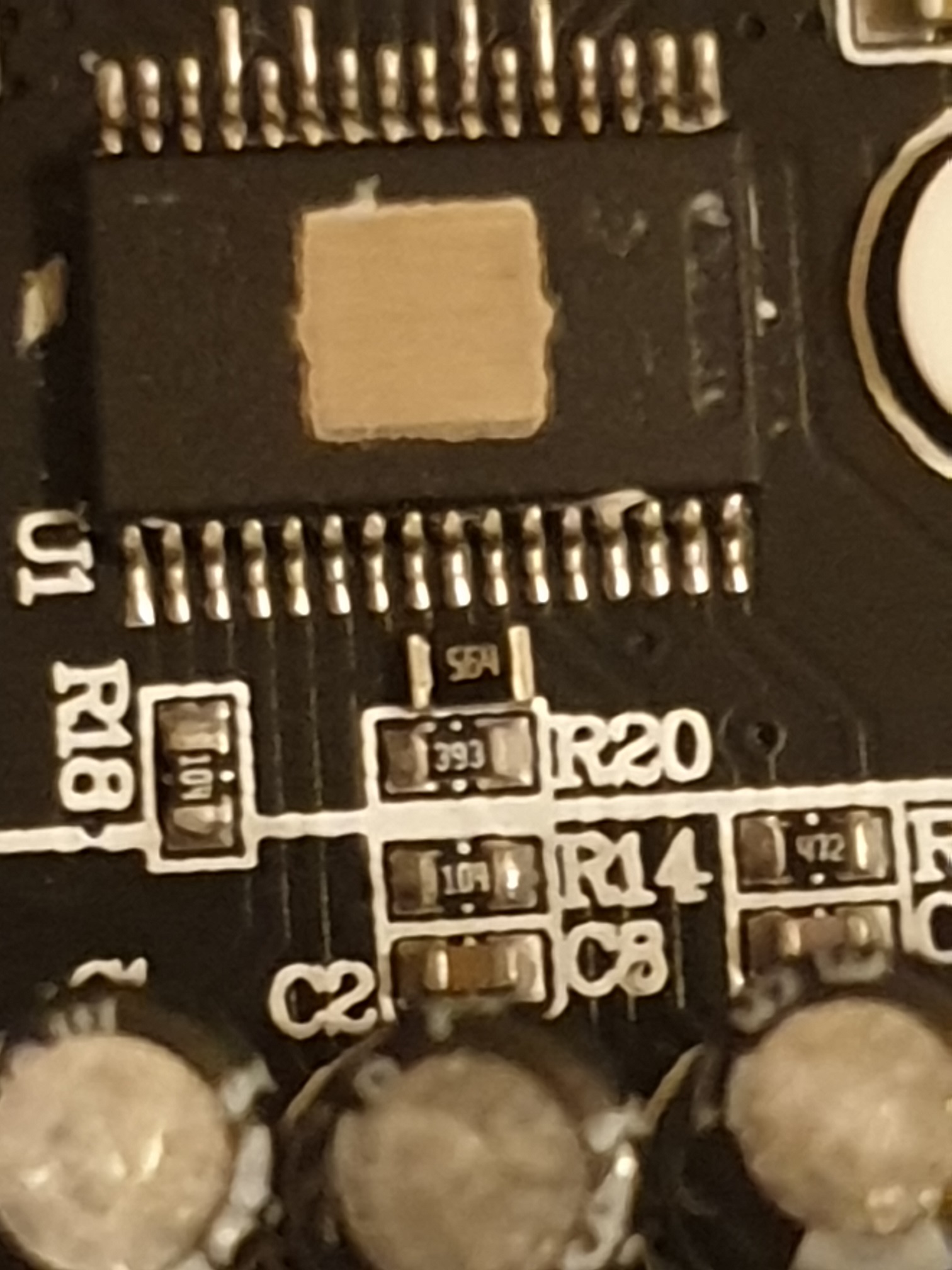

Looks like it is set to 32db gain which is too high, obvs.
I only have 0805 resistors and these look smaller. Maybe 0603? Will I be able to get 0805 mounted? I'll need a finer tip for my iron.

The thermal epoxy scrapes off fairly easily with a razor blade, and then follow up with denatured alcohol (ethanol) or full-strength rubbing alcohol (isopropyl alcohol).

Yep, 32dB gain is a bit high. That results in a voltage gain of about 40. If you are using a DSP like the ADAU1701 with a voltage output of .9v, 32db is OK for a lot of applications. However, I'm using the amp for near-field listening, and the bass channels are providing 2V output from the DAC attached to the DSP, so I want to back off the gain by at least 6dB. Just way too much hiss when I'm listening from 3 feet away...

I cleaned it all off with IPA, I just used thermal grease for the time being whilst there is the possibility the sink needs to come off and on.
Looks like 0805 will just fit on the pads. (resistor shown above R20 is not correct value just first I could find. It'll take some ninja skills!

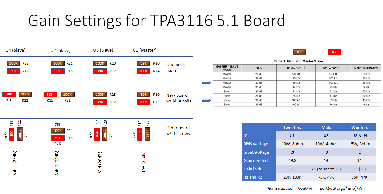

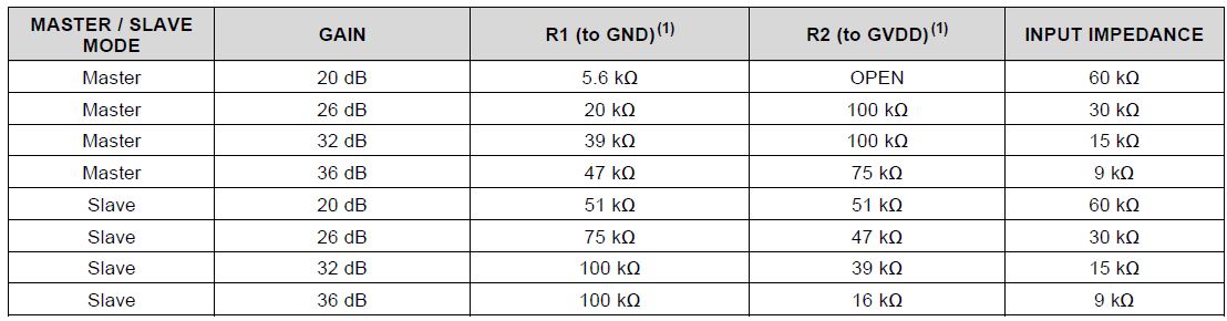

I started making the changes to reduce the gain on this board, and realized that there are at least 3 different versions of the board. They all appear to use the same schematic, but the resistors that set the gain are in different places on all 3 boards. I used the picture that Graham posted for his board, and found that two of the three boards that I own are different. The gain resistors are either parallel to the chips or perpendicular--depends on the PCB. See the attached drawing that shows the 3 different layouts.

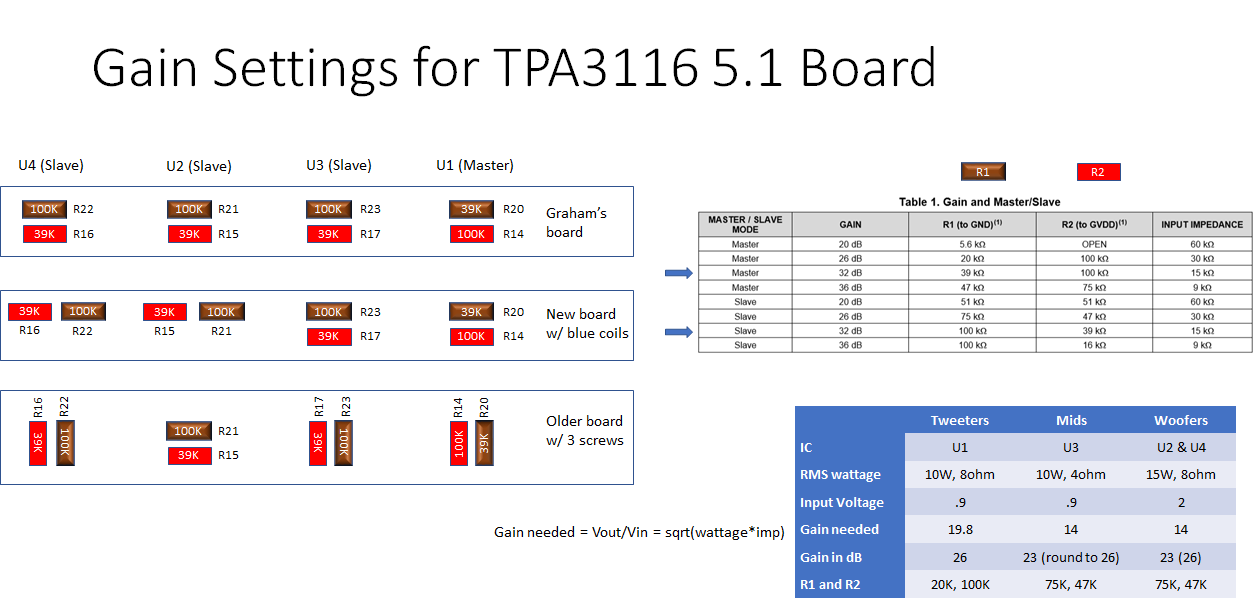

In order to determine the necessary gain for my project, I calculated the output required to reach the maximum rated wattage of the driver, and divided that by the input voltage. I used 1/2 the maximum input voltage to give me extra headroom. It turns out that the best gain for my application would be between 20dB and 26dB, so I went with the higher figure. The factory setting of the board is 32dB, which might be OK for really inefficient speakers, but there is too much "hiss" for nearfield listening with efficient drivers. I'll finish the mods tomorrow--I wanted to document the boards first before I started removing the parts.
I screwed up the first round of changes by assuming that I could just change the 39K resistor for all the amps. However, that is only true for the "Master" chip. For the other chips, you need to change two resistors, which makes the job more challenging. I used a 0805 because that was all I had for the master channel, and it wasn't too hard to cram onto the 0603 pads. But it will probably be easier to use 0603's. Given the way my board is laid out, it is too hard to fit a hot air nozzle between the other parts, so I'm using a fine conical tip.

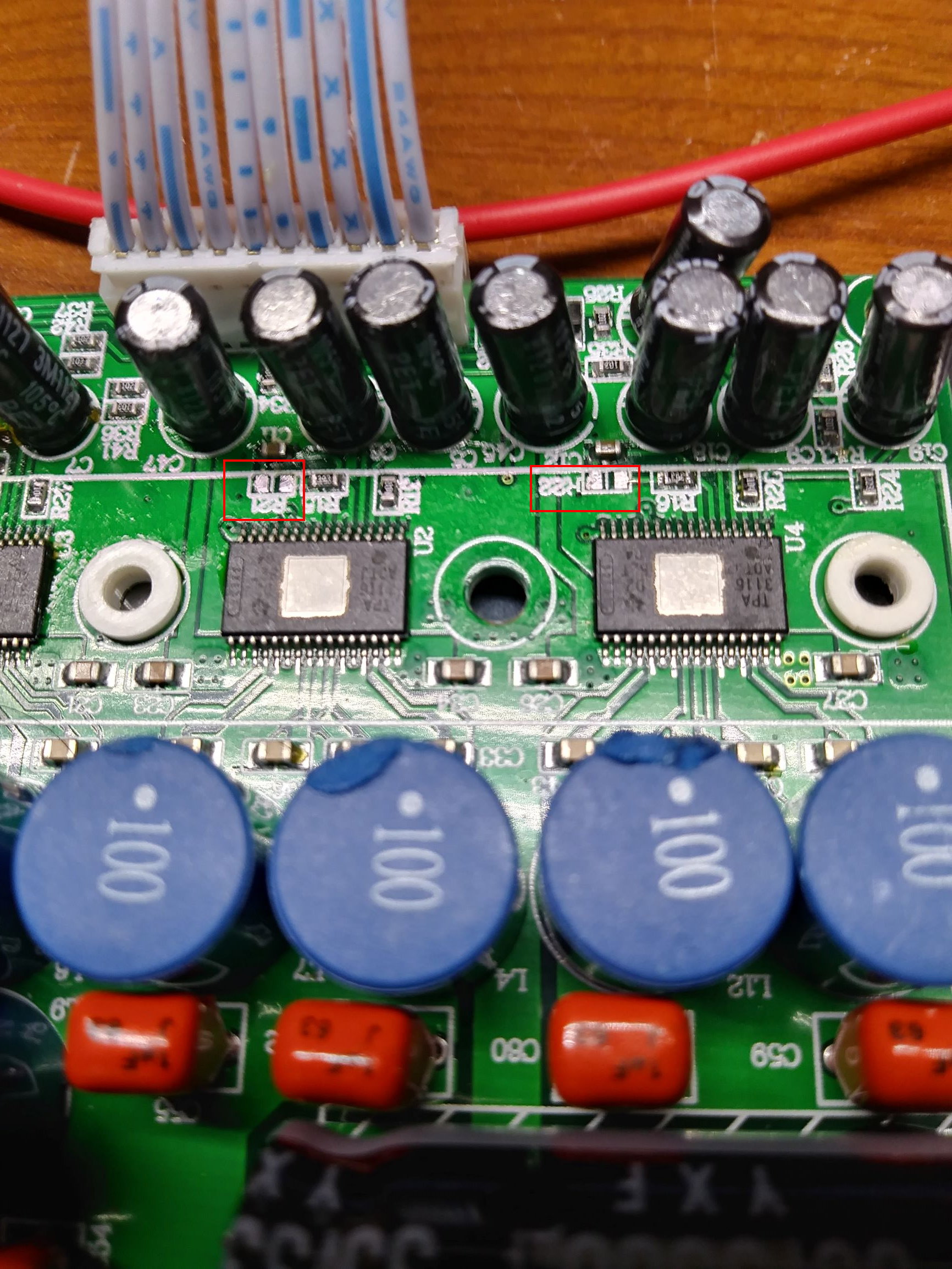

I have the same 6 channel board as Neil, except mine has 22 uH output filter inductors on the 4 stereo outputs instead of Neil's 10 uH output filter inductors. I would be willing to bet all the other circuitry is identical. The board, as delivered, is set for 32 dB gain. I verified the 4 TPA3116 chips are wired as master/slaves as I hoped so all 4 chips are synch'd together. The master chip is the leftmost chip when the amplifier is positioned with the output inductors closest to you.
I wanted 20 dB gain so I made the modifications below. Do note that resistor values for TPA3116 gain settings differ between master and slave mode chips (see the first attachment from the TPA3116 datasheet). Here are the original resistor values on the board using the datasheet R2 and R1 designators. The designators in parenthesis are the board identifiers. The slave chips are numbered left to right with slave1 next to the master chip. The photos show the resistor locations on the board.
...........R1..........R2
Master 39K (R20) 100K (R14)
Slave1 100K (R23) 39K (R17)
Slave2 100K (R21) 39K (R15)
Slave3 100K (R22) 39K (R16)
To set the master chip to 20 dB gain I just removed R2 (100K, R14). The table lists that R1 (i.e. R20) should also be changed to 5.6K, but R1 and R2 just create a voltage divider network and without R2 the value of R1 is really unimportant. So I left it unchanged.
To set the 3 slave chips to 20 dB I removed the 3 100K resistors (R23, R21 and R22) and replaced them with 39K resistors. The table lists that both R1 and R2 should be 51K, but the important point is that they are the same values so they divide the voltage (GVdd) to one-half its value. So my slave chips have both R1 and R2 set to 39K.
I didn't have any problem removing the heat sink after I removed the mounting screws as only thermal paste held the heatsink to the TPA3116 chips. Do note that some of the screw holes are isolated with grommets and others are meant to be grounded. Don't move or lose the grommets! I cleaned the heatsink and chip tops and used fresh thermal paste when I remounted the heatsink.
Hope this helps! I'm not a big SMD fan when it comes to soldering so that's why I took the approach of minimizing the number of resistor changes. I do have pre and post power/distortion measurements and the board works great at 20 dB gain. It still runs hot as Neil has discovered. I'd like to find a more substantial heatsink, but's that another adventure.

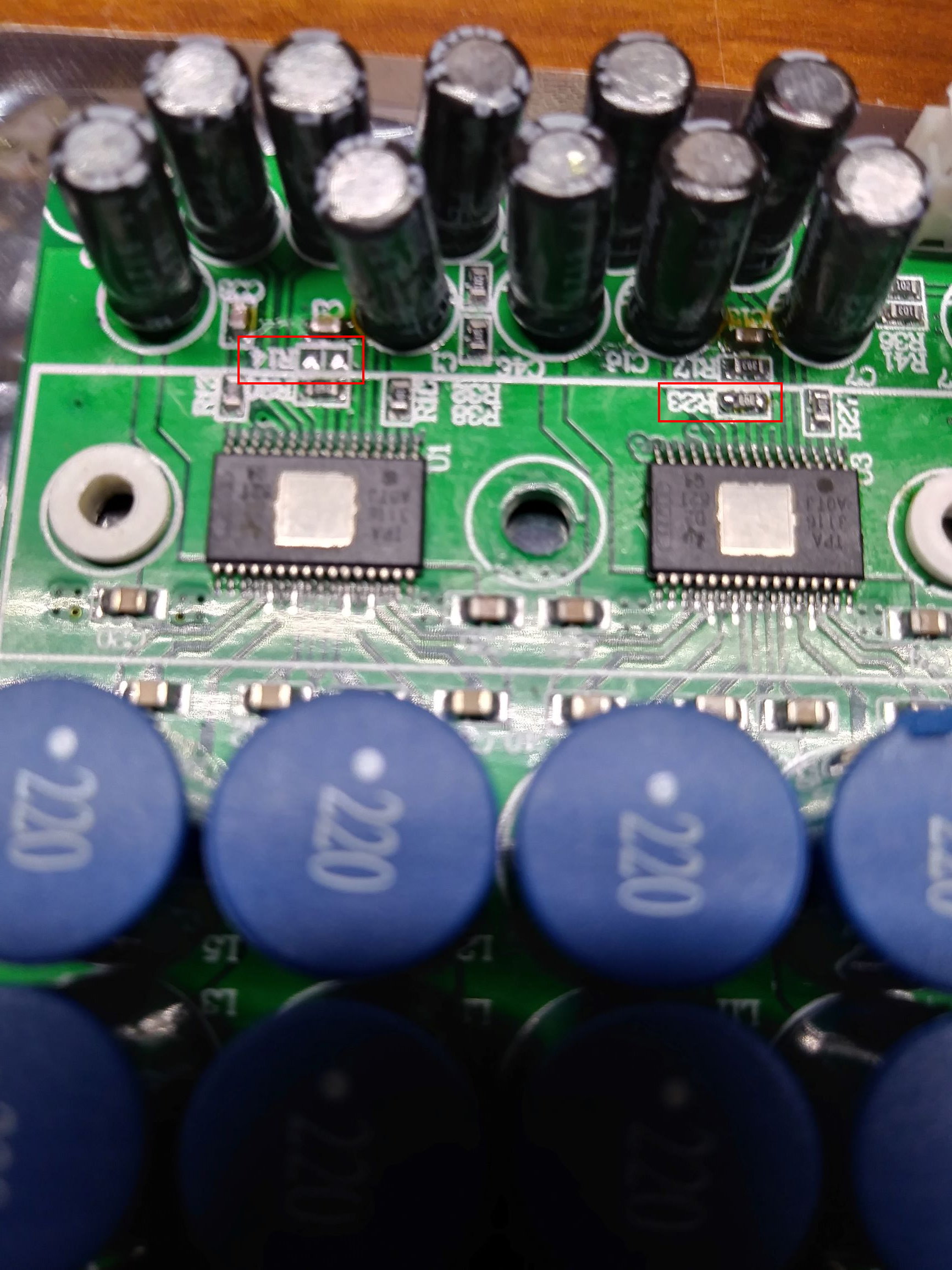

It looks like there are a number of variations of this board. But fortunately, they all use film caps in the output filter, reasonably sized shielded inductors and properly placed decoupling capacitors for the TPA3116. Those are the key ways that a manufacturer could screw up a TPA3116 design, and so far this board looks like a real winner, in spite of the variations.
I changed the gain on 3 of the chips to 26dB and set the tweeter channel to 20dB gain. That got rid of most of the background hiss, although I could have gone with 20dB for all channels. That's using my stereo 3-way ADAU1701 board, which uses the ADAU1701 DAC's (.9V output) for the mid and tweeter channels and a separate PCM5102 DAC (2V output) for the left and right "sub" channels. The final resistor values are shown in the updated chart.

I like the layout of the gain resistors your board, because there is enough room to aim a hot air nozzle on the resistors without causing other problems. With the hot air, those tiny resistors magically align themselves with the pads and make perfect looking joints. On my two boards, the resistors are too close to the capacitors to use a hot air rework station.
