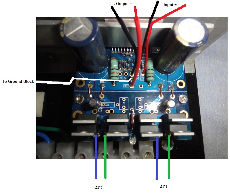

I have been having some fun with my scope and am starting to learn what means what.
Input Cable - I have disconnected one of the input leads and connected the scope to the output. With the 300mm long lead held away from the amp I seem to have around 2mV of general noise.
As I move the lead closer to the transformers I get a more defined 100Hz trace of about 2 - 5mV.
When I place the input cable right next to the mains input area it peaks at about
15 - 20mV and starts to show the 50Hz over the 100Hz.
I have taken this photo of the amp's star earth to clarify the layout.
-The White cables running under the boards is the earth from each module.
-The yellow cables are from the separator plates between each taroidal.
-You can see the safety earth from the main socket running yellow wires into the right hand back of the earth block.
- The input and output terminals are isolated from the back plate with plastic spacers that run through the hole.
Should I start removing non critical elements from the star earth structure and see what happens?? Of course not the PCB earth points??
Cheers
Dean

Just had a thought. I added The caps at points 'Cz' marked on the boards.
They are 0.1uF Wima's. The thing is, I did not add the 'Rz' resistors. Don't ask my why I did this, I have no idea.
Could these be causing the issue?
Just thought I would mention it.

As you can see in the photo, I have only attached the star earth to one point on the two PCB's, being the 'OG'. I am currently attaching links to the two earth points on the PSU pcb and will do some more tests.
Ok, I will just keep talking to myself here, somebody else might find this info useful.
-I disconnected one of the two rectifier/amp modules from the transformer and just ran a single rectifier/amp.. No change.
- I ran earth leads from the two points on the PSU PCB back to the star earth block.. No change.

Those spikes look like charging pulses through the rectifiers.
They could couple electrically through a common trace/wire, or magnetically across a pair of large area loops.
Did you do a trial assembly without a chassis? Can you easily dismantle the PSU and temporarily move it outside the chassis.

the charging circuit will show a 100Hz sawtooth waveform and a pulsed waveform.
These should be kept in a tight loop around the charging circuit only.
The audio side will be affected by the changing voltages across the smoothing caps. This will infiltrate into the audio signal processing.
Do your best to ensure that the audio side does not share are common wiring with the charging side. This is absolutely imperative, This is why one must NEVER locate the Main Audio Ground on the wire, cable, trace, plate between the smoothing caps.

Good to hear from you Andrew, I was hoping you would be around.
Hope your Christmas has gone well. Melbourne flooded today(along with my shed) so I cant work on the amp but I have a quick pic with a more complete one on the way.
In regards to your grounding observations, the only thing I can think of is that the AS4222's have a static shield around them with a lead-out wire that I have connected to the star-earth block, along with the amp ground leads. I also have an alloy plate between each transformer which also has a lead running to the star-earth block.
I guess I should try removing these from the earth block and look for changes on the scope, but I am not sure if this is what you are referring to.
To be honest I am not experienced enough to accurately interpret your advice in relation to what I have built.

Correction: "To Ground Block" = Star Earth Block. There is only one large brass block that EVERYTHING goes to.
I have checked for shorts between panels and connectors... etc.
All 6 channels have the same amount of 'hum' with the same trace on the scope, a 100Hz 6-8mV squarish wave. As shown in a previous pic

Hi Dean, what size are the filter caps on the amp board? From what I can see it is a very minimal design. I suspect 1000uF caps??
I know that my LM3886 had 100Hz spikes on the output (not as big as yours) and only had 1000uF / rail on the PS (though it also had local 100uF decoupling on the LM3886 pins).
Increasing the PS caps to 5700uF in total almost completely eliminated the 100Hz noise.
I'd say it's worth while trying to disconnect the alloy plates from the star earth block. I'm speculating here that rectifier pulses back through the transformer and the resulting EMI may be inducing current in the alloy plates which could be then polluting your earth.
Have you tried the scope measurements with 2, 4, and 6 channels running? Is there any difference?

Ok, so I spent the last 6 hours digging out the shed after the flood so I could get to the workbench. The house is fine with no real damage but we have discovered were the drainage situation could be improved in a few places. 😀
Amp testing time.... I am becoming more comfortable using the scope so this has been a good opportunity to learn something.
1. Single module running, 100Hz 6mV noise on scope and hum at speaker.
a) Add another psu/amp module = no change
b) Turn on all other modules = no change
c) Connect Alloy shield plates (between trany's) to star-earth = no change
d) Connect static shield from around trany's to star-earth = no change
e) Connect shielded wire from input to rca on back panel = no change
f) Drink a beer and scratch head = no change

OK, finally had enough time today to get the amp onto the test bench and disconnect everything but 1 channel. I then took an alligator lead and placed one end on the star earth block and the other on the outside of the rca connector.
I forgot to take a photo but the 100hz hum looks the same with the lead connected or not. So no change on that front.
Do you think its worth trying larger caps Peter (+others), say 4700uF and see what happens? If so, what brand would be best?
Cheers all. Dean
PS. I have had the amp running (with hum) and am having slow but great success with my miniDSP/OB rig. More bass than I have every had before from the 2 x 15's. In every other regard the AudioSector LM4780's have been operating flawlessly.
Cheers all. Dean
That does not ground the input, it needs to be connected to the "inside" of RCA connector.
If you are experiencing hum issues, larger cap will not help here.
Thanks for keeping an eye on this one Peter 😛
I will get the amp back on the test bench and redo the input earthing test hopefully in the next few days.
I will also take a few photo's this time and post them so the next step might be a bit clearer.
Cheers again
Dean
Cheers again
Dean
