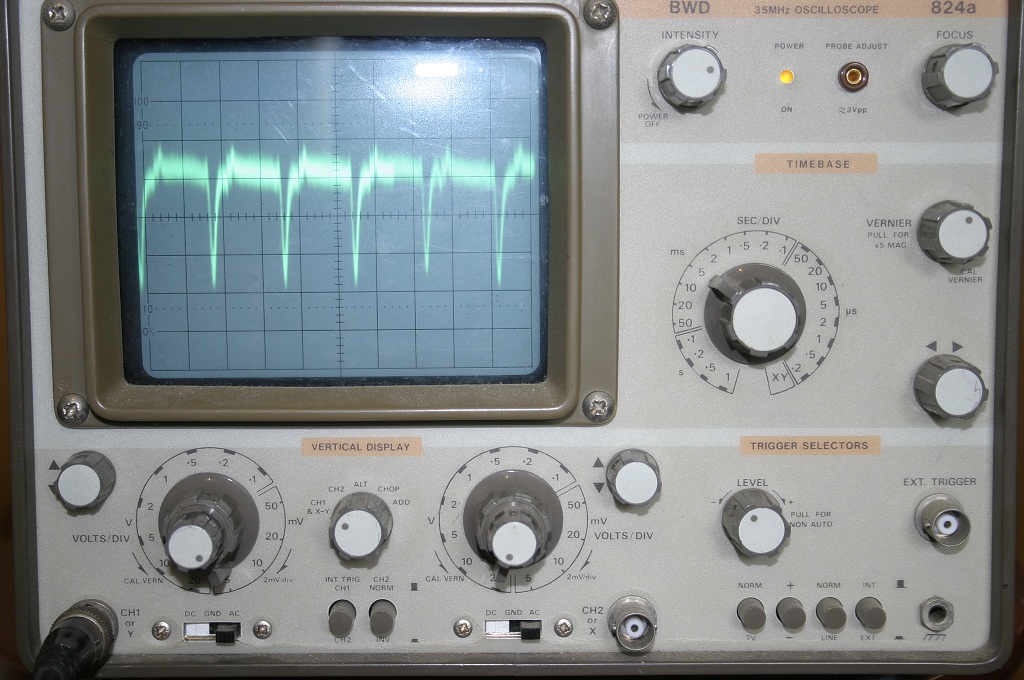

Trying to take a Photo of my scope so I can get your feedback. Having a bugger of a time getting the trace to show up in the photo. Has anybody had any luck with a particular setting on a camera???

Here is a photo of my scope (thanks Tony - 1/10th works) connected to the output of 1 channel in my amp. The other channel is still connected to the speaker and producing hum.
The scope is set to 2mV/5ms DIV.
To me it looks roughly like 100Hz@8mV, is this correct and can I assume that is related to mains interference.
Hopefully somebody know's what to make of this and can provide some feedback.

Yes definitely looks like 100Hz. somewhere between 6 and 8 mv.
100Hz is post rectification, if it was mains interference I think it would be 50Hz. So my guess is that it is power supply and earthing related.
Draw out all of your earth connections on paper and see whether you can see anywhere where there are two separate paths back to earth (possibly through the input wiring).
Tony.
