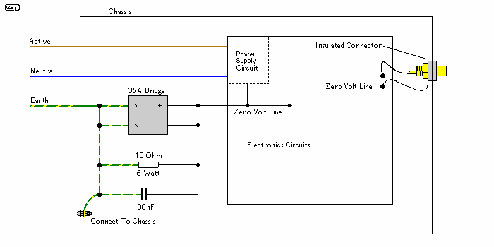

From the thread i found ESP's site and copied the diagram attached.
Will the values stated for the 'Ground Loop Breaker' be appropriate for my setup?

Hi Dean, I don't think that the earth loop breaker is going to help (unless one of the other components you are connecxting to is also earthed to safety earth. The loop occurs through the interconnects and out through the mains wiring.
The bridge should be fine, 400V 35A is much more than the mains can deliver, and it is mains level faults you are concerned about with safety earth. I found that I had to go to an 18 ohm resistor instead of 10 ohms to get a reasonable amount of attenuation (my earth loop was between my PC and my Amp.

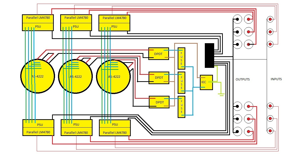

Here's the drawing of the current wiring. As you can see I have followed others advice and redone 'some' of the star earthing.
Can anybody suggest others things that need changing?
Also note that the 2 PSU's on each transformer are wired in parallel.
Its when I disconnect one of these psu/amp combo's that the buzzing stops.
Is it OK to wire two of these PSU's in parallel?
Have I somehow created an earth loop by doing this?

Is that with the inputs grounded, floating or the DSP connected?
I see 8 secondary tappings coming from each transformer.
Are these transformers, quad secondaries? I.e. all channels are isolated from each other.
If these are dual secondary transformers then the two channels supplied by each transformer are not isolated. A dual transformer feeding two PSUs and two amplifier creates a potentially enormous loop in the grounding wiring. Three dual sec transformers could have three big loops.
The two channels of amplification must be laid out (adjacent or on top of each other) to minimise the loop area.
Even doing this will not eliminate the hum at the output. This hum will vary with the various interconnections you adopt.
A monoblock is much easier to build hum free. A stereo is difficult to get hum free.
A 6channel is a challenge I will never rise to.

Here is a new drawing showing the Antek AS-4222 Dual Secondary Trany.
Each PSU/AMP board is simply paralleled with the other.
With only 1 transformer turned on would this not act like a simple stereo amp?
Should I be using only 1 PSU board with two AMP boards?

I have not found any way to get 2channel hum free operation using dual PSUs from a dual secondary transformer.
Either quad secondaries or single PSU in a two channel amplifier is the only recommendation I can give.

Right, I'm with Andrew then. You need to have each pair of amps running from one PSU. Turning the gain down isn't really a sensible option in my opinion.
