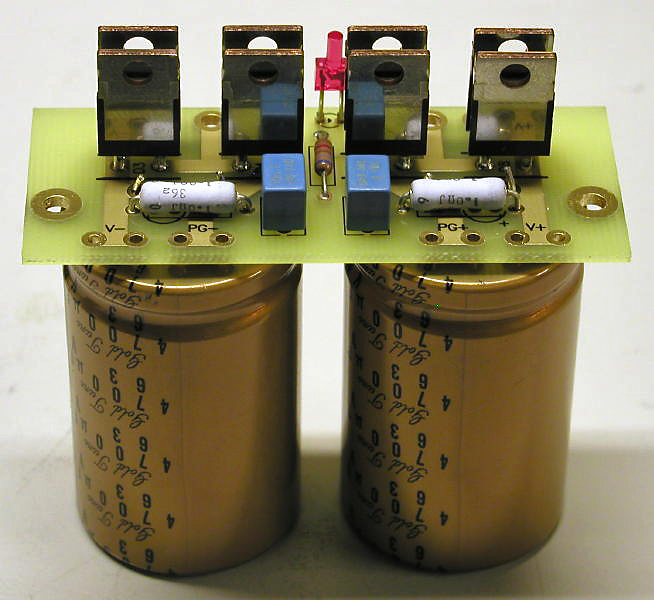

However, powering 2x LM4780 chips from a single PS with only 2 x 1500uF caps is a bit extreme, and personally I wouldn't recommend it.
Install bigger caps as per picture below (the picture represents LM3875 PS board where diodes are reversed).

What is the power rating for those 2 resistors sitting on top of the Cap? Is 5 watt sufficient?
How about the value for 2 blue cap?

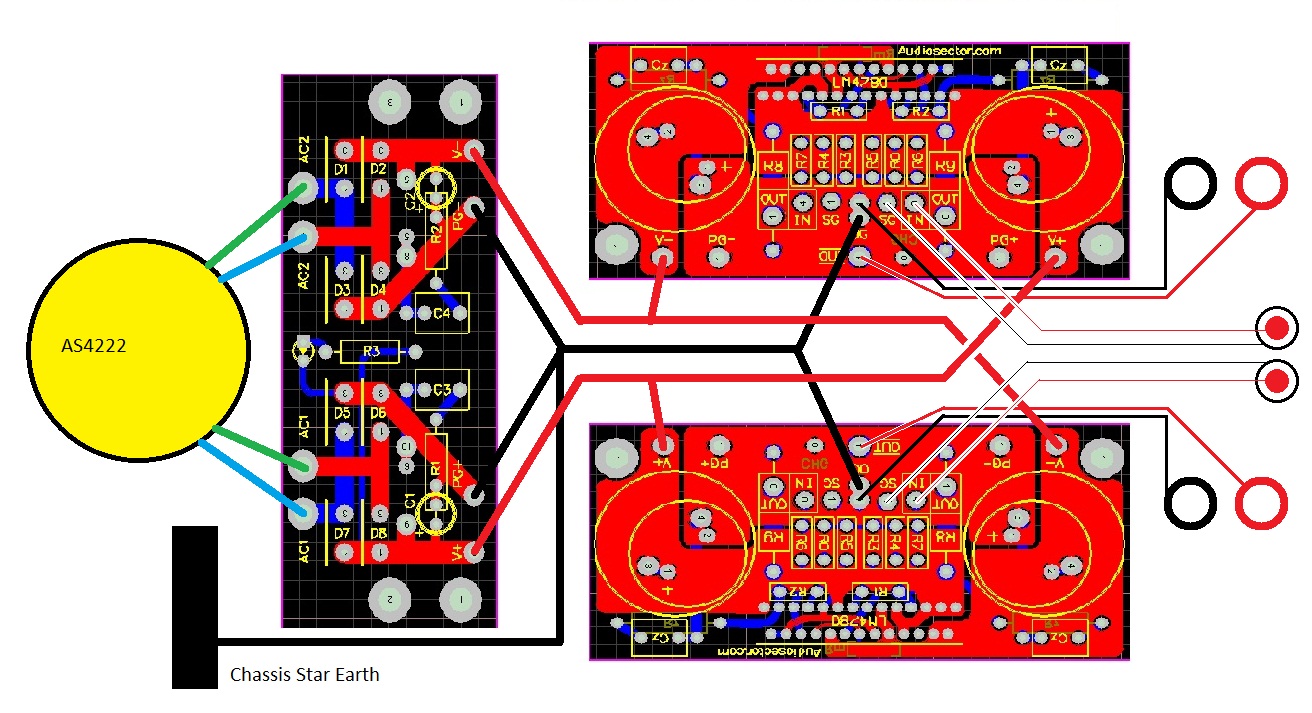

Well, it looks like I may have finally found the problem and need to run 2xAMPS/1xPSU/1xTrafo setup.
The Caps will have to be mounted externally so size probably doesn't matter.
It's listed on schematic here: http://www.audiosector.com/lm4780 psu.pdf
The resistors are 3W but 2W should work fine too
