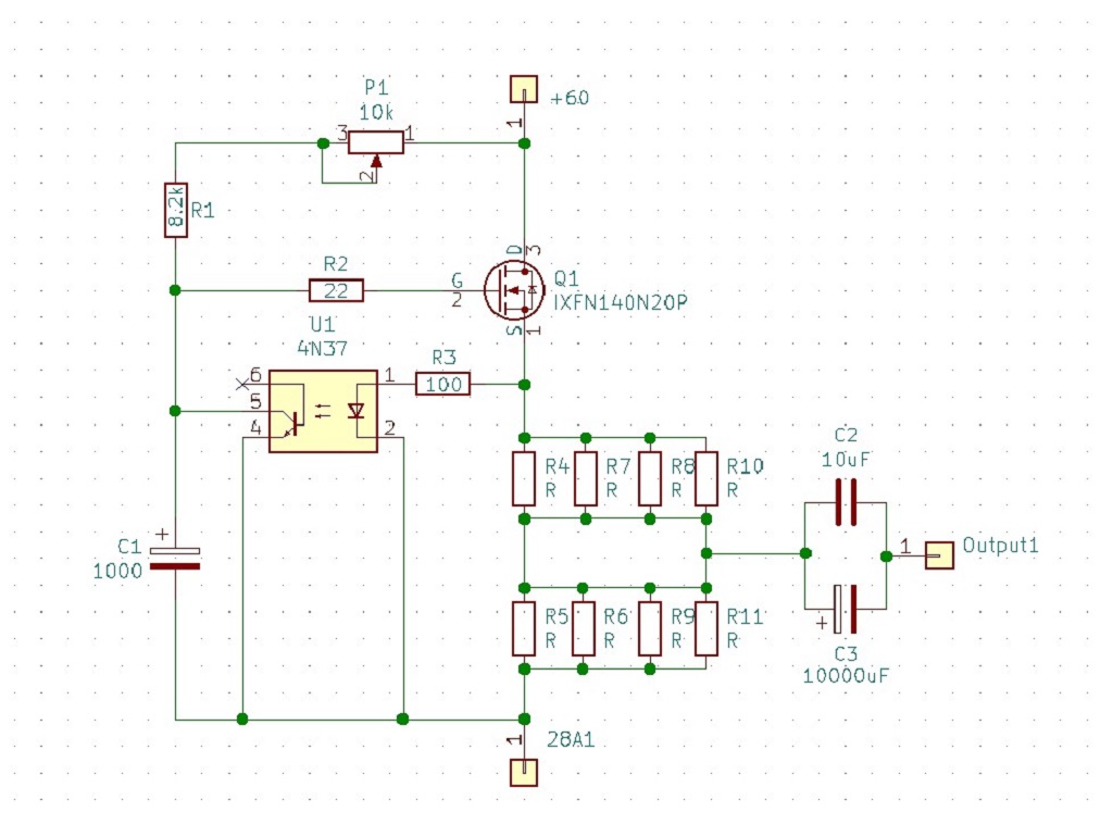

question...I've read the Tokin 2SK182ES needs to have it's bias supply on prior to applying power to the rails. As I'm using IXFN here, does this have that same requirement? I'd like to eventually use just one power switch when I finish the chassis instead of powering up things separately as I'm doing now.
If your main supply has lots of capacitance and your bias supply has much less, the bias supply will come up ahead of the main supply so one power switch should work. So that should work for the Tokin.
Another thing, the IXFN is an enhancement mode MOSFET so it is off until the Vgs comes up.

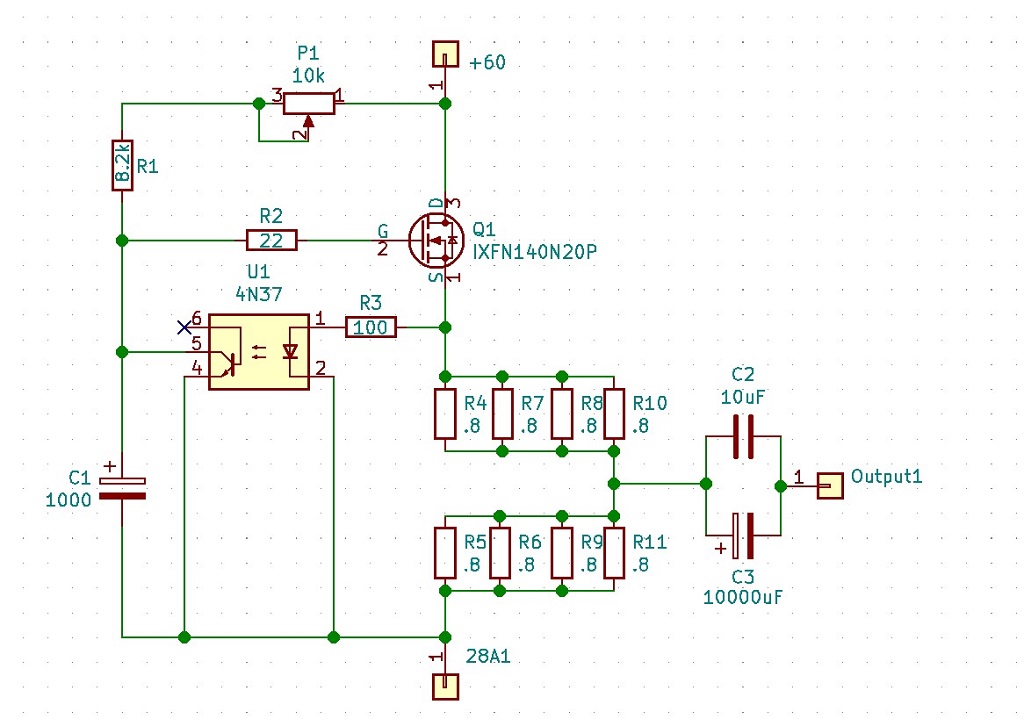

Why use so many source resistors ?
8 pieces for single channel 😱
CCS can be made with only two big wattage power resistors..
so is 12 pieces less (and 24 soldering points) for two channels.

On second thought, the 8x may cost less than the one BIG and I was trying to make my PCBs more flexible in case any of my forum members want to try some.
When completed, I'll probably order six. So I'll have a couple pairs I'd be quite willing to share.

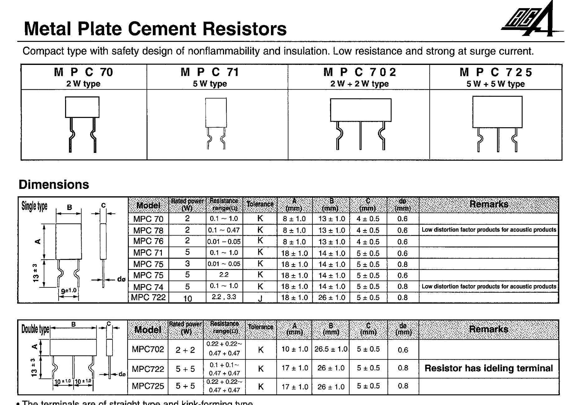

Bigger power resistors from Mouser | Digi Key for example Vishay| Dale cost is affordable.
Why is better to use only 2 resistors instead of 8 pieces ?

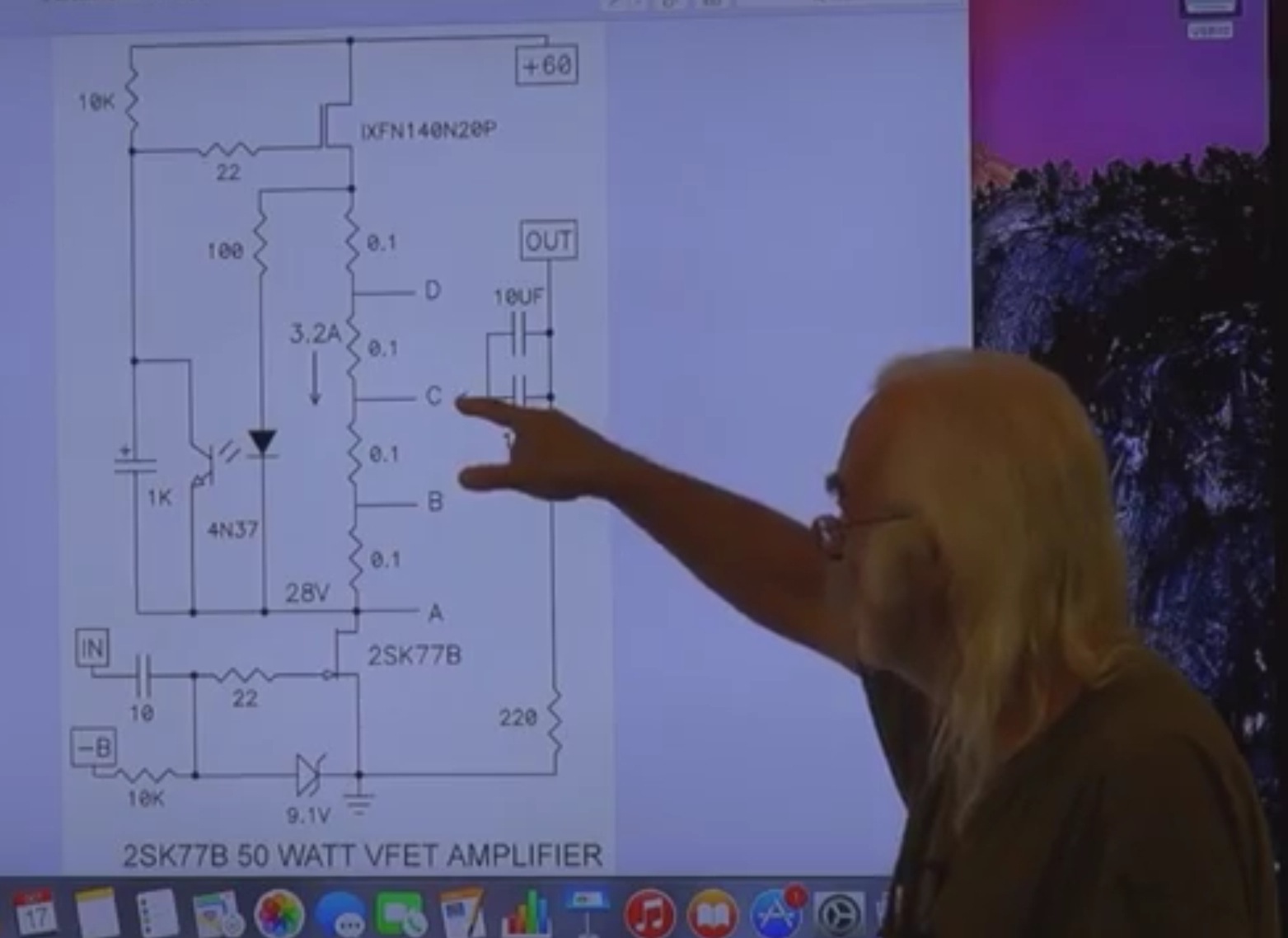

For flexibility, provide for six resistor in series, and for speaker out at each location between resistors. That will then accommodate six 0R1 3W resistors, which some may be shorted to vary the total resistance value.
The 0R6 is useful for the Tokin output version. I have also used 0R5 for my THF version although I am now using 0R6.
The option for different speaker out locations is also good for experimenting. I have tried different output locations and I am sure Soundhappy has too.
Armed with a USB sound card and FFT software, you can tailor the harmonic distortion to your taste by varying Iq, Vds, and speaker output location.

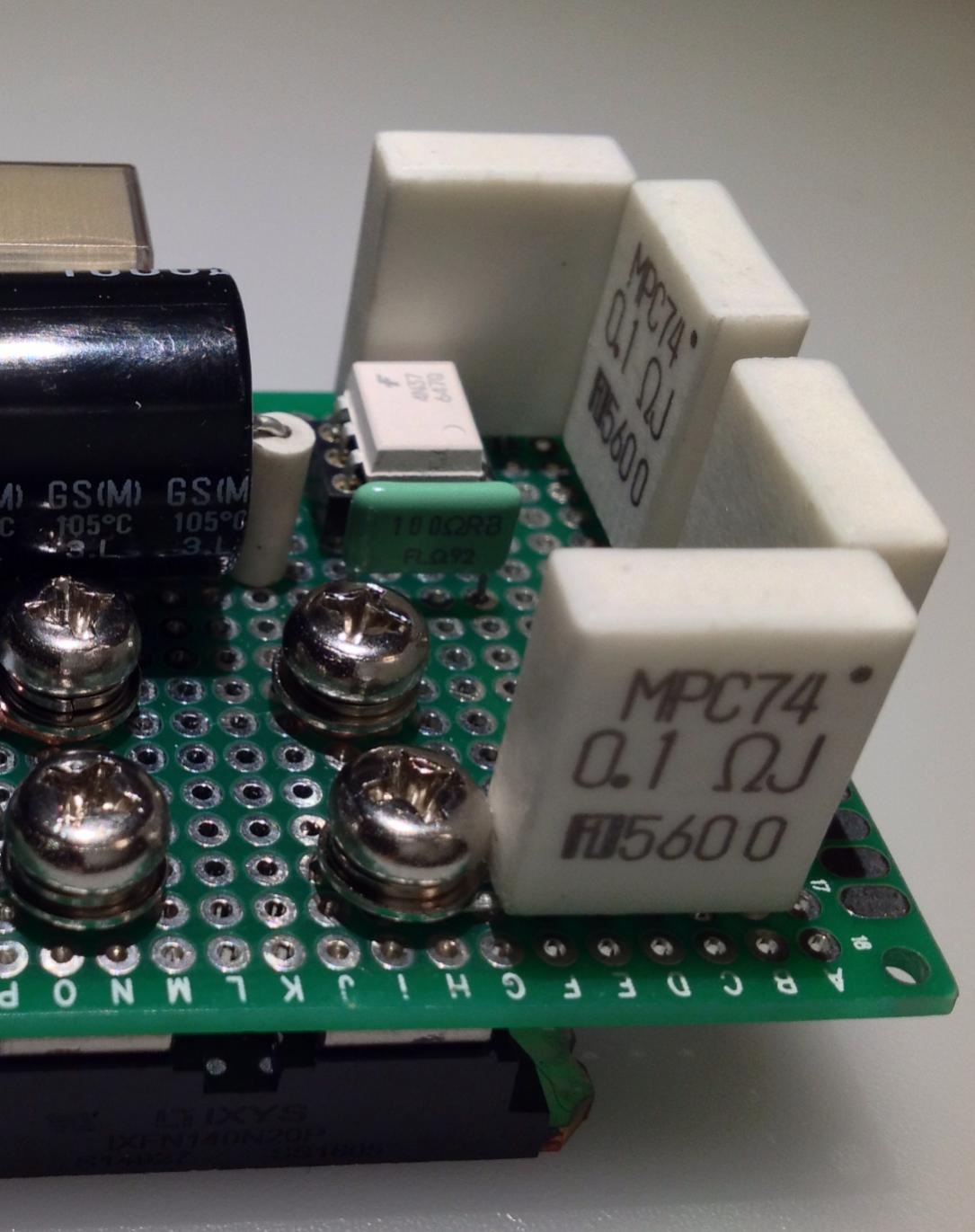

My build CCS are with 4 x 0.1R MPC74 but I do simplyfi this and use only one 0.2R insted of 2 x 0.1R..I was trying to make my PCBs more flexible..
so new version flexible CCS be 0.2R +0.1R+0.1R so total use of 3 resistors for one channel
but get possibilty to connection with C point ( more H2) or D ( dominant H3) sound.
Papa great CCS is the more audio modular version on the photos

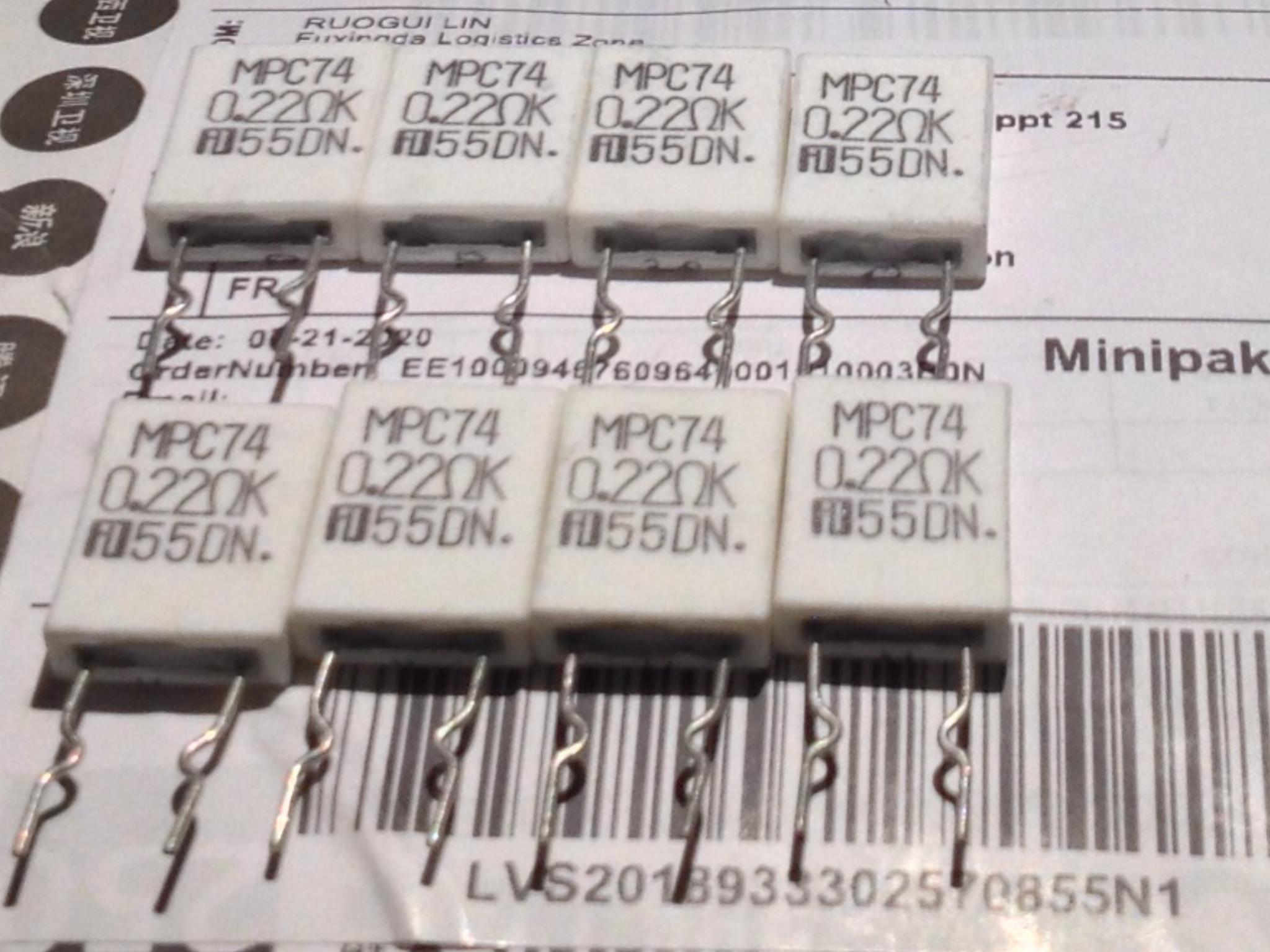

Fukushima Futaba MPC74 5W 0,1 Ohm 5% Metal film resistor 0.1 Ω Radial lead MPC74 5 W 5 % 1 pc(s) | Conrad.com
I get 20 genuine pieces from seller in China received last 10 days but temporaly out of stock try next week maybe ?
10pcs FUTABA MPC74 Series 0.22R/5W non-inductive resistance | eBay
.The 0R6 is useful for the Tokin output version. I have also used 0R5 for my THF version although I am now using 0R6.
Yes CCS resistors connected in series and different speaker out location
( + sometimes reverse speakers polarity's ) bring to music sessions more possibility's

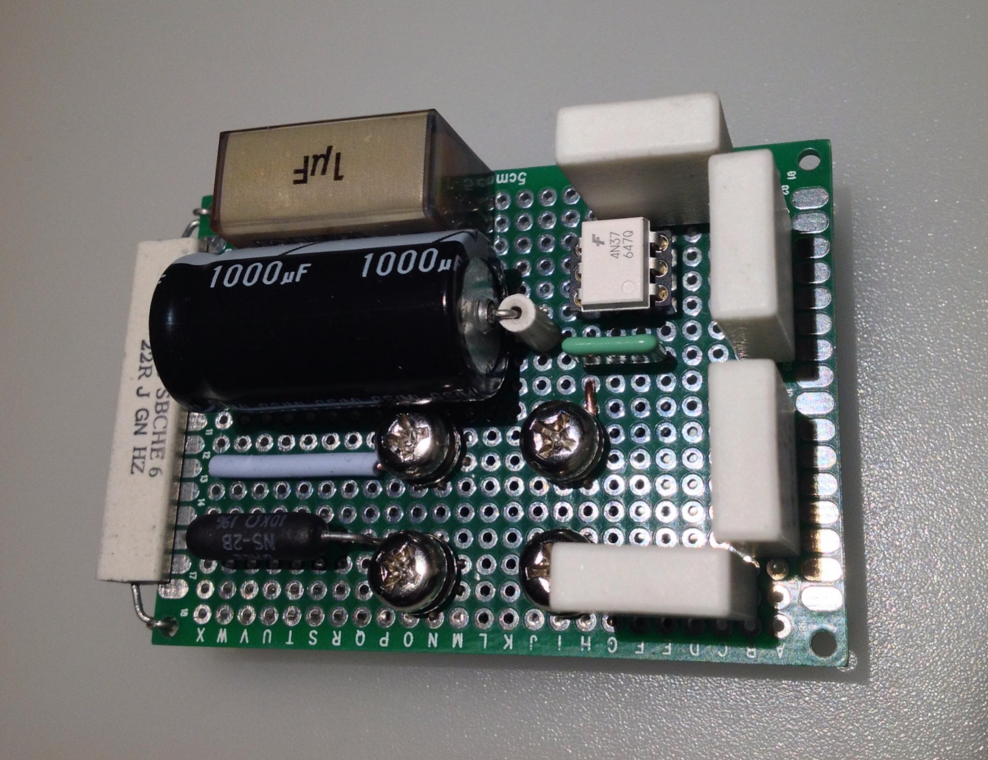

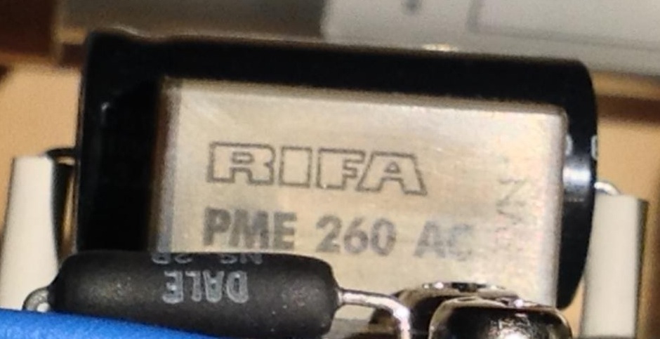

@Soundhappy, you sir are a component connoisseur! What kind of capacitor is that 1uf cap in post # 1236?
Jeffrey
Jeffrey

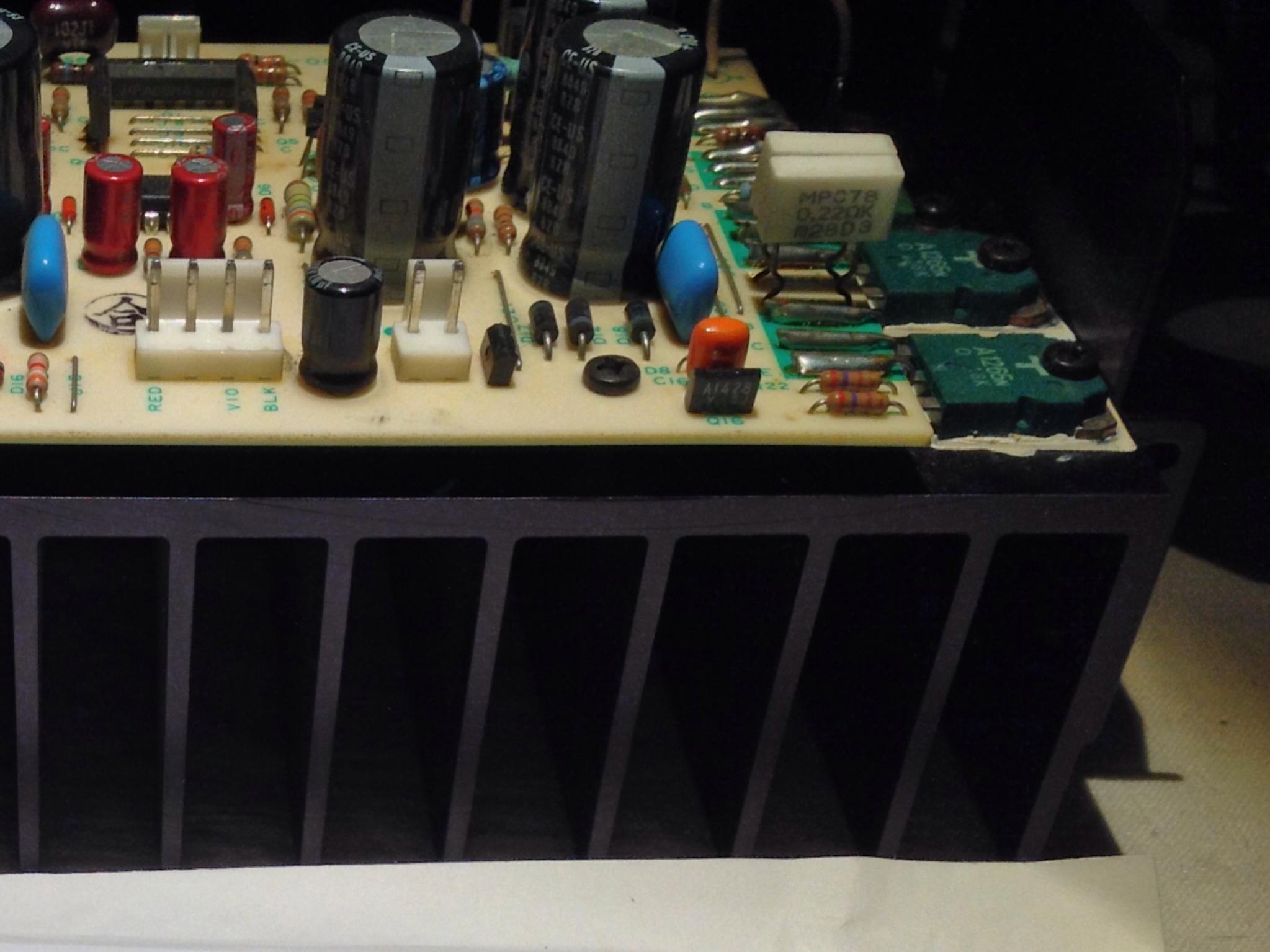

Only MPC78 (2 watt's) or MPC74 (5 watt's) are the best for audio.
Accuphase brand amplifiers use them
@ Jeffrey
Rifa PME 260 AC
@ Jeffrey
Rifa PME 260 AC
