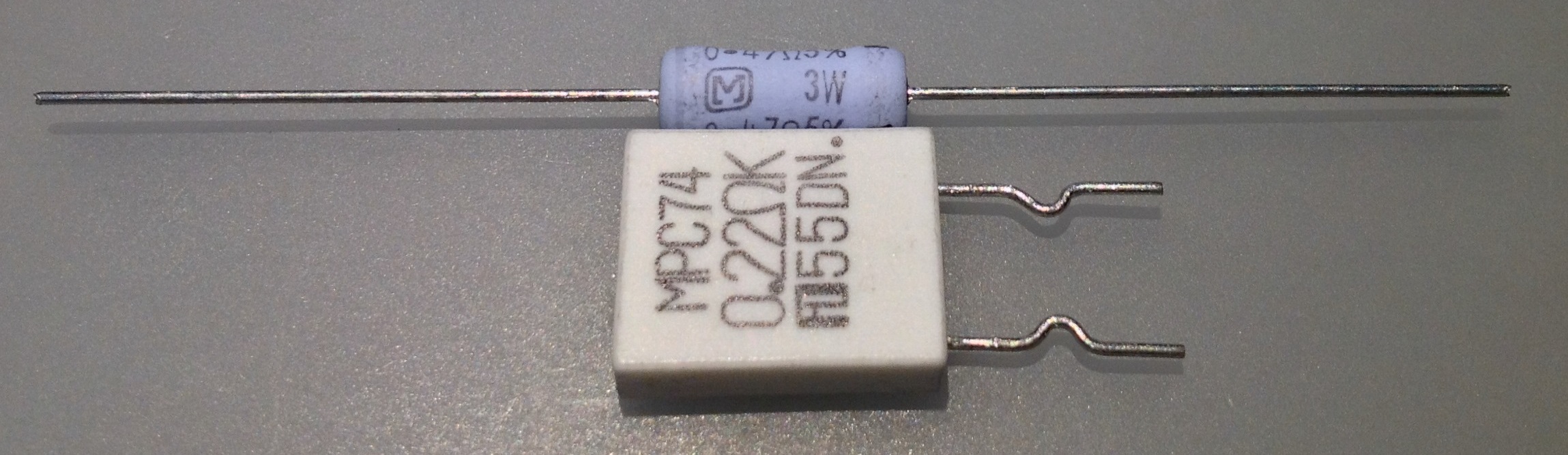

question 1 : 1W8 in one 3W or 5W MPC, or 5pcs of 3W MOX ?
question 2 : what's tolerance of 1 MPC, vs. 5pcs of MOX ?
question 3 : rather pushing 3A through tiny legs of one MPC, or 4 or 5times more MOX legs?
question 4 : rather pushing 3A through one pcb pad, or 4 or 5pcb pads, when you have choice?
question 4 : ever saw MPC inside, after 10yrs of work in mild class B conditions, with certain 20 occasions of amp abuse? ?

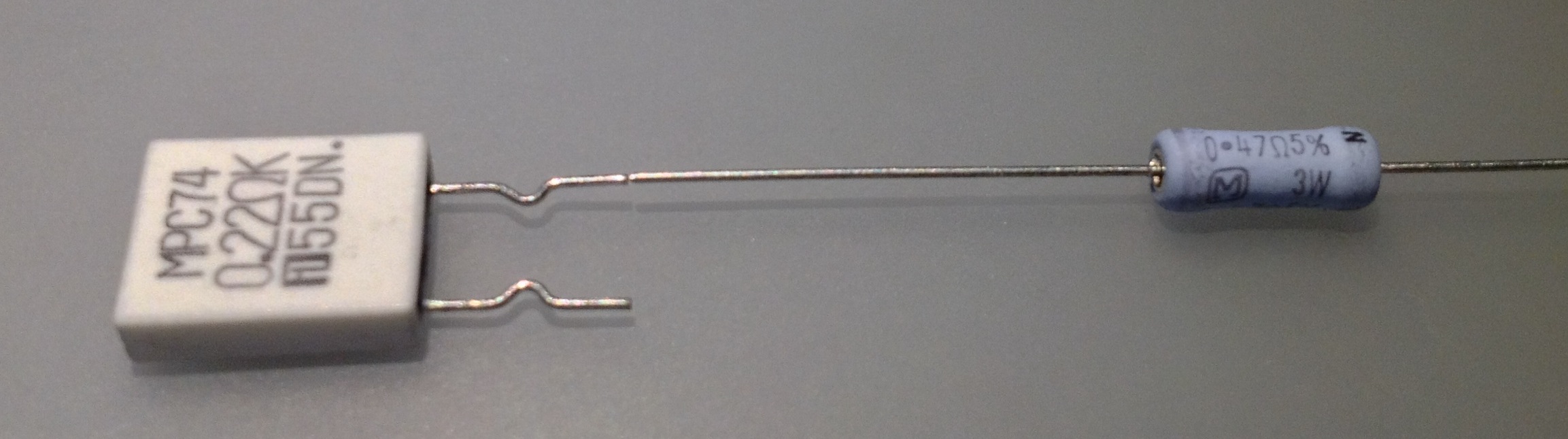

Answer 1 : I do use minimum number resitors with adequate power dissipation better 1 or 2 less noisy
than 5 pcs. metal oxides in audio path.

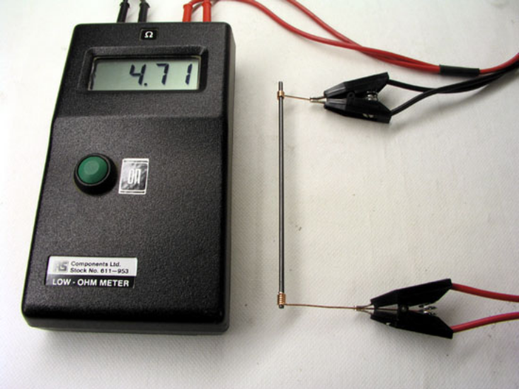

Answer 2 : MPC74 are in tolerance the same like 5% MOXide ,
with Kelvin 4 wires resistance test they are equaly in specification with 1% Caddock values.
Metal plate inside is easy to get cut with lot of precision.
They mesure much better then show in datasheet.
Answer 3 : You can do it with two thick legs, Papa CCS original schematic.
Look at the photo MPC74 are not thiny..
Answer 4 : for very high current I do rather use resistor model out of the pcb board pads the one with small aluminium heatsink.
Answer 5 : non

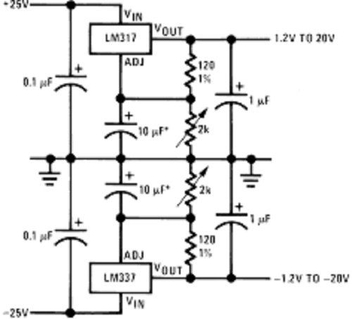

just tie those 18 and 12V, common tap is to connect to main GND
after rect. and smoothing you'll get unequal rails, but no problem for regs, current is tiny anyway
sole TL431 regs, for buffer rails - not to my liking, not enough current capacity there
use LM317/337 , don't forget to shunt their outputs with additional 15mA , buffer itself is small burden
Too simple a circuit for my buffers?
