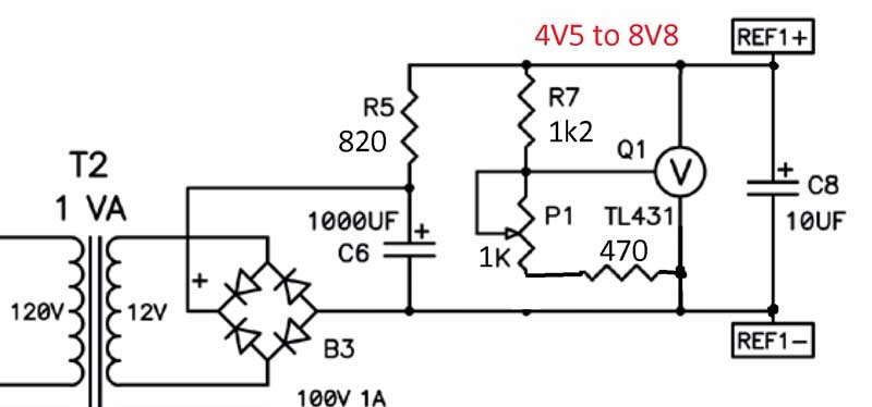

Using one of these for each channel AN-8445 - 800VA 45V Transformer - AnTek Products Corp. Thinking of building four of these TL431's. One for the bias of each channel and then a second pair (with values adjusted) to supply the +/- 12vdc to each buffer.

just tie those 18 and 12V, common tap is to connect to main GND
after rect. and smoothing you'll get unequal rails, but no problem for regs, current is tiny anyway
sole TL431 regs, for buffer rails - not to my liking, not enough current capacity there
use LM317/337 , don't forget to shunt their outputs with additional 15mA , buffer itself is small burden

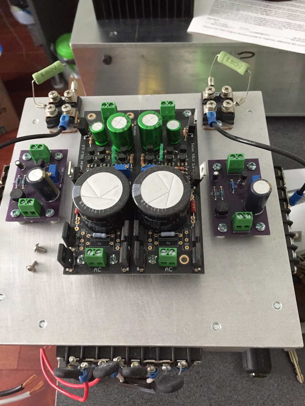

Two lucky breaks for me as seen in the picture below. The two outboard PCBs are the TL431 bias circuits and I have spare PCBs if I want to make up a set that has a different voltage range. Also, ZM suggested a regulator with more current for the buffers. Although a little overkill, I just happened to have a pair of SALAS regulators kicking around so in they went.

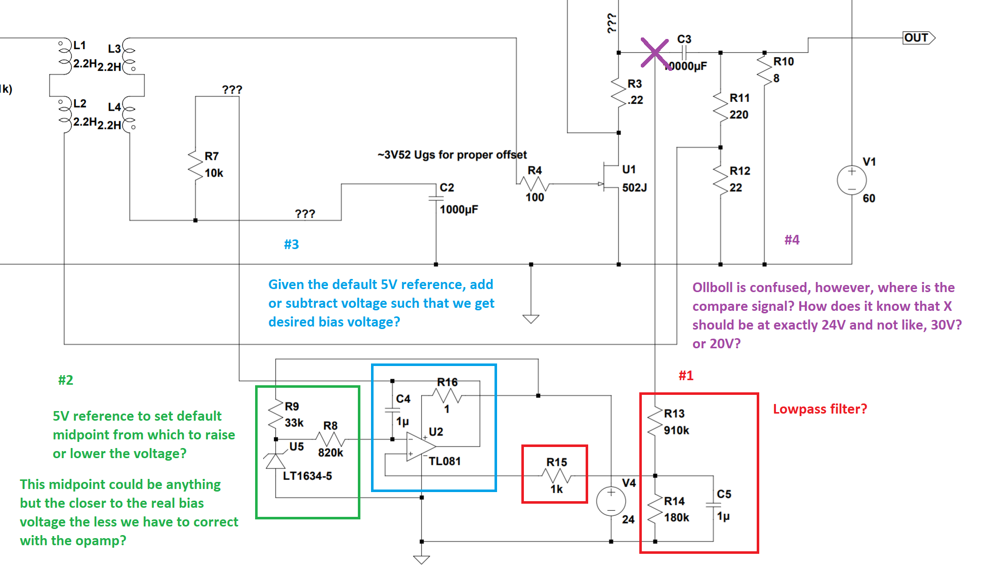

I tried again and did find a mistake in the servo circuit in #1190. I switched in the inputs of the TL081 opamp. Even with that fixed it still didn't work. The 5v regulator seems to create a 5v reference so at least that part seems to work.
Worth noting also that at the moment I'm not using beast mosfet or R100s but rather IRFP150s both for top and bottom.
Which makes want to start asking about how the servo bias actually works so I can try to understand what is going wrong:
My guess of how it works is:
#1 is a lowpass filter since we want to correct only the DC.
#2 the 5v reference creates a kind of default midpoint. This could be any voltage but close-ish to target voltage is better since then the TL081 has to correct less?
#3 The TL081 opamp outputs the difference from the 5V midpoint to the X voltage and outputs this as the bias voltage?
On #3 is where I don't really know what happens. Mostly I'm confused since the servo bias only really has a single input, X. How does it know to make the bias exactly such that the voltage at output is half of the rails? Shouldn't it need some input of the "ideal" voltage target such that it knows when to stop?
Now that I think about it if I remember correctly I got 6V difference from GND with +- 24V rails. Maybe if I learn how to set the target voltage I can get it working.

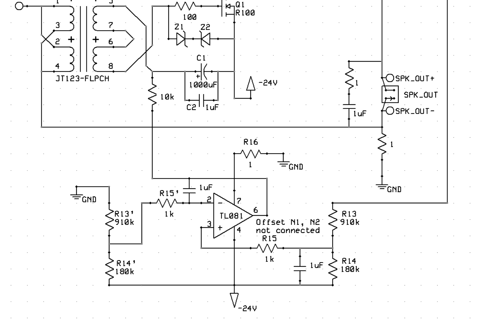

Cool, I think I understand now:
So basically R13+R14 works as a voltage divider translating 30V -> 5V. This is then compared to the 5V refence.
One further thing though:
The TL081 maximum voltage is 36V so if I feed it with +-24V it will probably not feel that well.
I believe I should be able to counterract this by just keeping the opamp at -24V to 0V and then shifting the input voltages down towards -24V.
This schematic uses the same attenuator as yours and shifts the voltage down by 1/6. My guess is that if I find it too slow during startup I could make R14 = R13 making the attenuation 1/2.

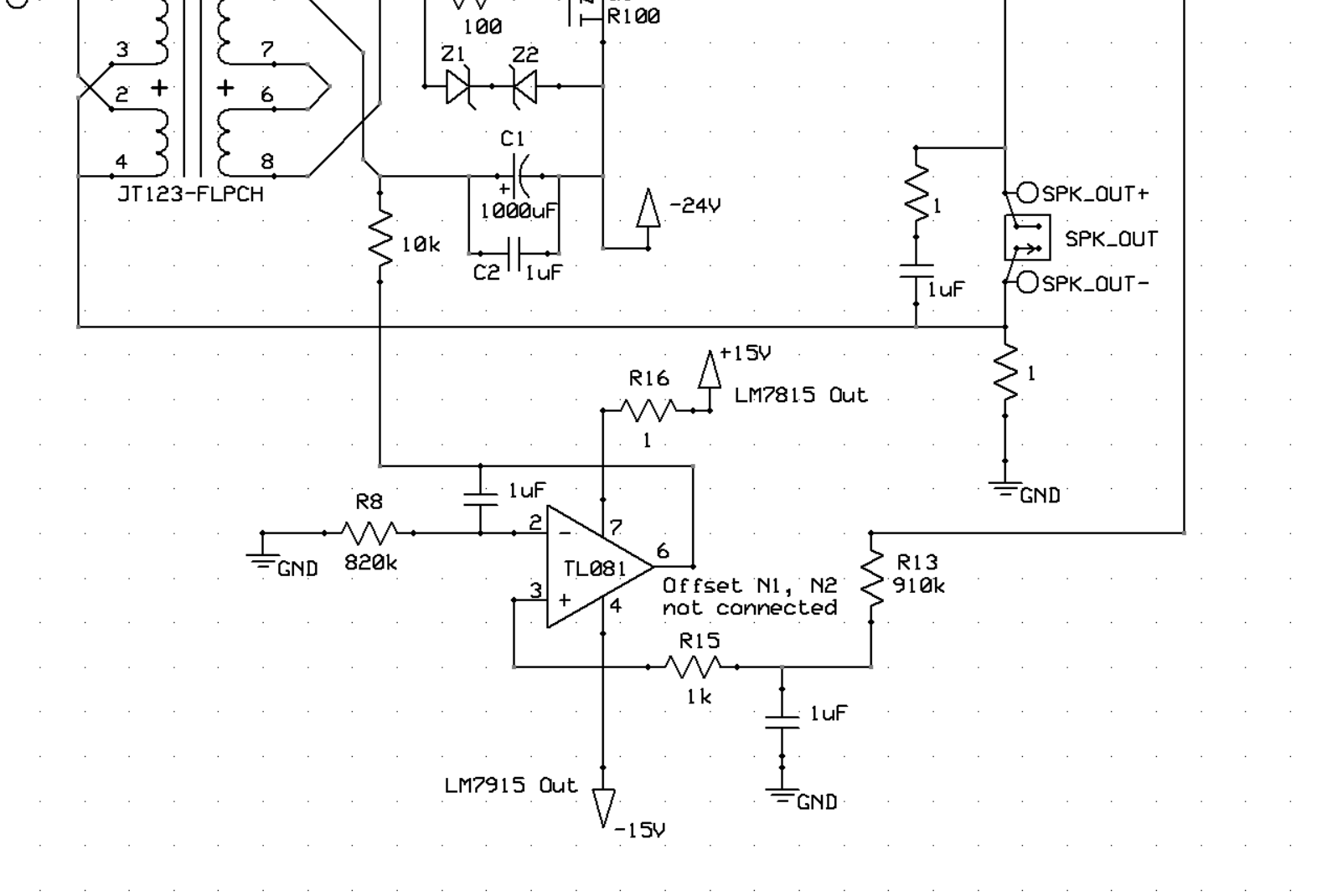

nope
read again what I wrote
use 7815/7915 to feed OP, and do with resistors as I wrote
can't catch what you want with 1/6 of negative !!! rail at ref.side of servo, when you want 0V at output node ?
put ref input to gnd, sense input to output node, and funny critter will do everything in its power to equalize what's on its inputs

It seems I did not understand =)
Next try:
