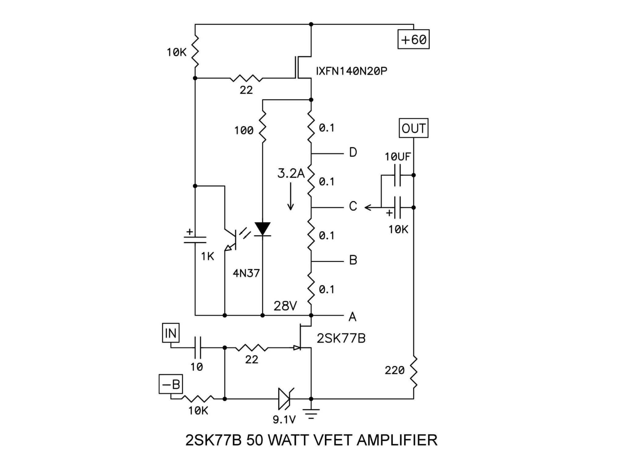

I got one of my signature potentially dumb ideas again!

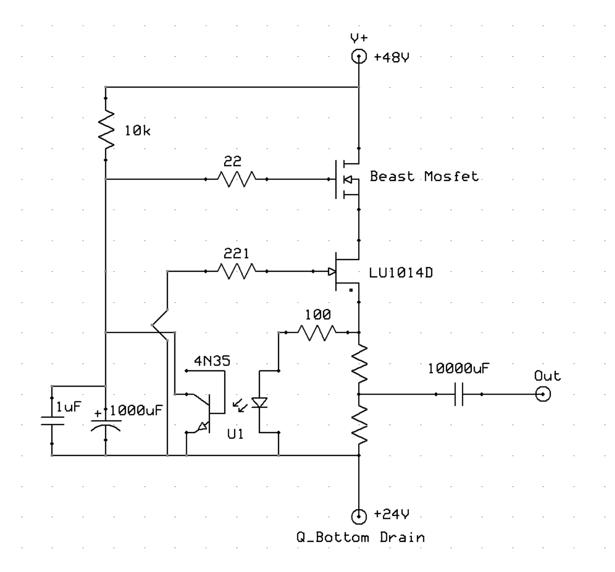

I've been toying with the idea of doing a cascoded version with maybe a 2sk82 on the bottom but I know how to do that and how to get it to work.
My question is if the opto CCS will work with say Zv9 cascoding out of the box or if I need to use a more fancy biasing scheme. I asked a while ago about using an optocoupler on the bottom and it was a certified dumb idea there, so it might be the same here =)

It wont work like that, in this case, optocoupler is not regulating the bias, but Vds of lower jfet..

I think it will work. Controlling the Vds of the LU1014 will regulate
bias since that Jfet has high current dependence on Vds at lower
voltages. Of course you have to ask whether that is more effective
than just controlling the big Mosfet directly.

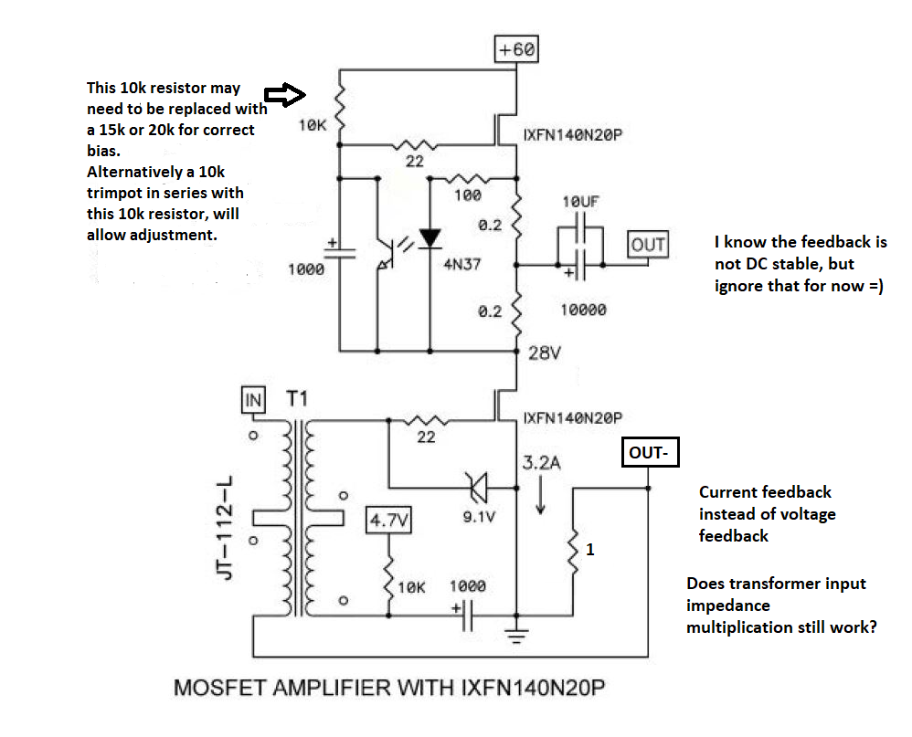

Another thing I've been wondering:
Does the transformer input impedance multiplication trick still work when using current feedback instead of voltage feedback? I want to build a current source variant as my speaker likes high output impedance.
Hockey pucks look kinda fun though... so would be cool if it works in that configuration too =)

But isn't the optocoupler doing just that, controlling the big mosfet directly since the Jfet gate is connected to the bottom of RS and not the top of the opto?
If I've understood correctly the schmatic should with respect to DC be equivalent to the normal opto circuit but with an extra current dependent resistor between RS and the CCS-mosfet source.
Or at least, that is what I hope it does, but that does not mean it actually does 😉

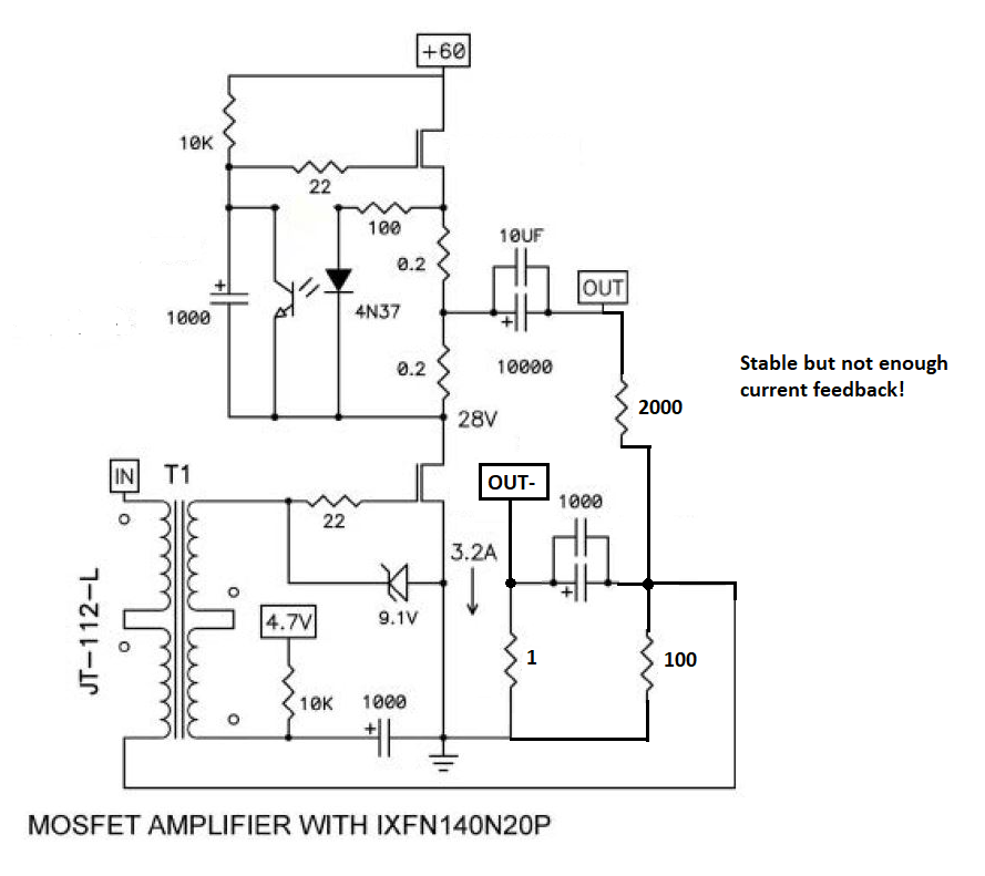

In my experiments I have gotten the circuit to kinda work with current feedback but at the same time kinda not.
I got the circuit stable, but that's not saying much as the amount of current feedback actually used was pretty low. I got maybe 3-6 dB of current feedback which is a bit less than I want =)
It works perfectly If I increase the R of the current feedback resistor but I have 4 ohm speakers so even 1 ohm is pushing it higher than I would like.
So my take on it is that I want to amplify the voltage across that resistor before feeding it back into the input transformer. My first idea was to use a simple jfet but then it inverts the phase and I have to fiddle with DC offset.

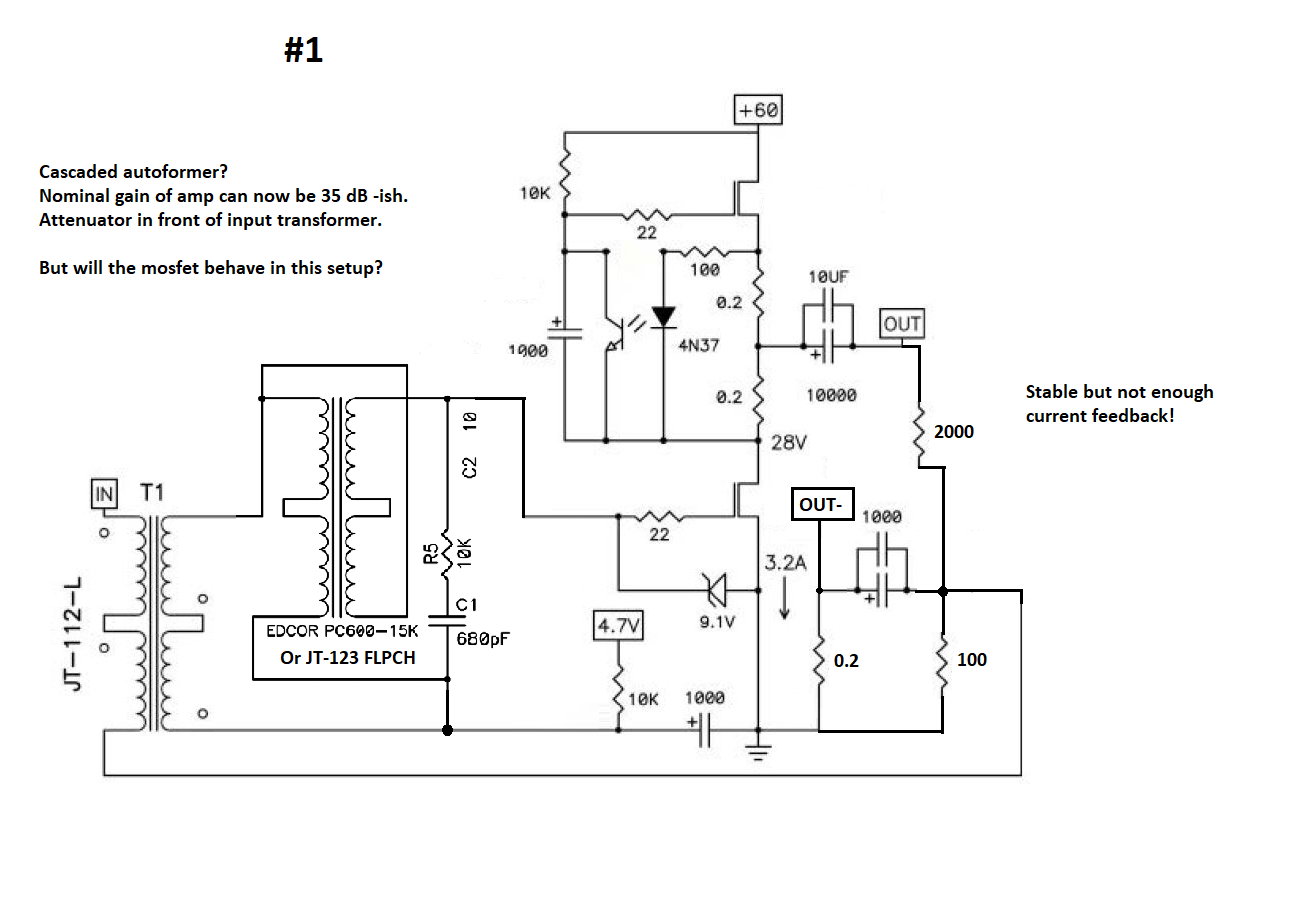

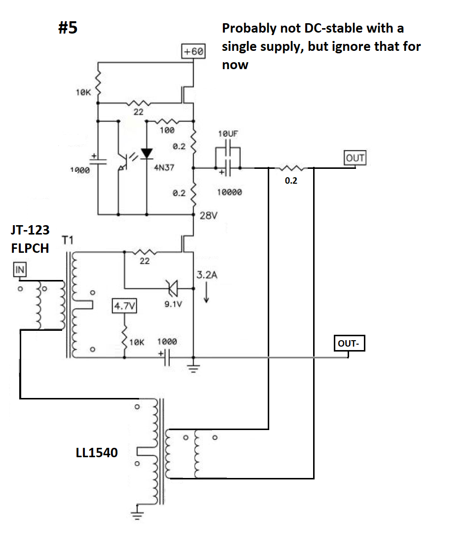

Then I got one of my certified crazy ideas again: could I just use more transformers?
I have quite a few Lundahl LL1540 which are pretty similar to the Jensen JT-123-FLPCH and 2 Edcor PC600-15K lying around anyway =)
This adds more impedance matchings though so I'm not sure it will work.

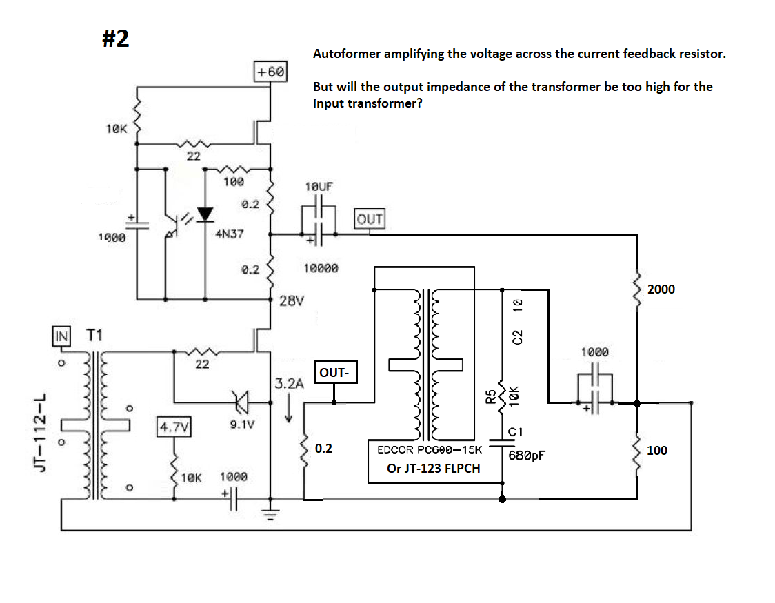

#1 is to raise the gain of the amp to ~ 30 - 35 dB and place the transformer in between the input transformer and the mosfet. In this case my guess is that the increased capacitance of the autoformer will wreck havoc on a beast mosfet or even a normal mosfet like the IRFP240 in common-source mode making this a non-option but might as well throw out the idea for review =)
#2 would be to amplify the voltage across the current feedback resistor. Will the input transformer play nice in this case though?

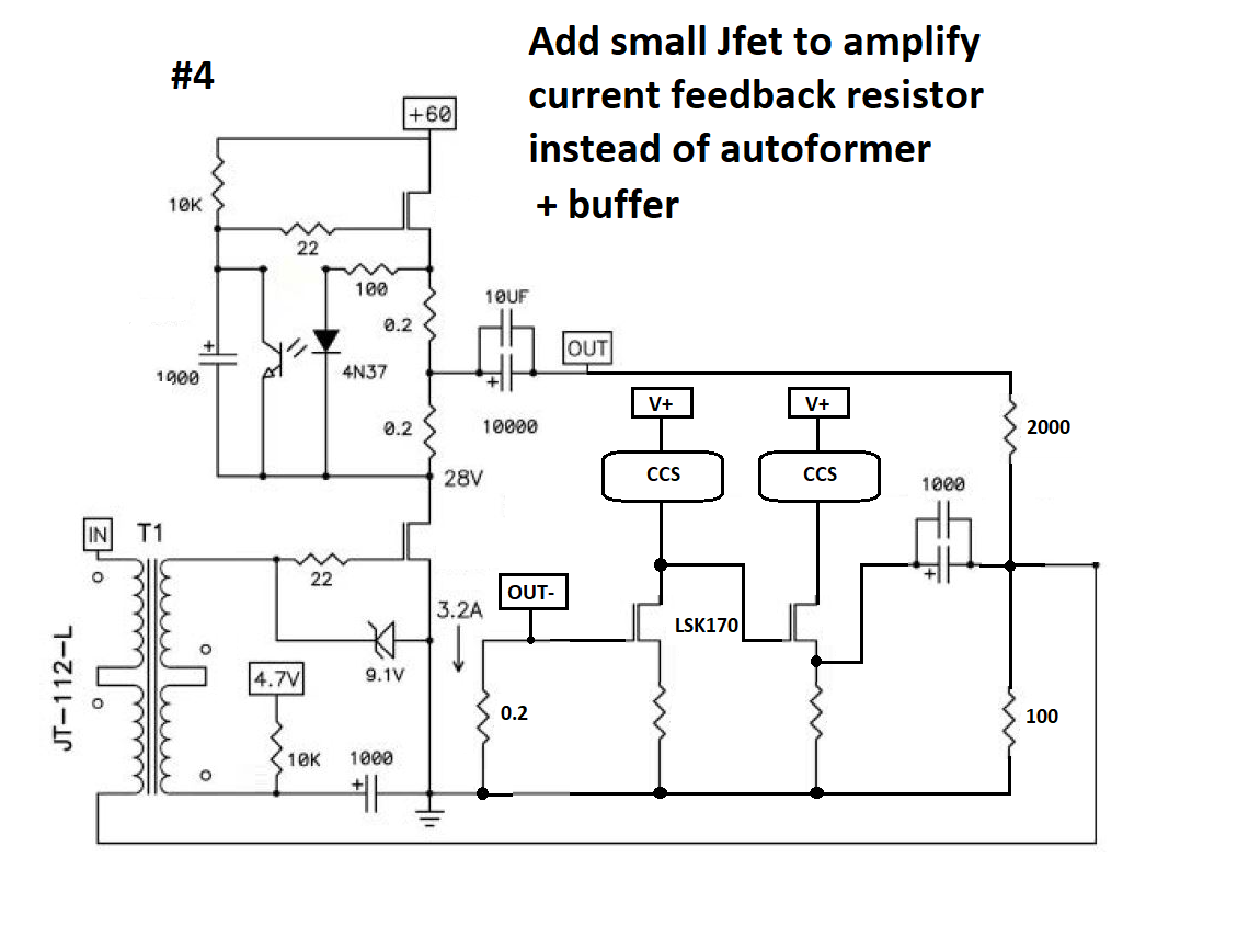

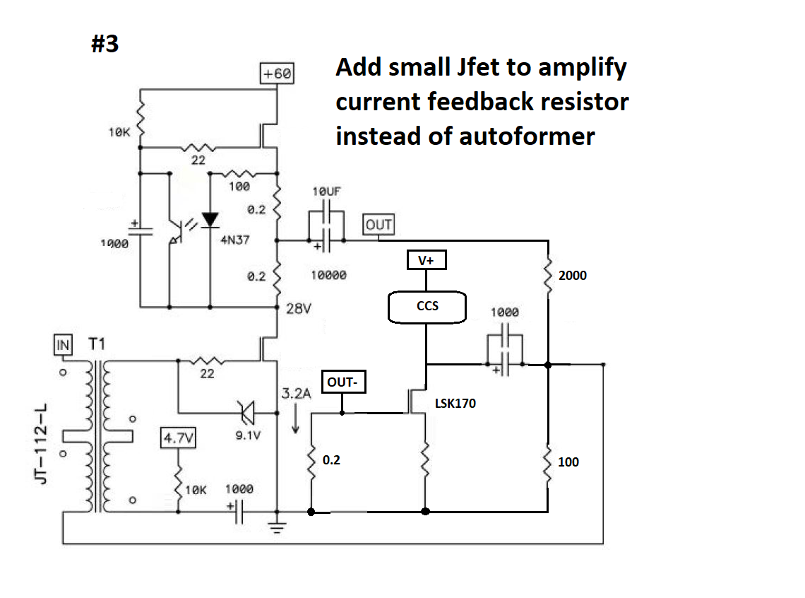

Might as well post idea #3 and #4: adding an amplifying jfet and in the case of #4 also a buffer.
But thats way more complicated than just using transformers. It makes a beautifully simple circuit not as simple and beautiful anymore.
And something I forgot in the schematics: I will fiddle with making the input transformer parallel instead of in series, as effectively increases the current feedback voltage : input voltage ratio. On my F6 amp that worked but I had to use an 1 ohm resistor to get enough feedback, so these ideas are still valid as they would let me reduce the resistance of the feedback resistor.

Swap positions of the current feedback resistor and speaker in post #1147, you may have to attenuate it!
But won't that just make it a normal low-ish output impedance voltage feedback amplifier? Since then the feedback signal will correct the voltage over (speaker + resistor) instead of just (resistor).
Won't it be pretty much the same as If I used the normal voltage feedback schematic and added a series resistor to the output to raise output impedance to the value of the resistor?
As I see it, if you look at the speaker and feedback resistor, its a potential divider between the output and ground. Flip it upside down and its still a potential divider, all that's changed is the ratio.
The feedback to the transformer is a voltage, it always was.
It's current feedback because you are monitoring the voltage developed across a resistance caused by the current flow.
Having said that, because the impedance of the speaker is not constant with frequency, the feedback signal will vary, flipping the position of the resistor and speaker will cause the variation to invert.
Sure, but the feedback I want to send to the input is the voltage across that resistor, not that resistor + voltage across the speaker which as you said varies.
I could flip it to the top but I still only have the voltage across said resistor to play with. And since now the feedback voltage is now floating above ground I'd have to use a transformer to bring it down to ground reference for the input transformer.
And while I could get ground loaded operation that way instead of having the speaker float above ground, I'm not connecting the speaker to anything afterwards so a floating ground isn't an issue. It would make design phase easier though as I would have an easier time measuring as I don't have to fiddle with transformers for my sound card =)
The voltage would be across the speaker, not the resistor & speaker.
The voltage varies even if you measured it across the resistor.
Yes, but the voltage across the resistor varies only as a function of the current through the speaker. The voltage across the speaker varies as a function of the current & the stroke position.
It is this stroke impedance variation I want to correct with the current feedback, hence I want the correcting signal to only be dependent on the current of the speaker -> voltage across the resistor.
Which in practice means I want the output impedance of the amplifier to be large relative to the speaker, ideally 10x or more. Thus the input signal controls the current through the speaker, not the voltage across it.
