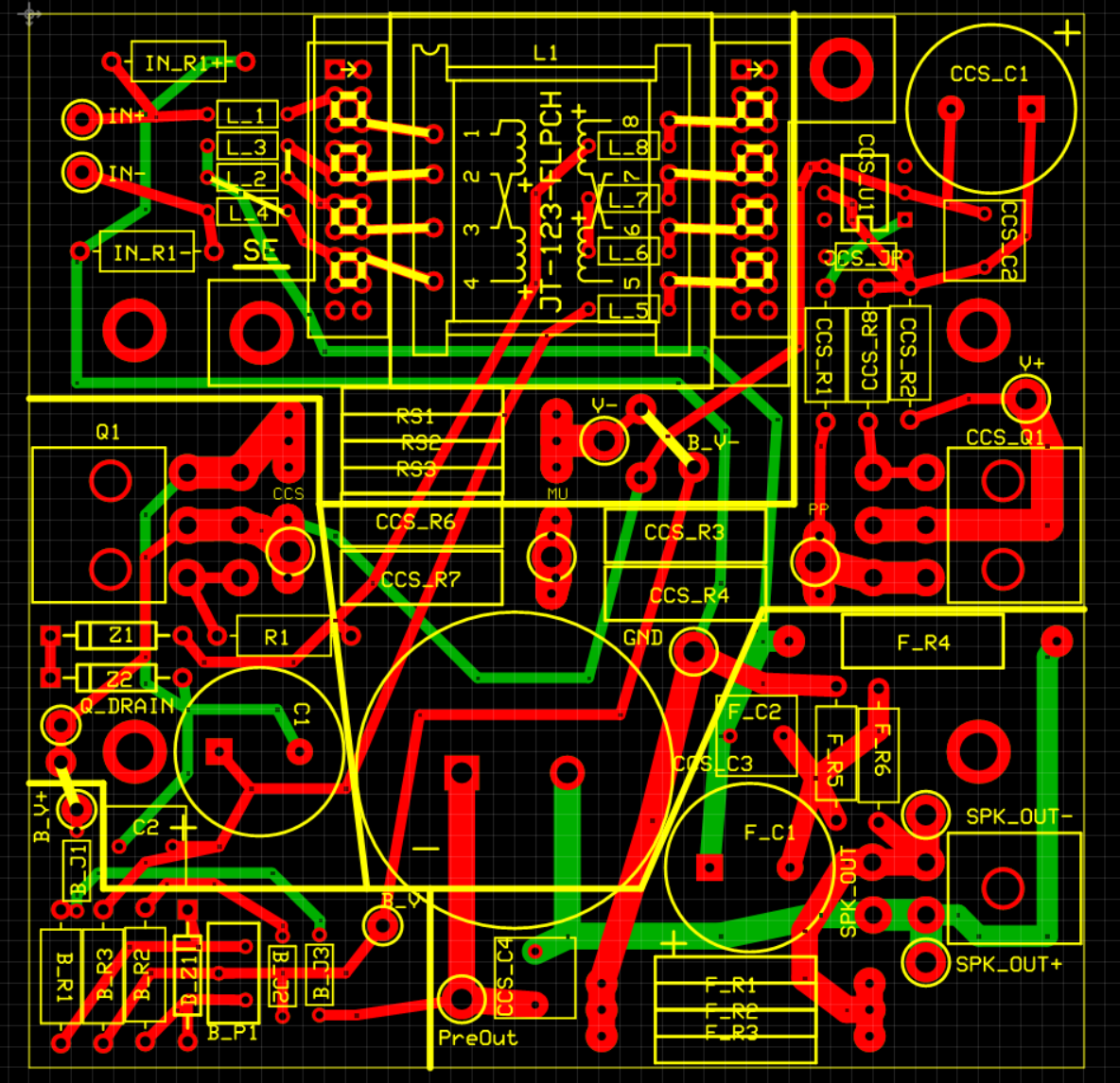

I have some boards I made. I got an amp working but it currently has more distortion than I expect. Probably havs something to do with my source impedance though as the circuit seems to work just fine. I only built genergs variant for IRFP240 / R100 though but apart from swapping som values here and there the wirings should be the same.
Only error I found so far is that the cap CCS_C3 has the wrong polarity. The transformer silk screen is also wrong one some pin winding polarities but If I remember correctly the actual wirings are correct.
The schematic is more complicated as I wanted it to support using mixed mode feedback (which also worked great). Also I wanted to test different biasing networks hence all the jumpers so I can test for example depletion mosfets without needing a new PCB.
The transformer I used is the JT123 FLPCH. I used a standoff board for the transformer. CCS_JP is also something I copied from the incorrect schematic and should not be connected =)
Input can also be configured to use balanced input or single ended depending on which jumpers are connected.
While I can't guarantee the quality of the boards as I am no board expert I do have an excess of boards (price for 10 was same as 2) and can send you some for shipping costs if you are interested. I'll get access to my work bench next weekend and I can start digging in the PCB shelf to see if I can dig up some transformer boards, I should have an excess of them too. Those boards should not be absolutely needed though as the transformer can be soldered directly to the board but personally I liked having the option to swap around.

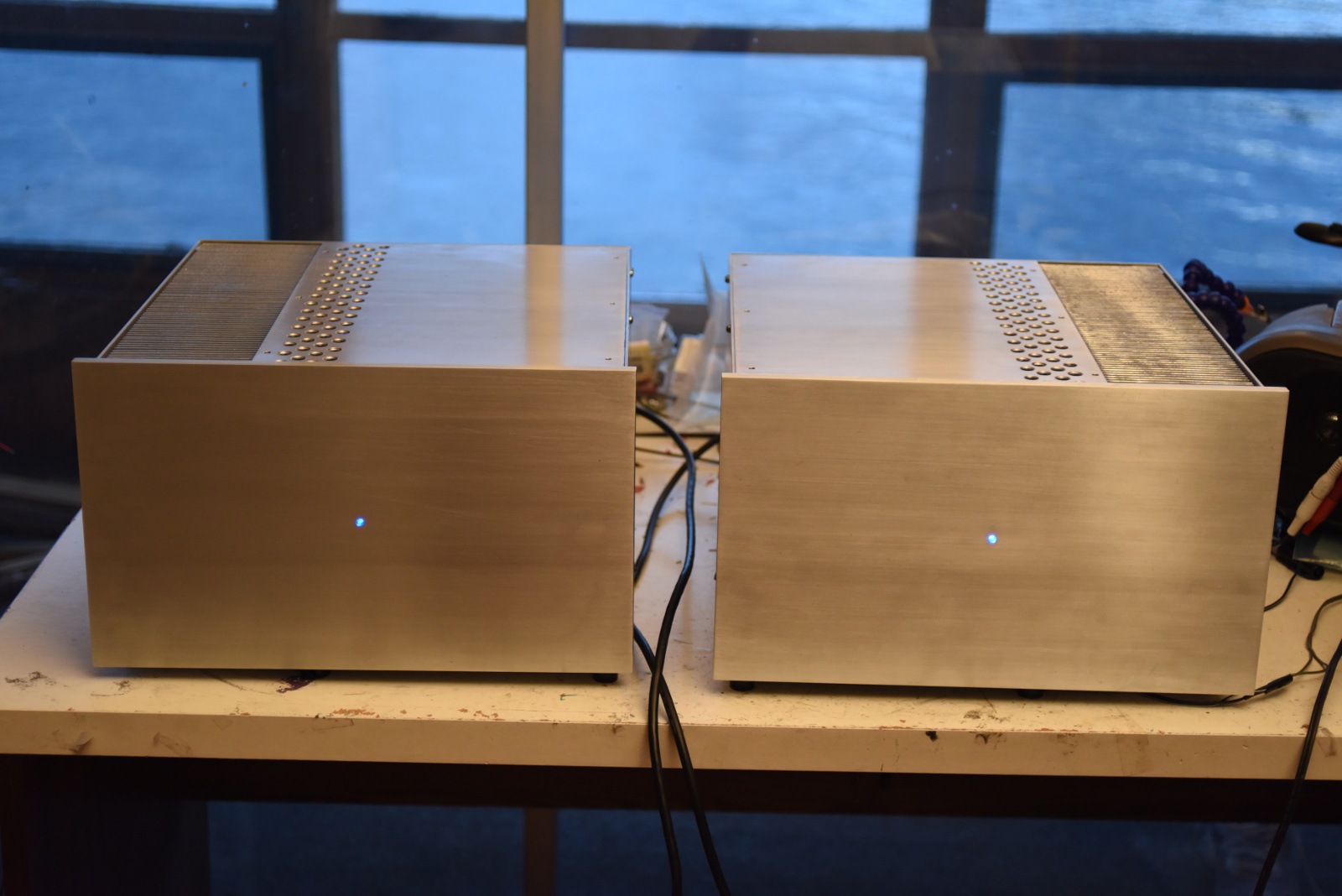

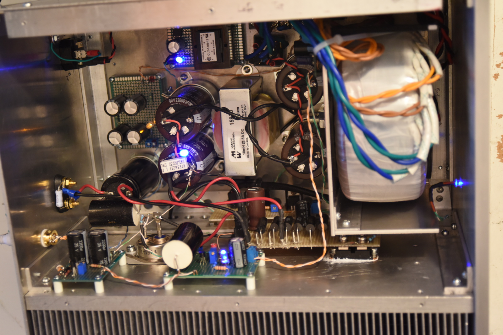

I have finally finished my THF-51S version of the BAF2015 amp. It took a while because I managed to destroy a THF-51S and a IXFN140N20P, and getting a replacement THF-51S from Pras in China was slow because of shipping problems due to the pandemic.
The device failures were not caused by wiring error but by layout issues. The amp was running for a while before things came to an end. The case of the capacitor across the emitter and collector of the 4N37 was too close to the metalwork and eventually shorted to ground which overbiased the IXFN140N20P. It then failed and shorted, which in turn caused the THF-51S to fail. Another learning experience.
A quick review of the amps. They have forced air cooling using 3 computer cooling fans per monoblock running at low voltage. They are very quiet and the amps run cool. I've added a B1 R2 buffer at the input so I can use these amps with a variety of preamps. The main power supply is CLC and the amps are very quiet.
I have not installed them in my main system yet. Ultimately, I will use them to drive JBL 2226 in 9 cu. ft. boxes in a biamped system.

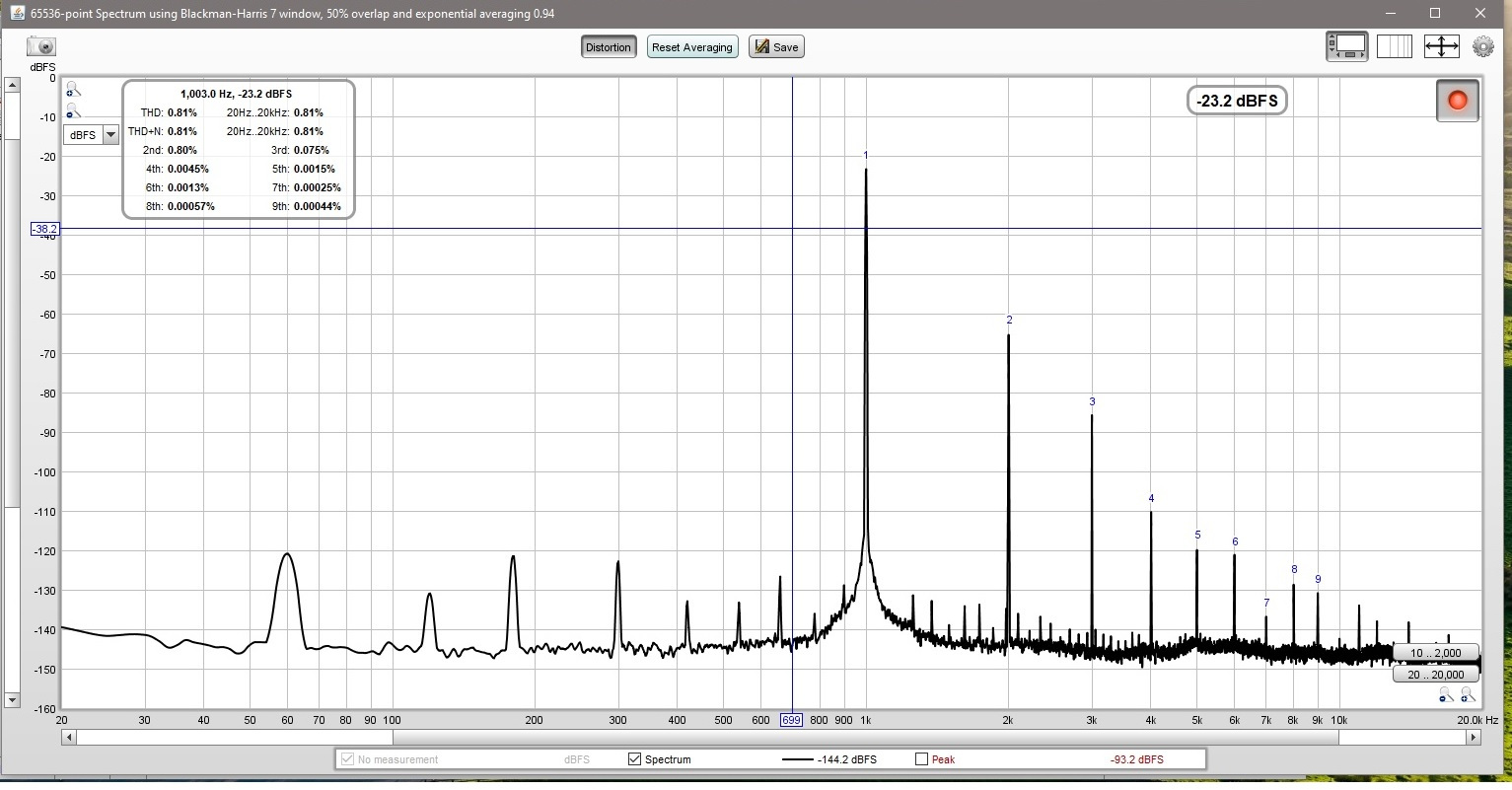

I ran some tests on the new amps and measured distortion at 1 watt output. Both amps were very similar.
