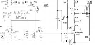

if not previous history (diddleedee when making an amp) , there is no logical explanation why opto goes Dodo
it is protected as rare bird , simply having that enormous capacitor across optotransistor , so any voltage change is sloooooow and it's never higher than Ugs (of puck) plus voltage across source resistors ....... so , pretty much under 6V
and it's declared 70V c-e

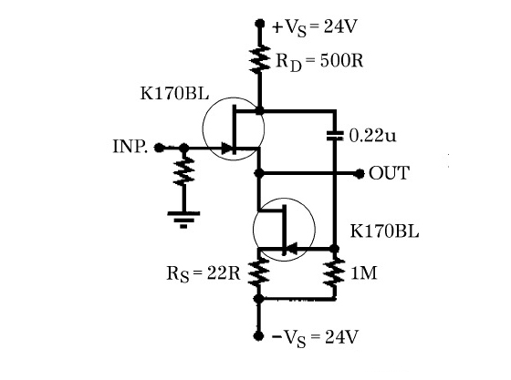

Something else: has anybody tried an input buffer made of J113 like in the
B1-NUTUBE-pre for this amp?
Or has anybody thought about a white-cathode-follower -like Erno Borbely
made it- as input buffer?

if you did read my musings about Erno's WC follower , used as option in SissySIT and Babelfish M25 , you could see that I found WCF being "better" than regular plain buffer only when heavily loaded
when loaded sanely/lightly , as most is the case , it brings just more THD ........ which is simply too much of good thing when Sissy is in question amd , most likely , even worse case here
try it , to hear do you like it , but I'm sure that I wouldn't
in short - my stance is that one needs gutsy and invisible buffer in front of amp having enough THD per se

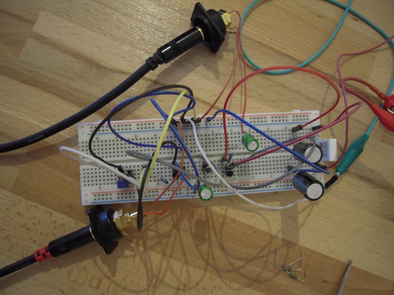

Hello Soundhappy,
sorry that I can't report you about the change of loudspeaker-out between different resistors. I didn't try yet. But I will for sure...
I tried a lot of preamps the last time - how they work together with the
50W-SE-Schade-amp. I tseems that Single - Ended - Pres are preferable.
All complementary designs had pretty much noise/hum. I had to turn the 10 kOhm trimpot at the input pretty often.
I have no buffer yet between input and autoformer. I was searching and reading a lot about buffers the last time.
I have tested two buffers based on J113 JFets (like in the B1-Nutube-preamp and one white-cathode-follower-buffer). The WCF-buffer isn't working till now. It is on the vero-board.
The simple J113 JFet buffer (from the B1 Nutube pre) worked immediately and measured around 0,06 - 0,08 % THD+N at 1kHz with some tweaking of the supply voltage (I tested from 18V - 24V) and some added resistance at the source of the JFet)
I was thinking about an input-buffer made with IRF610 or IRF9610 similar
like in Nelsons Aleph poweramps. This could be run from the 60 - 70V rails? But I did not try yet.
I think Nelson suggested to use a complementary input buffer with 2SK170/
SJ74 to get that very low output impedance (under 100 ohm).
I also thought about an input stage like the ACP+ preamp (which has a lot
of similarities to the BA-1 input stage).
And I have now 3 PSUs in this amp:
The main 60 V PSU, I made one for the bias voltage (not necessary) and
I made a regulated 24 V PSU for the buffer. The voltage for the buffer could
have been taken from the 60 V PSU via voltage divider.
This is what I am doing at the moment. But I was also busy at 'real world work' the last two weeks.🙄

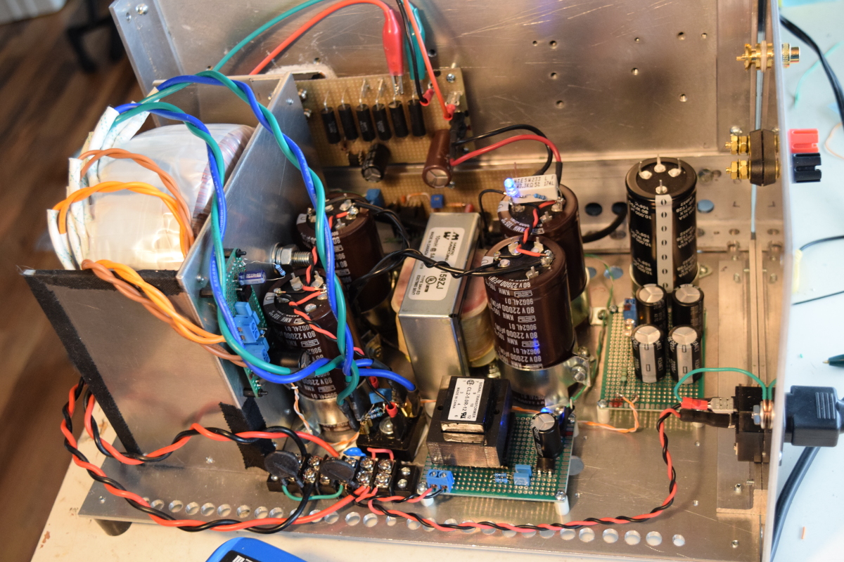

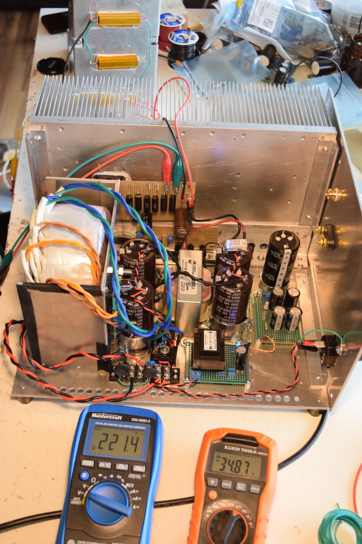

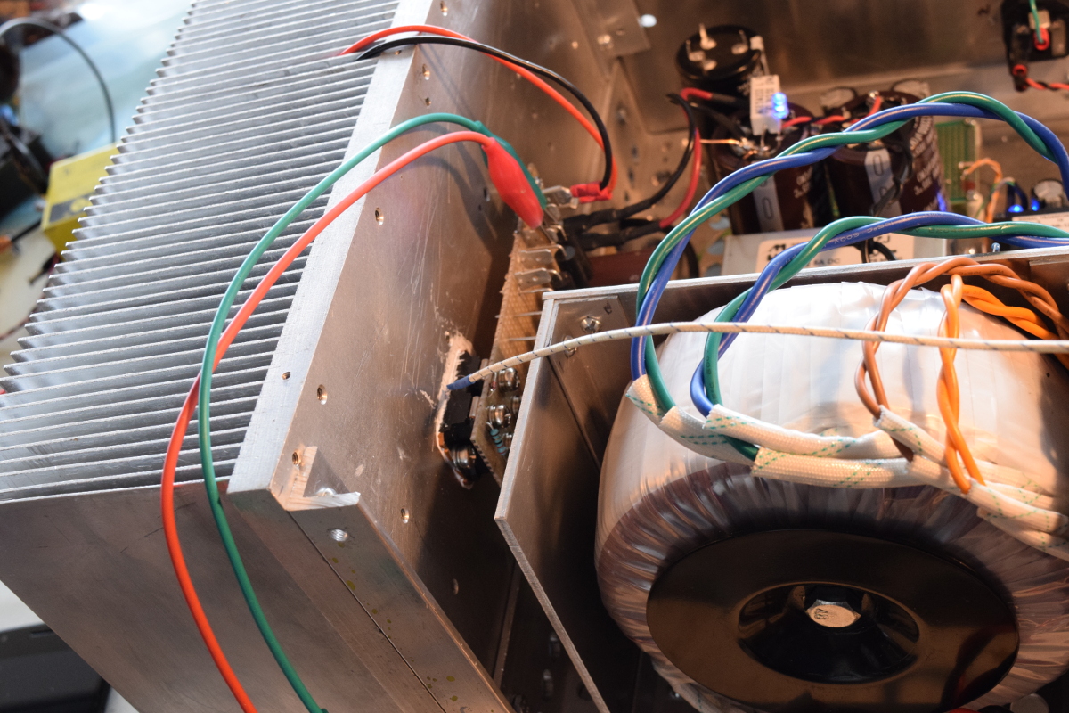

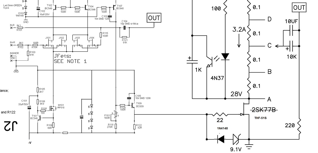

It's been awhile, but progress has been made. Both monoblocks are almost at the same stage of completion with the left channel a bit closer to the finish.
Yesterday, I built the current source for the left channel and the big test was today. The good news is that my workspace is still a non-smoking environment.
I will be using the THF-51S as the output device and based on Zen Mod's tests, I used 6 x 0.1 Ohm resistors in the current source. The results of the test are:
Input: 65V
Output: 35V
Current: 2.2 A
Load Resistance: 16 Ohms
Device Temperature: 36 C
Ambient Temperature: 21 C
Next up is to add the THF-51S. The bias supplies are finished and I have built input buffers for each channel as well.

to pinholer #1090
Hello pinholer,
good progress! Continue with your good work. 😉
Do I see an input buffer with a single JFet? 😀
Greets
Dirk
Hello pinholer,
Greets
Dirk

Thanks, Dirk.
My input buffer uses 2SK170 / 2SJ74 like the B1 R2.
