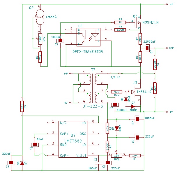

Hi Ben, which bias circuit are you using, is it this one? 50w Single-Ended BAF2015 Schade Enabled
No, I used this one by Zen Mod, with a modification:

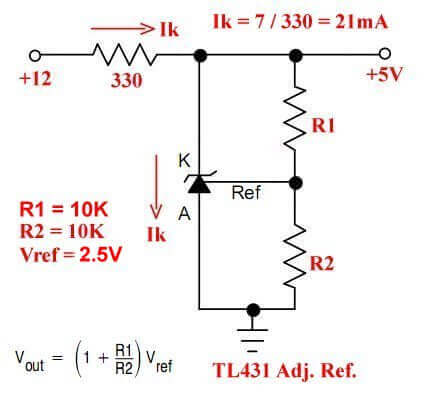

I changed the 1K pot to 5K. That dropped the lowest available voltage from 4V5 to 3V0. If you are using it for the THF-51S amp, you most likely need the lower voltage. It's best to test your THF-51S to determine their Vgs, as 3V0 may still be too high. If that is the case, you can replace the 5K pot with a 5K resistor which will set the voltage at 8V8. Then place the 5K pot across the output, which will then be a voltage divider that will vary the voltage from 0V to 8V8.
The schematic that you referenced is not ideal in that the TL431 is set for 0V to 23V output. For the THF-51S, a maximum of 23V is not required for Vgs.
Here is something that shows how to calculate the resistor values for a TL431 regulator setup, with a sample calculation.

I see. I agree with you in that I would question whether I would put a LMC7660 in my amp. My transformer had extra windings so it was easy to just use a separate supply for the bias.
