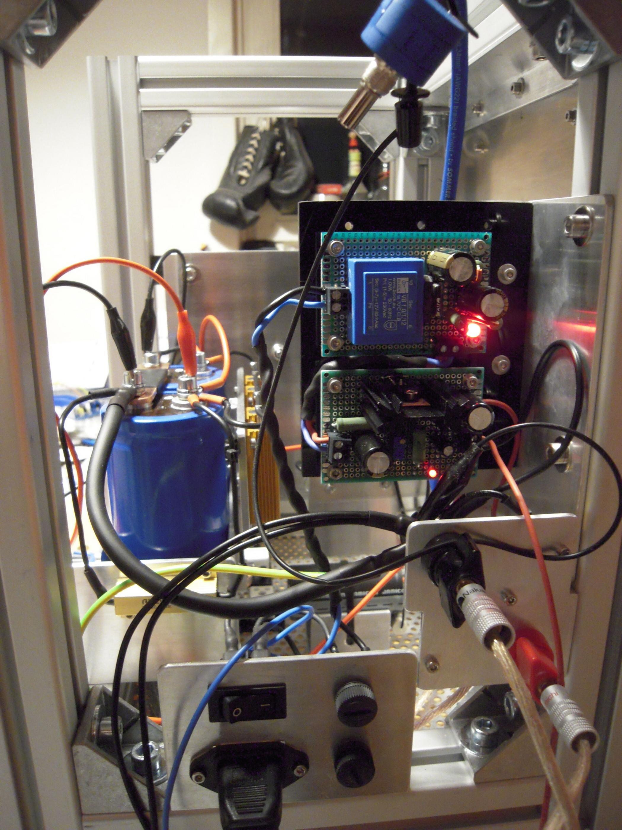

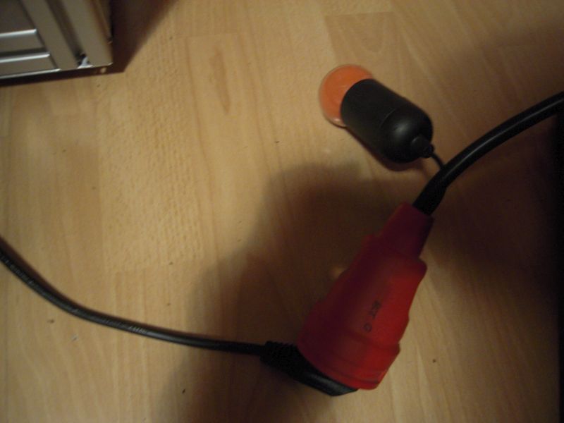

I tested the PSU with nothing hangin' on it. Put the light-bulb-tester in. Light turned off - pooh! Then without light-bulb-tester: I was short to a big boom!
I've got 73.8 V on the second cap. I made a CRC - filter with 2 x 47000µF caps.
The big cans / caps are rated at 80 V - so, I was close to the max. 🙄
But my mistake - I bought the wrong transformers.
230 V~ prim. / 2 x 25 V~ sec. / 500 W
sec. in series = 50 V~
50 V~ x 1.2 = 60 V
50 V~ x 1.3 = 65 V (this was what I've expected by the rule of thumb).
But the transformers put out a bit more than 2 x 25 V~ sec. (o.k. - unloaded).
I am searching.
And I will try to get the dumbness crown!
Greets
Dirk 😀

The trafos are in spec.. But I should have bought 2 x 22V~ sec. ?

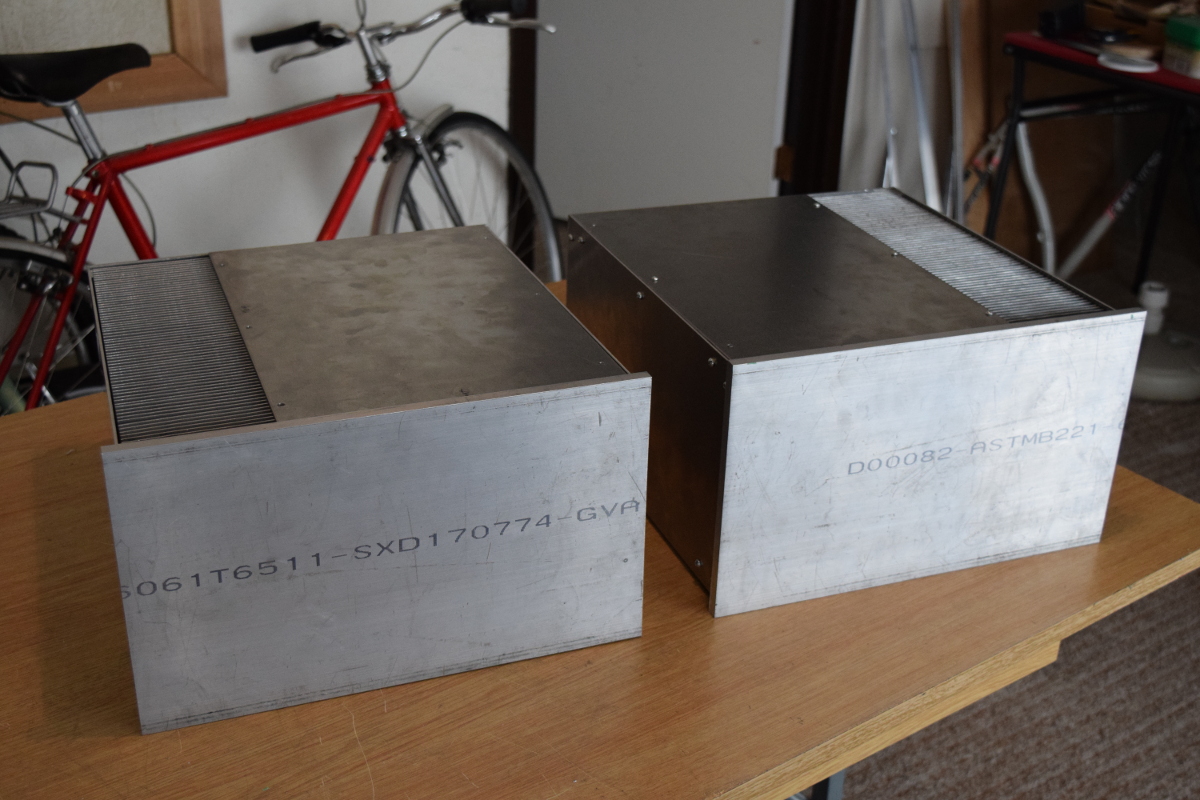

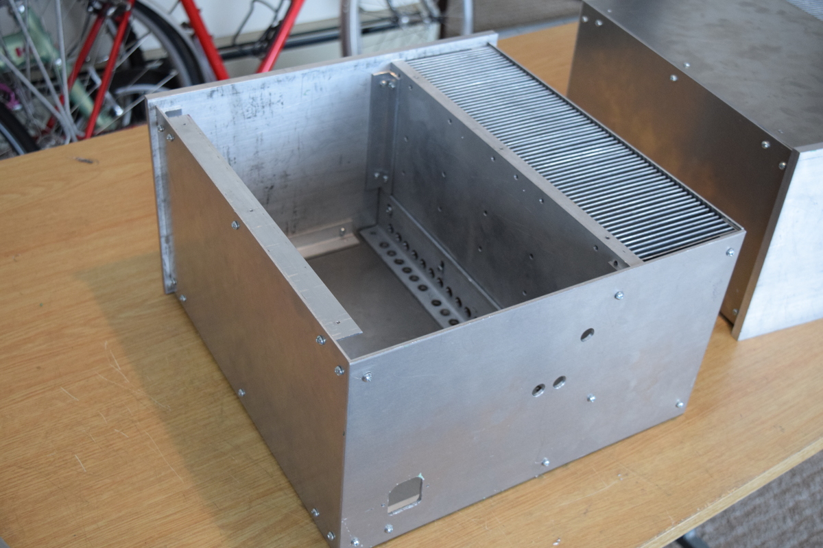

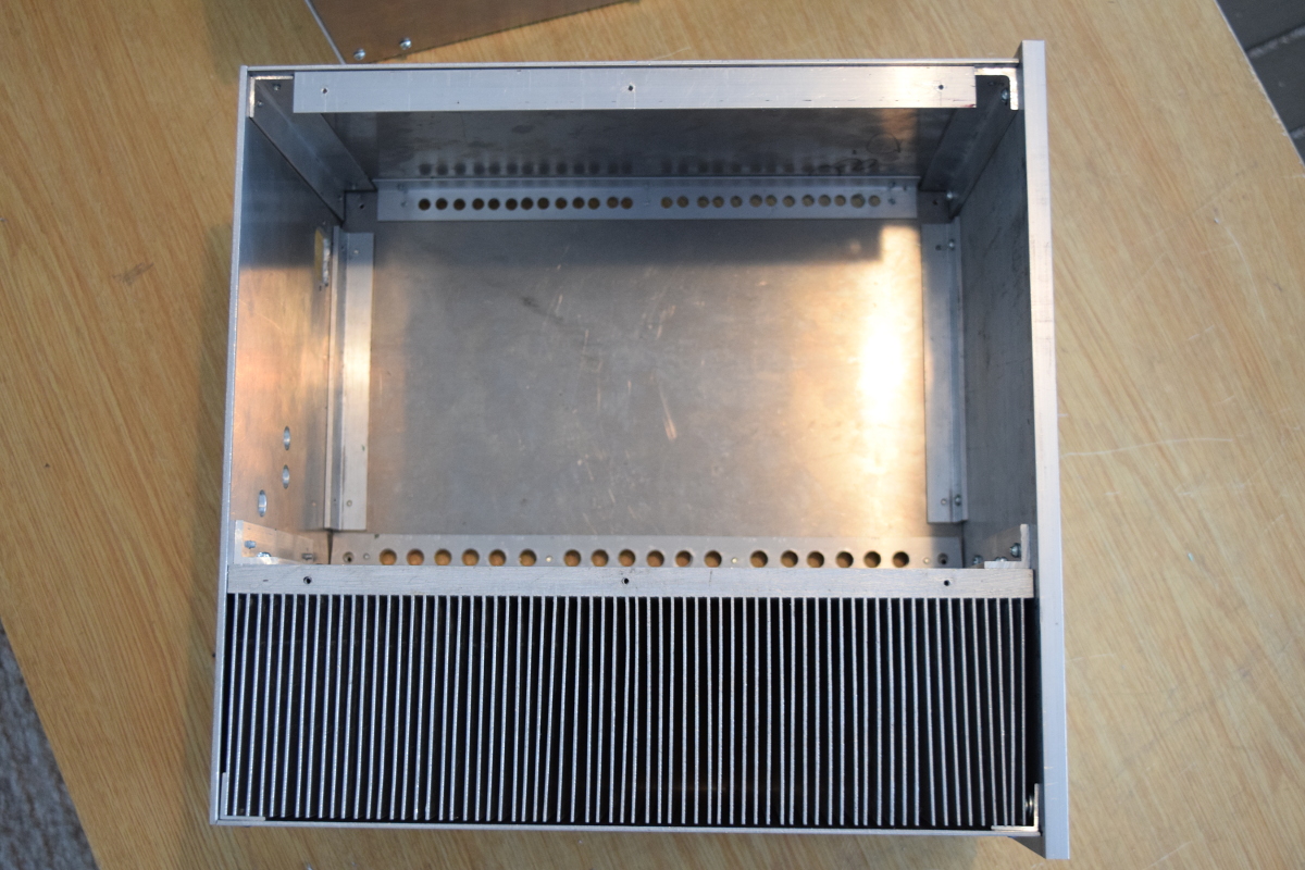

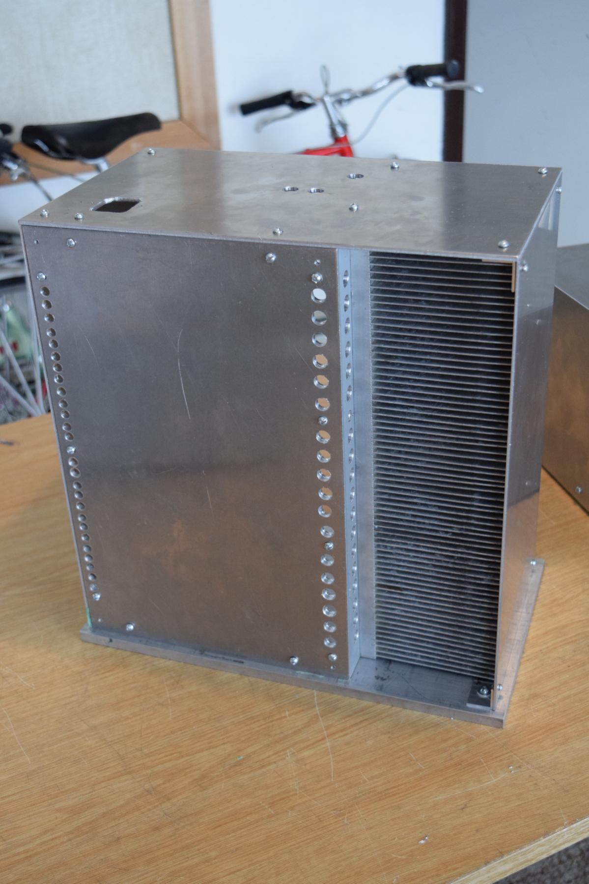

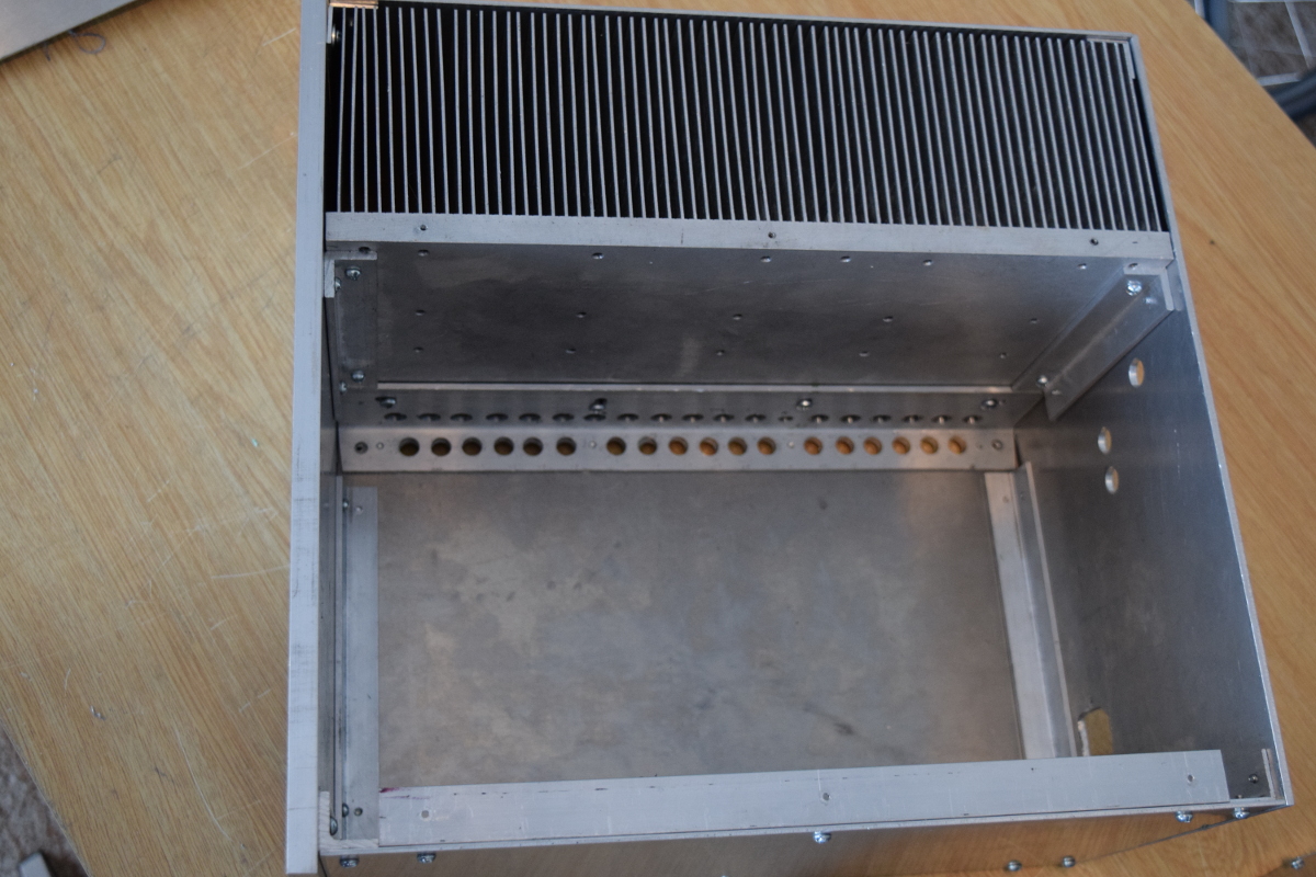

I finally finished the two amp cases. Well, almost finished. Still need to drill some vent holes in the top plates. Also, more vent holes in the bottom plates once the mounting holes for the electronics have been drilled. And, some sanding and polishing.
However, I am glad it's mostly done. Many hours and lots of aluminum chips produced.

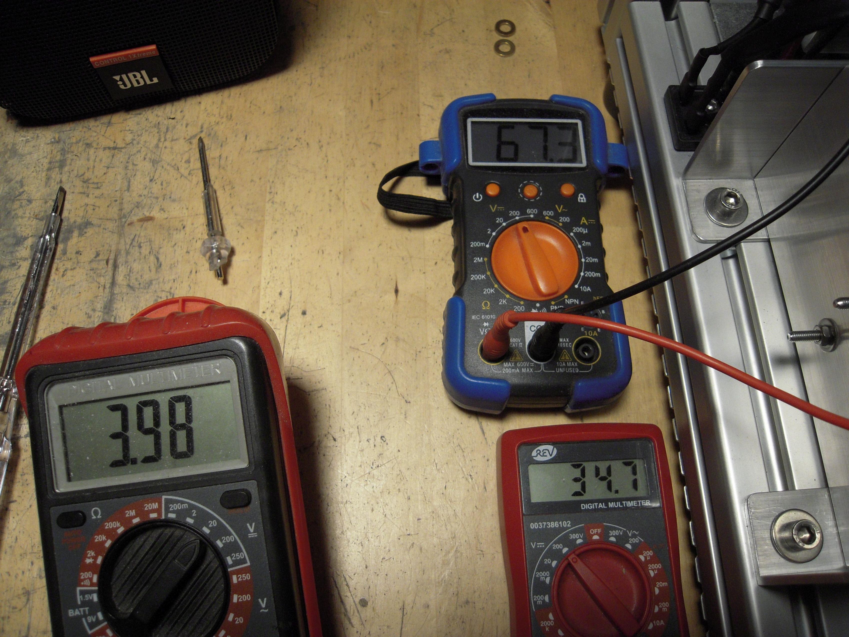

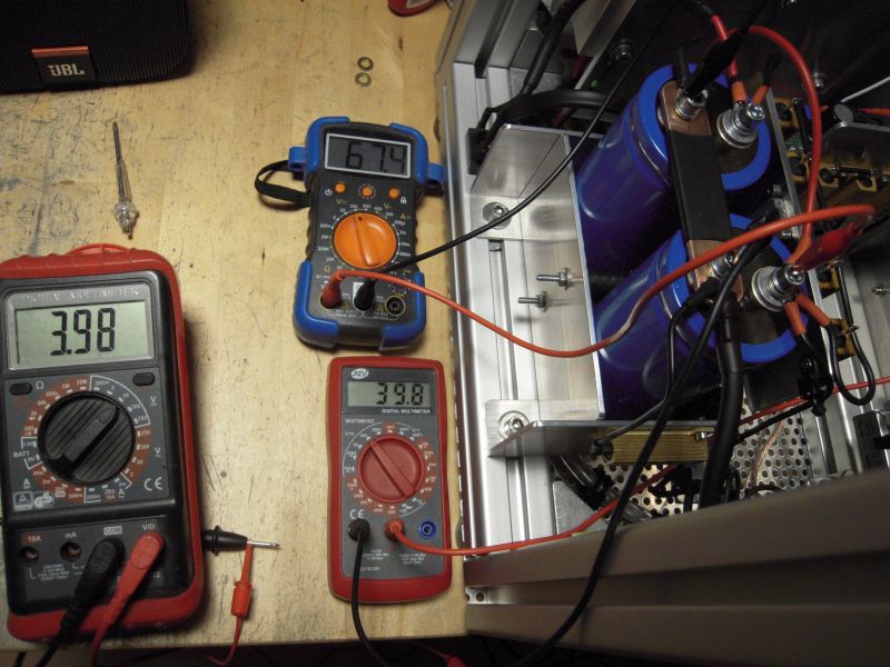

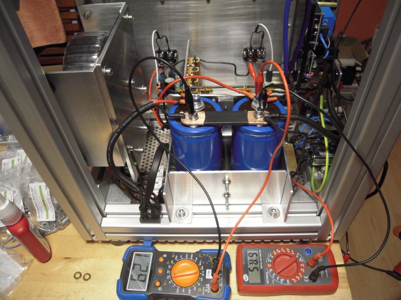

I made the first start up this evening with the 50W- SE- Schade-amp.
It is alive
. No fire
I've got the following values:
Rail: 67,3 V
Mid between MosFets: 34,7 V
Bias voltage into transformer: 3,98 V
temperatures hockeypucks: 68° C / 69° C
'' heatsink: 53,6° C / 53,8° C
Doesn't look so bad till now! 😀
Cheers Dirk

to Ben Mah
I forgot to write down the voltage over the resistor. 🙄
I will measure again (perhaps today - after work).
Greets
Dirk

to ItsAllInMyHead and Pinholer
Thanks for the kind words! 😀
for pinholer:
temperature on the MosFets (directly): 68° C / 69° C
temperature on the heatsink: 53,6° C / 53,8° C
(from outside / position where hockeypuck is inside).
Have anice day!
Dirk
for pinholer:
Have anice day!
Dirk
Thanks for the info, Dirk. Your large heatsinks are working well. I spent a lot of time thinking about how to dissipate the heat before deciding to go with fans. Each has its good and bad points. In the end, the smaller heatsink size decided it for me.

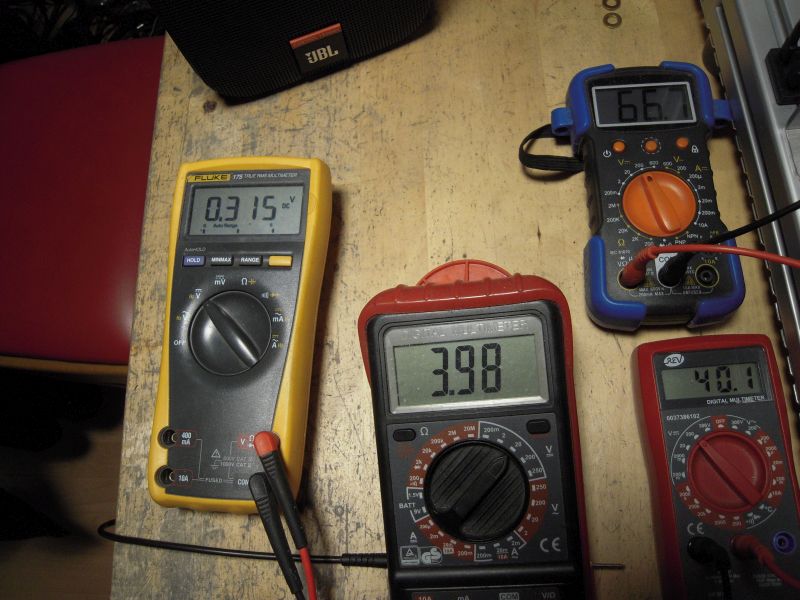

to Ben Mah #1012
Hello Ben Mah,
I measured 315mV (0.315 V) over one 0.1 Ohm resistor (between B and C).
so if I am not wrong: I = U/R
I = 0.315V / 0.1 Ohm
I = 3.15 A.
Greets
Dirk
Hello Ben Mah,
I = 3.15 A.
Greets
Dirk

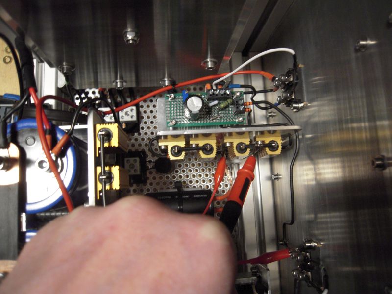

Hi Dirk,
3.15A is good. I also see 3.98V and 40.1V, and in an earlier photo I see 3.98V and 34.7V. I assume that those are Vgs and V between 0.1R at drain above the lower IXFN and source of the lower IFXN. If that is the case, try adjusting Vgs so that both channels have the same voltage drop across the lower IXFN.
