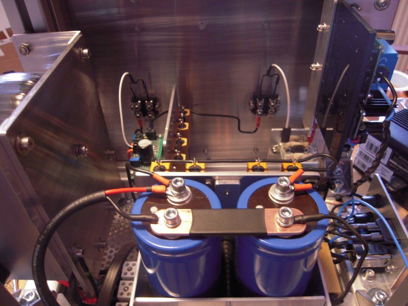

Hello members,
I have continued a little bit with my 50W- SE- Schade- project.
Will there be a :c_flag: at the end of this race track? Or will it be :yikes::flame:?
Greets
Dirk 😀
I will try...this amp
I tested the PSU with nothing hangin' on it. Put the light-bulb-tester in. Light turned off - pooh! Then without light-bulb-tester: I was short to a big boom!
I've got 73.8 V on the second cap. I made a CRC - filter with 2 x 47000µF caps.
The big cans / caps are rated at 80 V - so, I was close to the max. 🙄
But my mistake - I bought the wrong transformers.
230 V~ prim. / 2 x 25 V~ sec. / 500 W
sec. in series = 50 V~
50 V~ x 1.2 = 60 V
50 V~ x 1.3 = 65 V (this was what I've expected by the rule of thumb).
But the transformers put out a bit more than 2 x 25 V~ sec. (o.k. - unloaded).
I am searching.
And I will try to get the dumbness crown!:yes:
Greets
Dirk 😀

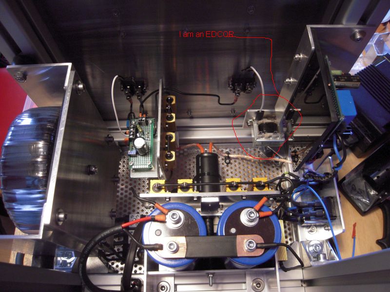

to Sondhappy #993
Hello Soundhappy,
Audio-transformer is in: EDCOR 600:600
It is in the right lower corner of the case (a little bit hidden - it is a transformer
on a 'secret mission' 😀).
I also have to build the input-buffer. So still some work to do...
Greets
Dirk
