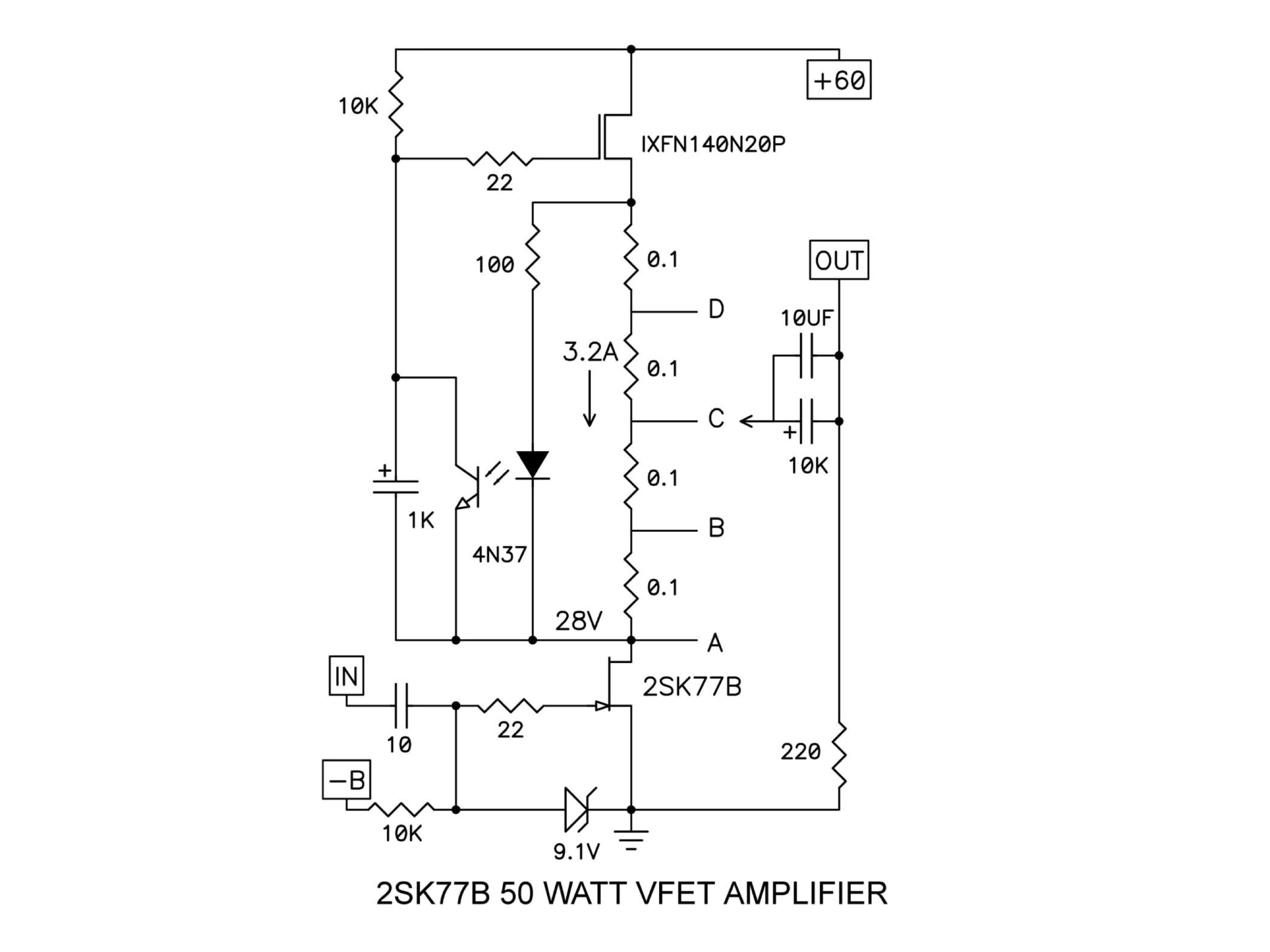

Recently I was asked by two diyAudio members about my build. It seemed the lack of success of some members' builds had some wondering how I built my amps and got them working. I am a self taught diyer who has learned a lot from reading the forums, and I am still learning from reading the writing of others. So I am trying to include information that will help those with less experience, as others have helped me.
My build did not deviate much from Nelson's schematic. It actually worked as is except for my substitution of the THF-51S in place of the 2SK77B, which is of course unobtanium for most of us. The current source did output 3.5A instead of 3.2A indicated on the schematic. It is interesting that Nelson did mention 3.5A in his BAF2015 video. I changed the 10K resistor between the drain and gate of the IXFN to 16K which dropped the current to about 3.25A.
The only other deviation is that my CLC power supply provided 62.5V instead of 60V. That was because my choice of transformer and choke in the CLC filtering gave me that number. In my case I chose a 50V 600VA Antek transformer for each monoblock and the final VDC ended up being 1.25x50V. However it did work as built in accordance with the schematic, even at 62.5V and 3.5A.

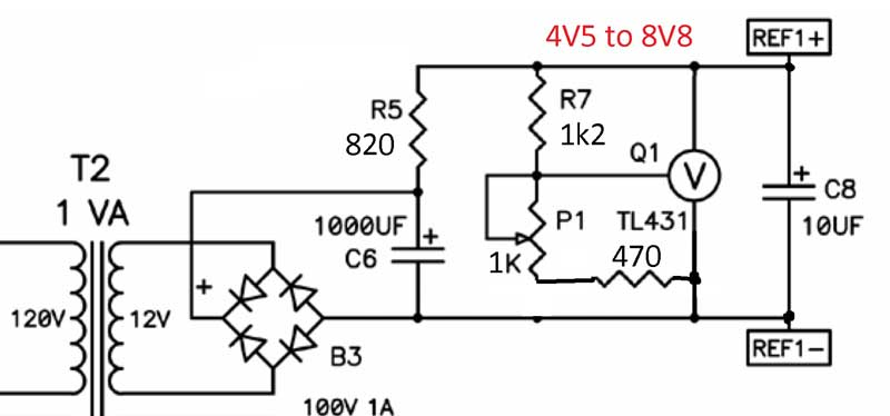

For my bias supply, I modified Zen Mod's circuit (50w Single-Ended BAF2015 Schade Enabled post#508) to suit the Vgs of my THF-51Ss.
I had purchased four THF-51Ss when I was planning my SissySit build, and I used Zen Mod's test circuit (SissySIT post#81) to determine their Vgs at 24V and 1.8A. The THF-51Ss that I had left for my BAF amps had Vgs of about 3.5 and 3.8V. Note that in the BAF amp, the output device operates at 28V and 3.2A. In my amps, that meant a decrease of nearly 0.5V in Vgs from those measured at 24V and 1.8A. I modified the Zen Mod bias circuit by replacing the 1K pot with a 5K pot. That changed to output voltage range to 3V0 to 8V8. If you find that you need a bias supply that goes lower than 3V, I suggest replacing the TL431 with the TLVH431. The TLVH431 has Vref=1.24V whereas the TL431 has Vref=2.5V. This changes the output voltage range to between 1.5V and 4.4V. Another possible solution would be to use a resistor voltage divider to drop the voltage of the TL431 circuit.

With the power supply done, I built and then tested the IXFN current source. The current source (everything from the 60V supply to but not including the 2SK77B on the schematic) was connected to the power supply, and an 8 Ohm test load was connected to the end of the current source (point A on the schematic). My 8 Ohm load was two 50W 4 Ohm metal clad power resistors mounted on a heat sink (resistor power dissipation = 3.2A x 3.2A x 8 Ohm = 82W). I initially powered up with a dim bulb tester to check for shorts. With the 60V 3.2A power demand, I used a 250W bulb in the tester. With that done and no short detected, I powered up at full power and measured the voltage across the test load. The expected voltage drop was 3.2A x 8 Ohm = 25.6V. I was in that neighbourhood. I believe that I actually got 26.7V and as my test load measured 8.2 Ohm, the current source was outputting about 3.25A - close enough.

I then built the rest of the amplifier circuit and the bias supply circuit. I tested the bias supply circuit separately with a dummy resistor load (I think I sized the load for 2 or 3mA at 3V). I also made sure that I set the bias supply at maximum output voltage before I connected it to the THF gate.
For the first power up of the complete amplifier, again I used the dim bulb tester. I also had a meter on the THF drain and source (ground), a meter across one of the 0.1 Ohm resistors at the THF drain to monitor current, and one meter to monitor the PS voltage. With no short detected, I powered up with full AC power, and adjusted the bias supply pot, watching as the voltage across the THF dropped to 29V. Initially with the bias at -8.8V, the THF was off and there was no current flowing. I chose 29V instead of the 28V shown on the schematic as my V+ was 62.5V, not 60V.

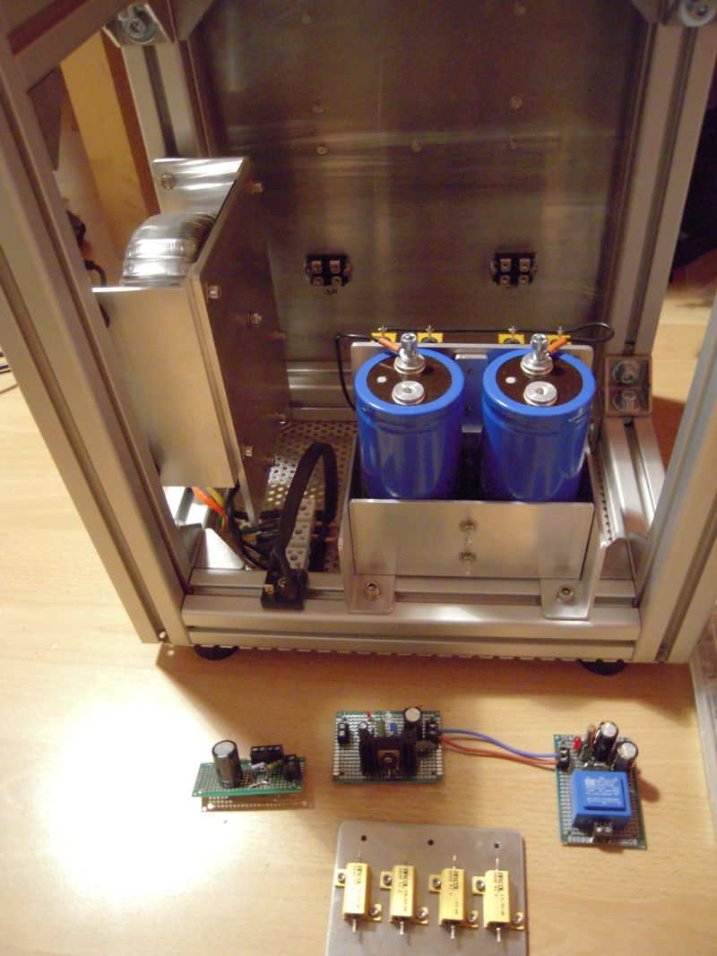

I am at this stage of my build. I hope it will come alive without a disaster.
I build the version with the IXYS - hockeypucks. Poor mans iteration... 😀
Hope to get the PSU done next few days. Still a lot of work waiting.
Thanks to BenMah for your guidance. A big help.
