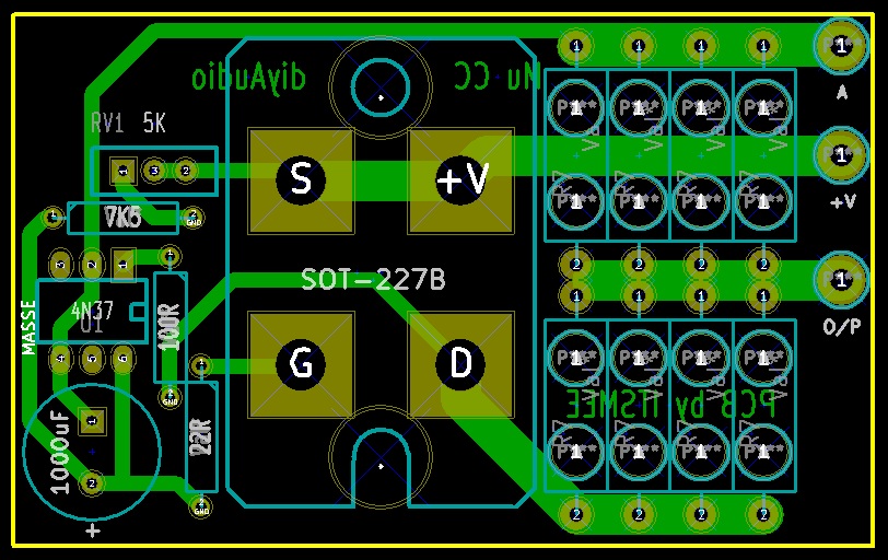

Something like this? I need to check it over with fresh eyes tomorrow, when it's ok I'll post the gerbers.

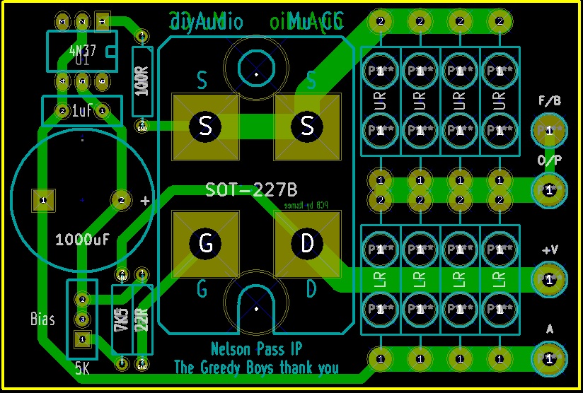

With fresh eyes, I added the missing track, then noticed that the SOT-227B datasheet I was using had the gate and drain reversed :eek:
New layout, Iv'e checked it over a number of times, looks ok... I zipped up the gerbers then uploaded to JLC PCB, now waiting for delivery :D

I'm resting after a great day at BAF and I've been staring at your pcb design for a long time, checking the amplifier schematic and the IXFN data sheet, and it looks to me that you have the source and drain connections reversed. As far as I can tell, you are sending 60V to the Source and then outputting out of the Drain. But it should be the other way around. The 60V goes to the Drain and outputs out of the Source.
As I said, I have been looking at it for a while so I don't believe that I am wrong. I mean, I am questioning myself over this but in the end it looks backwards to me.
I apologize if I'm completely out to lunch.
Ben :confused:

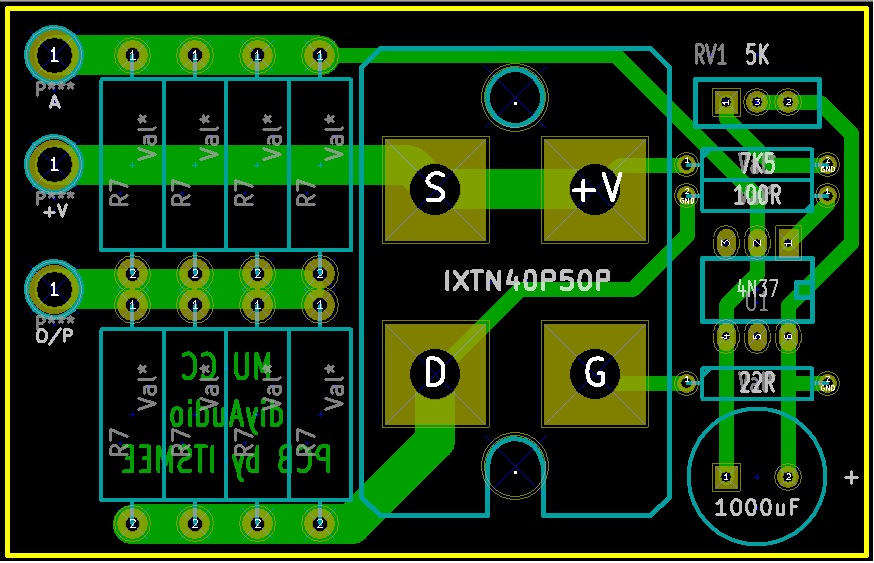

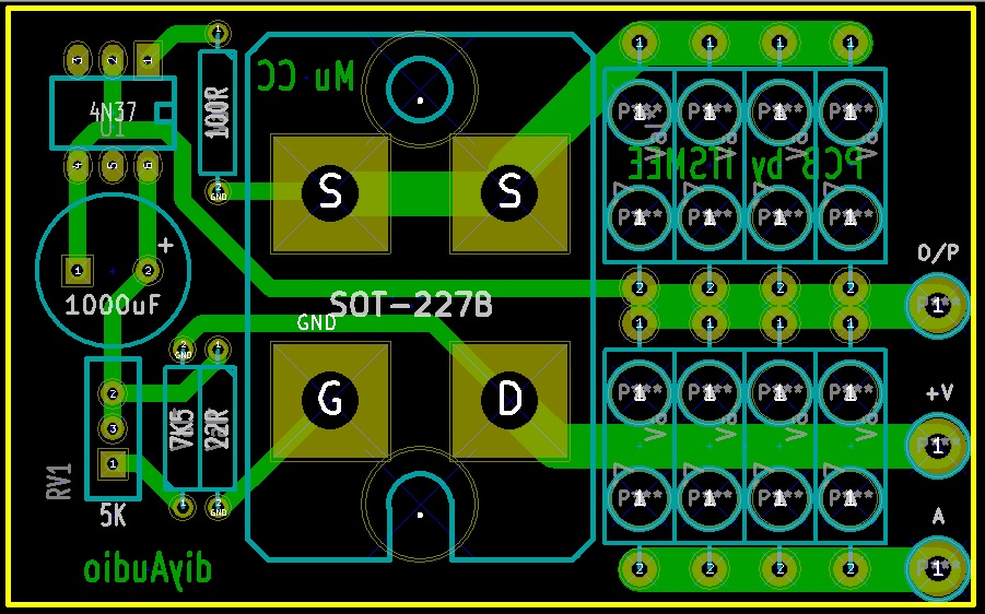

Hopefully it's right this time.
Bad news! :(
Something that I didn't catch last time - pin 5, not pin 6, of the 4N35 connects to the 1000uF cap positive terminal.
In your switch-around of Drain and Source, some of the connections were messed up. Your 4N35 pins 2 and 4 and 1000uF cap negative is now connected to the speaker out (O/P). It should be connected to "A" on your board.
Maybe fourth time lucky. ;)
