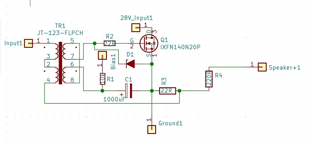

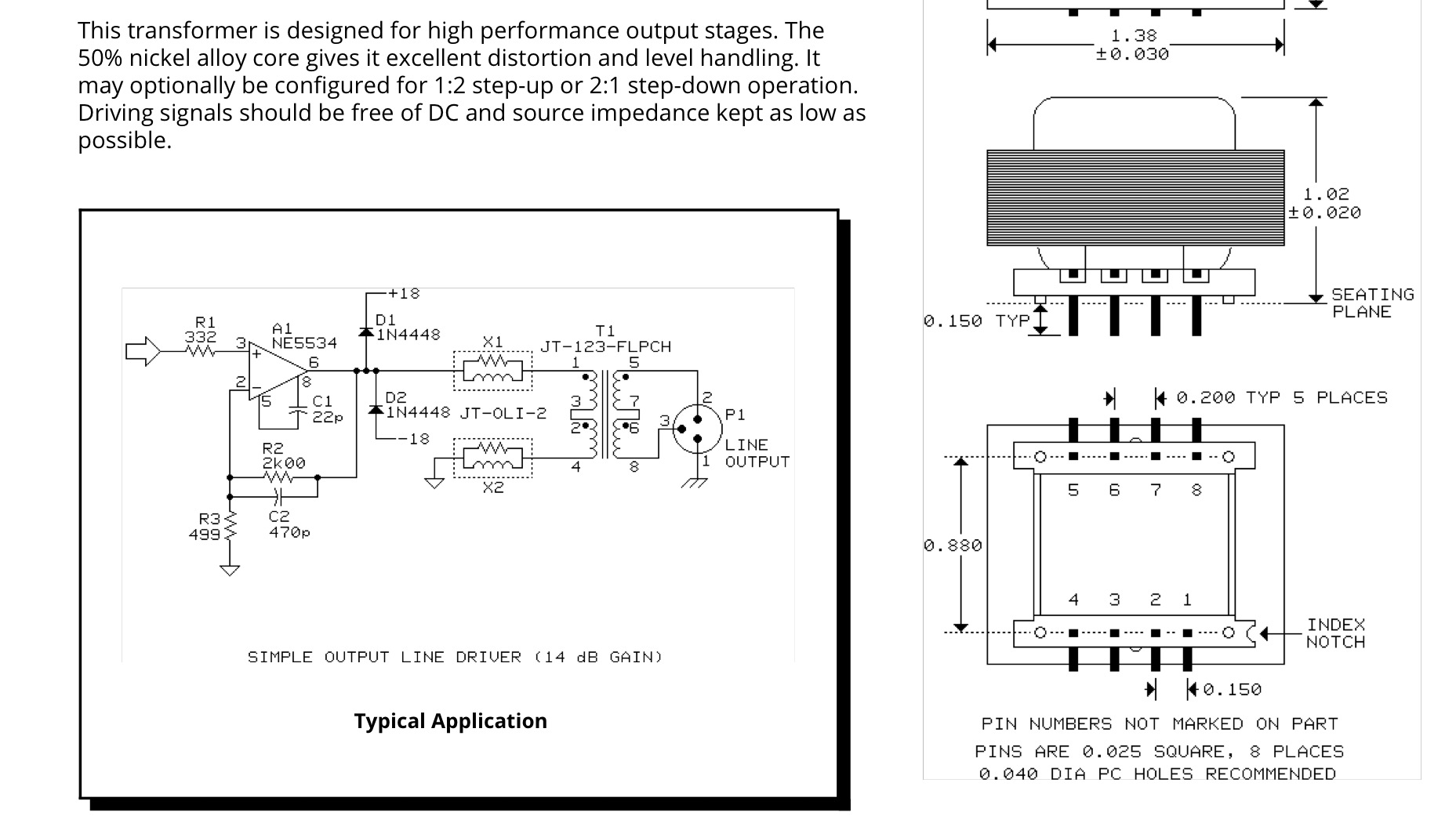

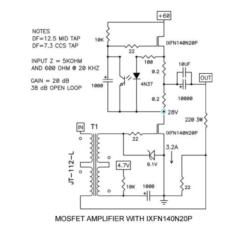

Question about the schematic in post 12.
The Jensen transformer's physical polarity, is it flipped manually to match the schematic or does the polarity markers end up being marked the same as the schematic?
I know it's stupid question, but I'm afraid to wire it incorrectly.
I guess I can place the secondary in series and just flip the connection to the circuit board or next connection points. :eek:
Sorry, I have a little mental block with this for some reason. :eek:
After reading Soundhappy's post here's with what I came up with.
Dan
Yes, Dan OK :)
Jensen pins numbers with the dots are 1 and 2 for primary and 5 and 6 for secondary.

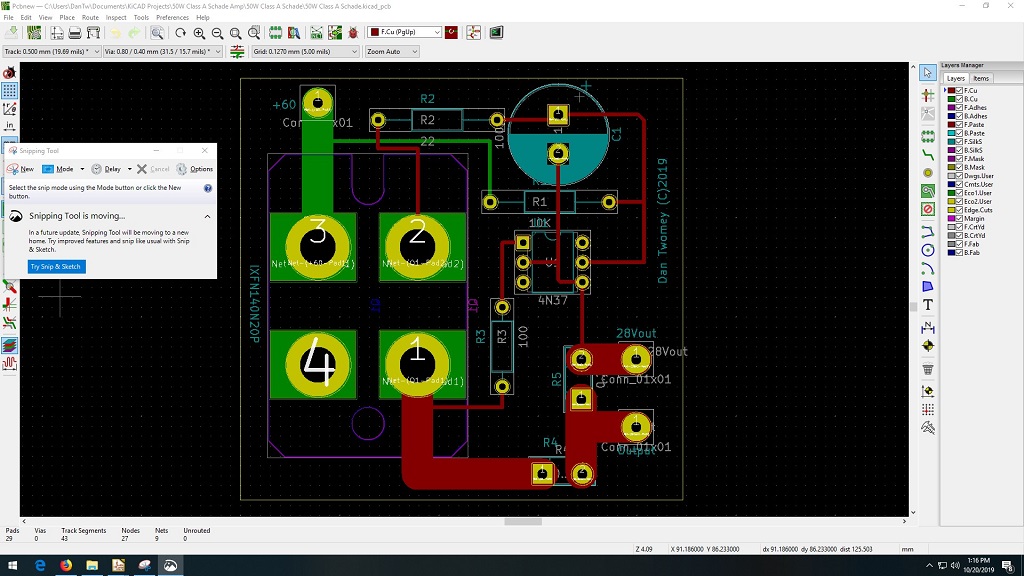

Joined 2002
CCS learning curve. My CCS seems to work fine. With 1,2, and 4 ohm loads it produces close to 3.5 ADC even though it drags my power supply down to 50V. I suspect I might be in line with others in changing the value of of the 10K resistor as outlined in post #49.

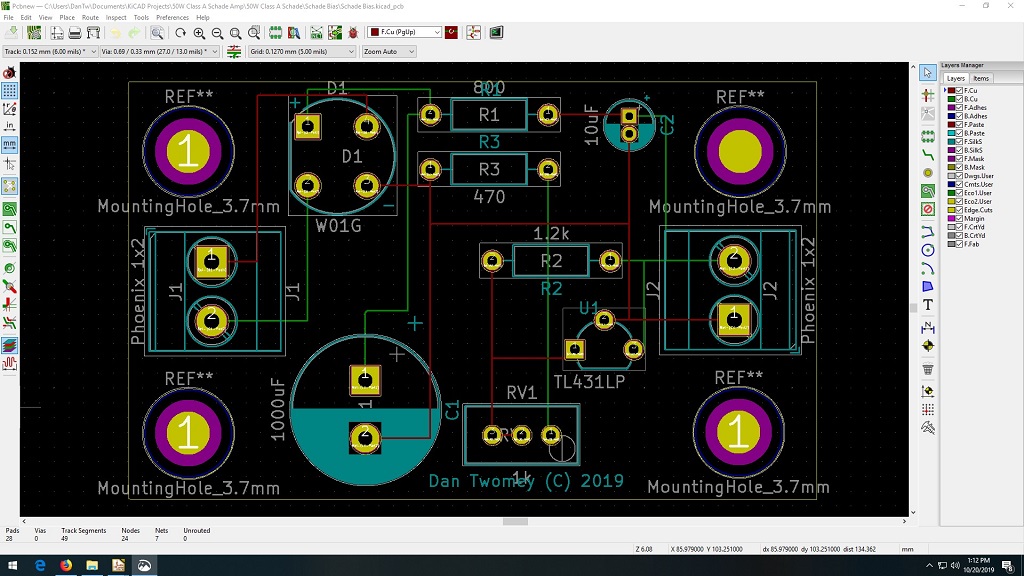

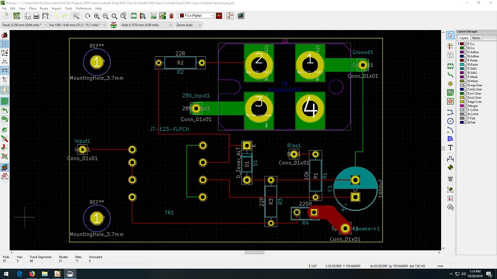

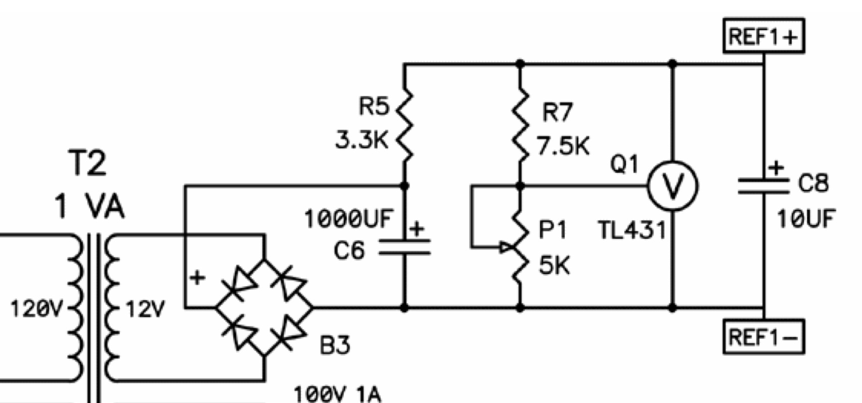

This is my first shot at making PCBs so there may be more revisions yet. I've built a standalone bias board as seen below. Also seen below is the latest revisions of my CSS and input boards. I'm a bit perplexed over a buffer PSU circuit. I don't want a ultra high-end Salas regulator, but I don't want to stick in any old LM317.
Dan
Joined 2002
How many volts at the IXFN drain 28 ?
I stay at non more 3.2A current because is made heatsink very hot after 2 hours :)
Can't really measure that voltage because I'm just loading the CCS with a 1 ohm resistor. The bottom half of the circuit isn't connected. I'm making two boards because I'm planning to have each IXFN on it's own volkswagen sized heatsink. Thus two boards. What may have just dawned on me is that only the CCS IXFN will produce any real heat? The bottom amplifier IXFN will not? If this is the case I could easily put everything on one board for a far better solution?

@ Dan
My are Mr.Pass TL431 psu circuit for bias.
Made with this schematic voltages can be trimmer ( multiturns ) adjustable to 4.7V and up to 12V. Work splendide :cheerful:

Joined 2012
Dan
Both will dissipate approximately the same amount of heat. The current is identical and the voltage drop across each is intended to be equal or close to equal.

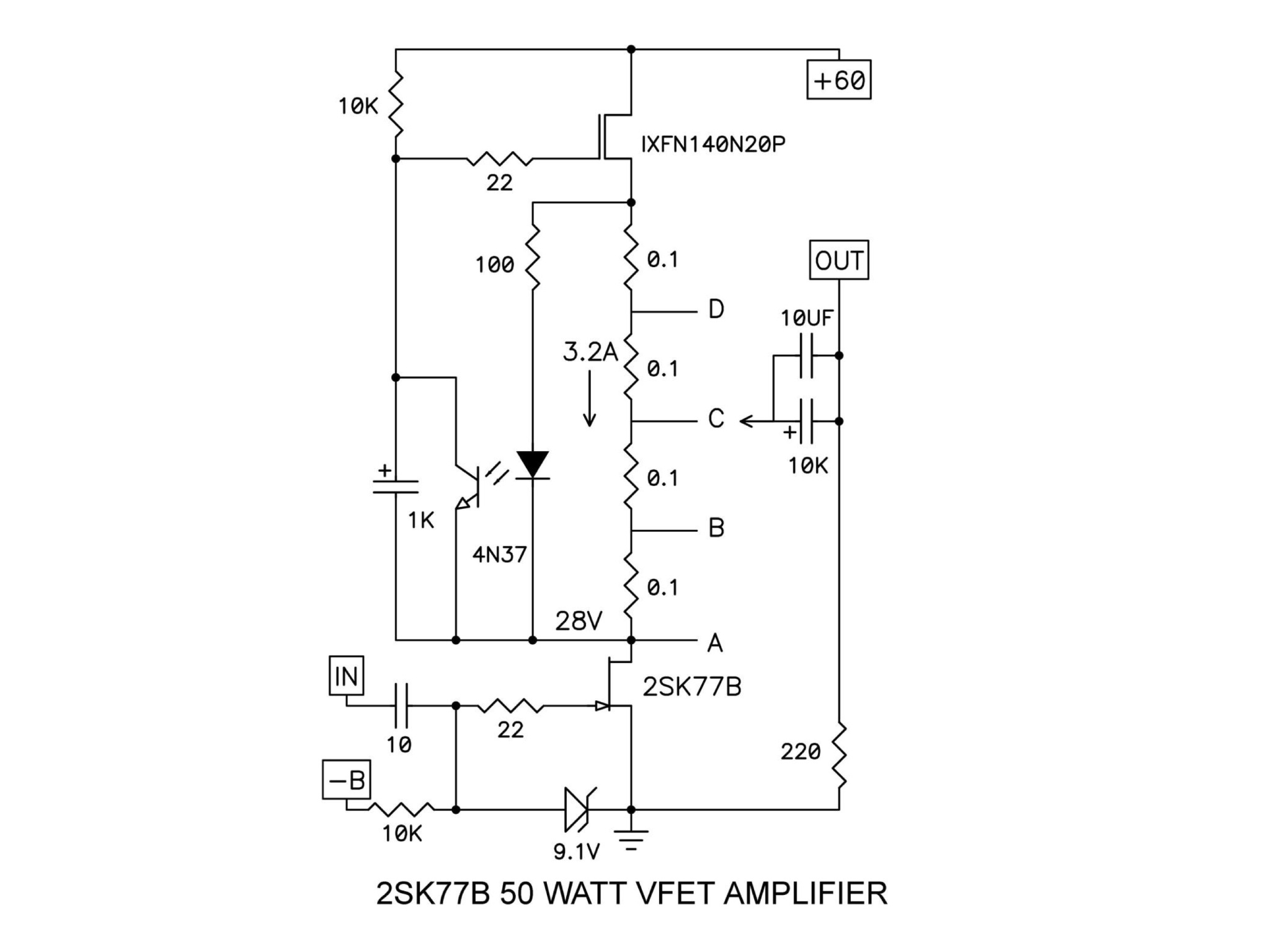

This is my first shot at making PCBs so there may be more revisions yet..Also seen below is the latest revisions of my CSS ..
This CCS connection points C and D from 2SK77B Vfet version give two different audio signatures.
C have more H2 and slightly higher distortion = emulate triode sound
D bring H3 and less distortion = more up front and bright sound.
Both are perfect for two different preamplifiers or speakers.
I connected two positions switch between CCS points C and D and is opened a twice audio enjoyement from only one amplifier
:up::) :wrench: Best regards
