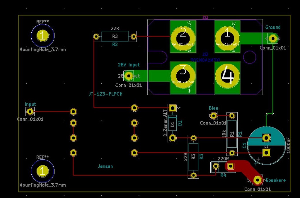

Hi Dan, regarding the layout in post #820 - it's been a long time since I've done any board layouts but let me know if you think this would work - push R1 to the very top of the board above R2 and you can do all of this on a single layer, no more green and red crossing paths.
... actually if you switched positions of R1 and R2 you could get the same result too, no more need for another layer
I'm a rooky but I took my best shot and have some boards on the way. We'll see how they turn out!

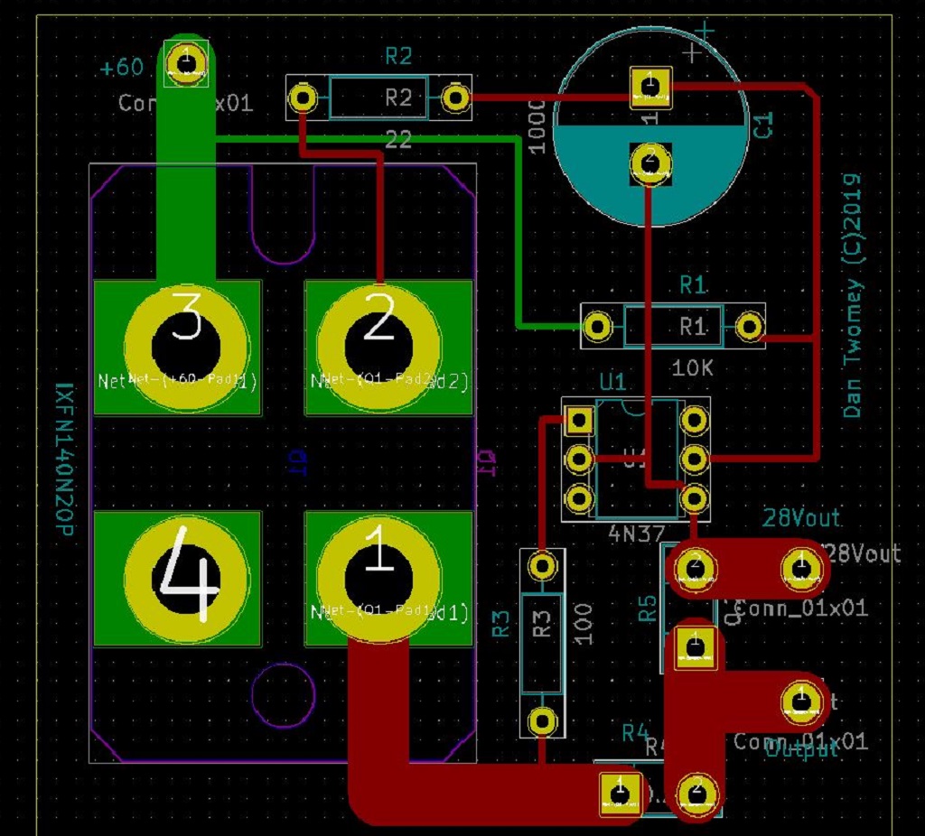

For everyone's amusement my latest PCBs.

Or, if you move the thin green trace up then under R2, you'll only need single sided PCB

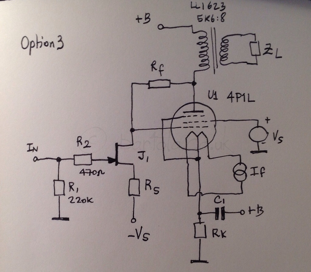

let's concentrate on something else - eenyweeny JFet feeding from drain two bigun gates , no feedback etc
just make some olde toob schmtc , Kosher in audiophool circles , and be done with sugar

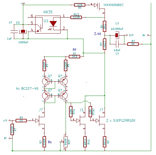

I'd rather double up the mirror output than half the emitter resistor for more drive - thought the J74 was in the feedback loop?

Make separate : CCS , amplification stage , bias circuit with simple jfet buffer included.
PL amp with IXYS areexample. Have a nice day
Is a simple JFET input buffer more or less 'mandatory'?
The reason I'm asking is it makes sense to included the input buffer on the amplification stage if I'm going to the trouble of designing and making PCBs?

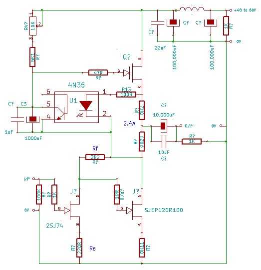

The more I 'learn' the more this circuit interest's me. The top half provides a constant current source but the bias circuit determines how much current the bottom half passes?

Starting around post #83 of this thread are conflicting opinions of what Pa is recommending. I hope my unregulated CLC will do.
