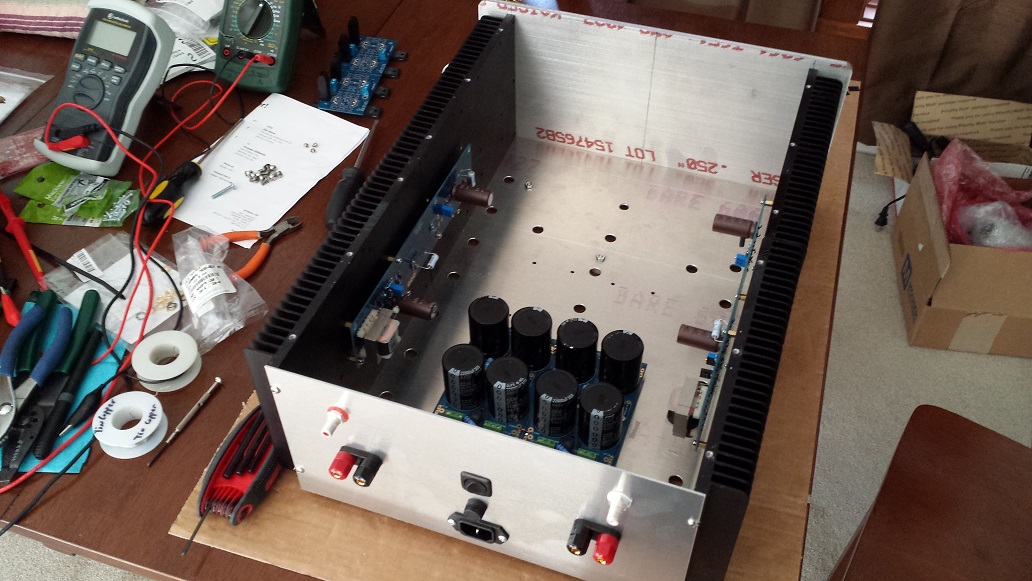

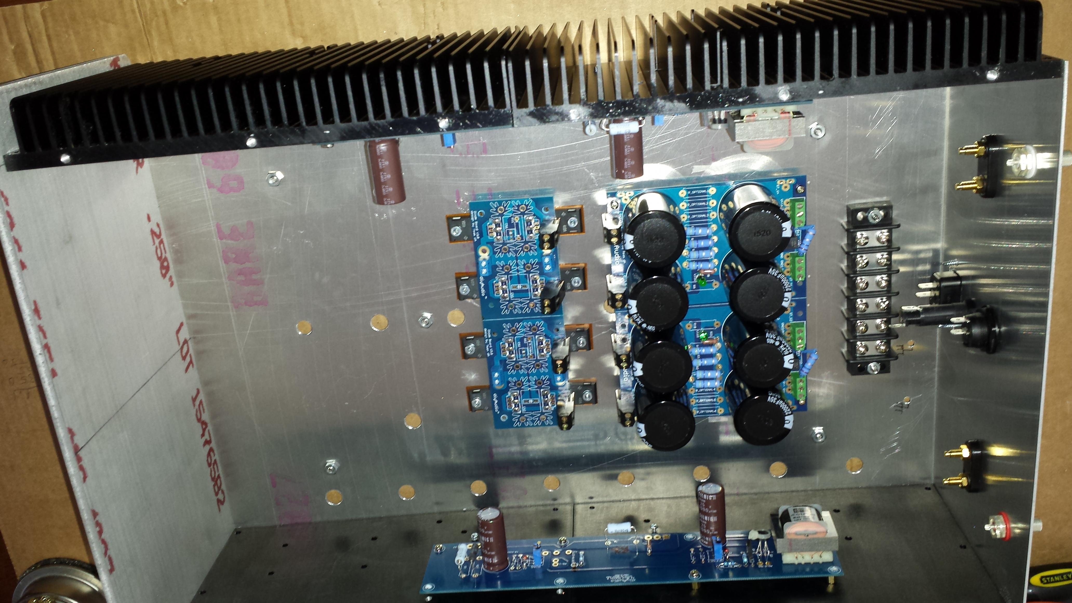

The long story is I don't want to re-task the 6w L'amp CCS SIT and F6 Jfet cases to build 50w mono blocks. I have a new (partially built) case waiting, so if I just take down the output requirement and dissipation, and try mosfets and the R100 jfet, it's a win-win. Then I can compare it to more amps. ;)
The case should be able to dissipate 100w per channel.
Was reading the Sweet Spot article last night. If the device is locked to a voltage or current setting, one could still adjust other factors to play around with the sweet spot. At least that's what I took from the article. Just need a distortion analyzer. Lots of stuff on ebay for cheap, but some only have .1% capability.
