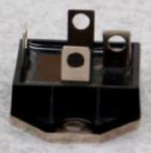

ps. curious 2SK77B hockey puck photo ( prototype ? ) package from Maxonic catalogue.

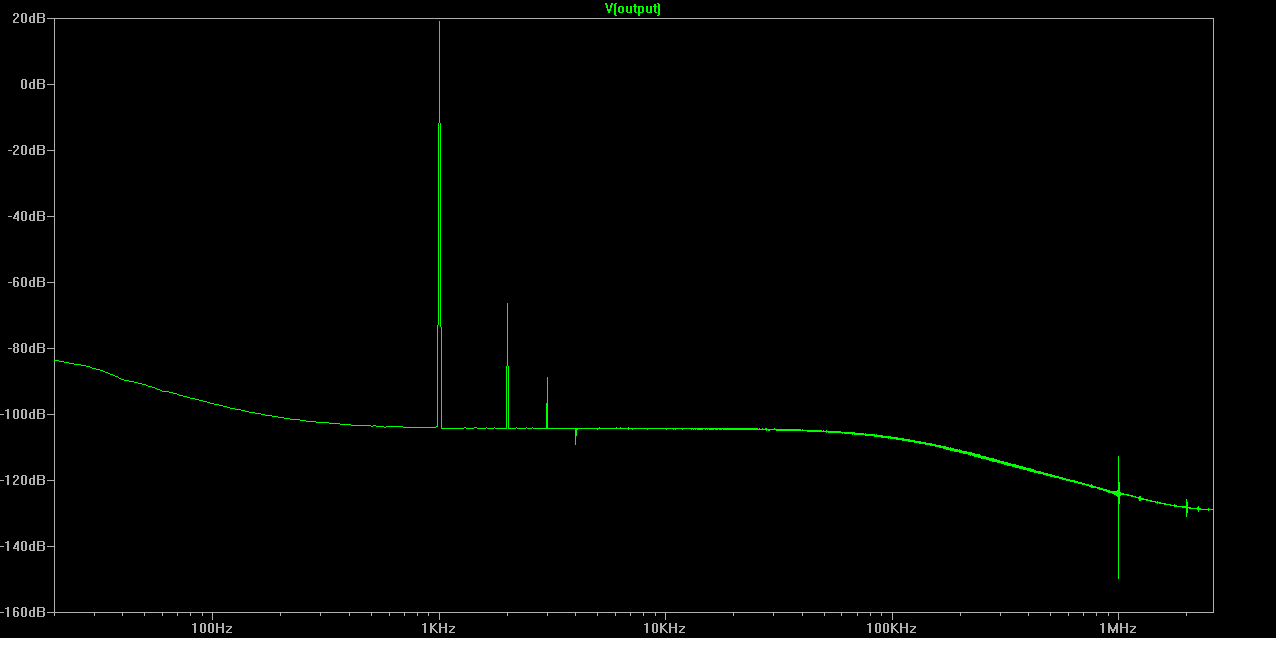

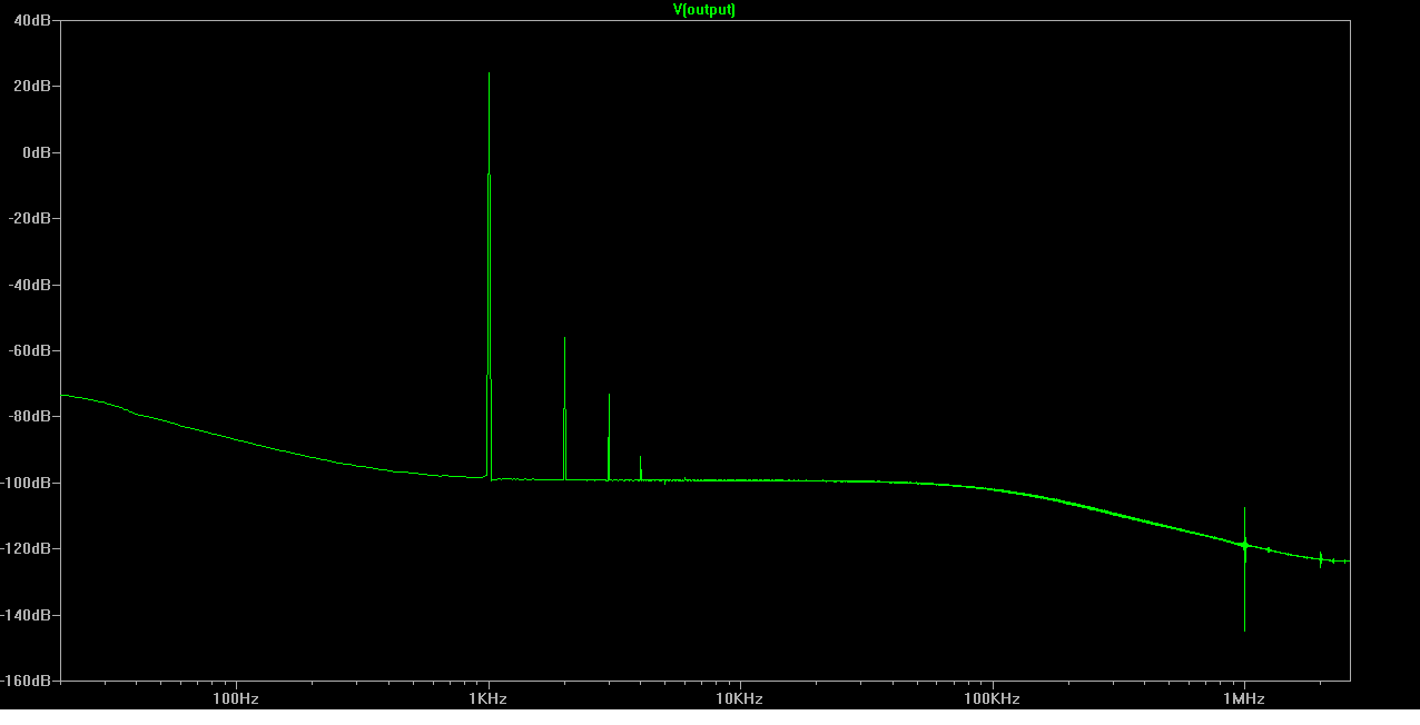

I simulated the Baf2015 in ltspice but without the input transformer and I used an IXFN120N20 model from Ixys. The amp has a closed loop gain of 20db and the distortion at 1 watt shows about 0.001% and at 10 watts about 0.005%. I simulated the F6 and the ba-3 and their distortion was close to what was measured. So I don't know whats going on here. It sure would be great if it was accurate.

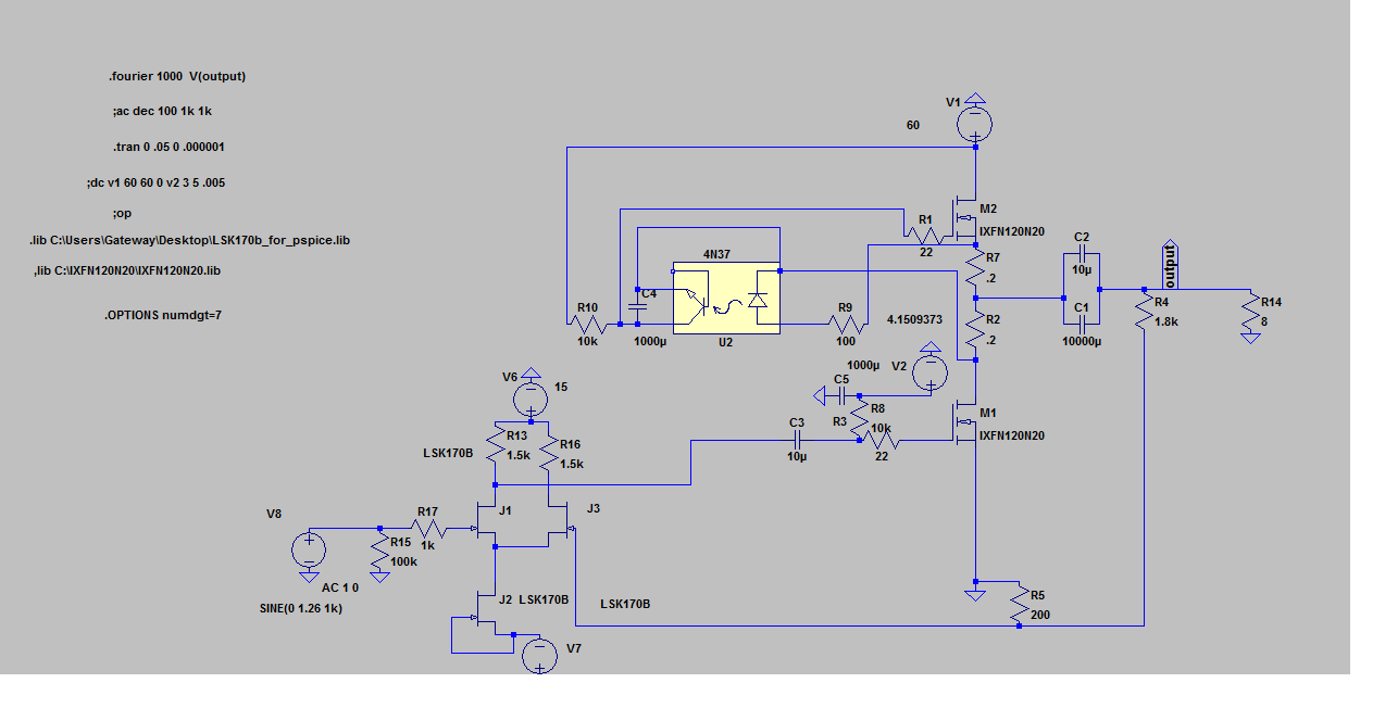

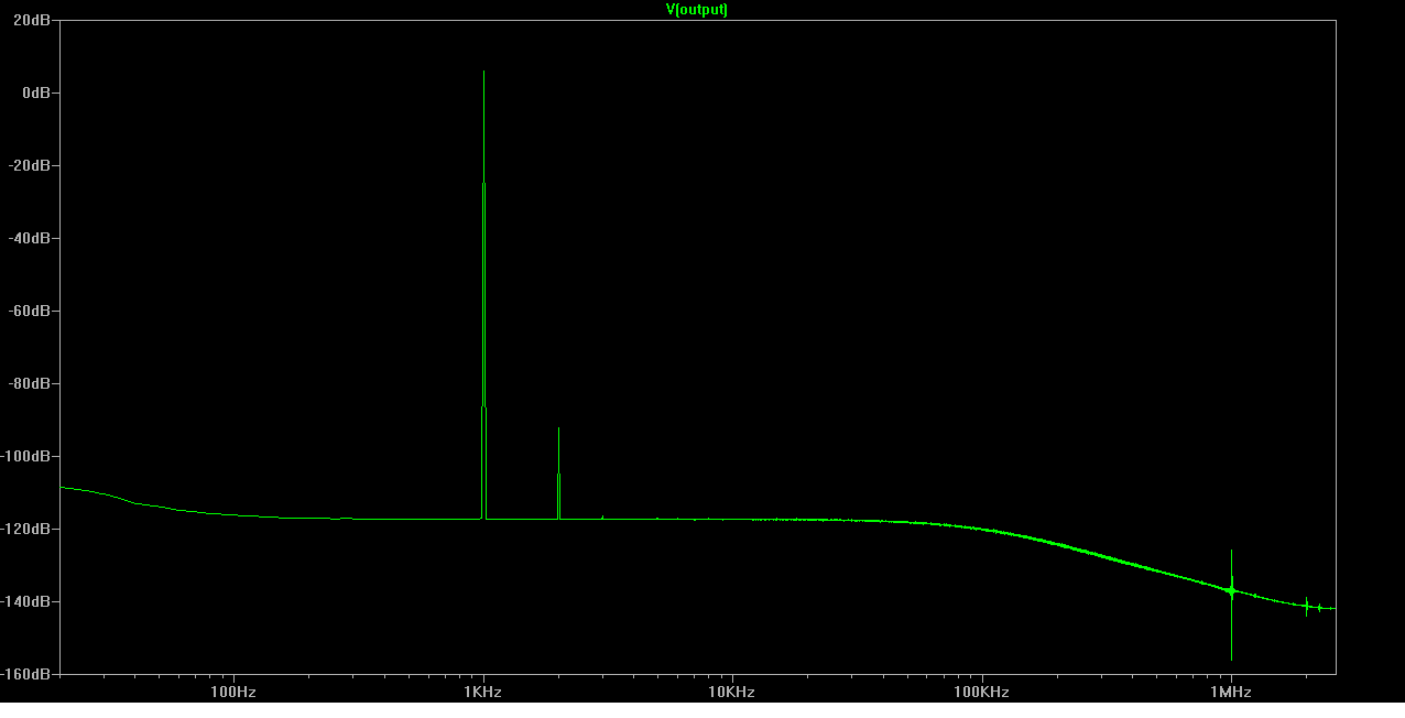

Here is the circuit I used, it seems to be stable. I thought there might be more third harmonics in this circuit than in the transformer circuit. Another distortion graph at 32 watts.

Well I can't find anyone selling it.I see that Ixys does now show the 50n120sic as an active part. And, the datasheet is incomplete. I just found another sic part "APT70SM70J" from Microsemi for $27.30
Picodumbs, what is its transconductance of it? I noticed you had a picture of it from a link in one of your previous posts.
