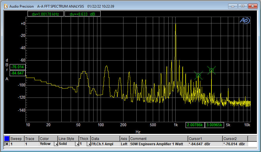

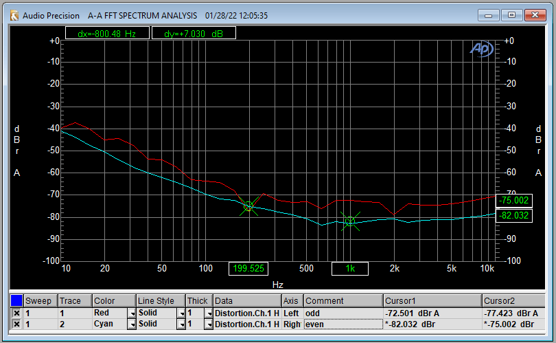

swapping various 6HJ5 tubes I was able to get the THD+N down to 0.036% at 1W -- this overstates THD% as the power supply spurs are greater than the harmonics. With careful adjustment of the balance potentiometer, THD+N was more than halved.

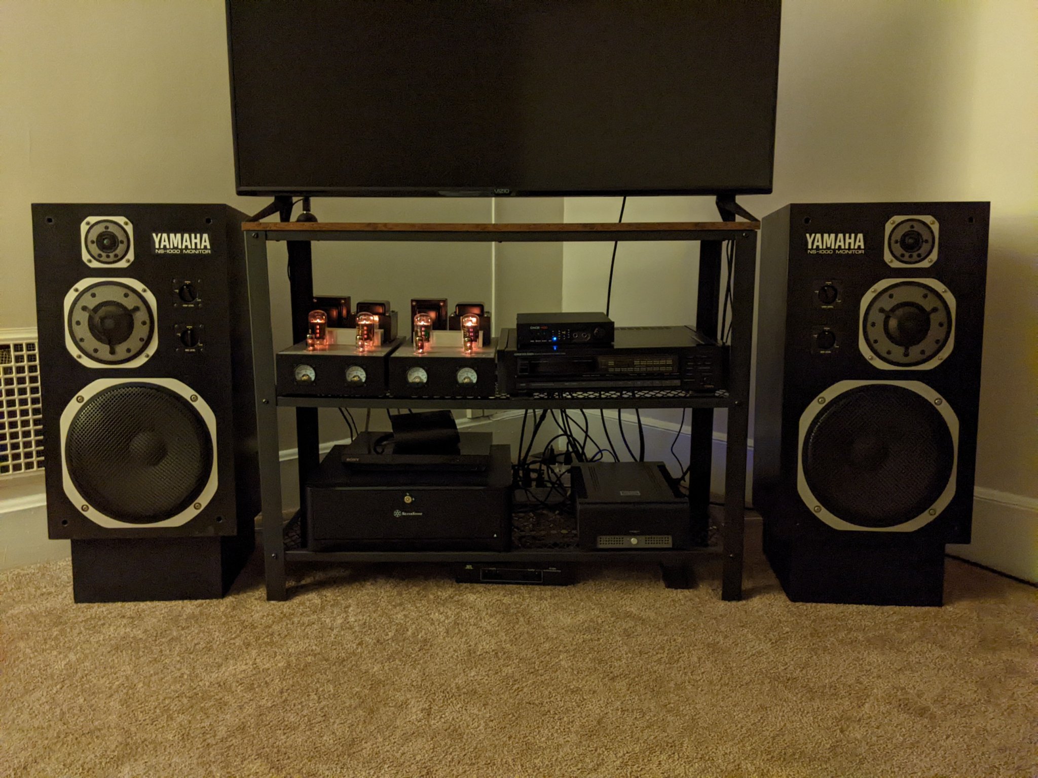

This amplifier equates itself extremely well in comparison to those reviewed in Stereophile for the past 4 years.
well done .... great project you must be pleasedProject done!
And, oh yes, they sound sweet...
Thank you all for the patience and precious advice!

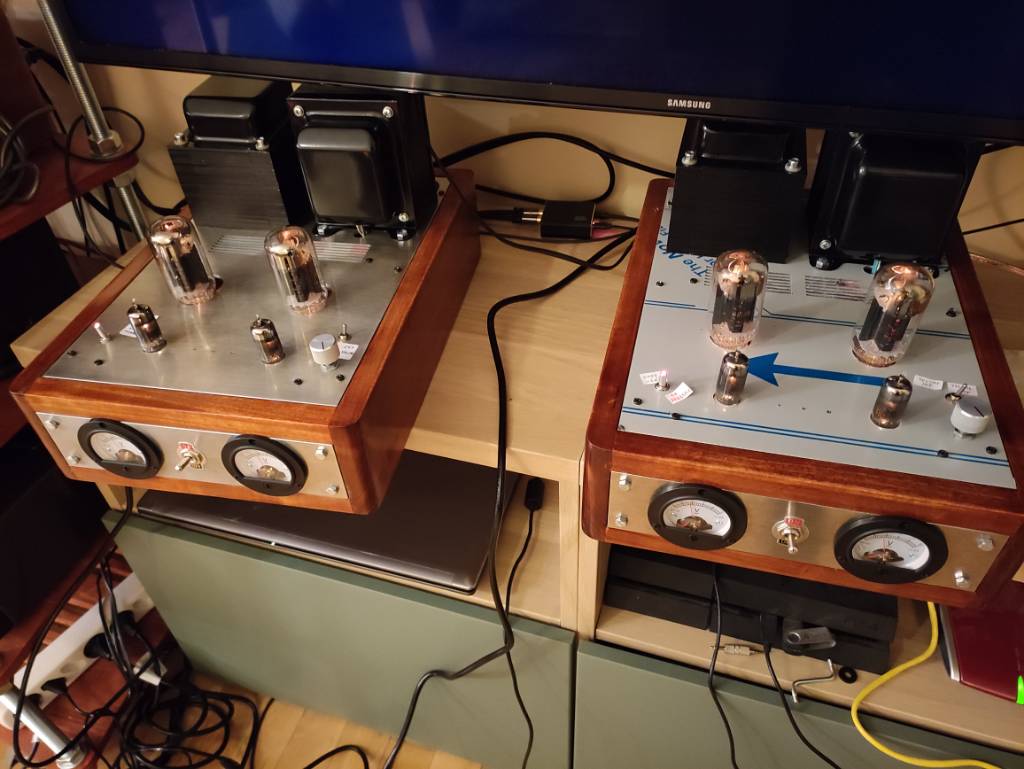

Now some logos and stickers on it, and that's all folks!View attachment 919126View attachment 919127View attachment 919128View attachment 919129

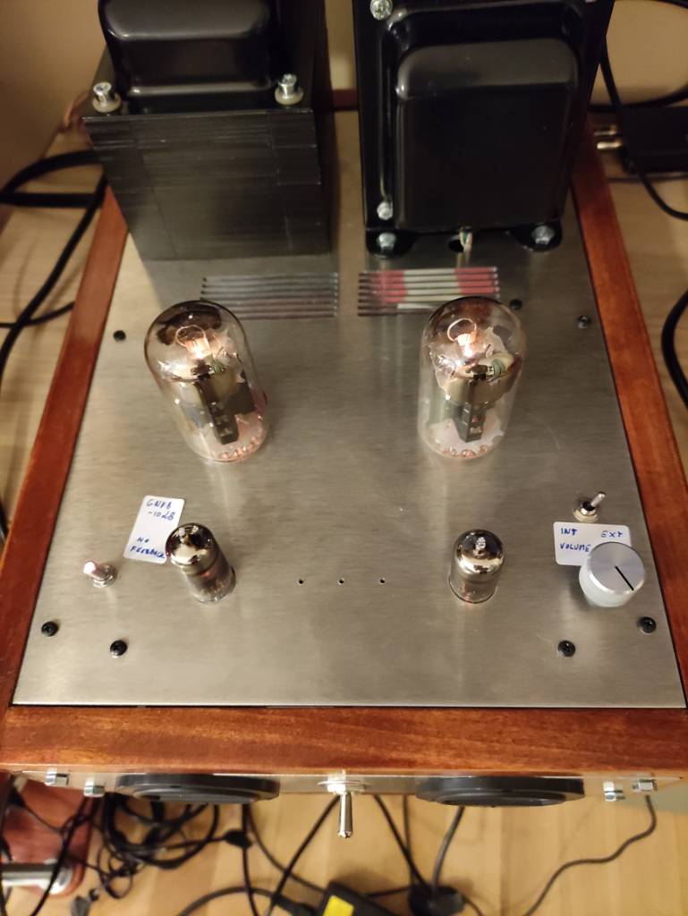

If you plan to wire output tube sockets back to the PCBs (and I don’t see any problem with it if you are cognizant of any grid-stopper/oscillation issues) then you have the freedom to choose any appropriate sweeptube, especially if you are willing to use those with plate top-caps.
I don’t know a specific “replacement” for 6HJ5, but there are several that will work well in the ”50 watt Engineers Amp”. Member “smoking-amp” tested and wrote about a lot of them in the Tube/Valve sticky ”Those magnificent TV tubes”, see link below. It is a matter of finding a source at a price that you find reasonable. As a last resort, JJ now manufactures a fresh octal-based EL509 without a topcap. Good luck.

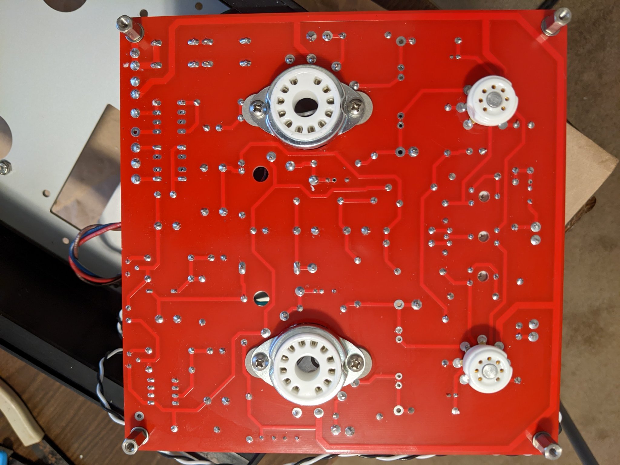

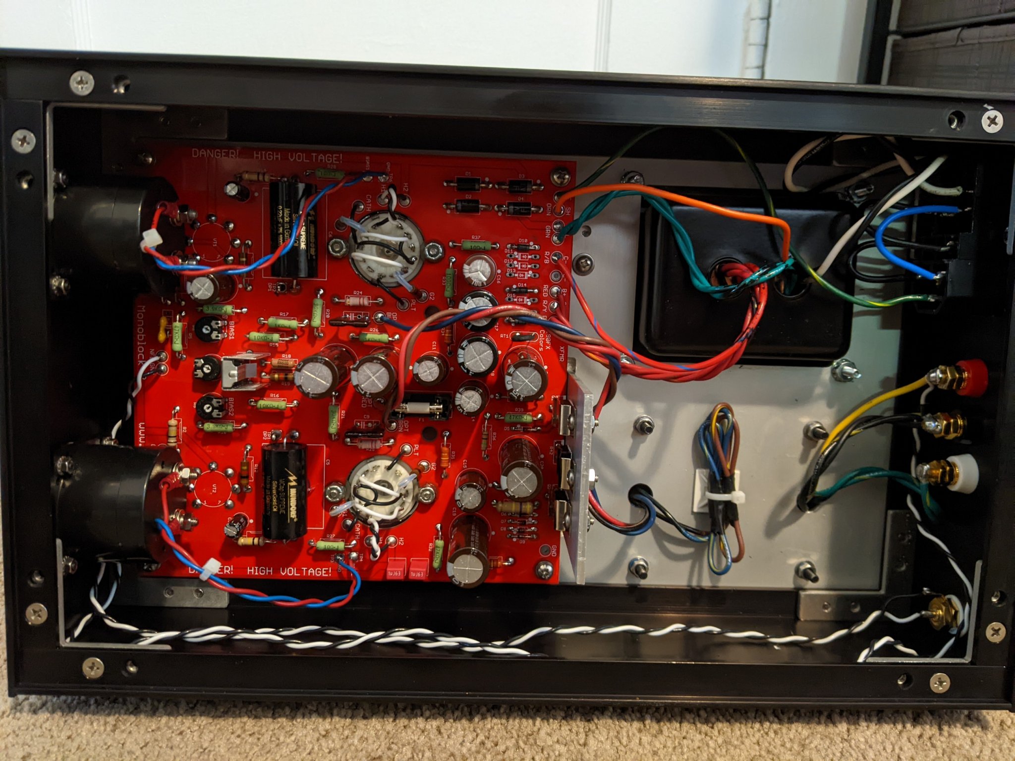

Had I to do it all over again, I would have wired the tube sockets back to the PCB rather than soldering them in place. This allows for some experimentation.
Make sure that the screen voltage regulator and B+ cap multipliers are working before inserting the tubes. I had a bad solder connection on one of the zeners and fried a pair of 6HJ5's. 6HF5's with plate cap would work but since they were used for ham radio transmitters (like Drake 2NT) they are getting expensive.
The balance pot really does allow one to trim the THD%, --

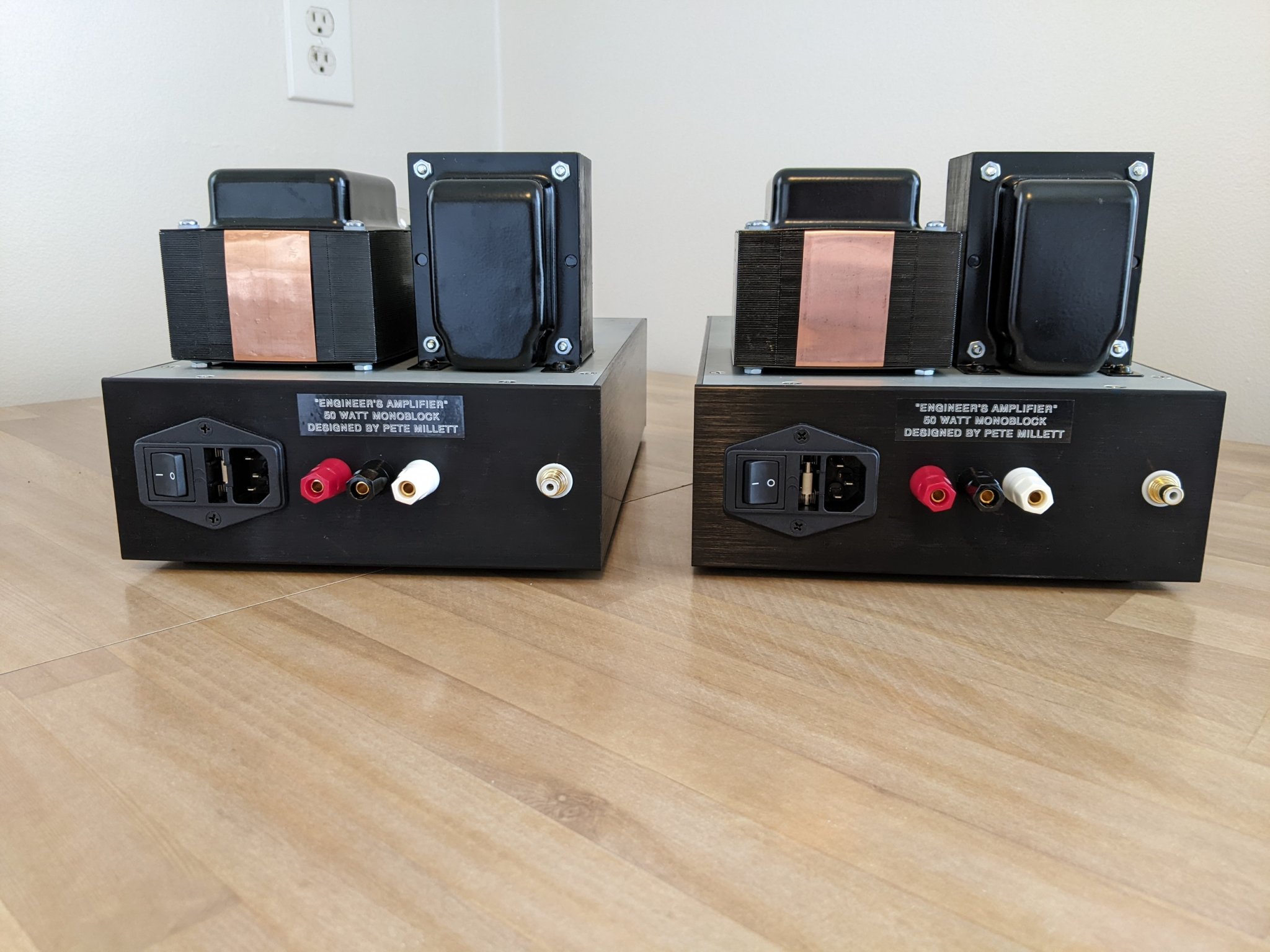

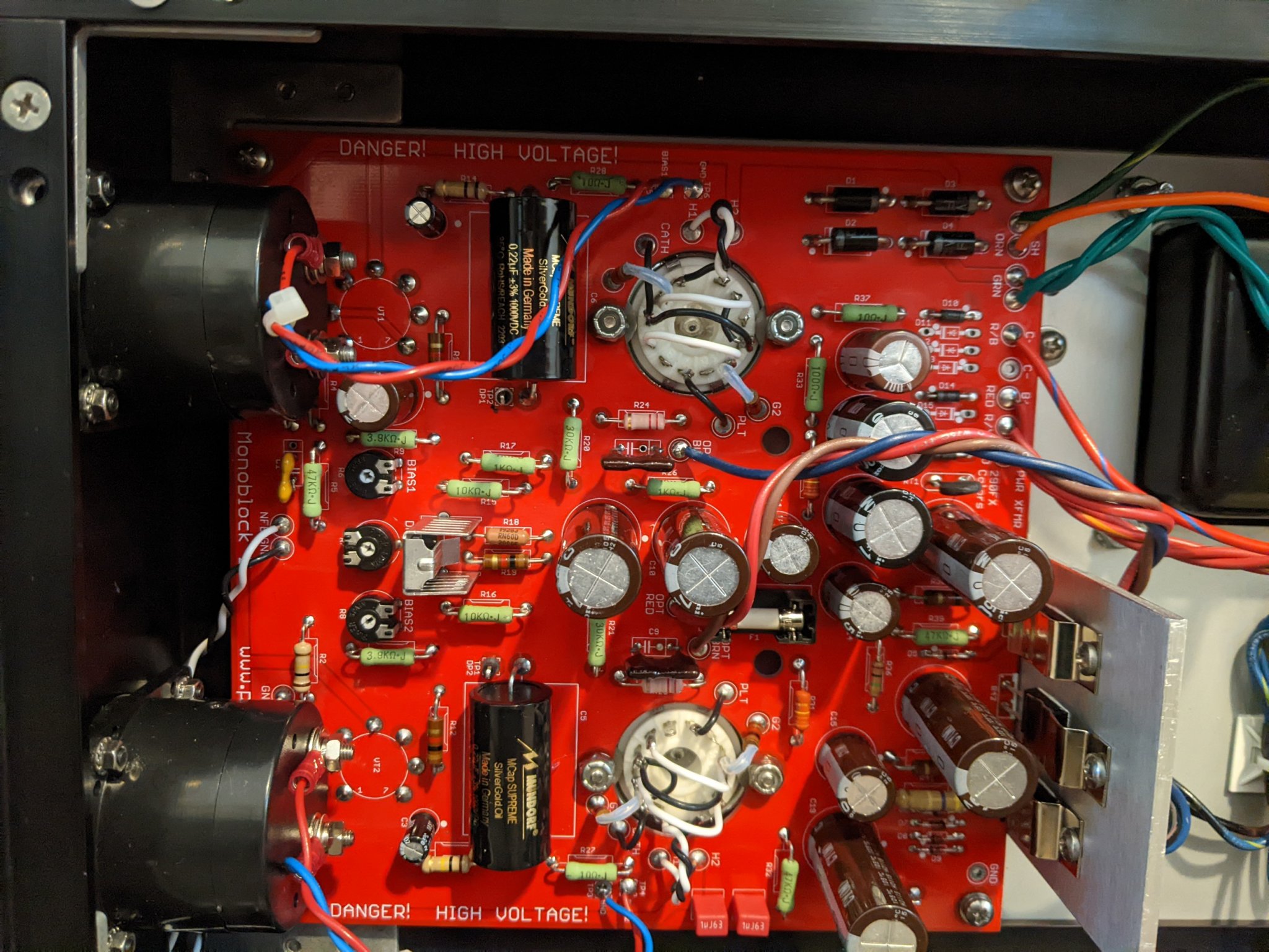

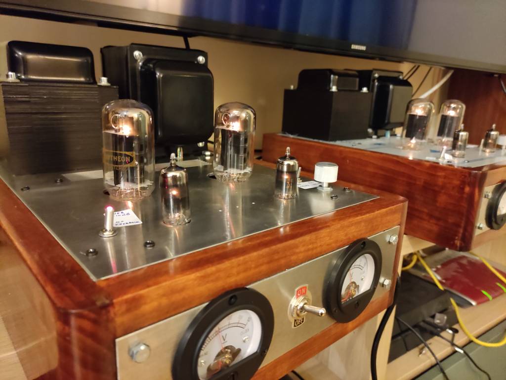

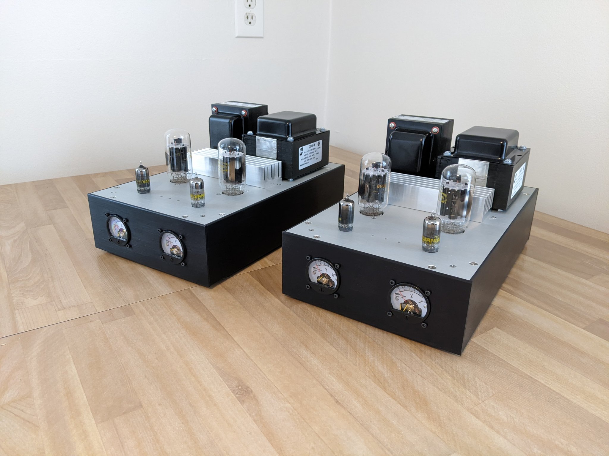

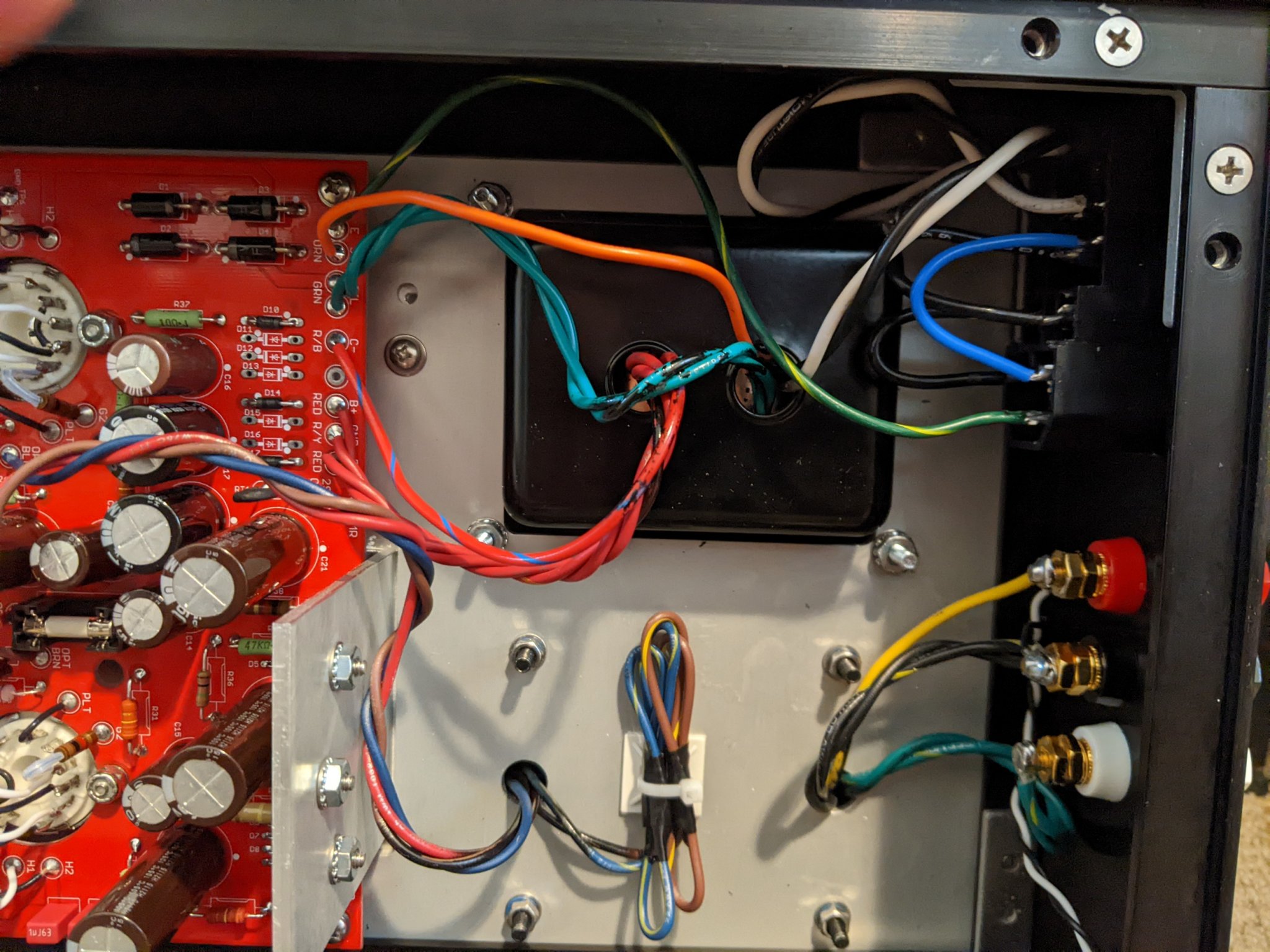

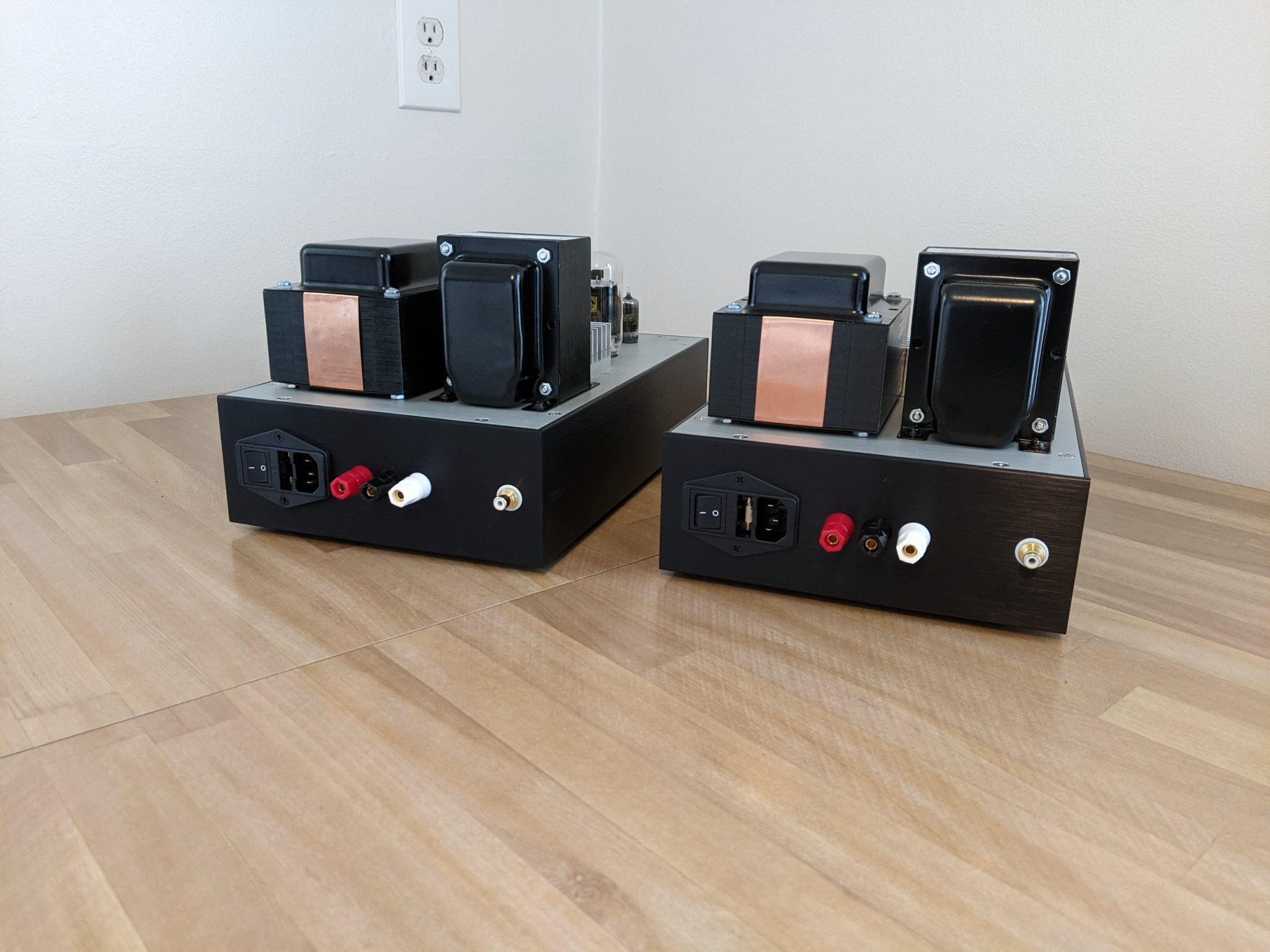

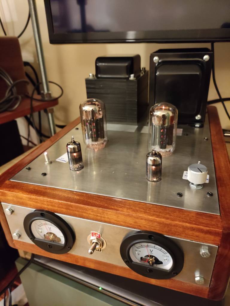

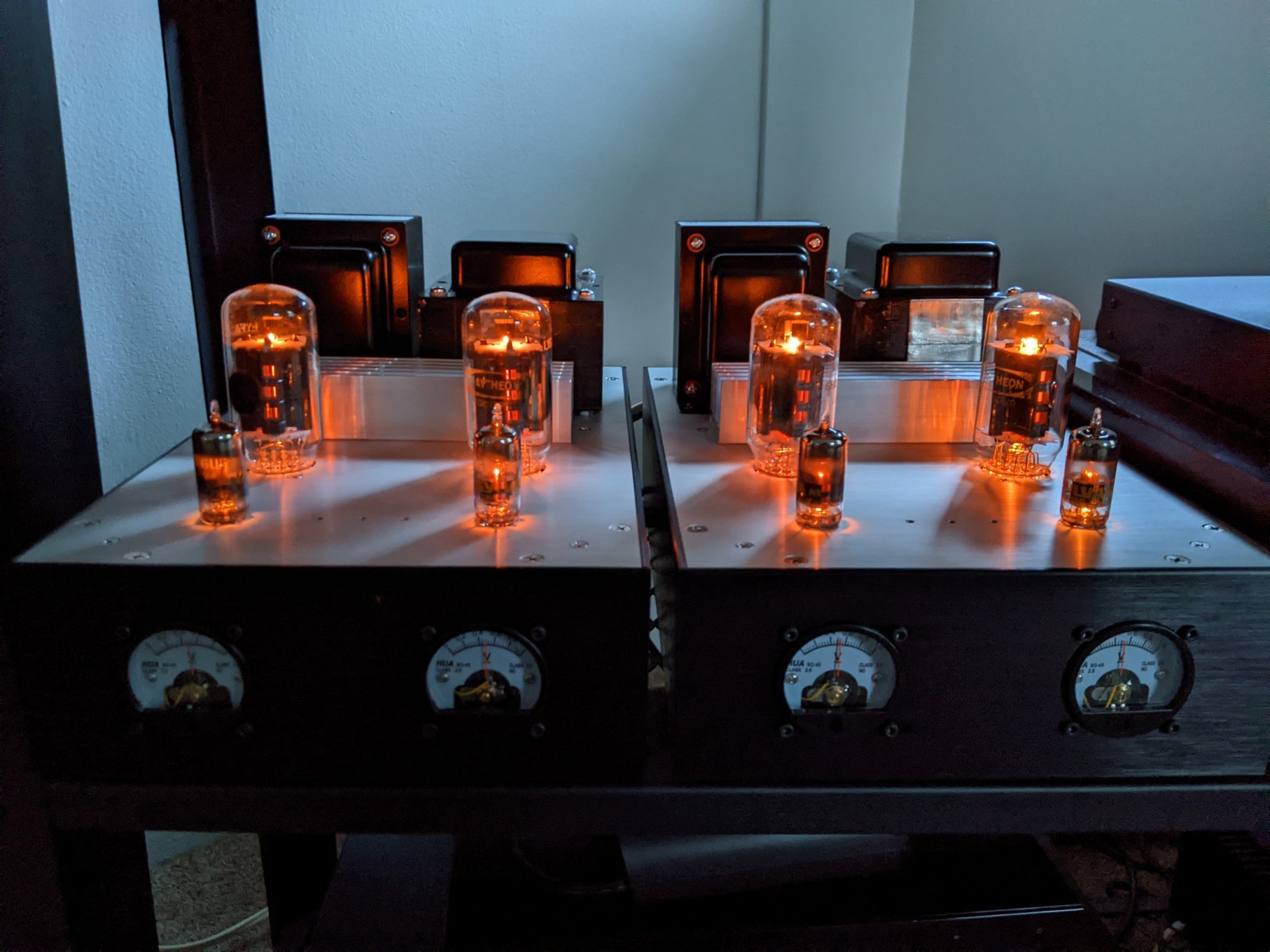

Finished my build.
I mostly stuck to using the parts called out in the BOM but I had to make some substitutions for some caps that were out of stock and some of the KOA resistors that were obsolete and out of stock.
At C5 and C6 I used Mundorf MCap Supreme Silver Gold Oil capacitors. I’ve had good experiences with these caps in other gear that I use.
One other substitution that I made is to use a 3.15A slow blow fuse in the power inlet. I started out using the 2A slow blow called out in the BOM but these were blowing on every 2nd or 3rd power up. The 3.15 fuses haven’t blown after several power ups.
The chassis is from Landfall Systems and it’s the same one that Pete used in his build, including the color scheme. The happy coincidence is that the colors match my NS-1000M speakers perfectly. It’s an excellent chassis. The guys at Landfall were great to work with.
Everything worked on first try. I was able to set the bias and balance easily with the first set of tubes that I installed. The tubes are Sylvania 6GU5 and Raytheon 6HJ5.
The sound quality is stunning. It’s very alive, euphonic, and engaging. The highs are smooth and clear. Vocals are natural sounding. Bass is deep, tight and articulate. Very big sound image. The speakers disappear. Separation and “air” around the instruments is excellent. Hooked up to my NS-1000M’s, the sound is ultra-transparent. I don’t want to stop listening.
Kudos to Pete for such a great design.
