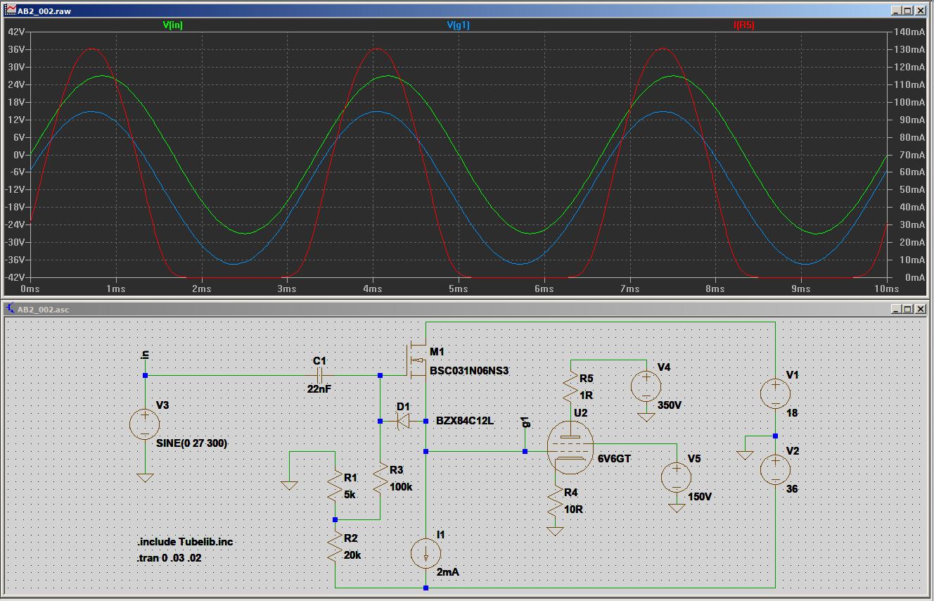

For a guitar amp, I assume we also have to limit positive signal swings to the control grids to avoid control grid failure. The 12AB5 (one of the few datasheets I can find with positive grid voltages on it) shows curves with up to +15V on the control grid. If fixed-biased at, say, -25V, then the control grids can swing from -25V up to +15V, a 40-volt swing. Do we need to also provide symmetrical negative swings (going down to -65V)? Or, since the tube is cut off beyond about -30 V, is that the maximum negative signal needed?
So perhaps what we want is something like a +18V, -36V supply for the MOSFETs? Maybe that would be easiest to get from a traditional 60 Hz 12.6V transformer, with a doubler for the negative rail, and a half-wave rectifier for the positive rail. I think I went through similar reasoning a couple of years ago, and bought a 12-0-12 (or 12.6 - 0 - 12.6) transformer for this job, before abandoning the project and eventually forgetting all about it. 😱
I feel as though I haven't yet fully wrapped my brain around the MOSFET drive, fixed-bias, AB2 layout. The basic idea is simple and clear enough, but there are still some details that aren't clear in my head.
For instance: considering the large input capacitance of MOSFETs, how big does the input coupling capacitor need to be to avoid creating a voltage-divider with the MOSFET input capacitance? And if we use this large coupling capacitor, will the resulting -3dB frequency be too low to be good for a guitar amp? And if we fix this by reducing the MOSFET gate bias resistor, how will we then get enough drive current out of the preceding tube phase-splitter stage?
Anyway, first things first. Does the attached LTSpice sim look about right? (Only one half of the PP output is shown, and no output transformer to keep things simple, just a tiny anode resistor to help me plot the anode current.)
In the plot, the green trace = input signal to MOSFET; blue trace = signal on control grids of output tubes; red trace = anode current.
I used the Dirk Reefman model for the 6V6GT, and whatever reasonable-looking MOSFET and 12V zener diode I found in LTSpice. Mr. Reefman is from Europe, and unsurprisingly, I found no included models for 32ET5 or 50C5, though perhaps they exist somewhere on the 'Net.
Supposedly the Reefman LTSpice vacuum tube models are pretty good, but I have made no attempt to verify the accuracy of the 6V6GT model. I'm not really looking for an accurate model here, but rather something I can play with to get the concepts clear in my head.

It just dawned on me again (been there before, forgot) that the driver MOSFETs are in source-follower mode, so there's no Miller effect, and the input capacitance will be much smaller.
And IIRC some of George's data (15 V signals through a 1k control grid resistor) suggests no more than 1 mA control grid current at Vgk=+15V, which means a really small MOSFET would do the job - maybe even an LND150, which has very low input capacitance for a MOSFET.
