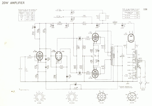

I'm looking to make a guitar amp based roughly on the AA5 design.
I'm hoping to use a push-pull pair of 50c5's, with a 35w4 rectifier, and either a single 12a*7 gain stage or a duel 12**6 gain stage for a relatively low-noise, 2-5 watt output amp.
Now, I DO CERTAINLY KNOW the rules of these things. I WILL BE USING AN ISOLATION TRANSFORMER (I have no desire to die), I know to keep the chassis and ground seperate, etc... So, let's please not have that discussion over and over.
The main thing is, I haven't been able to find an output schematic of a 50c5 push-pull pair. I've found plenty SE designs but I'm looking for a little more output.
In addition, I'm not exactly sure what cheap output tranny would work (to keep cost down) and I'm totally lost on the splitter stage. I'm looking for 2-5 watts output at 8 ohms.
I'm also looking to use parts that I already have (with probable exception of the OT and possible splitter tube.)
Any suggestions?

When 1/2 wave rectification is employed, a "standing" DC voltage is impressed on the rectifier winding. Available isolation trafos, like the Triad N-68X, are not designed for such service. You can achieve your purpose by employing a hybrid bridge rectifier made from 2X UF4007 SS diodes and 2X 35W4 vacuum rectifiers.
Set up 2 series heater strings, with a 35W4 and a 50C5 in each leg. A 12AX7 goes in 1 string and a 12AT7 goes in the 2nd string. Join the 2 strings together and add a 12BH7 (12.6 V./300 mA.) into the setup. A 5 W./68 Ohm dropping resistor at the "head" of each string completes things.
A Mullard circuit, using a 12BH7 section for voltage gain and a 12AT7 as the LTP, will easily allow you to drive the 50C5 "finals" into clipping. That leaves 2X 12AX7 sections and a 12BH7 section for preamplification and signal shaping circuitry.
A Hammond 125E should be fine as the O/P trafo. There's plenty of magnetic headroom for the NFB error correction signal.

Egg,
If you follow the advice I previously gave, your "iron" purchases will be limited to: a Triad N-68X isolation trafo, a Hammond 125E O/P trafo, and possibly a Triad C-7X filter choke. CLC B+ filtration is better. Allied Electronics charges $10.36 for the C-7X choke and $11.41 for the N-68X trafo. An Edcor XPP15-8-5K O/P trafo, which costs $20.00, should be suitable in this guitar application. Take advantage of the O/P trafo's UL taps by connecting the 50C5 screen grids to them by 1 KOhm resistors.
A 12AT7, a 12AX7, 2X 35W4s, and 2X 50C5s you seem to already have. Jim McShane charges $12.50 for a current production EH 12BH7. Jim also sells UF4007 low noise SS diodes at a fair price.
BTW, you might be better off with a 12AU6 or 12SJ7 pentode in the preamp, instead of a 12AX7, as the modest B+ rail voltage in this amp will not allow large plate load resistors.
I've attached the Mullard 5-20 schematic. Study the topology, as it works for the types we've been discussing along with EL34s, etc.
