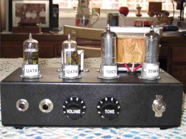

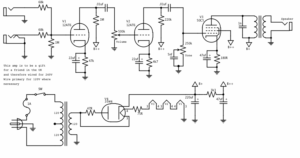

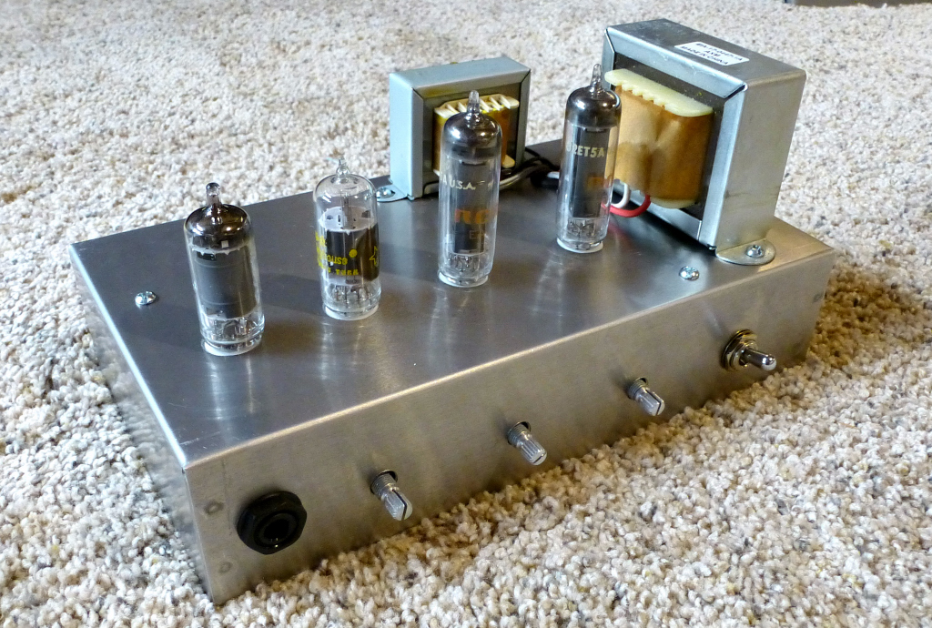

Looks like I'm a year or two late in this thread, but thought I'd share. I built a SE 50C5 amp as a gift for a friend in the UK when we met at the Dayton Hamvention.
It uses 12AT6 (x2) as the preamp, 50C5 output, and 35W4 rectifier. Undistorted output approaches 3 watts when feeding a 8-ohm non-inductive dummy load and measuring on my Hitachi scope. A 75 ohm resistor eats up the remainder of the series heater string voltage.
The amp is powered through a 120/240 / 120 isolation transformer, and since this amp is destined for the UK, it is wired for 240V.
Plenty of volume for bedroom or living room, and eases into distortion at moderate volume.

The transformer I used is a 50VA Triad N-68X isolation transformer. It is available for $11.20 from Mouser.
In addition to allowing 120v / 240v primary option, the heftier transformer also has enough capacity so the series wired heaters can also be on the isolated side.
Joe
Joe
Joe
Thanks Joe, I ordered 2. Are you saying to hook the secondary up to the mains, then run the heaters and B+ voltages from the separate primary (now secondaries)? Thanks,
Nicholas
Nicholas
Yes, that's the idea. Because otherwise, the heaters string would pose a danger, too.

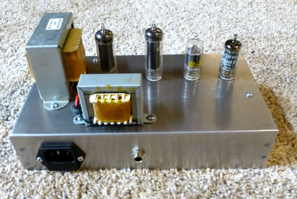

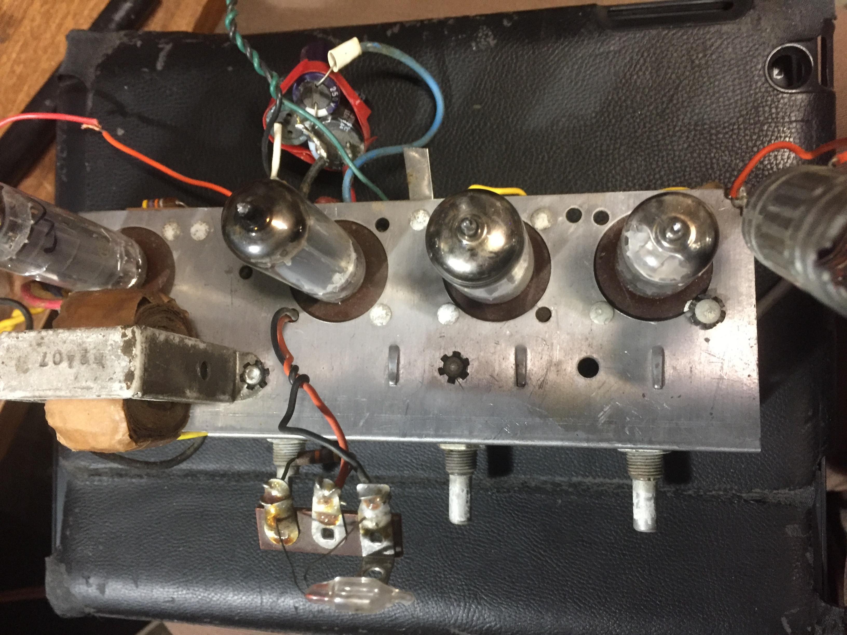

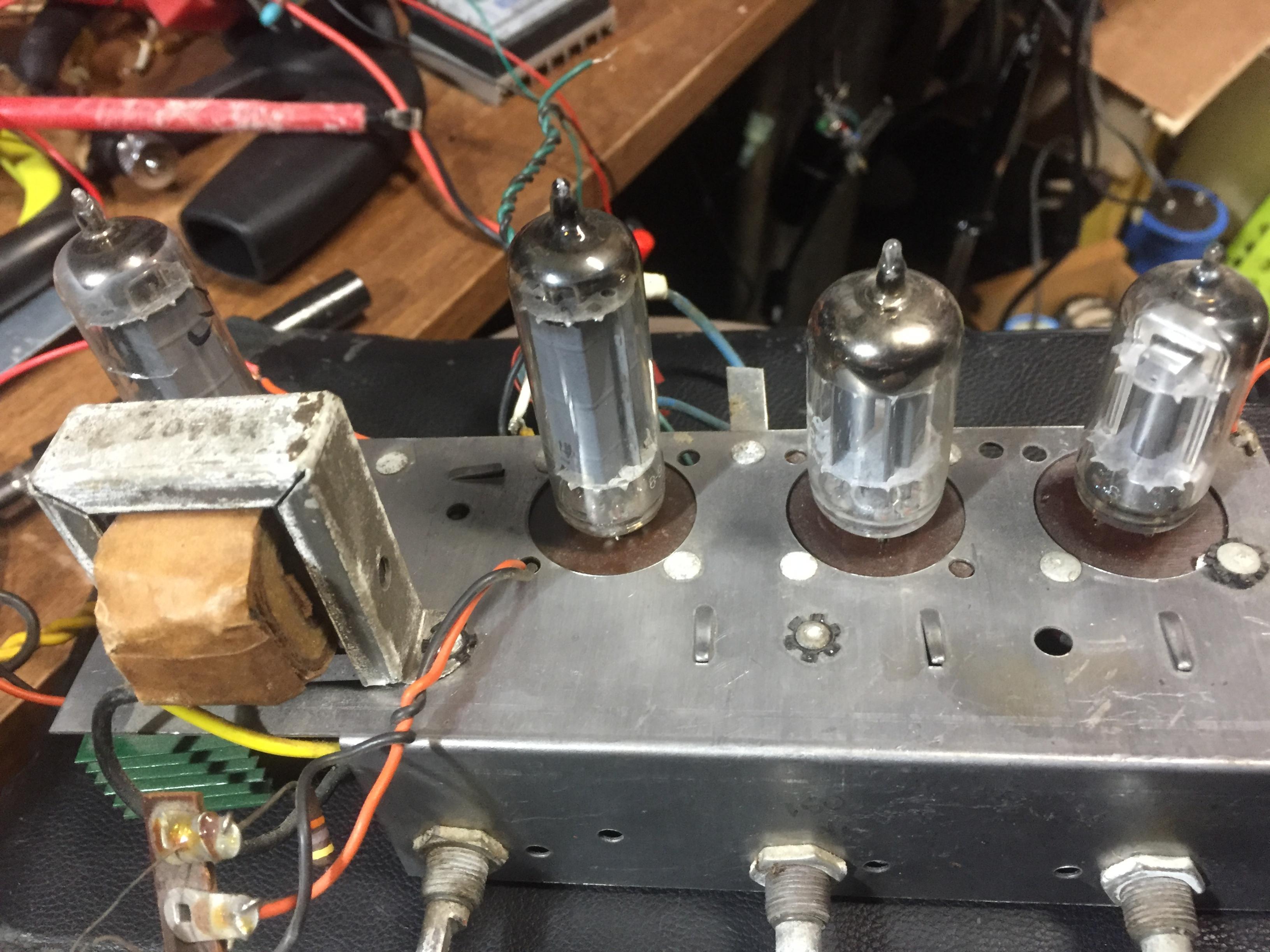

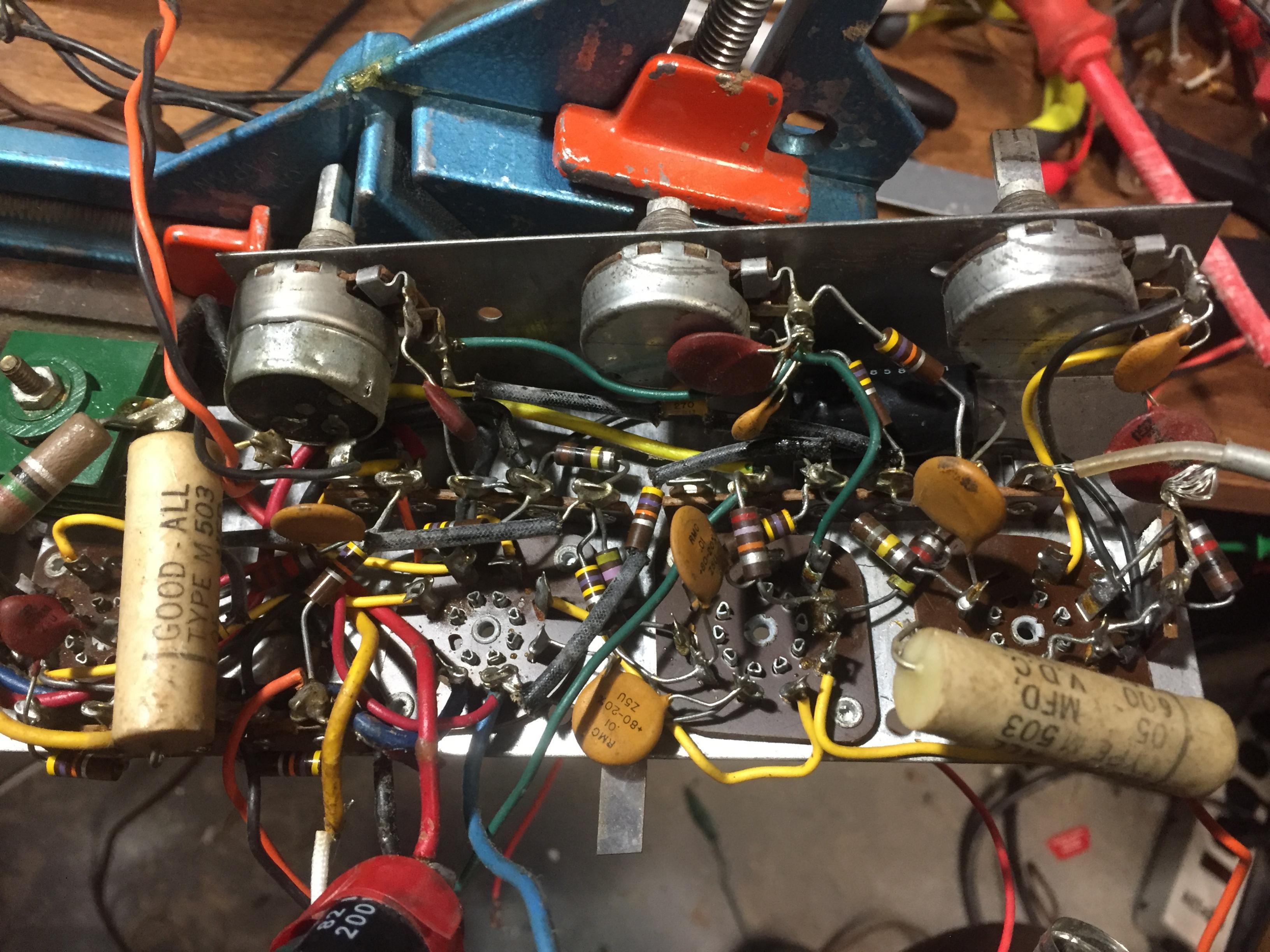

Old thread resurrection here; 'curious if a p-p 50C5 ever came to pass?
I ask, as I have a late-50's "mystery chassis" already most of the way there...and I sure could use some ID-Assistance!:
It is a 50C5 (push-pull <!>), four tube...but not the typical SE/12AX7 type ala RCA "RS-158" chassis: This has the a 12AV6 up front, but some (unidentifiable looks like "25X7" yet worn off) other tube apparently providing phase-splitting before the p-p 50C5's. There's an iso-trans, selenium rectifier and apparently dropping resistor in the series heater chain. It has been suggested that it might actually BE a 12AX7, and I'm just fixated on the nearly erased tube branding...

I'd love guidance on the mystery chassis, as well as a model/schematic assistance. I've scoured the web for a week for similar topologies - and I'm a better than average Google'r - but the RS-15x series seems the closest. I'd hate to have to guess, based on series heater v'drops and pinout swag'ing. My goal, as with the O-P, is to convert to small guitar amp.

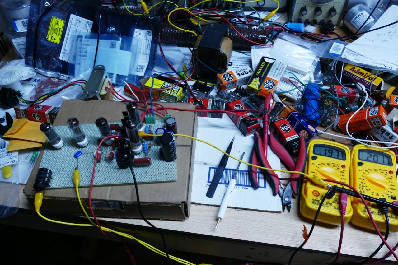

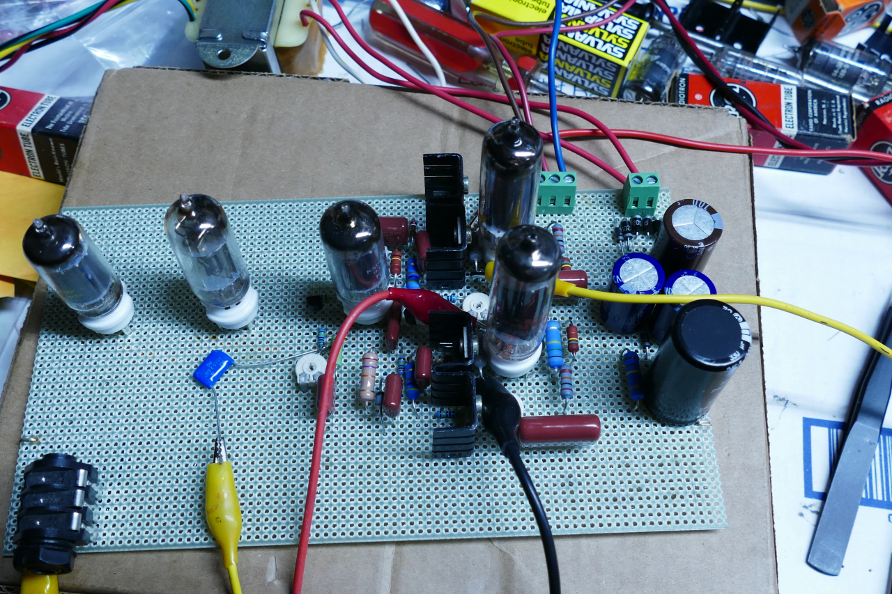

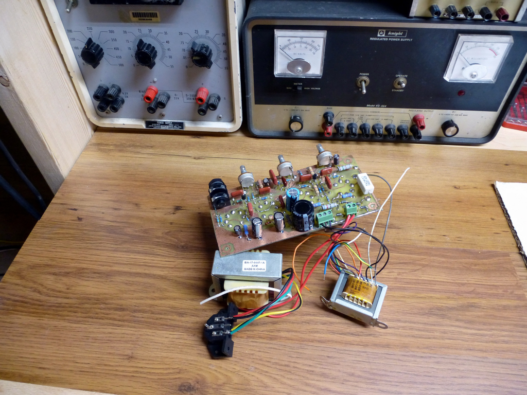

It's not finished yet, but here is an unusual design that uses mosfets to drive the 50C5's into AB2. The power amp stage is still being developed, and the preamp stages haven't been started on yet. The unusual feature of this one is that it squeezes 20 watts out of a pair of 50C5's with HiFi levels of distortion. I will continue to work on it as time allows. (first three pictures)
B+ is about 350 volts, screen grids are at 140 volts. It has passed my "leave it running at full power overnight to see what happens" test with no damage. I set it to exactly 20 watts, where it made just under 3% THD with a slight hint of clipping on the bottom half of the wave. It was making 20.04 watts at 3.1% THD the next morning.
This evolved from this little amp that made 3 watts from a pair of 32ET5's on 170 volts of B+. They will make about 15 watts per pair on 350 volts and sound better than the 50C5s for cranked to 11 guitar. (next 4 pictures + schematic)

The limiting factor in many push pull amps is often not the plate dissipation, it's the screen grid. That is the case with the 50C5. I set up one of my Universal Driver boards (mosfets to drive the grids of the output tubes) with variable power supplies and ran a bunch of different tubes up to their breaking points just to find their limits.
I pushed a pair of 1940's 6L6GA's to 110 watts into a 3300 ohm load on 500 volts. They just sat there cranking out this much power for several minutes without any unusual glow on any internal parts. Going beyond 110 watts however, resulted in a tube arc blasting the cathode resistor in half. The tubes survived and lived on for more testing. At the same power 110+ watt level, another tube arc, and another blown resistor.
The 50C5 gets the glowing grid syndrome somewhere between 30 and 40 watts per pair on 340 volts into 6600 ohms depending on which tubes I tested (Sylvania, RCA or GE).
Most of the 50C5's that I tested didn't show ANY red plate in a dark room until 13 to 15 watts of dissipation per tube, so I arbitrarily set my limit at 10 watts.
The screen grid spec is 1.25 watts which seems to be the norm for other tubes of the same size with a HOT 7.5 watt heater. I would not venture too far beyond this for any continuous or high duty cycle operation like a cranked guitar amp.
To get max power from 20 watts worth of plate dissipation, you need to maximize efficiency. AB2 operation and a carefully chosen load impedance are used here to squeeze big watts from little tubes.

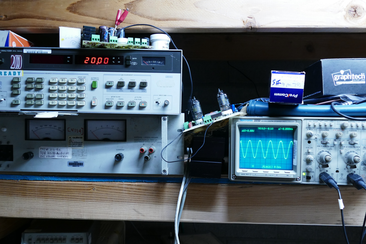

Here is the power output data for two tubes (but I didn't note which was which) with all the critical tube conditions noted. One pair of tubes stayed in spec to 30 watts. They will indeed run all night at that level. The others will not. The screen grid goes over 1.25 watts at about 27 watts of power output.
Both sets, and all the others that I have tested will run happily at 20 watts. All hit clipping right at 30 watts. At this point the THD and the screen grid current go up abruptly. running them continuously in clipping WILL fry them......So how do we make a cranked guitar amp?
