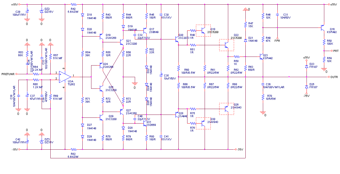

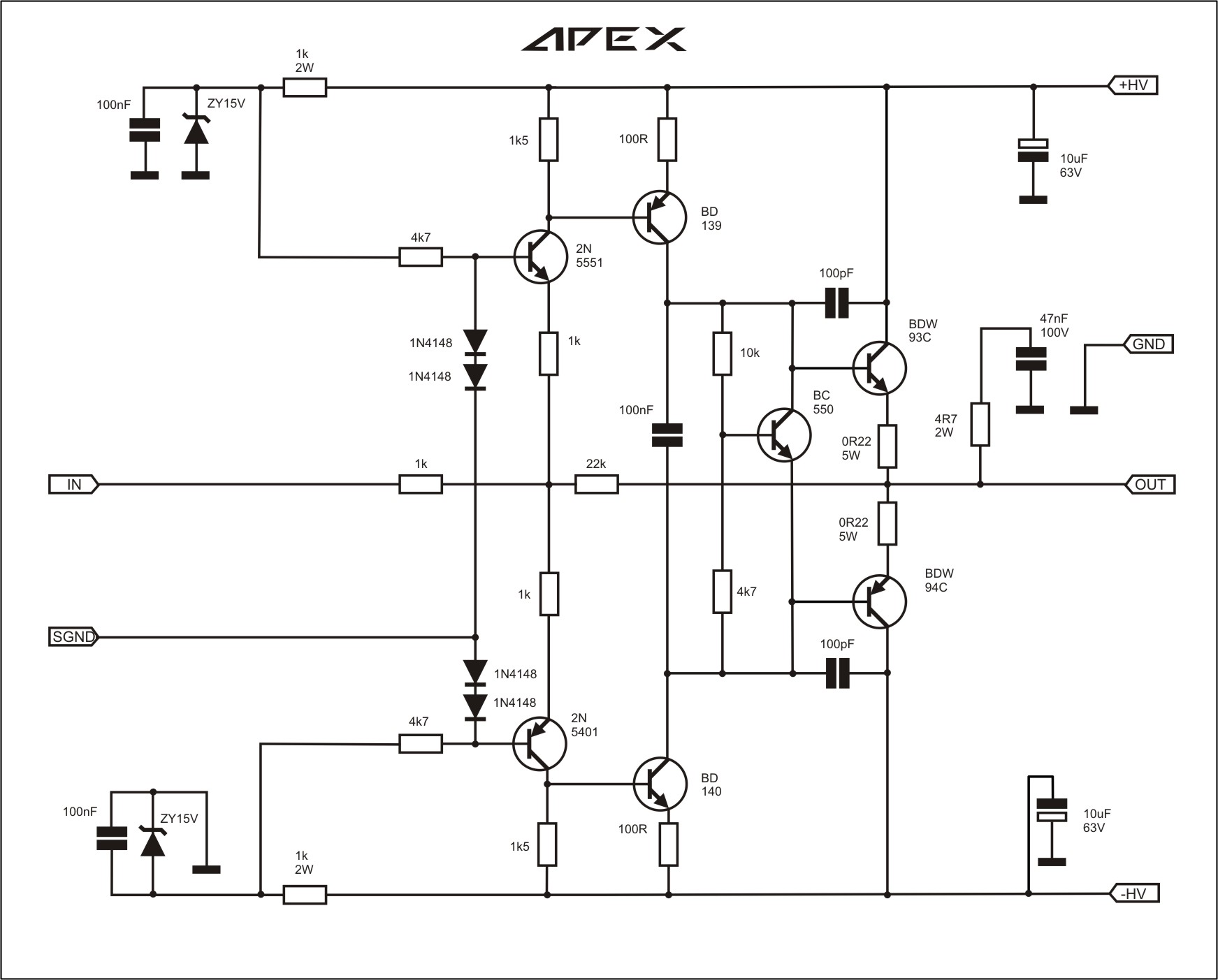

500W PA amplifier with Limiter
I have designed an circuit ,look the same as circuit Ampex B500.
With feedback global use BJTs

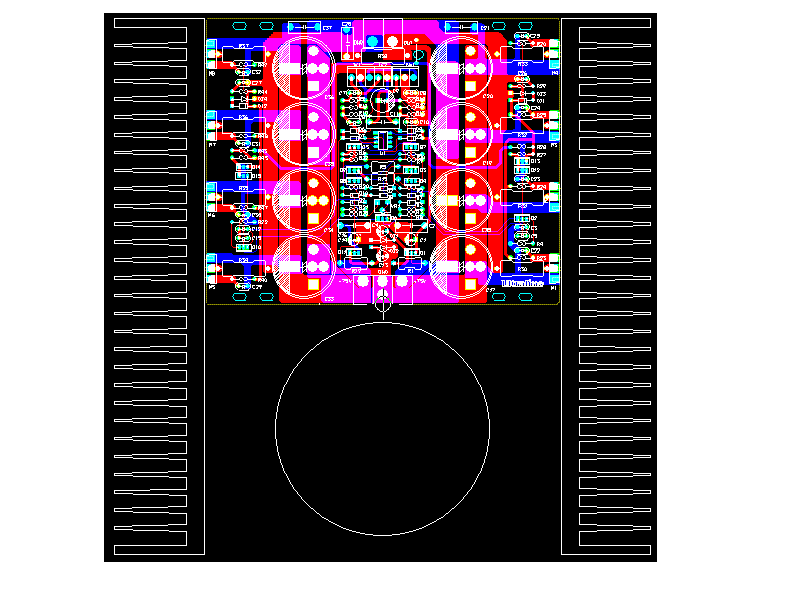

Hi!
I want to build this amplifier, and I have some questions. I don't want to use limiter, bridge mode and the protection. I marked some components on the picture below I think i don't need:
On the right side, I'm not sure if the two diodes (1n4007) are for the protect or the amplifier. Will it work if I remove these components?
And another question. Is +-70V enough to get about 350W at 8 ohm speaker?
Thank you for your help!

Amp will work, but do not remove 1N4007.
+/-70V is enough for 350W at 4 ohm .
Regards
