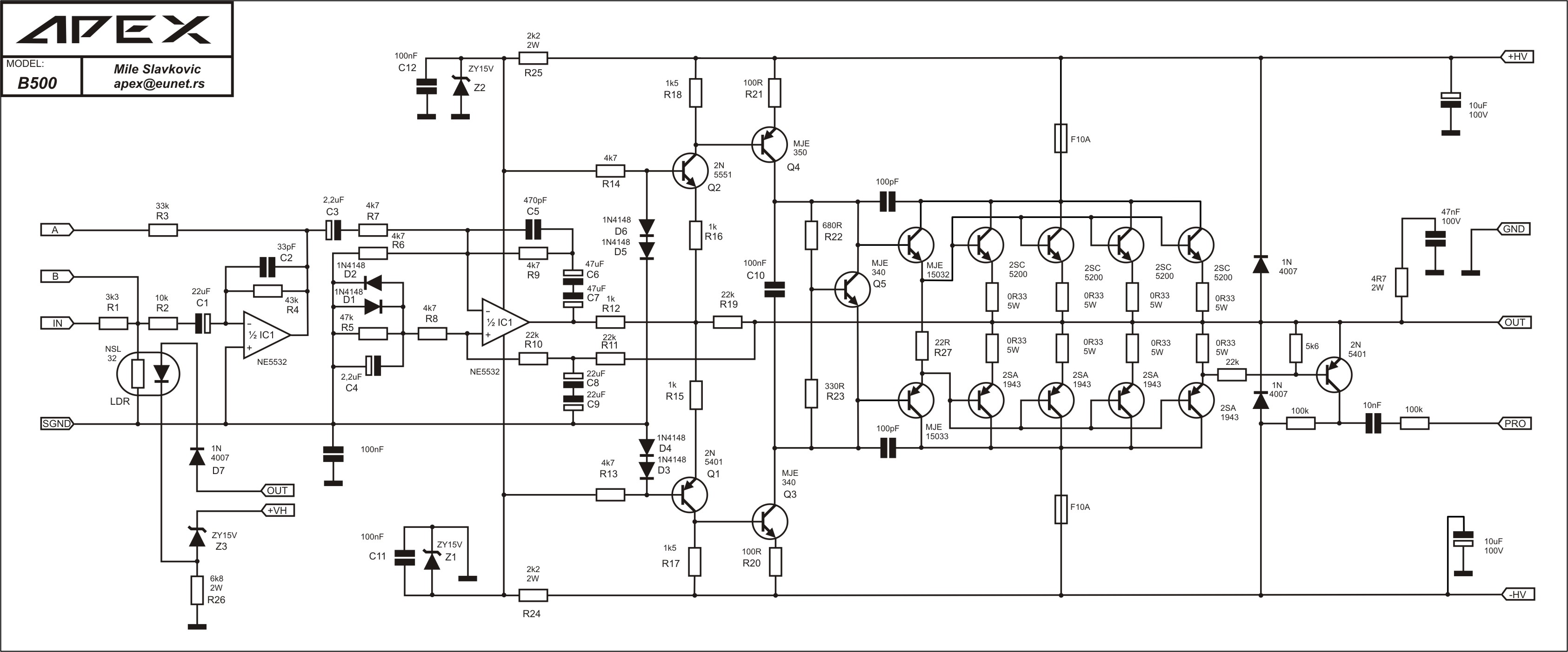

can i use c5171,a1930 or c4793,a1837 instead mje340,mje350 for pre driver section.
if its ok so is it need small heatsink or no need heatsink.
Yes, and use very small heatsink.

Replace R2, use 1k instead 10k and gain will increase.
If R22(680) decreased bias decreases or not?
Can I use 3mm led in place of NSL32?
Yes and yes, you have 'clip' led and amp without limiter.

Hello mile can i ask if it is possible to use 85vdc+/- on B500 do i have to change anything any modification?
No change for 8R speaker, but for 4R better add 2 pairs of outputs and use large heatsink.

Nothing happens without 47k resistor. Increase bias to 25mA per outputs for better treble. Clip LED glows about 10V before hard clip (about 80% power).

A few question before I go to build this amp. I'm Just trying to understand the circuit, I been notice that Q1 and Q2 is in position of common collector biasing, correct me if I'm wrong, so the main signal path going through R15 and R16 and that time Q1, Q2 will saturate depend on the signal. now question again how it works D3, D4, D5 and D6.

The output of the op amp is fed to the emitters of Q1/Q2 via R15 and R16, actually Q1, Q2 are common base circuits, not common collector as you think...please look at the schematics again....
Diodes D3, D4, D5 and D6 biases Q1 and Q2, so that about 0.6mA runs thru these trannies.....
