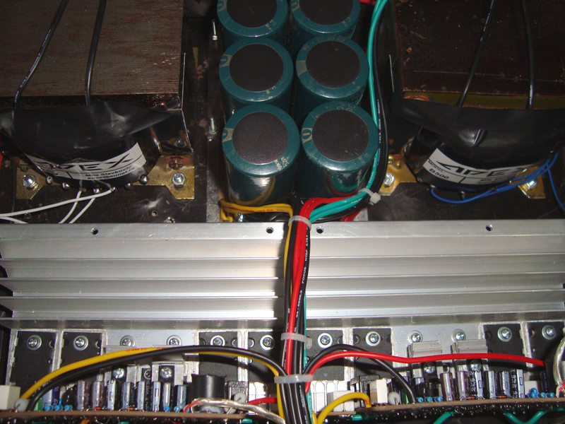

500W PA amplifier with Limiter
B500 ROCK MY HOUSE
Thanks to Apex
I'm so happy now
my B500 now Playing USB thumbdrive & FM

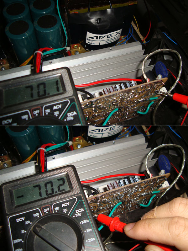

power rail +/-70V DC
from 2 trafo @600VA 57V ac each
load 8r
its cool, not so hot
No Humm, no hiss
just the music
loud & clear
(I think heat sink is small so I don't go to 4r yet)

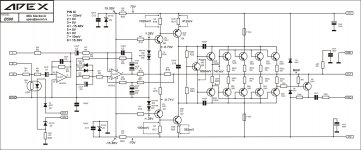

Some question,
Why I can't measure any voltage across 0r33 resistor when the volume minimum?
Any suggestion which component to be change?
attached image of some measurement
Also its need or not to add "Apex Speaker Terminal" on the output amp like AX series?
If need, any changes or its just same as AX Speaker Terminal?
GBU & PEACE

Nice work.
There is no voltage across 0R33 becouse outputs work in class B, use 1k pot instead R22 and set 10-20mV for work in class AB (BIAS 50mA).
Add 'Speaker Terminal' on any amp, there is DC protect (crow bar) and Zobel Network.

Oh that why,
I will work it in class AB later
for now its okay anyway
my speakers are subwoofers
they like this amp
Thanks again

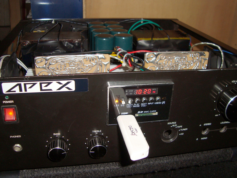

Hi JOHN, i want to know about your USB thumbdrive & FM did you build it (DIY) or bought it ?
i want that one for my amp... thank's
I bought it in Denpasar @ my uncle elec-shop.
Anyone want to buy from me ...? or want to trade it with IR2117 & some u fast diode that hard to find here.
I just have one of it left, want to give it to Sir Apex as a gift he...3x 🙂🙂.
Wish he come to Bali, maybe some vacation.
