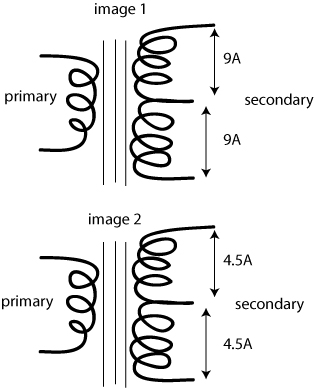

I suggest 2x55VAC, 9A for stereo amp.
hi apex sir,
u suggest 2/55vac 9A transformer, but, i asked transformer winder man, i need 9a transformer.
so he asked me, u need 9A by 9A or 4.5A by 4.5A? i m confused.
can u explain.
see the attached image which is correct 1 or 2?
