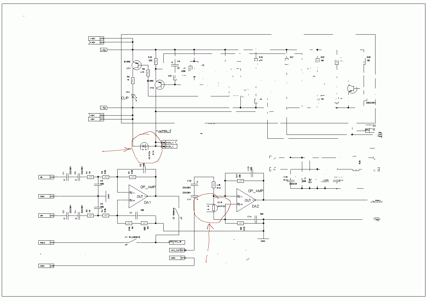

I must say once again that B500, and H900 can work without NSL32, you just have no limiter, and instead led diode integrated in NSL32 you can use regular led diode for clip indicator.

ldr+led only

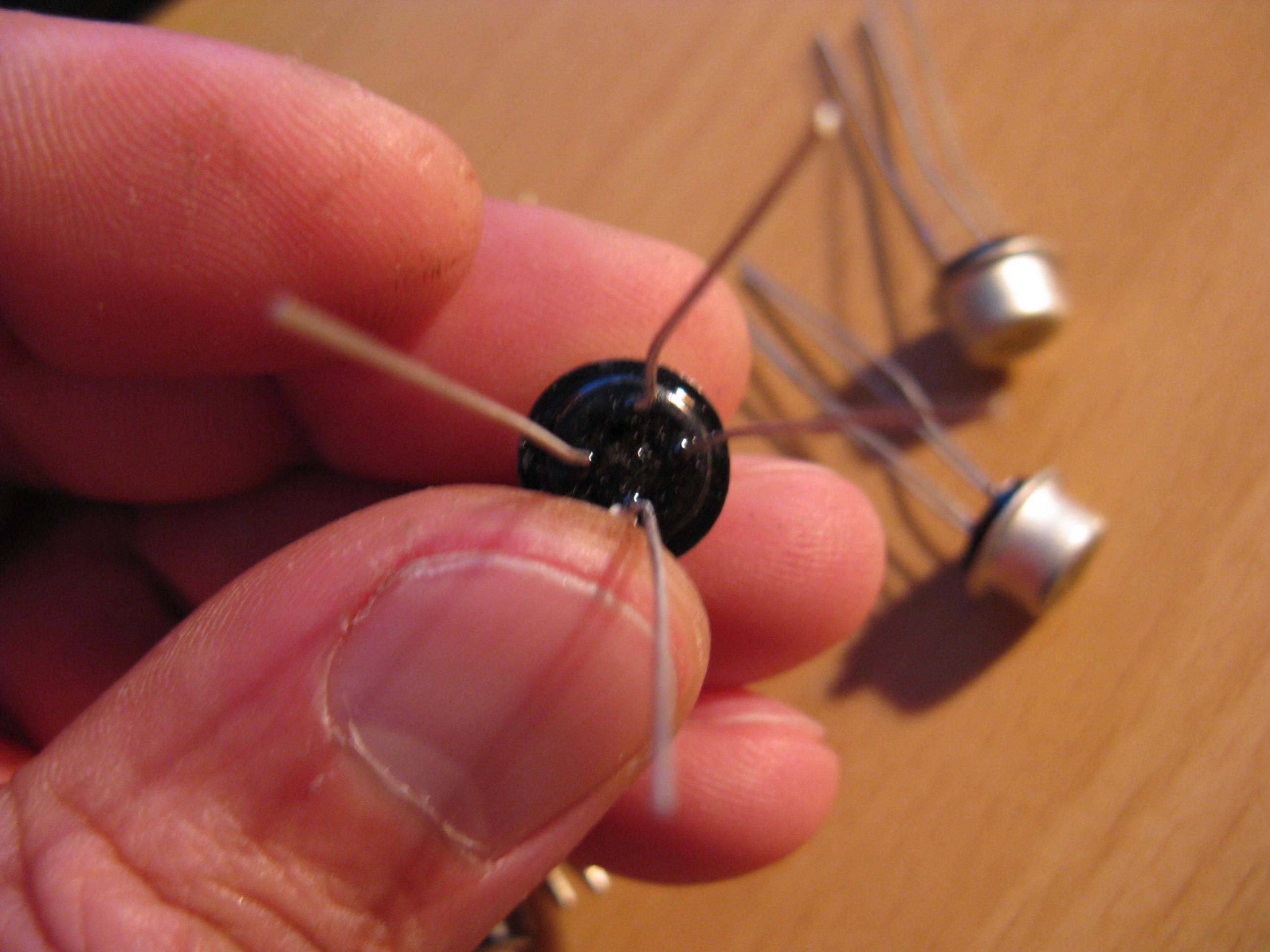

Is this opto ldr? What is pin layout?In Russia you can get an approximate analog aor124

Thanks, I like case, it is more robust than NSL32.Here are the details in Atach

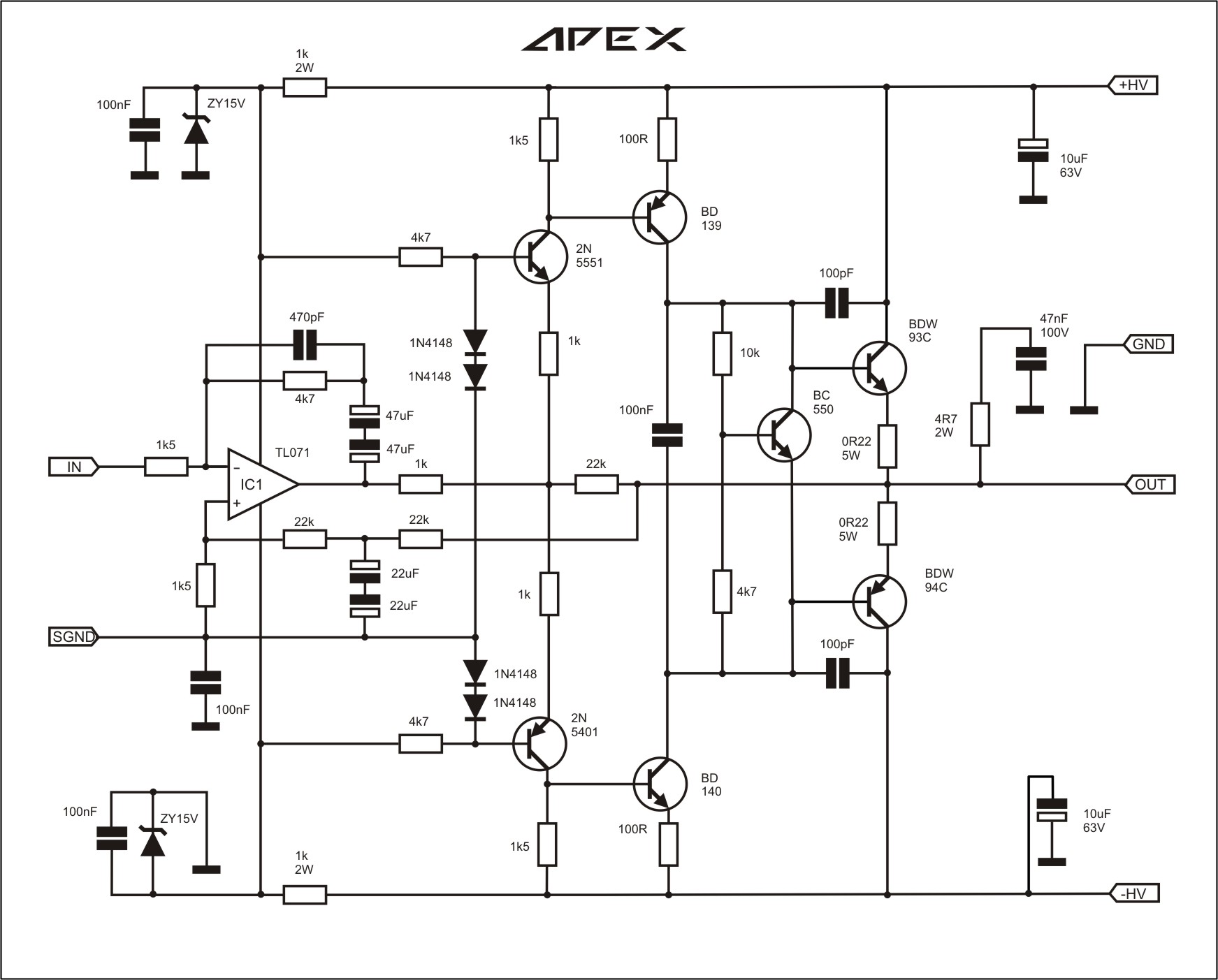

Not had to deal with NSL32, I can not say anything, but people did on aor124, it is in kliplimiter in amplifiers, working chetko.Ya now finish your payment b500 and check!
Look like AOR124 is perfect for B500, if pins layout is right, but that will be smal problem.Here's a similar example!
