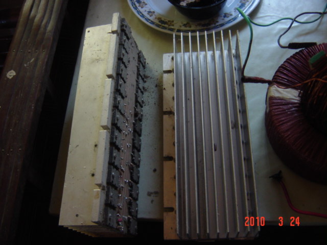

this is my heat sinkDo not powering up without heatsink, drivers transistor work in class A.
Don't forget wire jumper on coper side pcb.
Don't forget to connect input GND.
Use 150R 20W on primar ac transformer.
U can use 100R instead fuses, I don't, but I made 1600 amplifiers still now.
Check DC offset before connect speakers, use 100uF bipolar if U want test amplifier without protect.
Good luck!
Regards

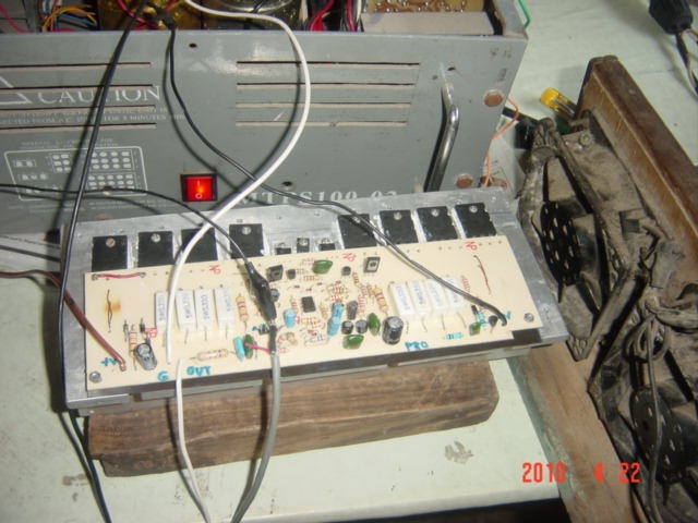

what particular ink are you using
that is not a ordinary silk screen embosed ink
I just print layout PCB, my friends is specially work in advertising which transfer in PCB. I don't know what ink in used..

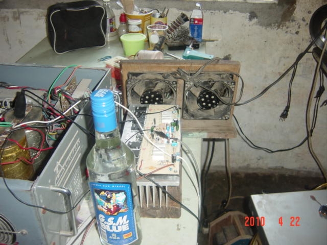

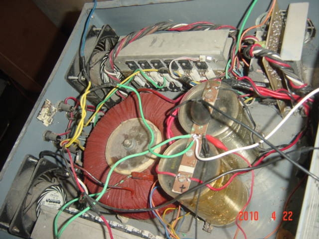

That was fast work. Congratulation!apex;
working b500
good sonics
i'll drink for this one;
cheers
Cheers
Cheers
i still envy to those who manage to get IR2117,😡
but i still have tlo72 step driver to make🙂
thanks to you apex
What speakers you have?i still envy to those who manage to get IR2117,😡
thanks to you apex

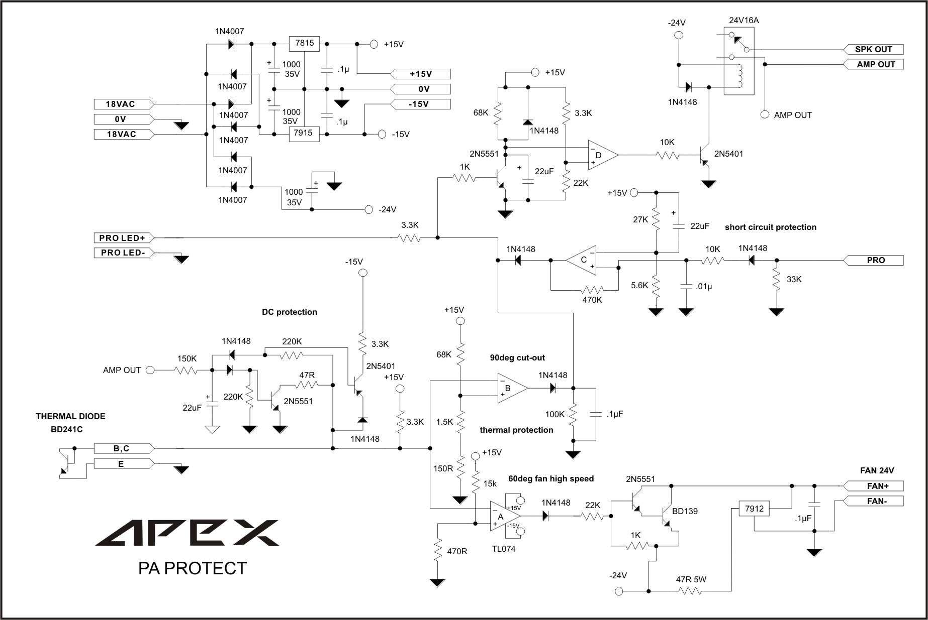

PA Protect Schematic
PA Protect include:
1 Anticlick 5sec delay
2 DC cut-out
3 Thermal cut-out on 90deg
4 Fan high speed on 60deg
5 Over current protect (power-on reset)
Conectors:
1 2x18V 500mA AC
2 +/-15V DC stab for XLR circuit
3 PRO overcurrent detect
4 Protect LED
5 Thermal sensor BD241C as diode on heatsink
6 24V DC Fan cooler (12V for low speed)
7 Speaker IN/OUT
This is 18inch subwoofer? Try B500 on full range speakers, and you will hear crystal clear sound.jblsrx18s clone
