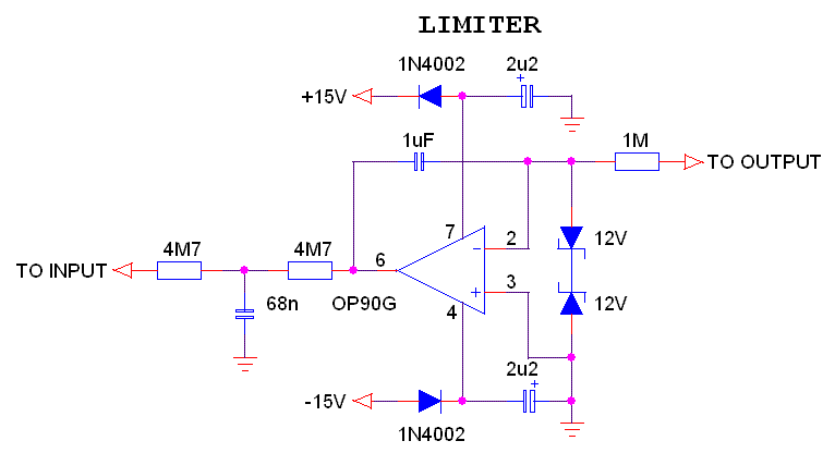

500W PA amplifier with Limiter
Hi Mile,
Can you modified the values for replacement for NSL32
