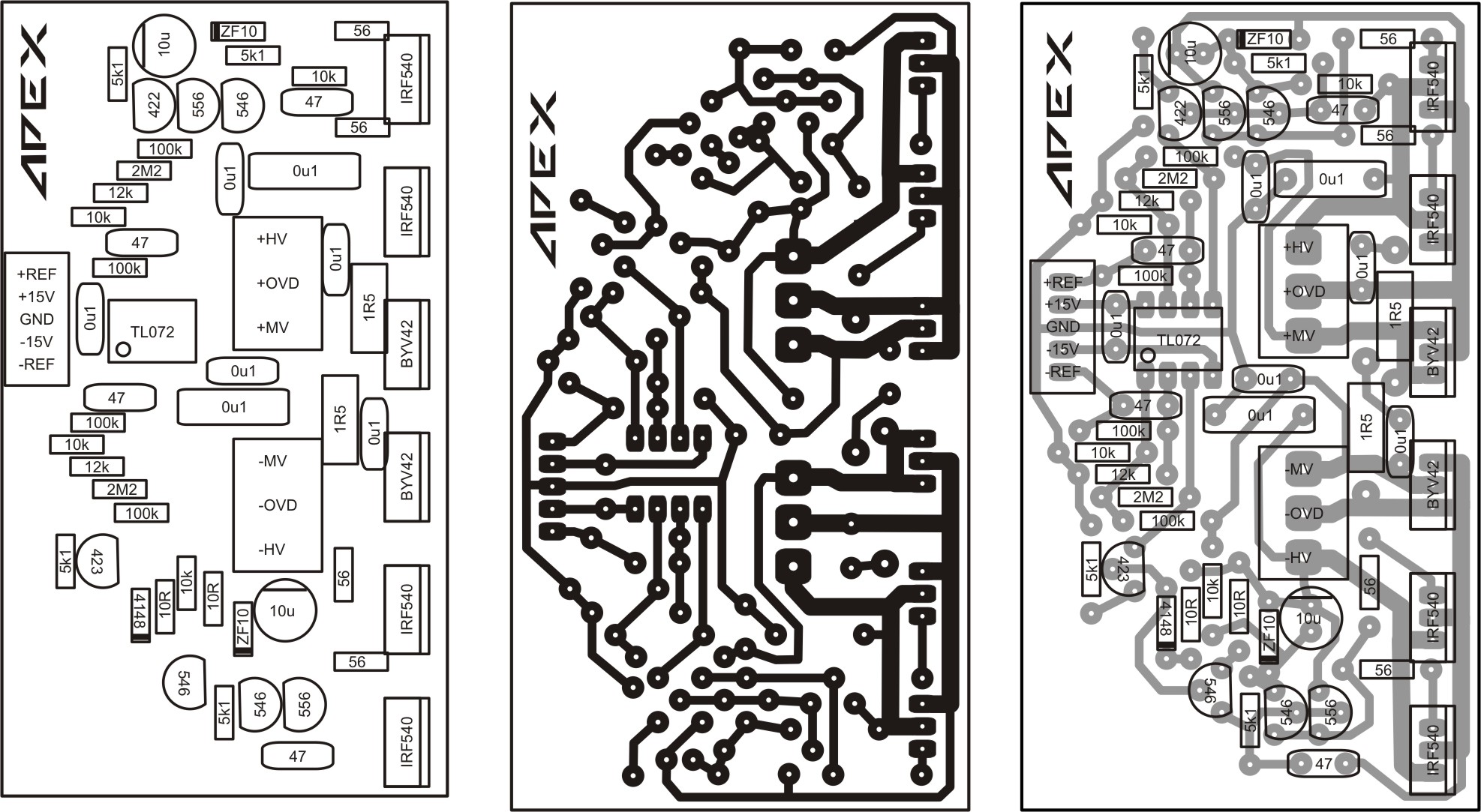

Hi coolet
I'am edit track and add resistors stabilizer 10 Ohm to power out put transistor.
Regards.

hi teslar can u post the parts placement,,

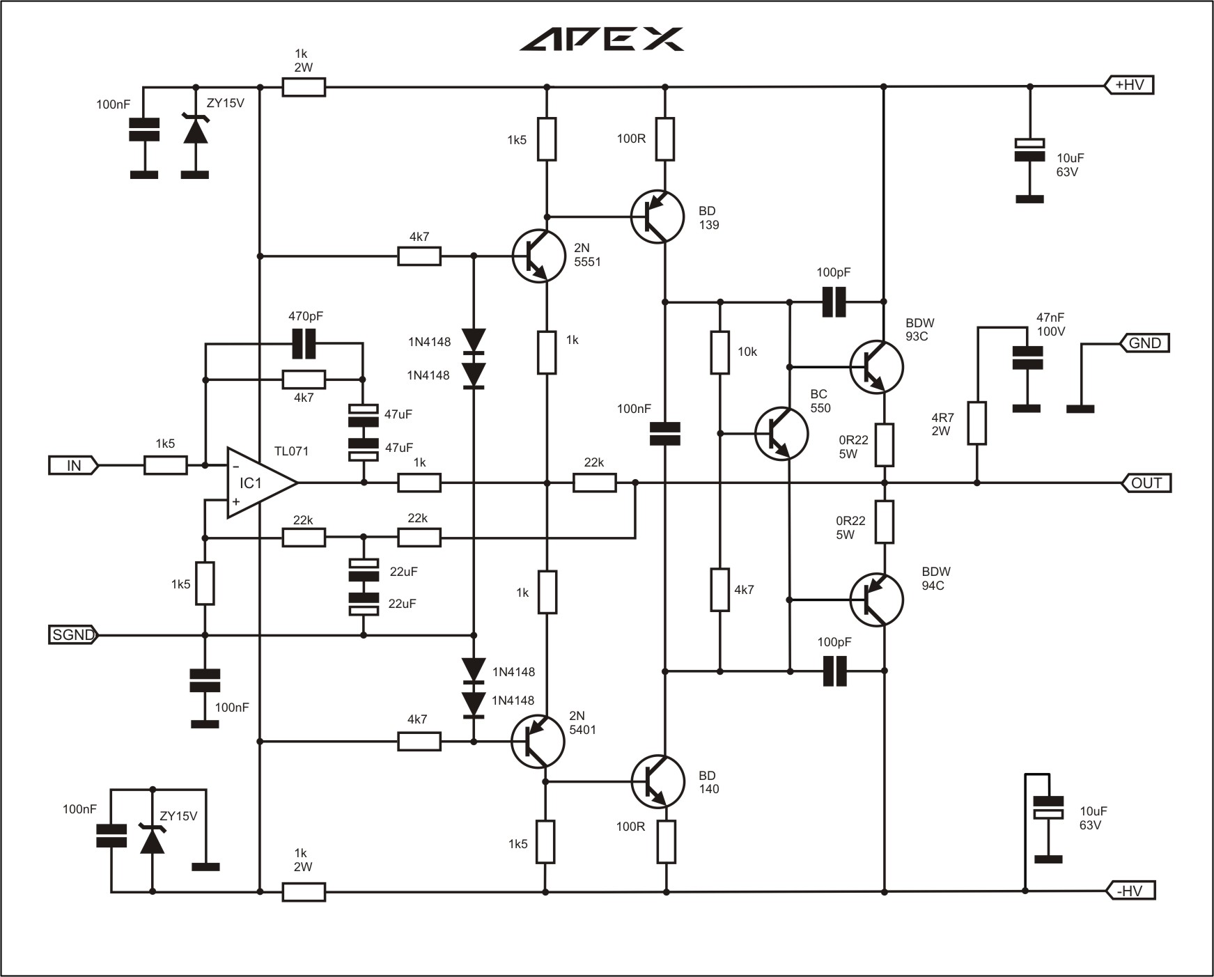

Can you please teel me how many output transistors do I need for +/-42V?
Can I replase MJE15032/15033 with BD243/244 or similar on this voltage?
I have transformer with 2x30v~ sekundar.
Hi, Apex.
Single pair will be ok, you can use BD243/BD244 or use darlingtons BDV83D/BDV84D without drivers. This schematic can help.

Ok.Thanks. I will design PCB for this schematic.
Share your design here when was finish

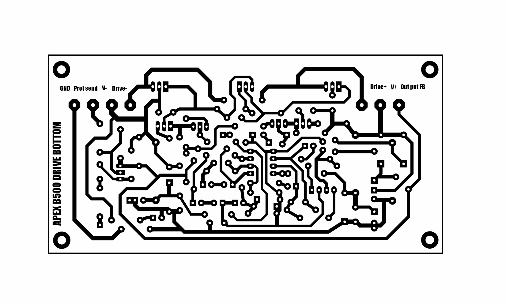

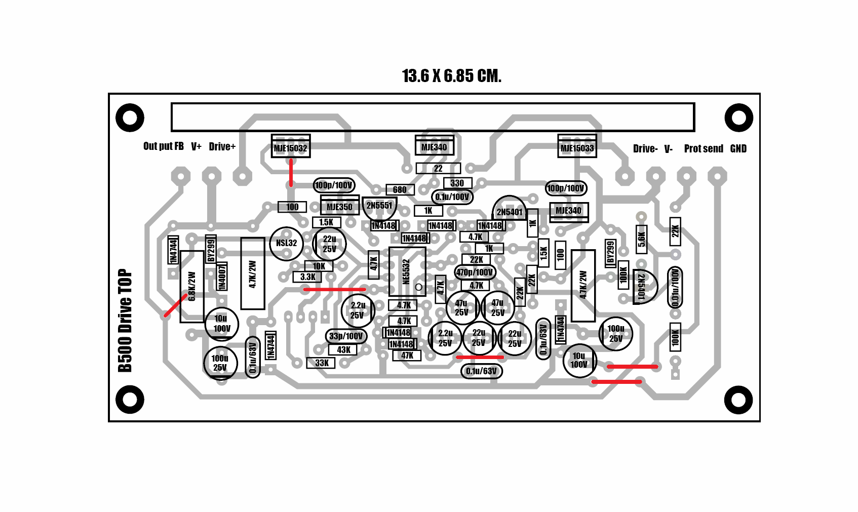

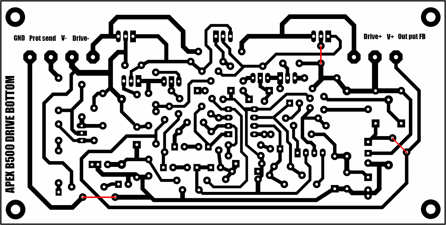

Hi boggart dapo.
I correct edit track and post the parts placement but i don't test ( Wait for holiday time ).
And you use please check and confirm for B500 schematic again.
Regard.
