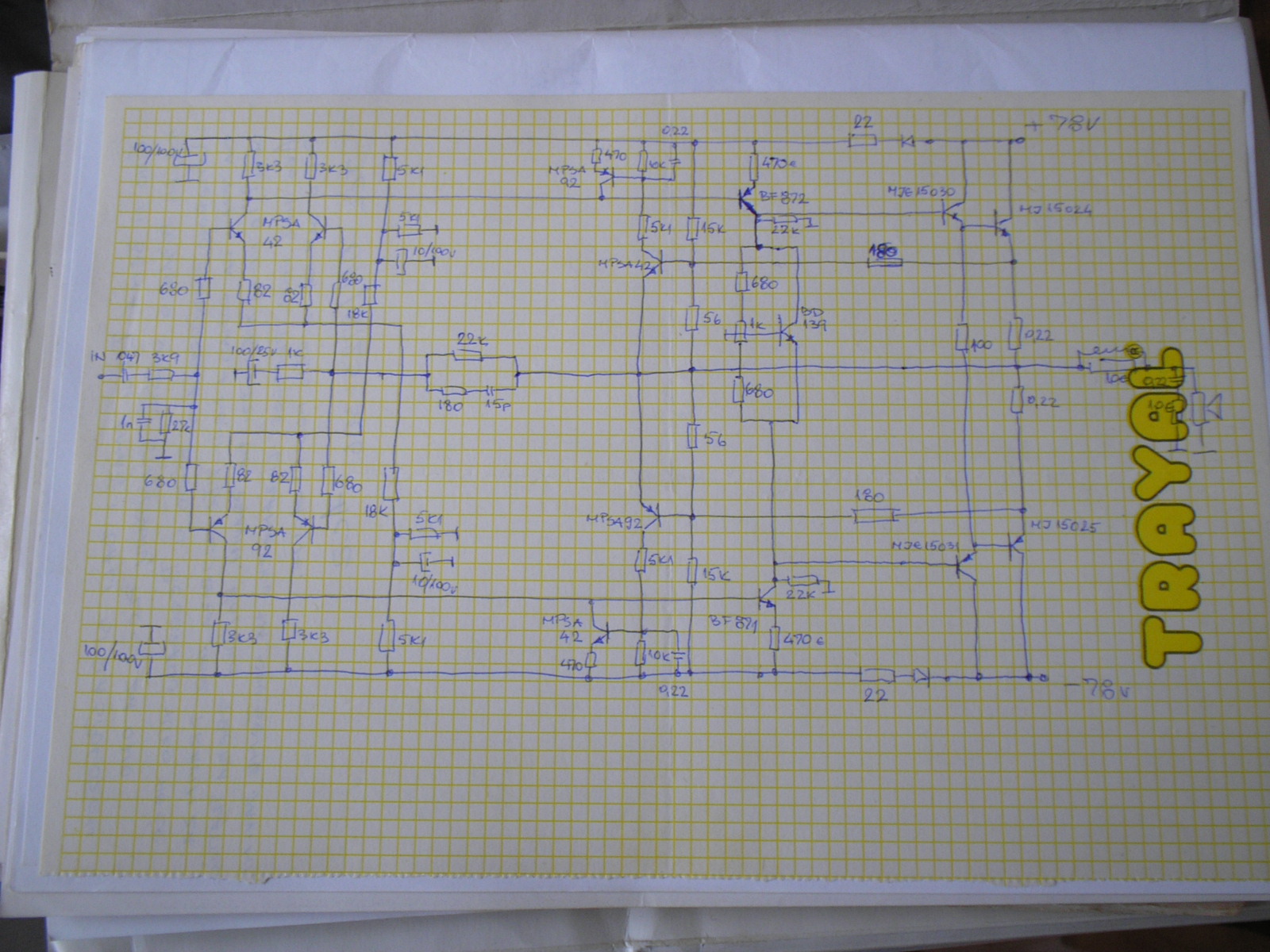

what amp is this sir???...
i seem to like its symmetrical design...
can this deliver harder bass than b500???...
tnx...
ees...

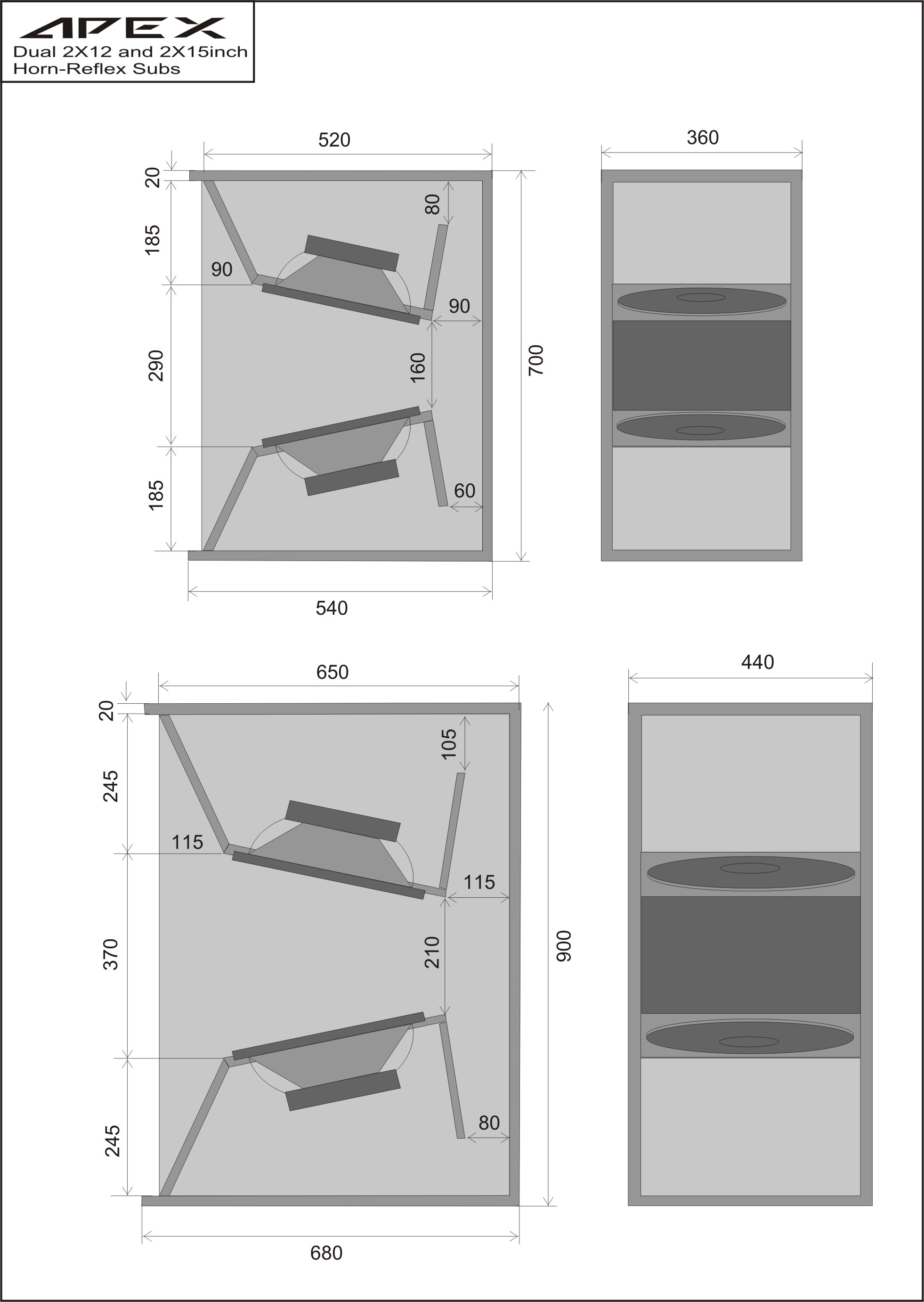

I use active x-over and horn-reflex subs with B500, and bass is great: very high definition, any tone of bass guitar or drums is clear. This symmetrical design is classic and good, but speaker box is also important for good bass.
Regards
Regards
ok i see...
how about using the same set up...
only different amps...
using b500 compared to this amp???...
how do they differ???...
tnx...
ees
horn reflex sub
Regards

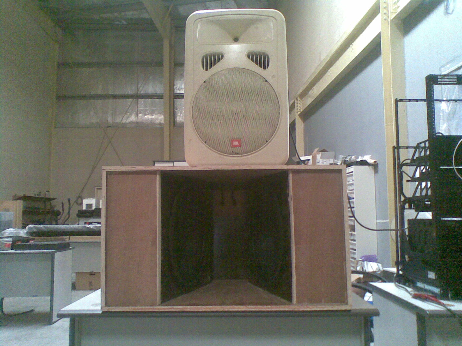

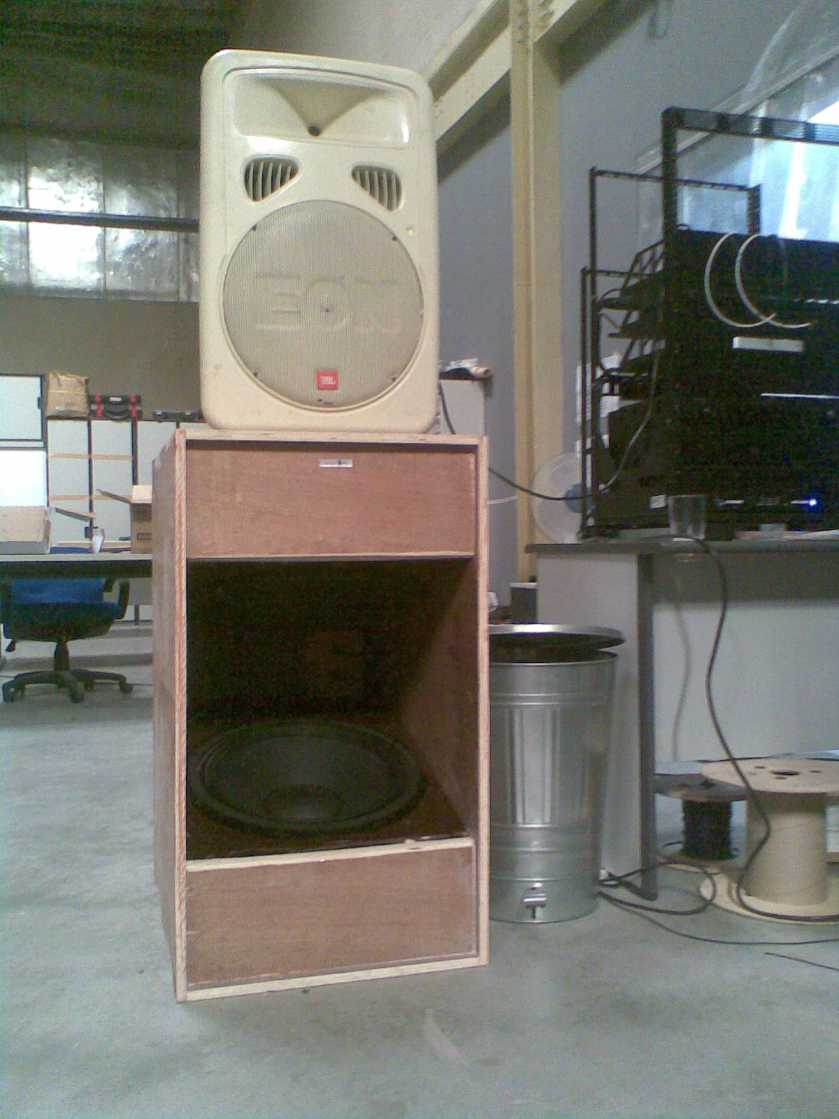

hi apex, we built your horn reflex sub using Fane 18xb speakers and it sounds great, driven only by a crown xls amp in bridge mode, it really rattle the roof of our warehouse, very hi fidelity bass that throws at a distance
