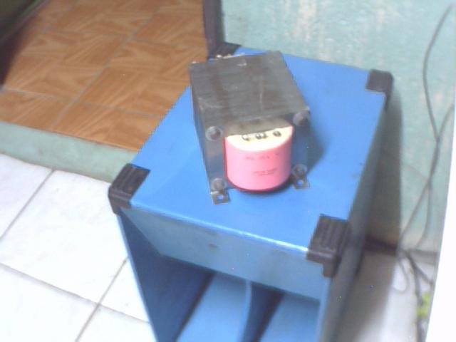

can we see the pic of the transformer
regards
sekhar
why do need such amp rating for ur transformer........ can we have a look at the pictures of ur transformerapex

i once built an amp with this psu rating with EI core...i thought of using it again...

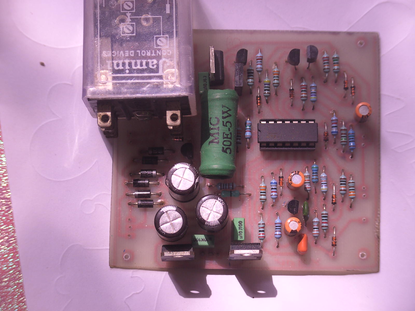

Yes, but you must have overcurrent detector on amp pcb, like B500.hi apexaudio
greetings can this dc protector be used with other amplifiers?
mainly the short circuit protection
thanking you

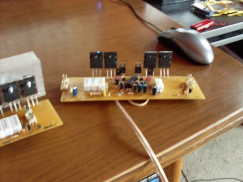

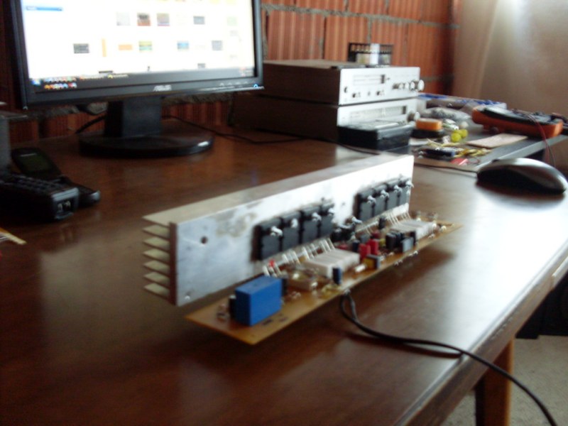

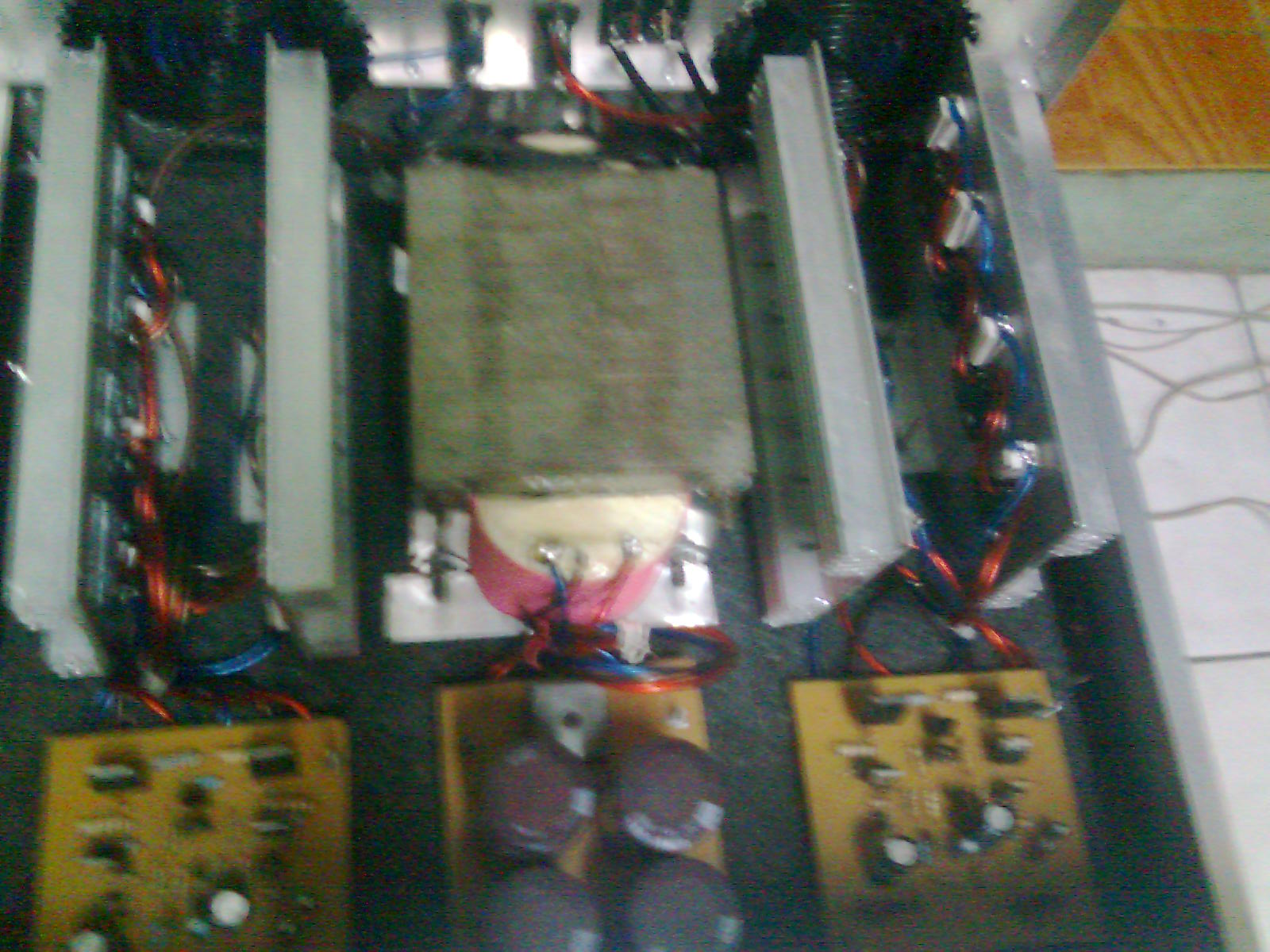

sir... i powered on my b500 circuit...
i had dc on output about 7v...
i put 2 330ohms 10watts resistor on xformer primary...
power trannies seemed to warm up...but dc occur on output...hum on spkr...no audio on output...
what seem to be the problem???...
pls help...
tnx...

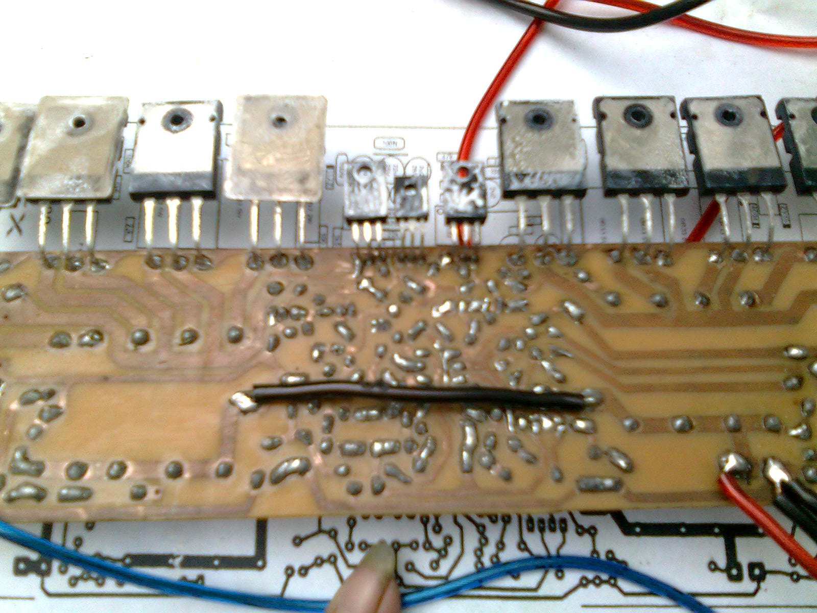

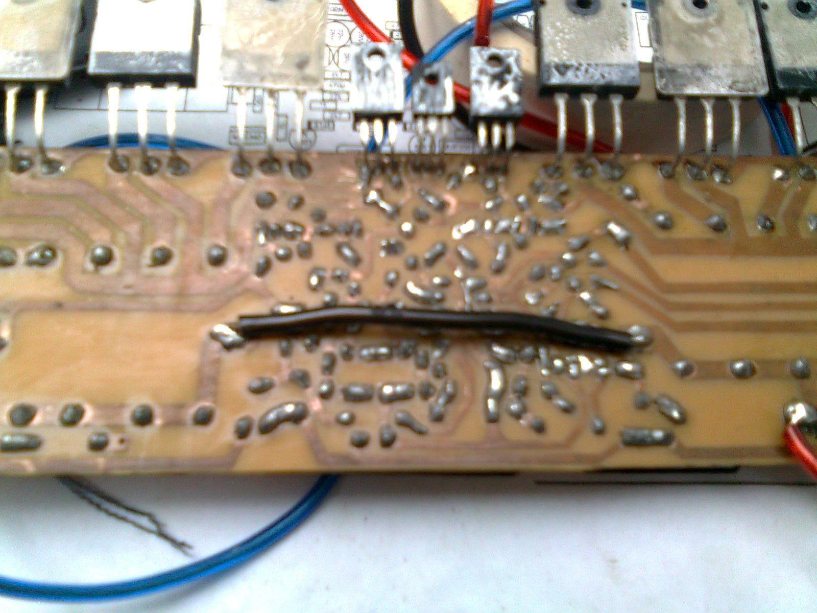

Do not connect speakers if you have DC on output. If you not forget to connect wire jumper (red line) on botom side of pcb or GND on input with separate wire from PSU, try to measurment voltage on point as I suggest,apex...

Do not connect speakers if you have DC on output. If you not forget to connect GND on input with separate wire from PSU, try to measurment voltage on point as I suggest,
Regards
i removed spkrs from amp...i already hve separate wire fromm input to ground of psu...w/c post can i see your voltage suggestions???...
It's same as for H900 post #405 in thread:i removed spkrs from amp...i already hve separate wire fromm input to ground of psu...w/c post can i see your voltage suggestions???...
http://www.diyaudio.com/forums/solid-state/162408-900w-h-class-pa-amp-limiter-41.html

I also had DC voltage about 8V, when start amplifier first time,
but when I turn it on after few seconds again voltage was -35mV.
And now is 35-40mV and amplifier works ok.

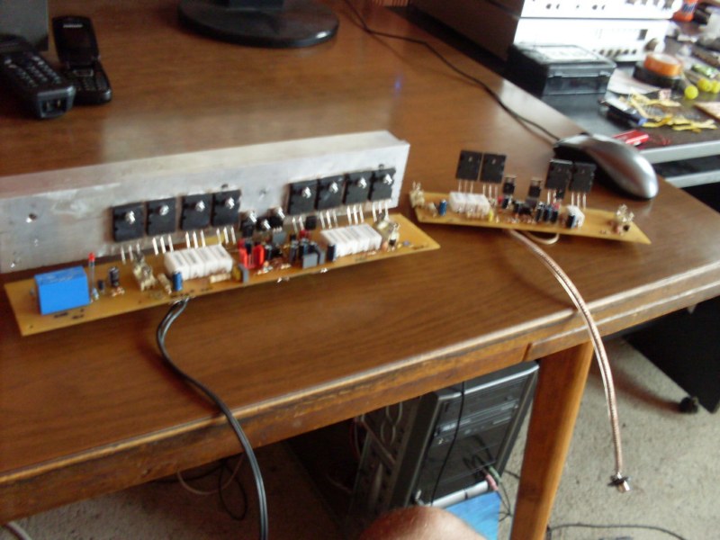

7vdc on output doesnt decrease...stays as it is as it was first turned on...
output trannies turn on hot in less than a minute...

im facing some kinda' prob here...i still dont know what to do...

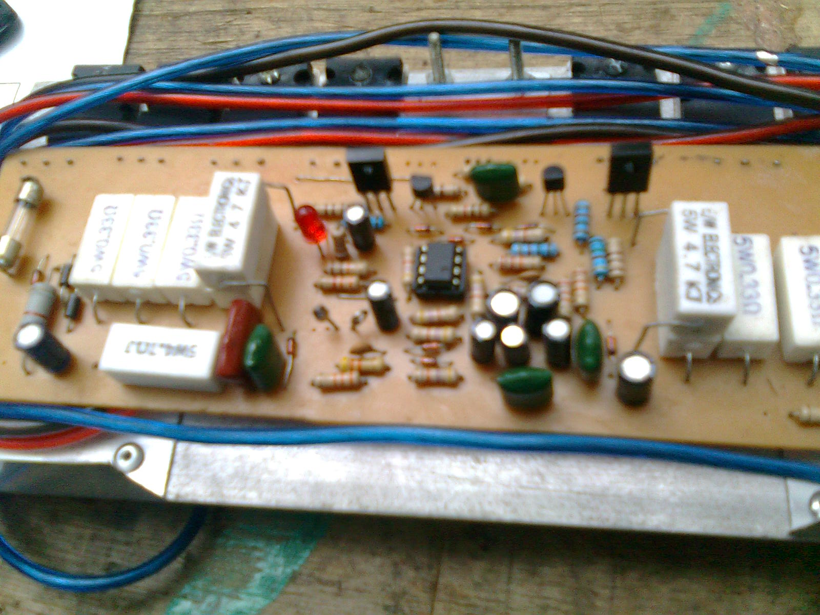

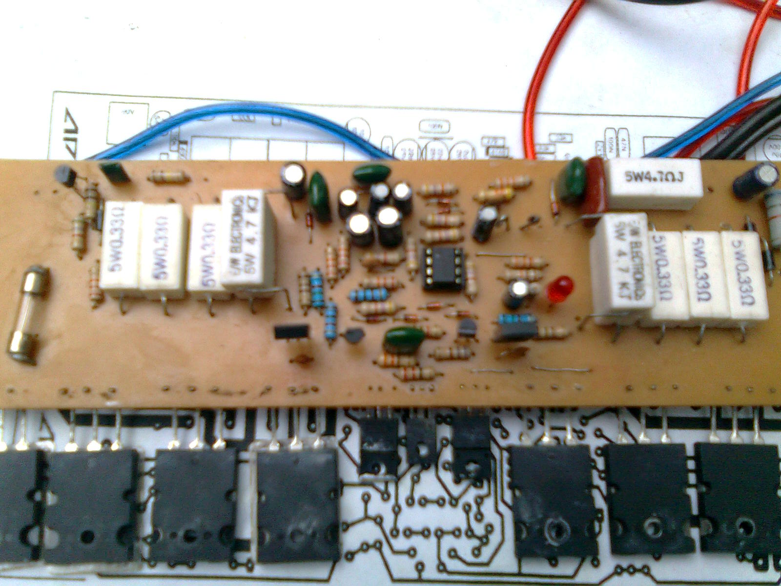

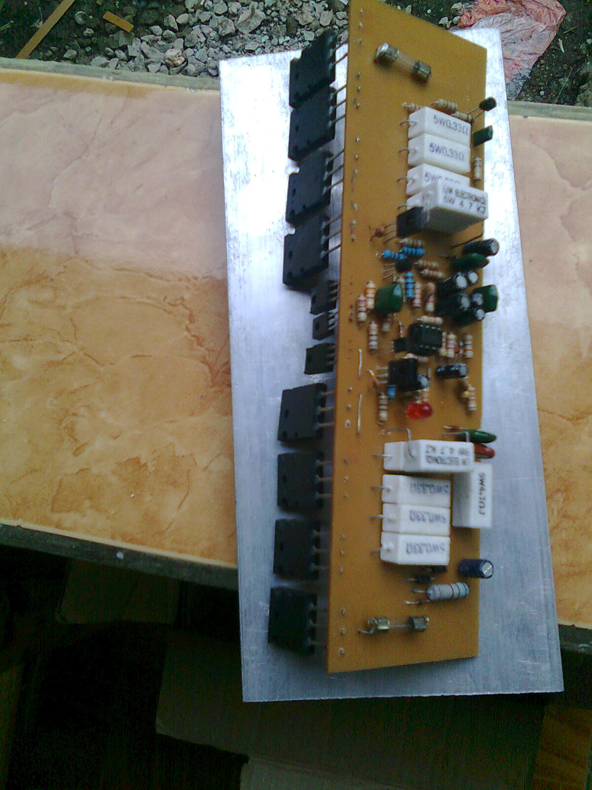

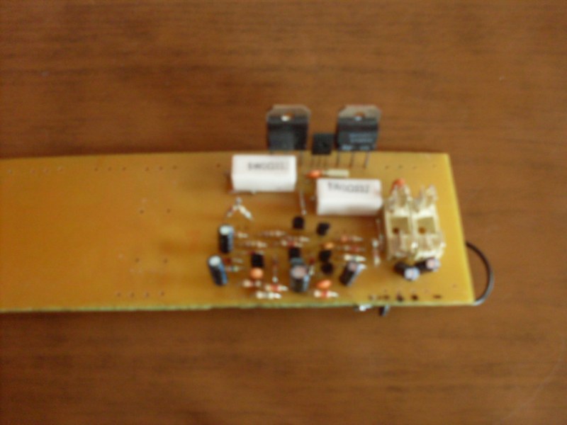

Post some pictures if you can.
Look at GND wiring.
What voltage are you using for this amplifier?
Look at GND wiring.
Look at GND wiring.

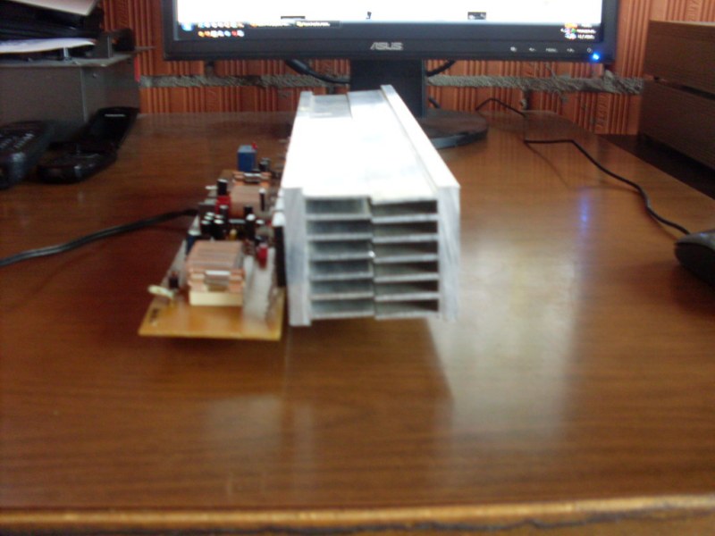

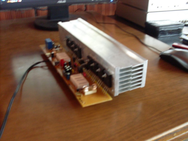

i took pics this morning
i used my fon to capture images
i guess its not that clear...
