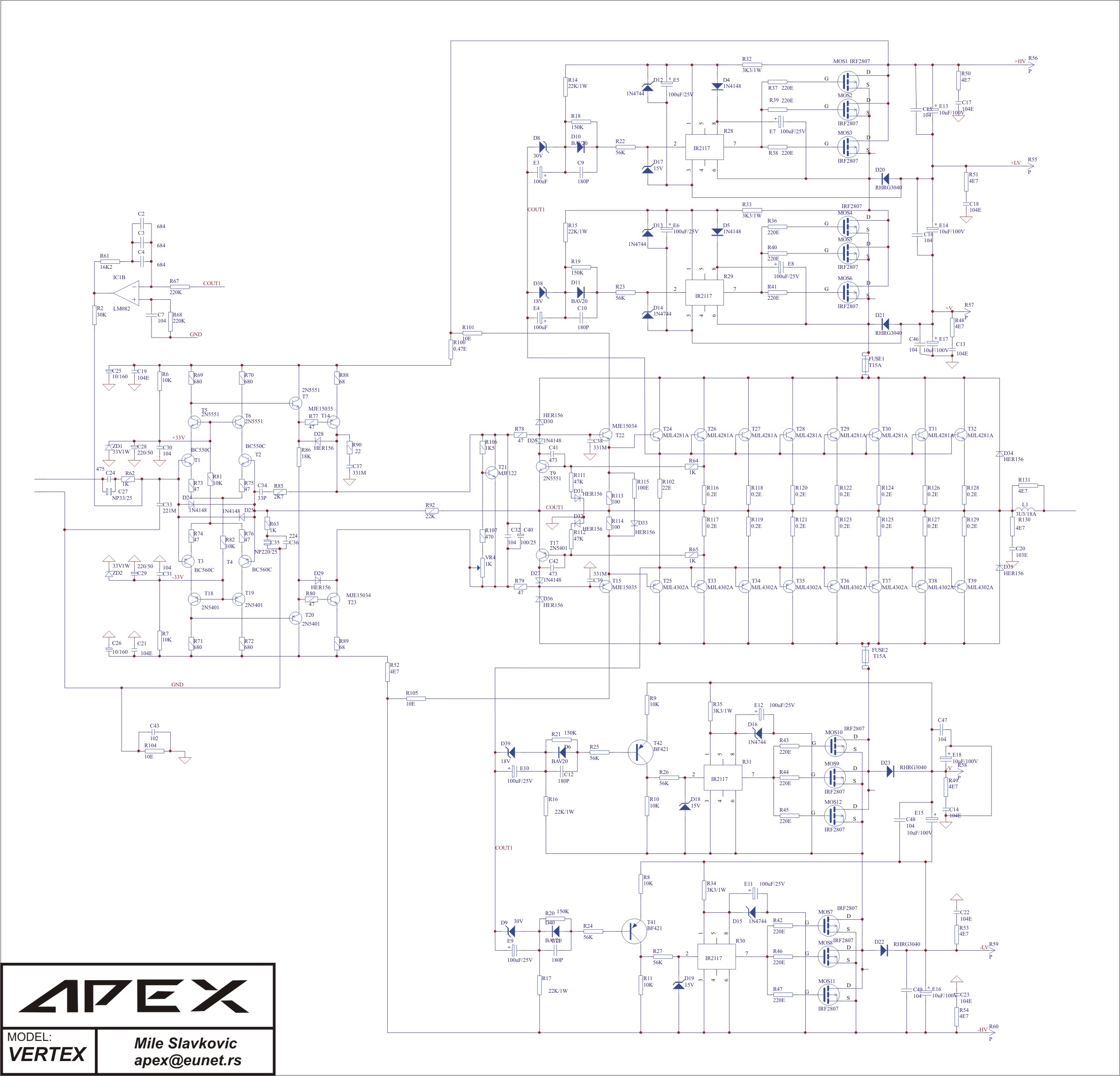

500W PA amplifier with Limiter
Nice try, but for this power you need something like this,
Regards

How you comment QSC amplifiers RMX series?
apex

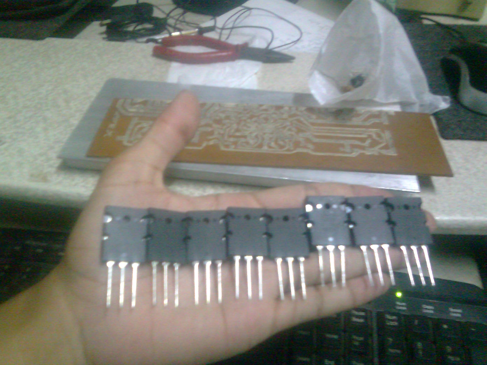

sir,
i bought all the b500 components...i noticed that some components in the schematic differ from the pcb placement guide...
i need to know which one to follow...should i follow the schema or the pcb???...im using two psu for testing 1 is 50 0 50vac @20amps 2nd is 55 0 55vac @25amps...
tnx...
regards...

Only difference post #1 and post #8 is 2k2/5W instead 4k7/5W both is OK, but if you use 2x50v or 2x55v put 2k2 or 3k3, for higher rail voltage use 4k7.
Regards

tnx, sir...
i also noticed differ diodes
post #1 used IN4007
post #2 used IN4004
which diode should i use for maximum safety operation with these rail voltages???...
i'm also planning of installing 8 pairs per rail...
but i will use 4 pairs for testing...:)
tnx...
regards...
