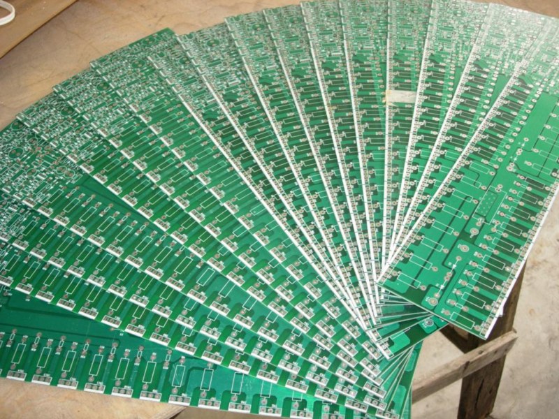

500W PA amplifier with Limiter

I share B500 with all forum members, now that is our amp. Thank you for build B500 and post pictures. I expect more amps in future use this topology.
Regards

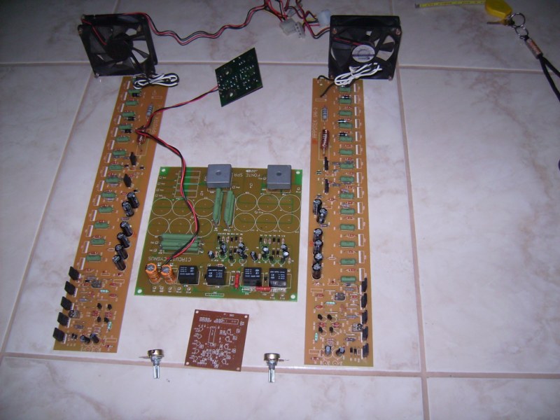

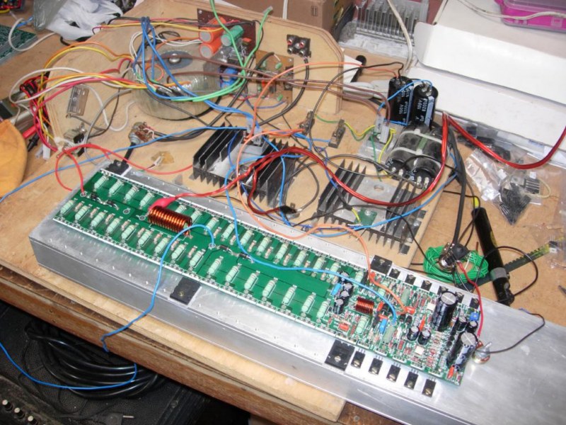

Apex..this my picture B500 after add fan, so 2 fan (sorry can't see that picture) and adding capasitor 0,22 uf/630v (yellow) + Resistor 17K/2w paralel with capasitor bank in PSU and softstart in AC in. With adding this, how effect for B500?
Pozdrav,
Pozdrav,
I expect many upgrades in a future, and you share your expiriance with us. This upgrades you did is OK. Thank you for building and post pictures.
Pozdrav

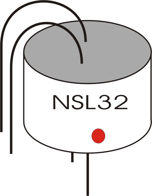

Hi Apex,
confirm: how to applied NSL-32 on PCB B500? NSL-32 just arrived from my friends in Singapore. In your PCB B500, drawing NSL-32 with "dot" is it match with "dot" on body NSL-32?? This ilustration:

Dot is katode of LED inside NSL32, resistor is on oposite side,

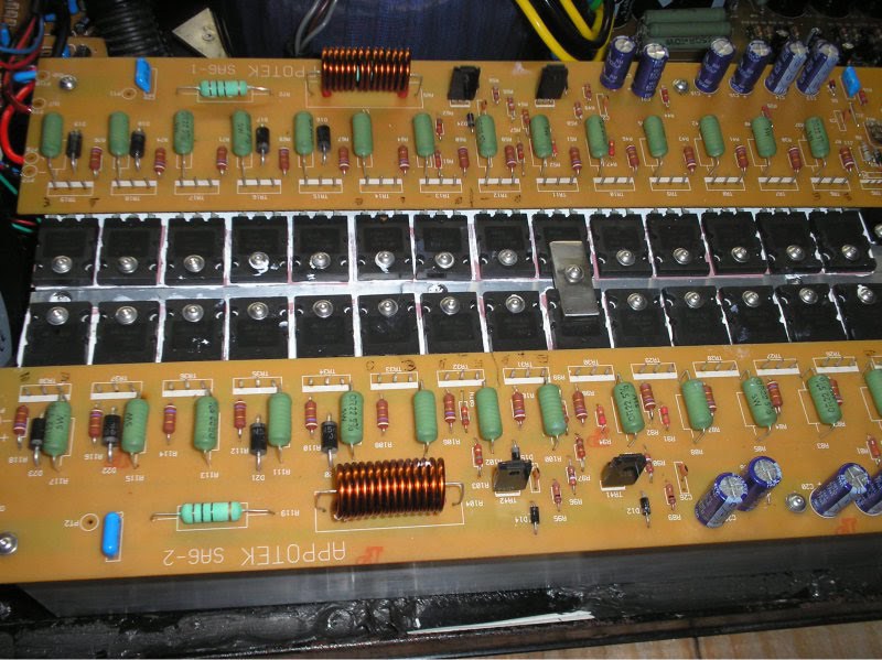

Hi, Apex. 🙂
What do you think about this amplifier?
Have you build something like this?

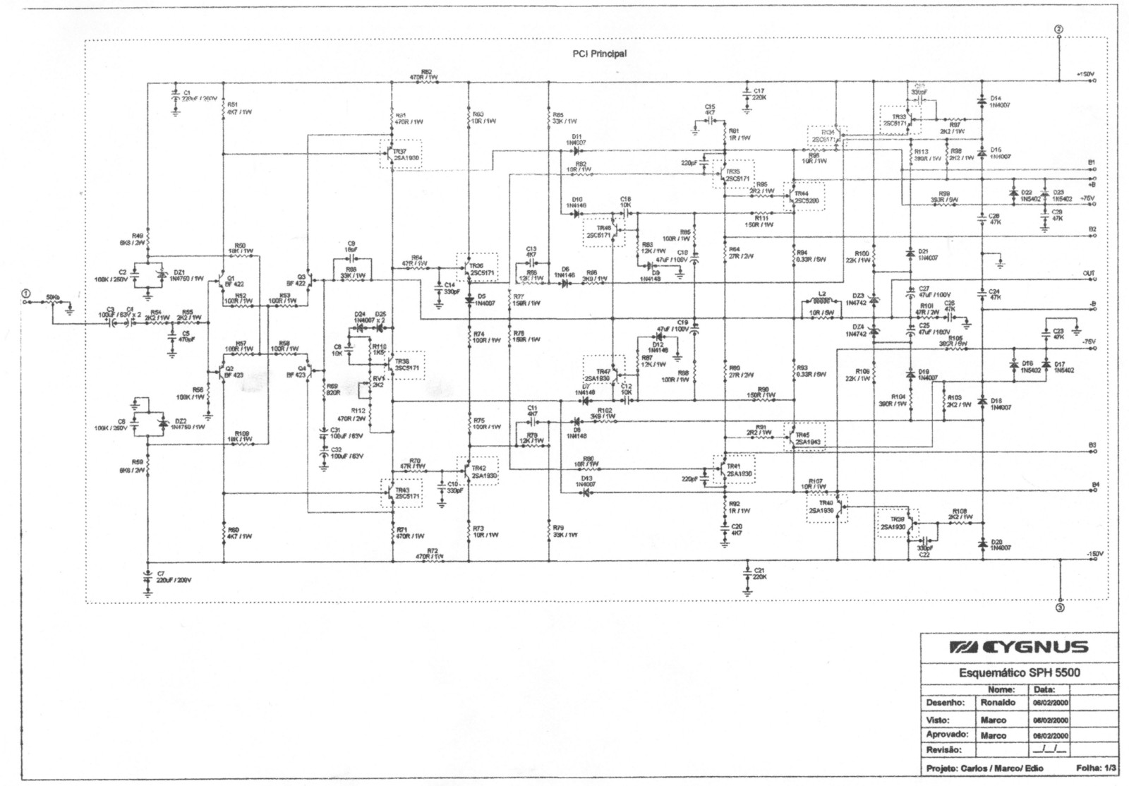

Schematics.
I resized this picture because it's to big,if you want better resolution I will send you by mail.
regards
